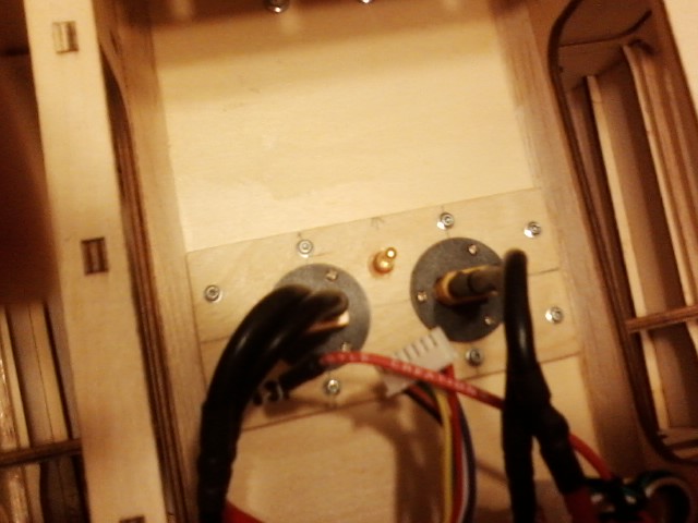

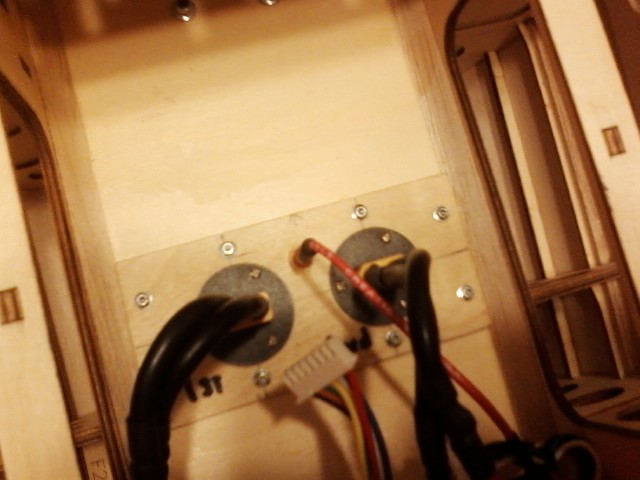

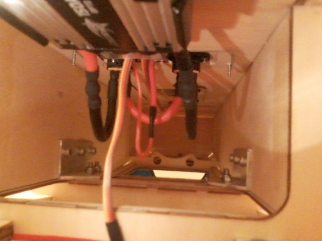

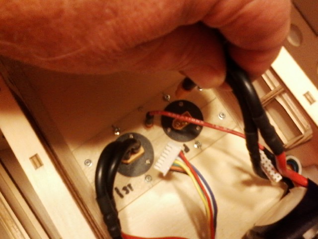

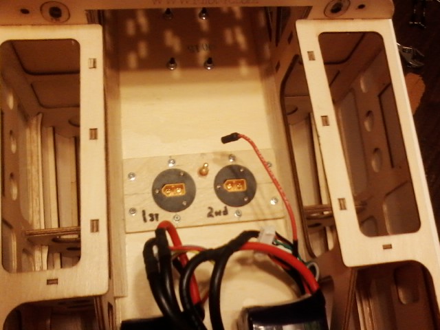

Played around with the 12s set up the last couple of evenings on the extra. Being this my first 12s...I have found that wire size and length are critical to optimizing performance. I installed dual XT60 connectors to run the 6S packs in series instead of the adaptor I had previously made. This greatly reduced resistance and now the system swings the 20x10 falcon carbon with out shut downs. I also replaced the speed controller wires with higher strand count 8awg wire. The little bullet connector between the two XT60 connectors is the "Anti-spark" connection. One of the two packs has the female (anti-spark) connector soldered to the positive balance lead. It actually works and eliminates the plasma arc completely when hooking up the second pack.

I like it! Very clean. Interesting the voltage drop is that significant in a short run. Though, what kind of current you pulling?

With the 6374 192kv - 91 amps.
With the 6374 149kv - 79 amps.
The 149kv motor seems to do better but does not have the top end the 192 has. It also has a couple of more minutes running time.

I would not have expected those results you obtained with the voltage losses. Will file that away for some future event. How do you like the e-power vs. gas?

The voltage drop on the packs was excessive using just the adaptor and a single XT60 to the speed control. Wiring two XT60 connectors in series with 8awg wire really improved the voltage from dropping excessively causing the speed control to shut down. The 149kv motor further aided in lowering amp draw at wot.
