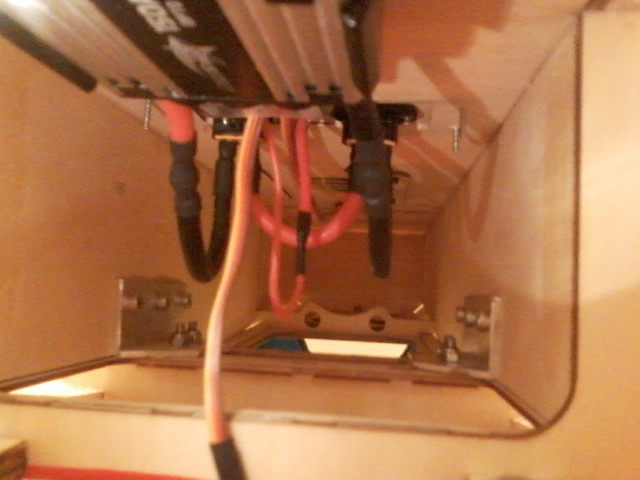

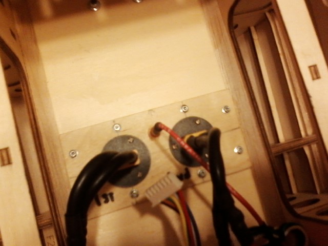

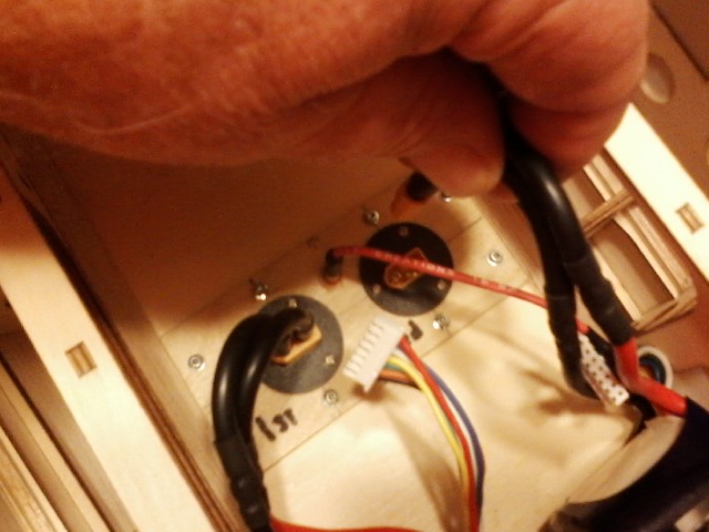

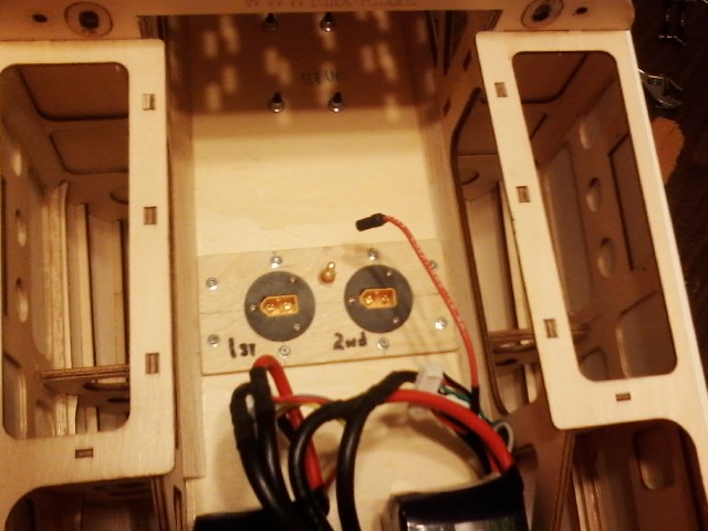

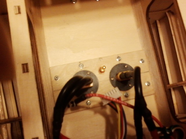

Played around with the 12s set up the last couple of evenings on the extra. Being this my first 12s...I have found that wire size and length are critical to optimizing performance. I installed dual XT60 connectors to run the 6S packs in series instead of the adaptor I had previously made. This greatly reduced resistance and now the system swings the 20x10 falcon carbon with out shut downs. I also replaced the speed controller wires with higher strand count 8awg wire. The little bullet connector between the two XT60 connectors is the "Anti-spark" connection. One of the two packs has the female (anti-spark) connector soldered to the positive balance lead. It actually works and eliminates the plasma arc completely when hooking up the second pack.
View attachment 92140 View attachment 92141 View attachment 92142 View attachment 92143 View attachment 92144
