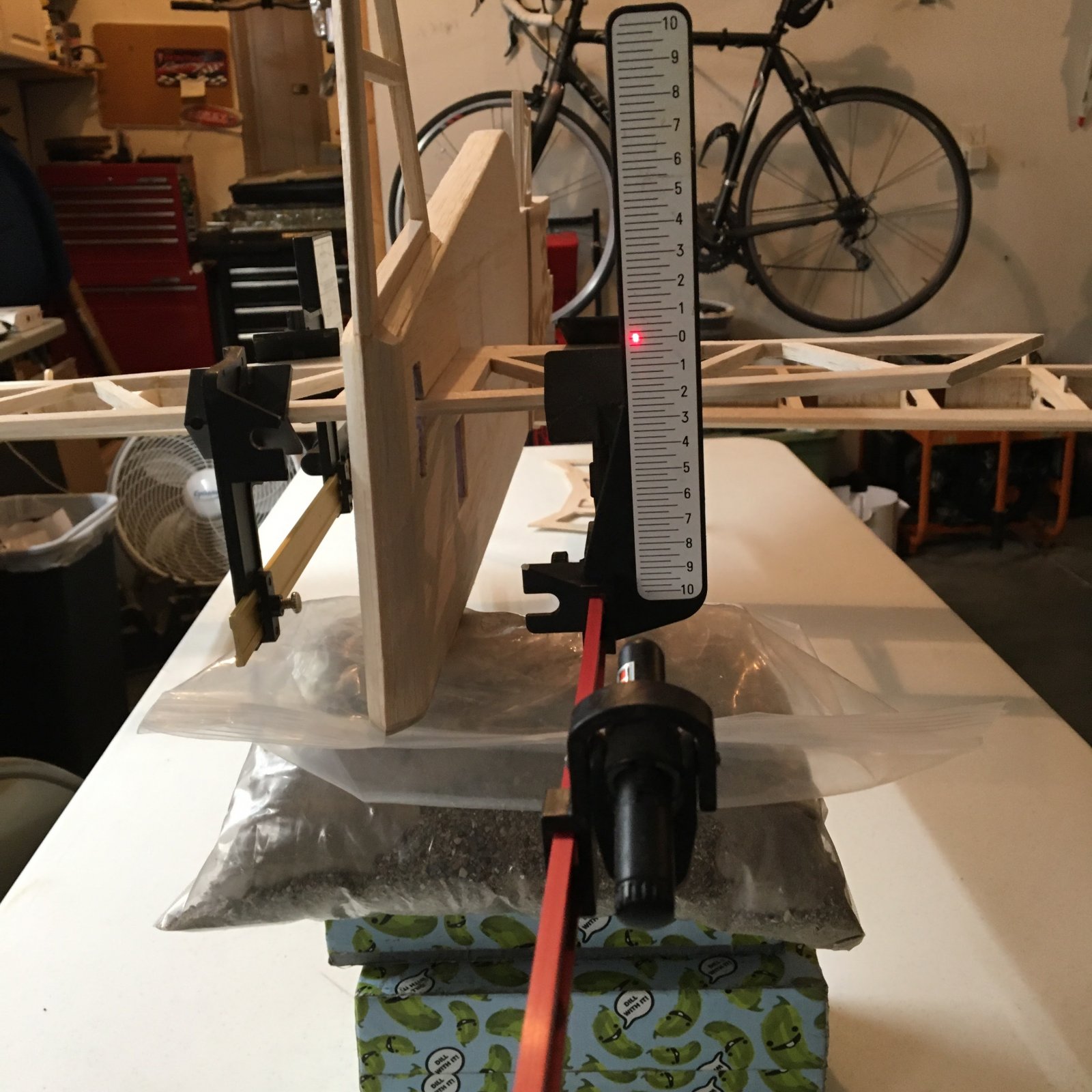

@JAG ... what is this tool with the laser? I don't recognize it but I think I need one!
I'll have to look. I'm borrowing it, so I'm not sure. I don't care for it much. The Robart is better. This one has to many adjustments and you lose the zero if you move it to another location. Heck even turning the laser off is enough to mess it up. It worked well for me since I was using two. I just left this one on the stab to make sure I didn't bump the plane off level.

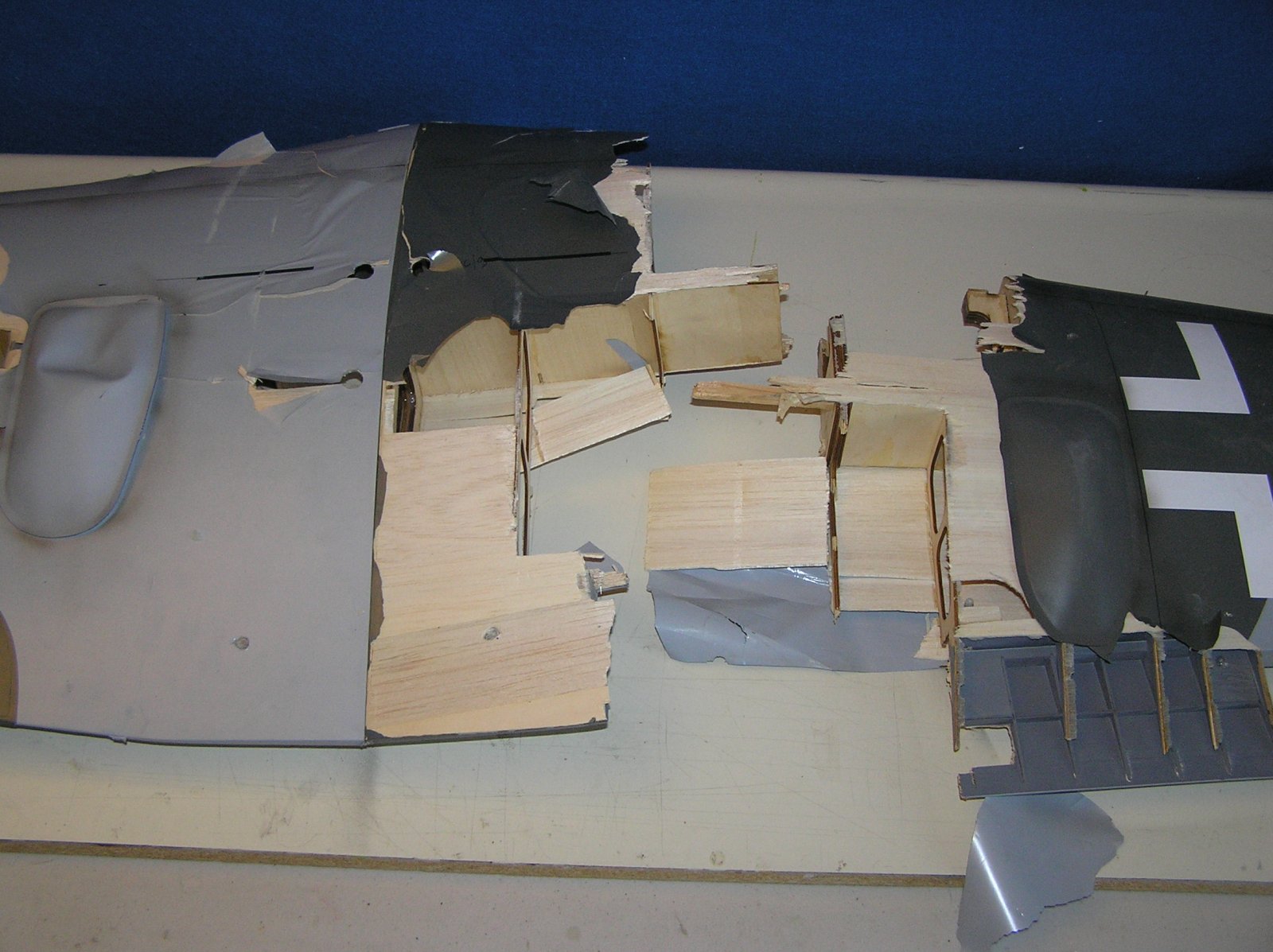

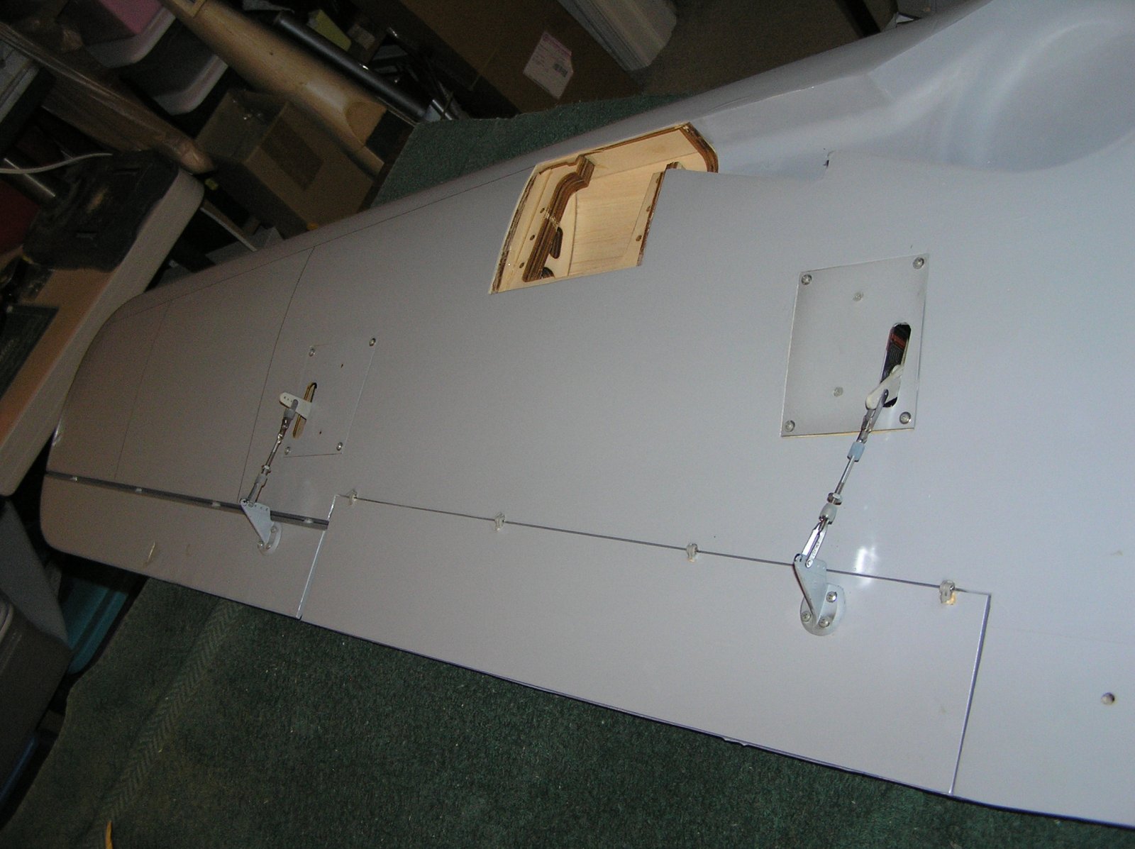

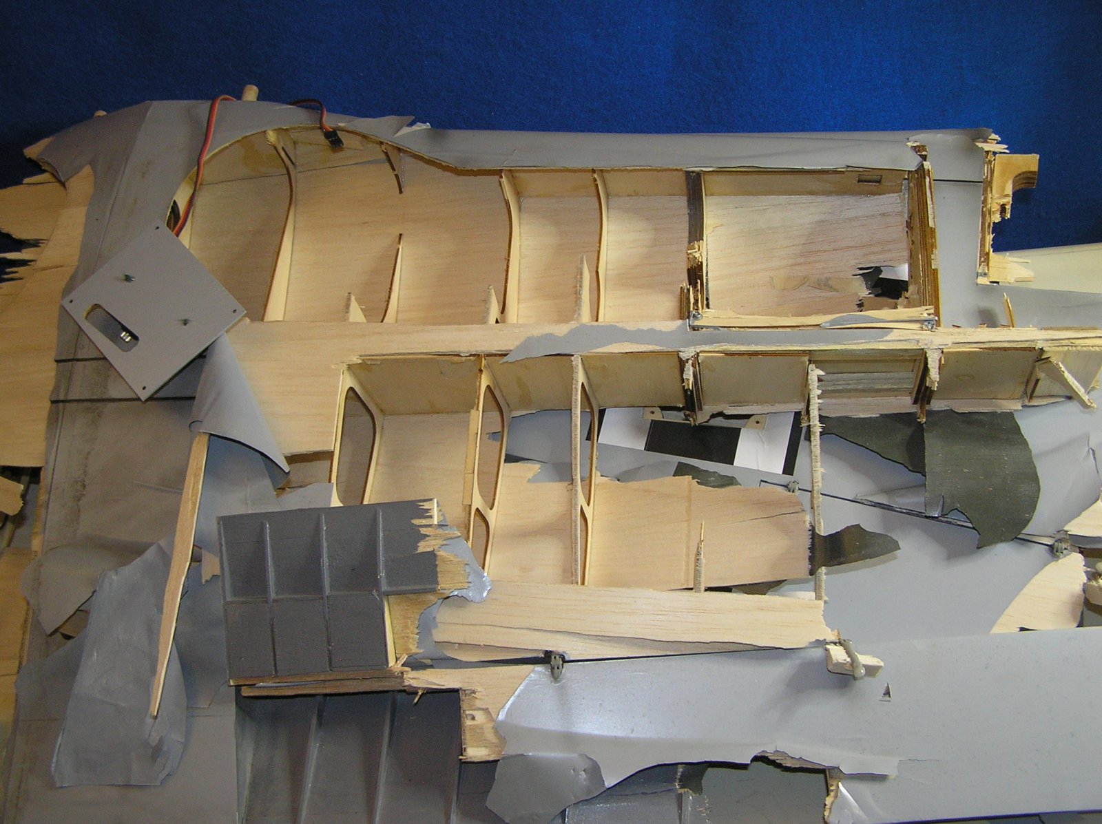

Here is a before picture that I took yesterday and an almost finished picture I just took....I work quick (ha ha)

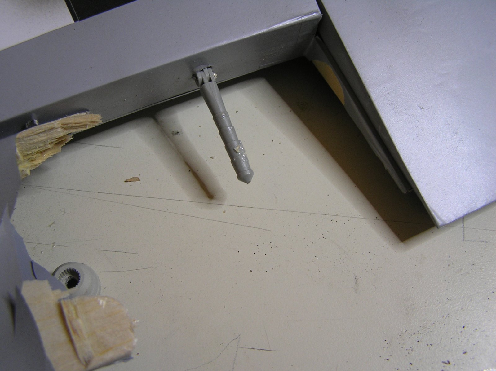

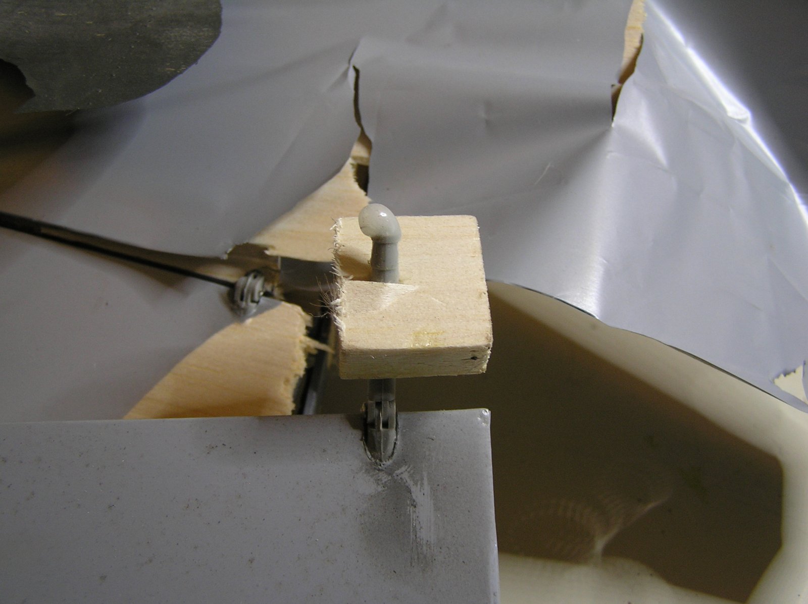

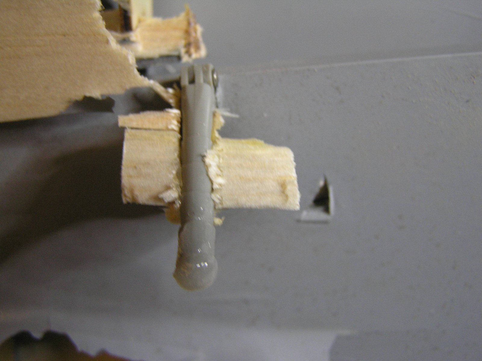

While looking through the debris....I noticed some of the Robart hinges weren't glued in at the factory as well as I thought - but that didn't cause his crash, when they really worked well.

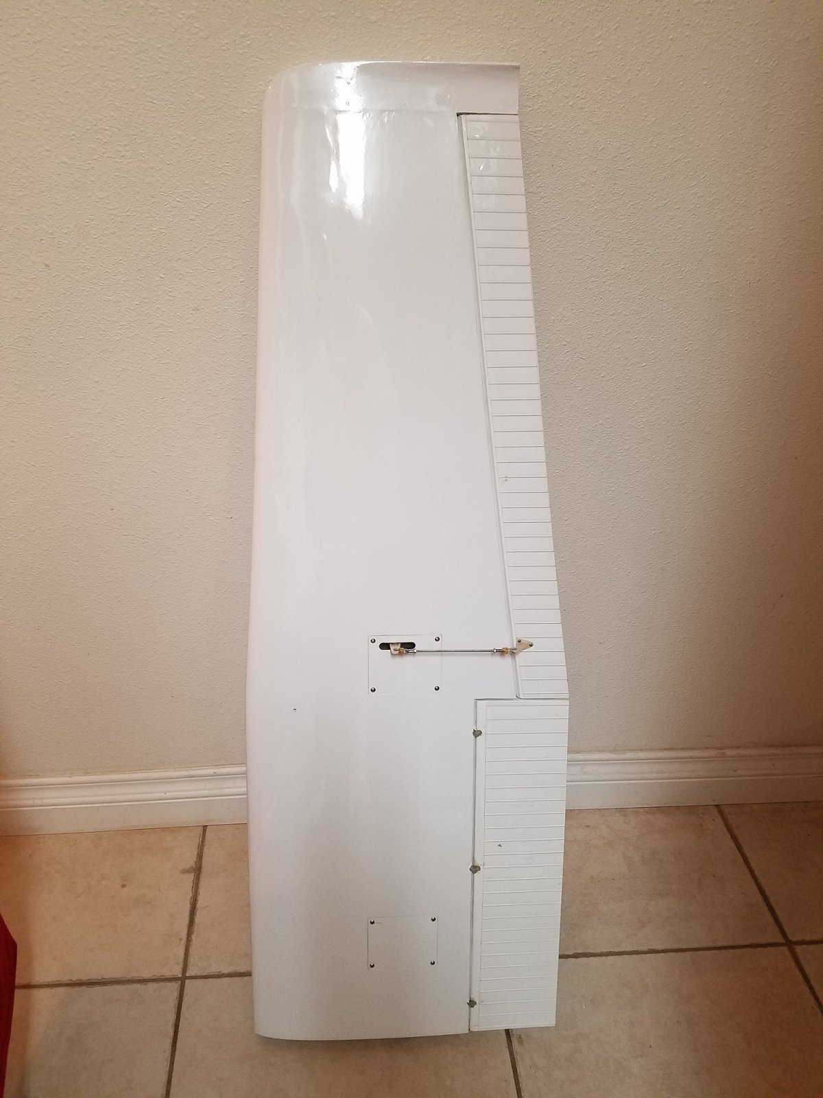

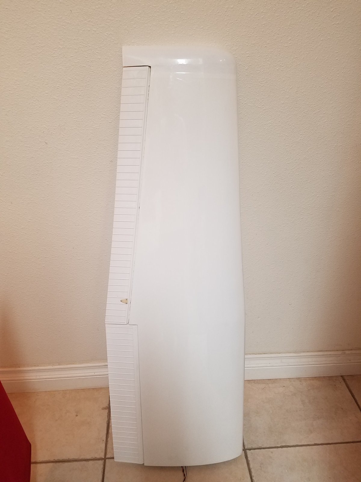

I spent a little time today doing some maintenance and repairs on my Gaserized Cessna and the 3w 170 Sukhoi. Late last fall I had a mishap with the Cessna and as much as I hate to admit it, totally my fault. I guess I have gotten used to flying in a "stalled" condition with my aerobatic planes. Last flight of the day on final, I slowed the Cessna down just a little too much with flaps fully depoyed and realized it a little too late. I mashed the gas pedal but didn't give the plane enough time to gain back the airspeed for a go around and she stalled over to her nose and left wing. Not too much damage to the plane but my ego sure took a hit. No big though, The engine survived just fine and the rest of the plane not badly damaged. Just needed to do some repairs to the motor box and left wing panel. I've since repaired the motor box and now have to cut the new cowl to fit. Today I finished up the repair on the wing and recovered it and re-installed the aileron and flap servos and tested everything. Seems good to go. I'll probably finish up the cowl in the next couple of days.

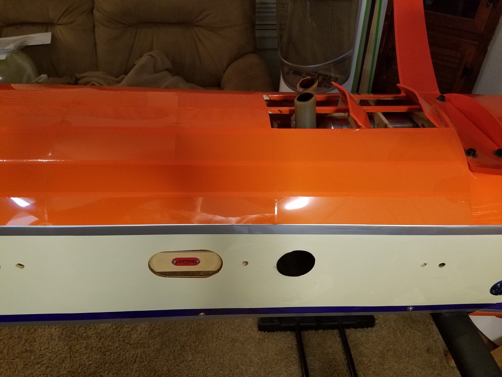

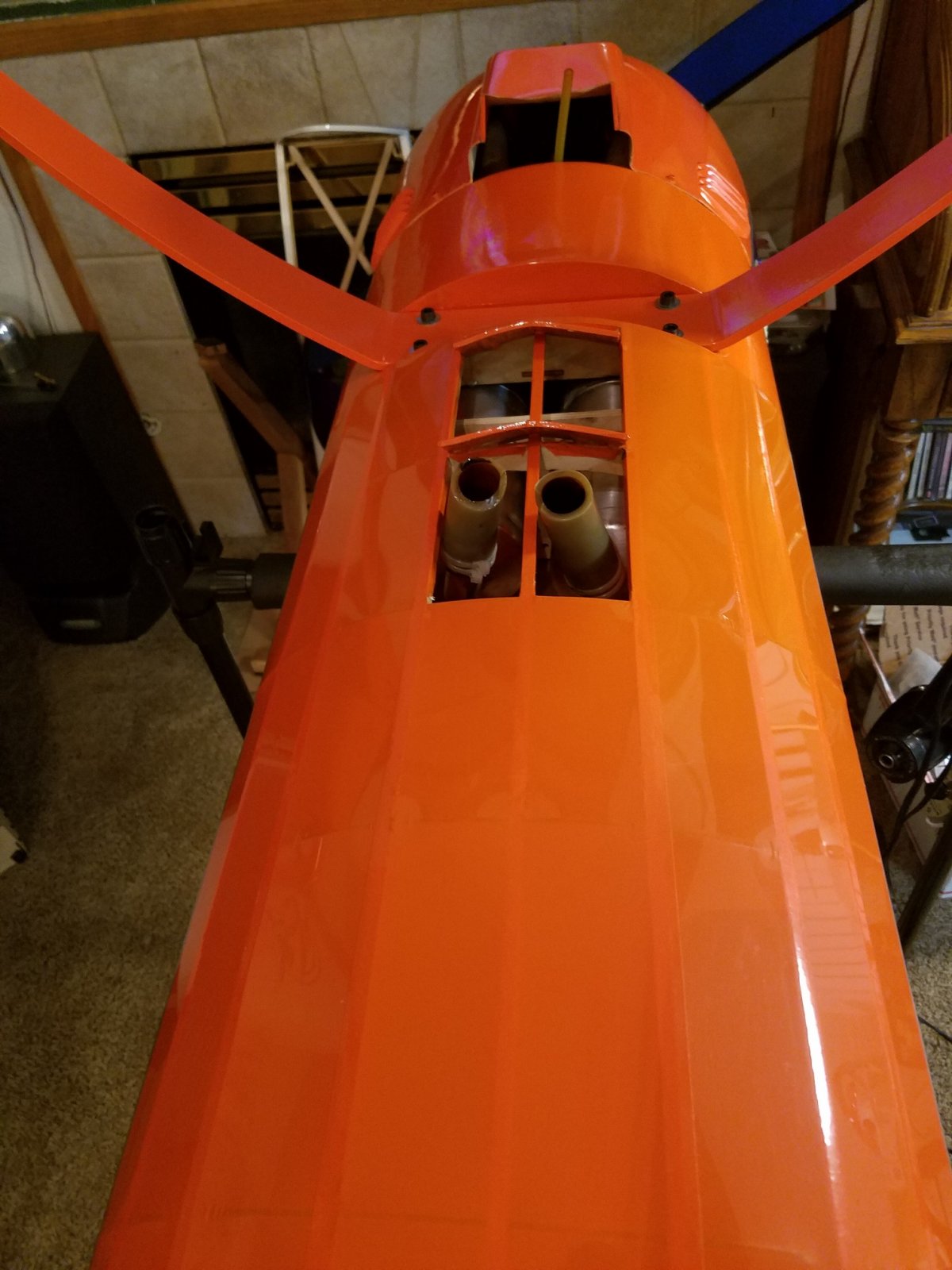

Next up I decided to do a little work on the Sukhoi. Since I have decided to faithfully persue flying the Sportsman class in IMAC this year, I wanted to make sure the big orange bird was ready to go. When I had her out a week ago Sunday, I noticed she was not tracking as true as I wanted. Mostly in higher speed straight and level flight, she would want to climb just a little. It tracks really nicely in all other maneuvers with no mix or compensation for coupling. It doesn't seem to do it at lower speeds and I believe I have it figured out why. When I built the plane two years ago, I added five cooling louvers to the bottom of the fuse from just behind the gear to 17" back to the furthest back louver to help "suck" out warm air from the engine compartment. I have since realized she doesn't need quite that many so I removed three of the five louvers. After removing the louvers, I recovered the belly to seal up that gaping hole in the fuse belly. I am hoping this will eliminate the tucking to the canopy at higher speeds. Will see very soon. I also noticed the "pulse" tube from the carb to the air horn had a cut in it and though the 170 never misses a beat, I figured it probably should be something that needed to be replaced. Done. Also noticed my aileron ball linkages were starting to squeak a little so it's time for a little lube on all the ball links. I also decided to relocate one of the rx. antennas to a cleaner reception area. I had noticed on very rare and random occasions a weird momentary lack of response from tx. input. I am thinking that maybe the dual boda antennas have been too close. We'll see if my new placement will help this issue.
