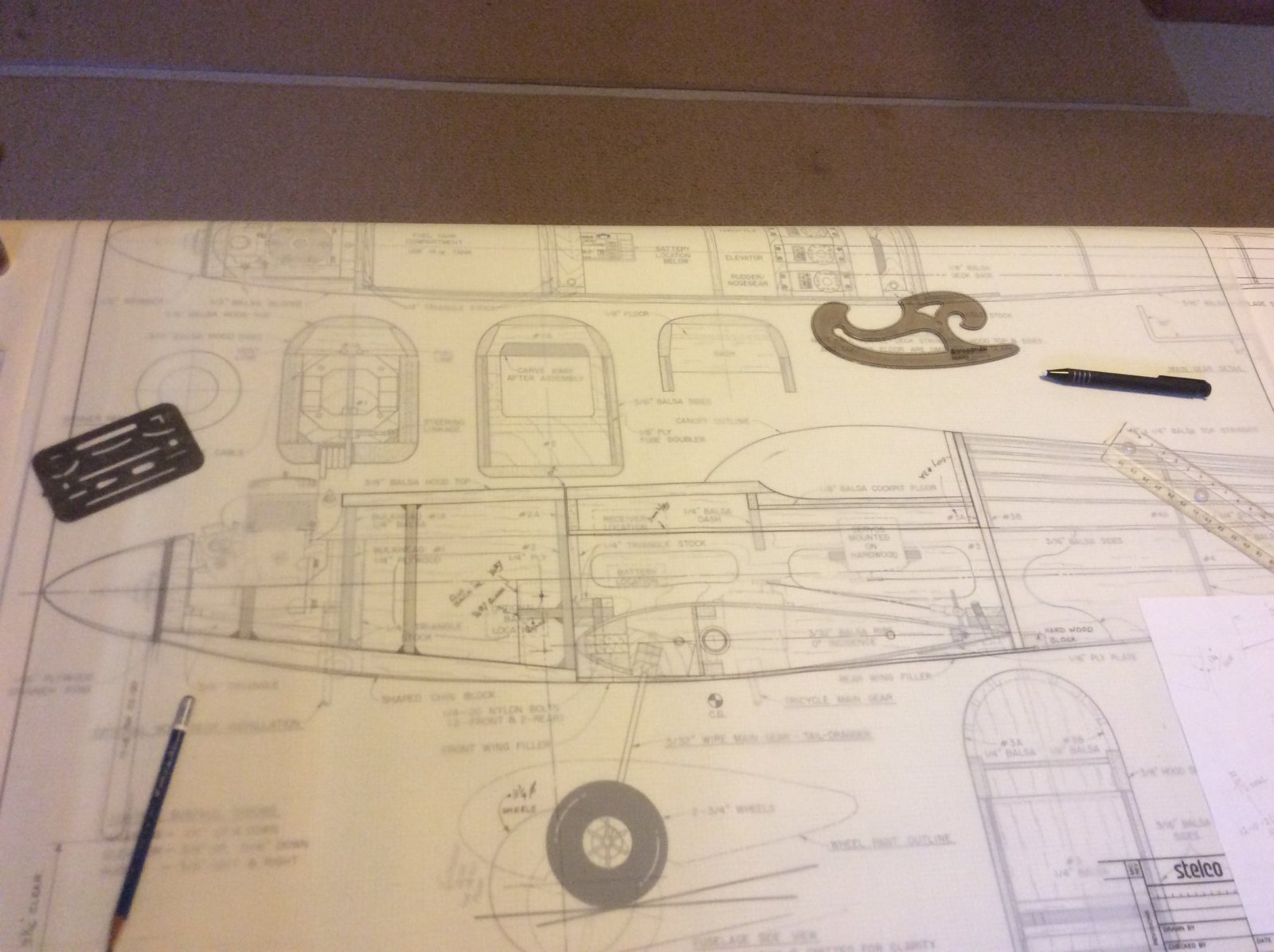

Well started on the Sportster. The wing will be two piece and slide onto a tube. If some of the older flyers will remember the Sportster was one piece wing that bolted in from the bottom with four 1/4 plastic bolts, and the wheels in the wing. So the wheels will be in the fuselage. So the bottom of the fuselage will be filled in and the top opened up so that the wings can be bolted in and connected from the sides.
To install the OS 120 the firewall will need to moved back 1 5/8 on an inch and the spinner size increased from 2 1/2 to 3 inches. Still have to think about the wing and the wing tube.
We start projects and man do they grow fast into a major project and a lot of work. What has happened is I am trying to turn a 20 year old design into what I am use today. Do not like the gear in wings that is pain to handle and store. And I do like having the plane stand on the gear while installing the wings. So this simple Sportster build has turned into a complete rebuild of the fuselage. What have started. I am so far into the fuselage I have to continue. Only thing good about it it keeps me off the streets.
