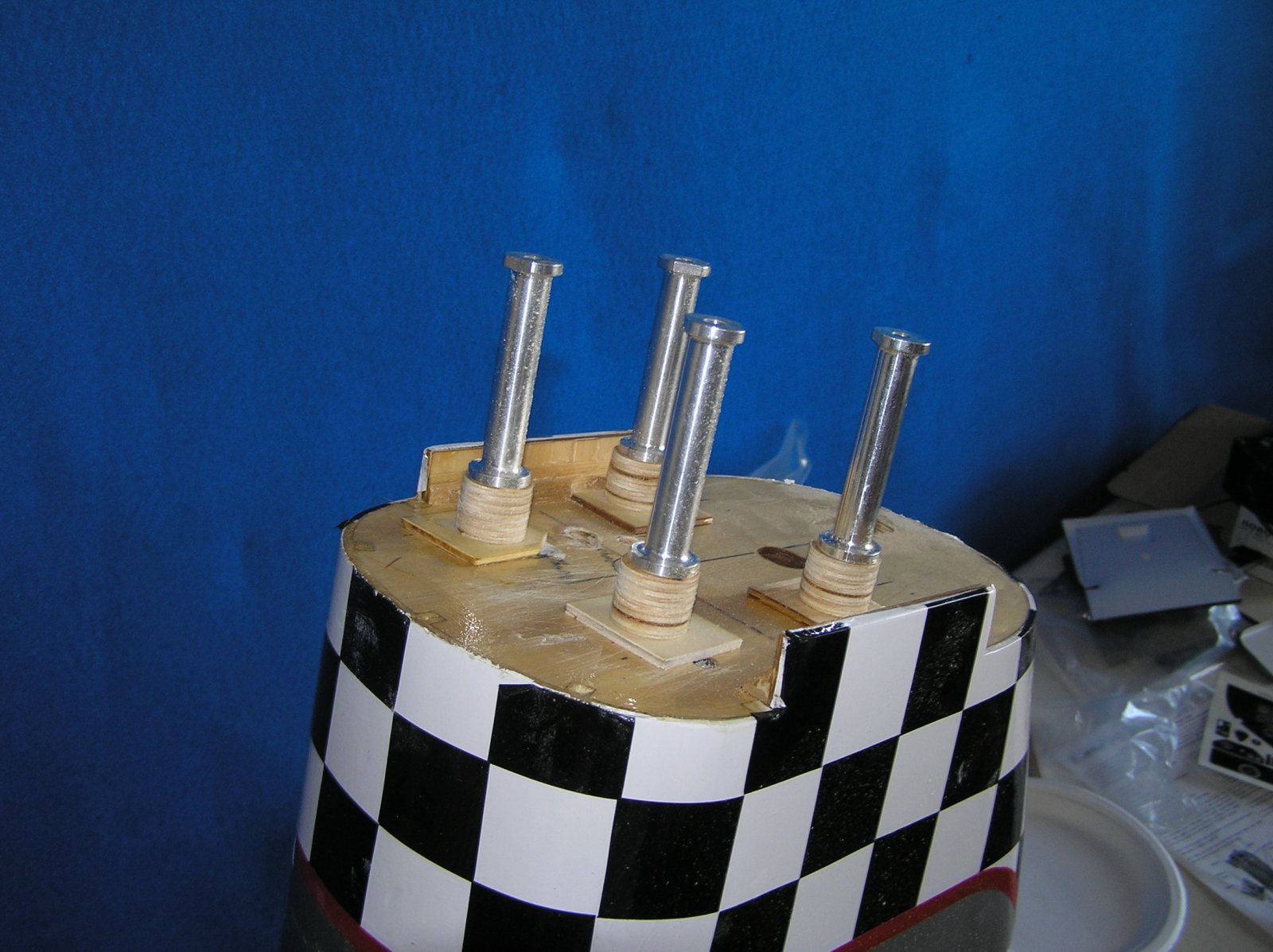

Guess it is time to finish up the front end of the TF Giant Scale P-51 ARF....had to move the engine 3/4" forward and then that was not far enough!

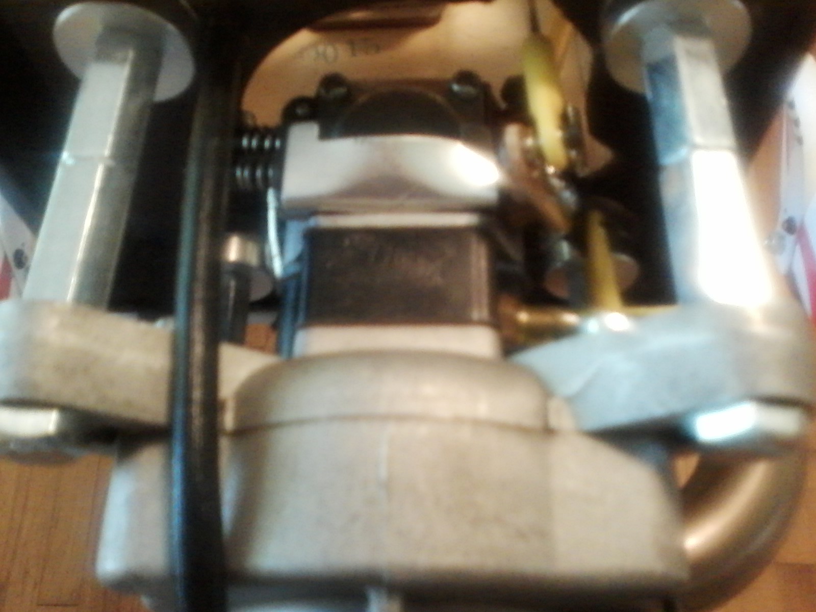

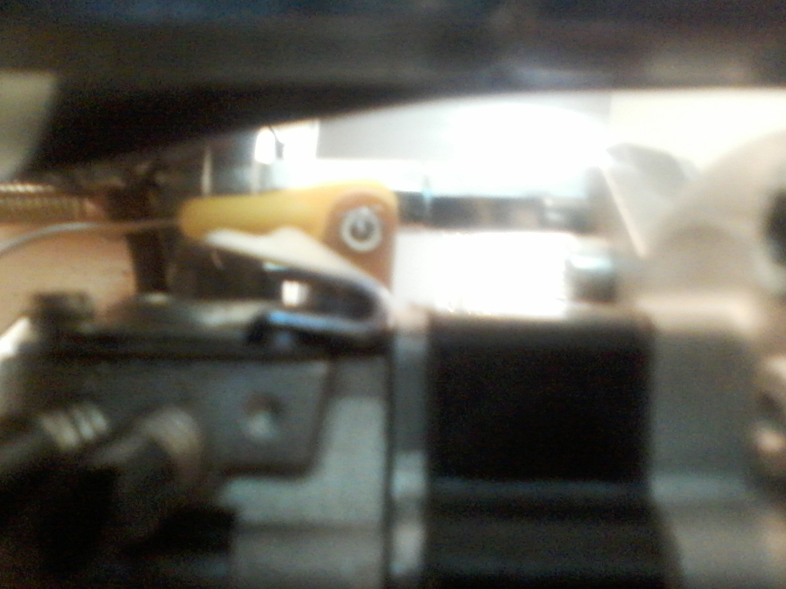

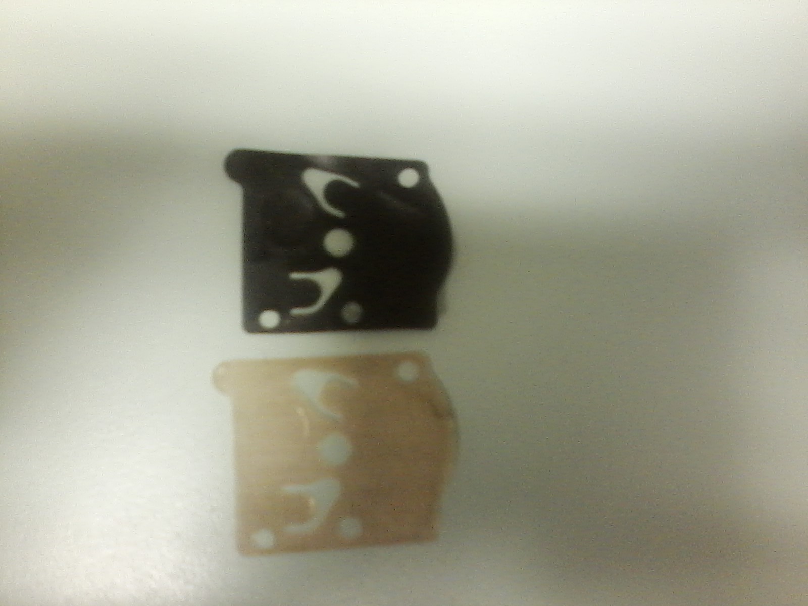

Alright. So I got over my "frustration" hangover and dug into the pump end of the WT908 carb and pulled the rubber membrane diaphragm and installed the "other" diaphragm (Reinforced Plastic Fiber???) from the K20WAT rebuild kit. I also added a "shield" for the hole on the metering diaphragm cover. Set both needles to slightly past 1.5 turns out. Fired on choke after 3 flips and then 4 flips to a running engine.
After warm up went 7400 rpm static. Reliable low idle to about 1300. After shut down I opened the HS needle just a tad more and restarted. Top end dropped 100 or so rpm.0812171107-00.jpg 0812171110-00.jpg 0812171111-00.jpg If this thing :steamer:'s at the field again......:laughing:.
