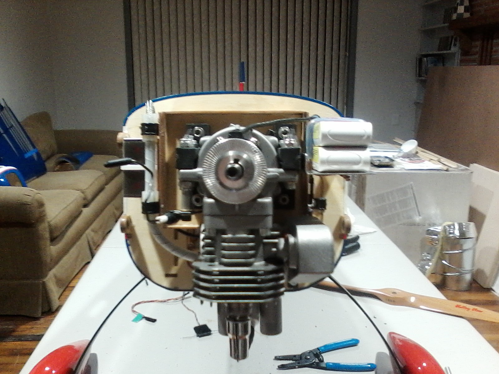

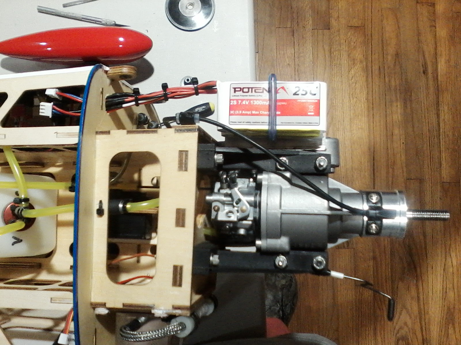

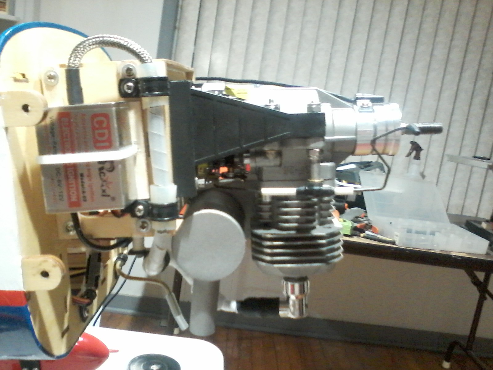

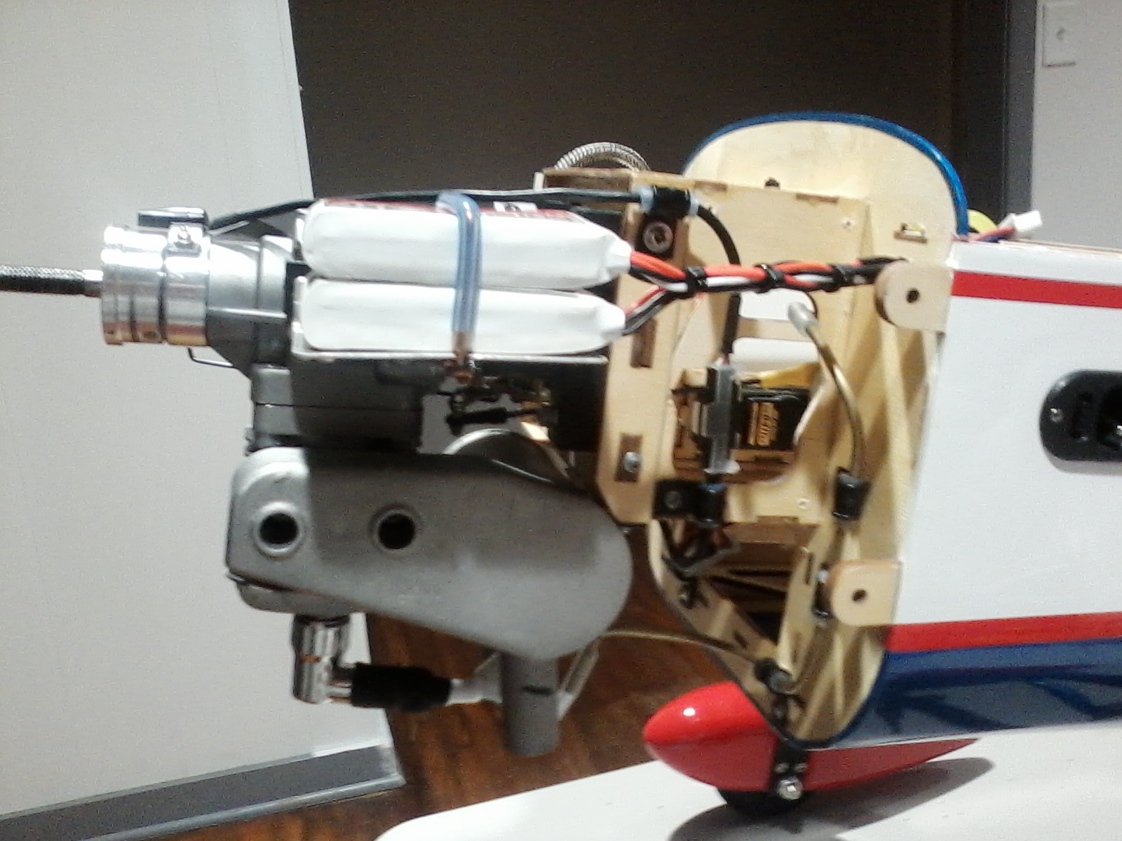

) and got down to 5% so I think it is DONE. My BAD. The Extra's DL50 ran awesome in the driveway but went to fly it and the same issue popped up on the ground as it did in the air when I maiden a month ago. Engine leans excessively at 20/25% throttle and loses power but almost picks back up immediately at about 30/40% throttle. It actually died when I was taxing around checking prior to roll out for lift off. Sounds like an air leak but I suspect the check valve just before the HS jet nozzle to be faulty or something keeping it from properly seating at all throttle positions. There was a whole bunch of metal shavings, dirt particles and crud when I dismantled it. I may have damaged the check valve m
y self when I shot carb cleaner in to the HS jet but I doubt it because the problem in performance was pre-existing. Going to put a new carb on it but man I just need to throw down and get a DA50 and be DONE. Getting tired of not being able to post in that other thread ya know
