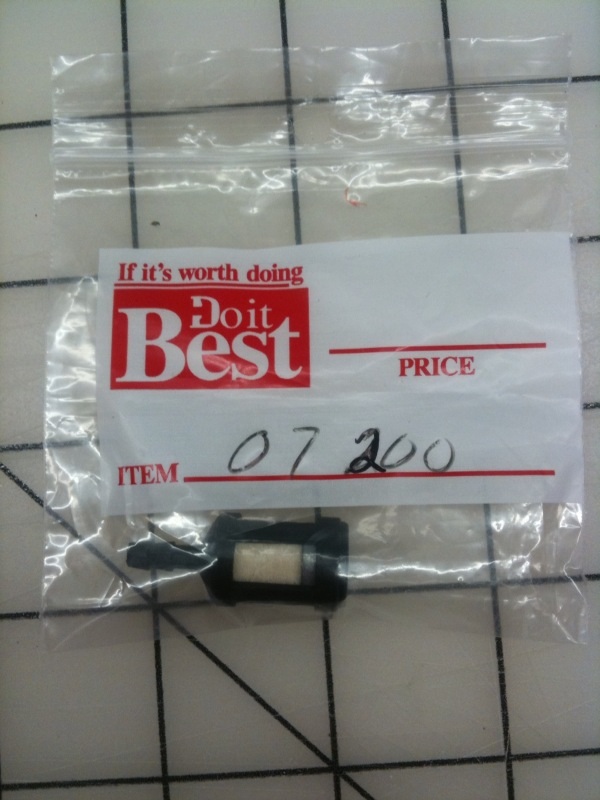

I use Fortitude style clunks in all my tanks. Never an issue. Luckily the local hardware store stocks them at $2.00 bucks a pop. Apparently they use them in chainsaws or something.
