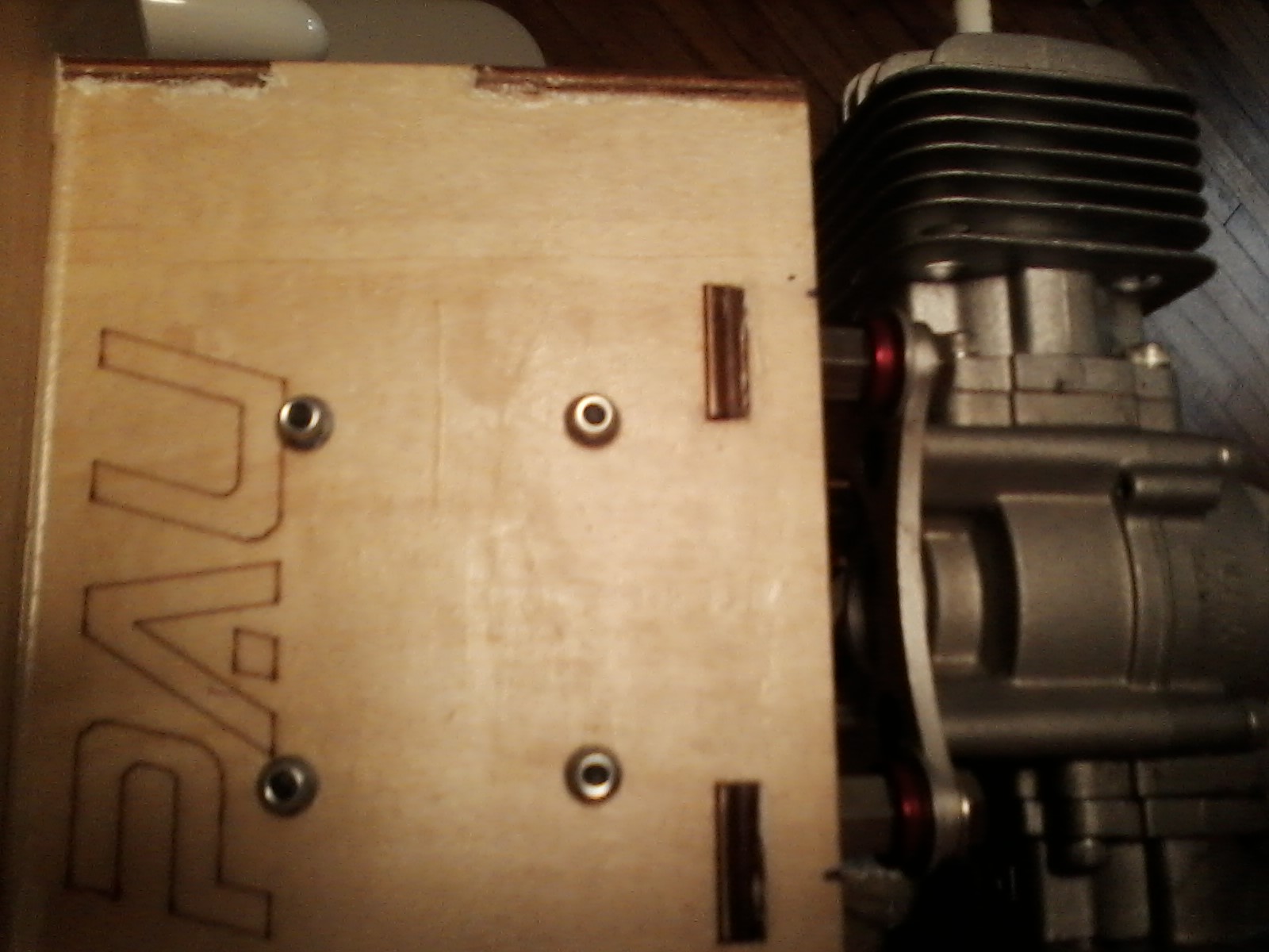

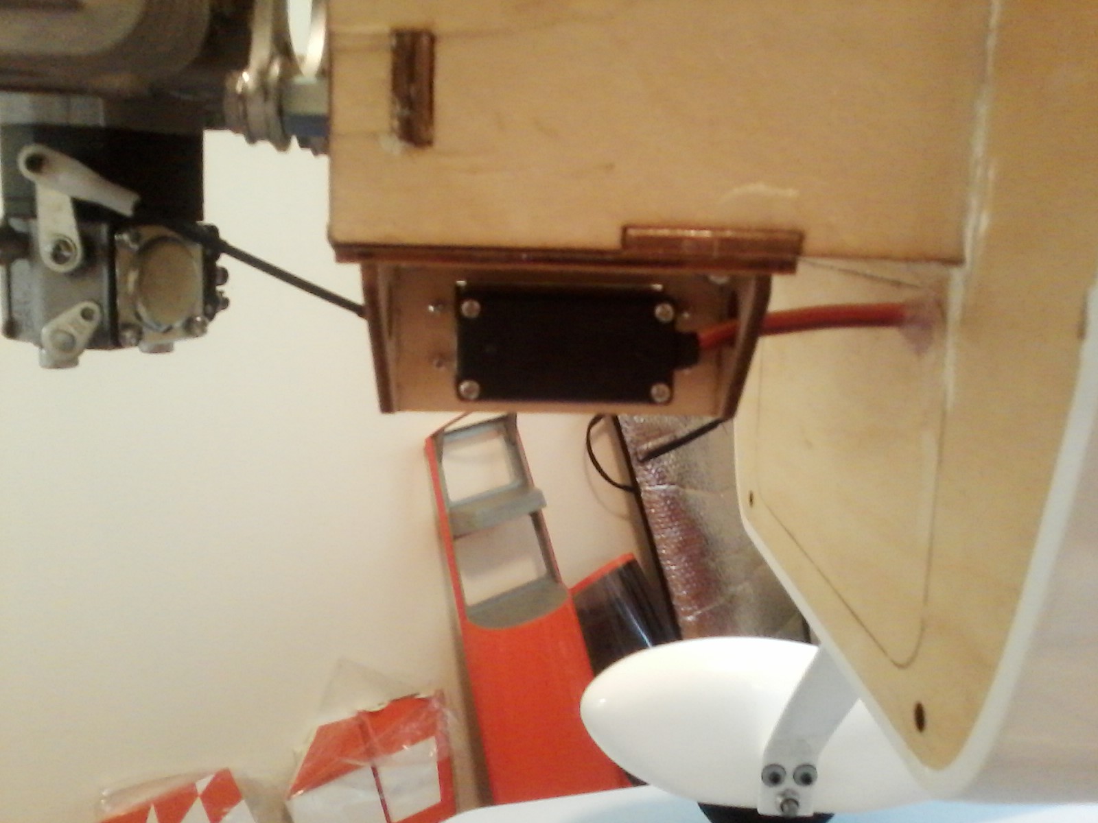

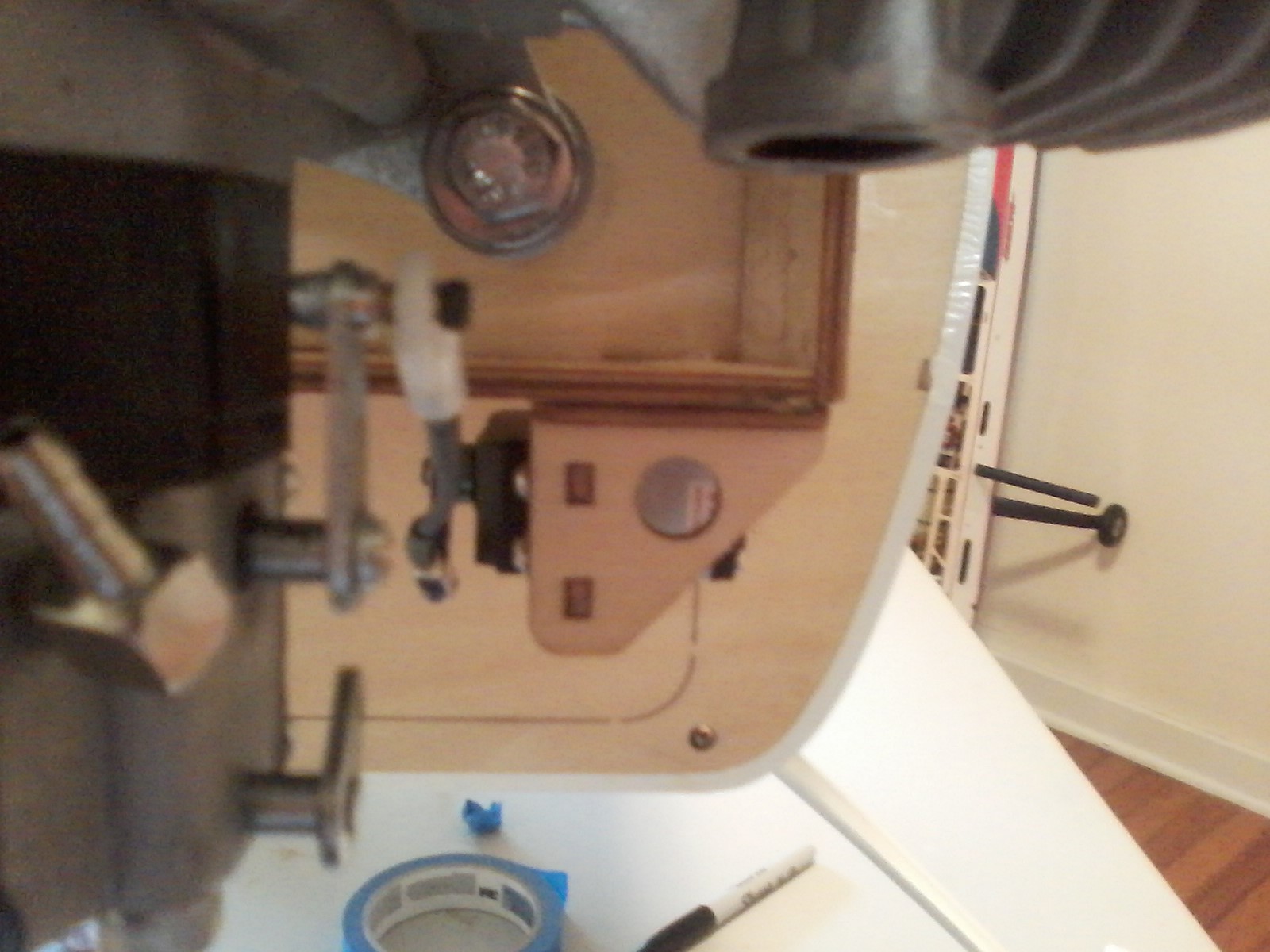

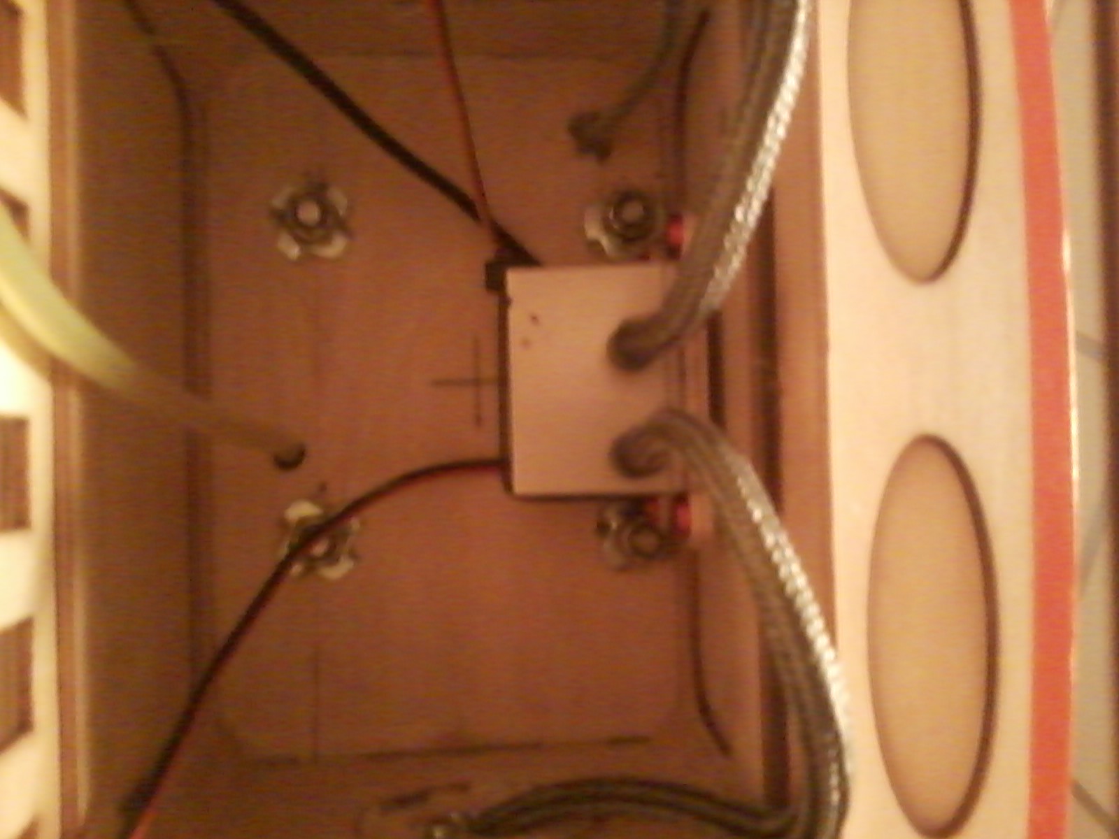

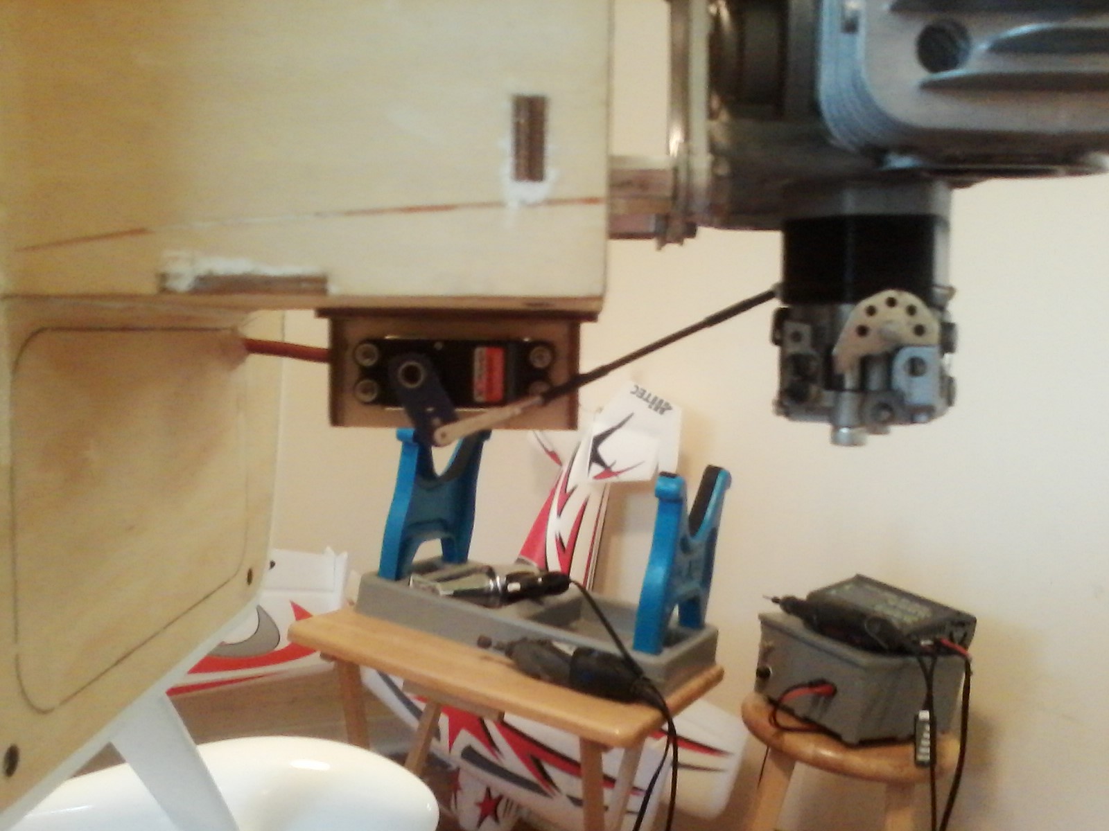

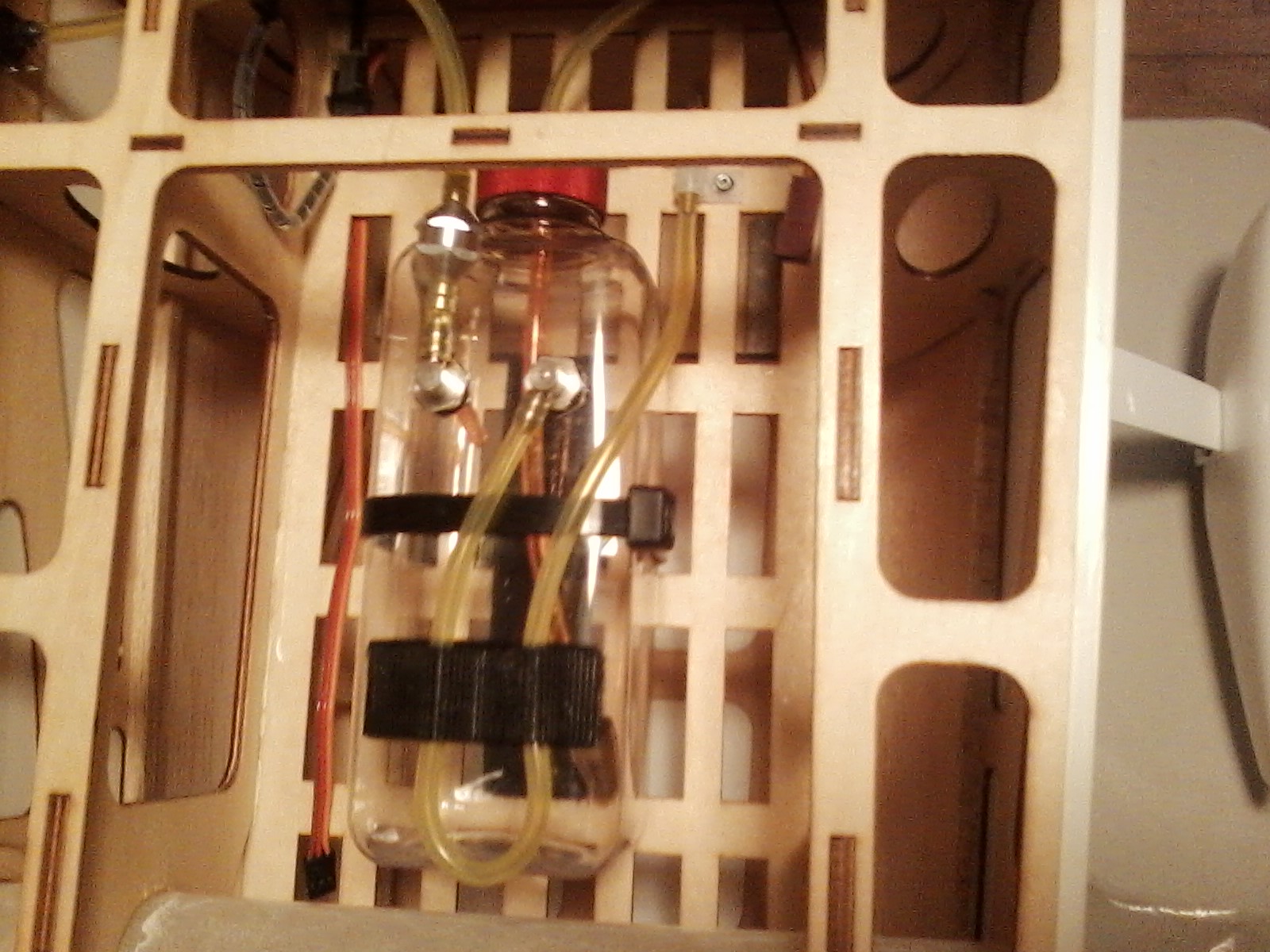

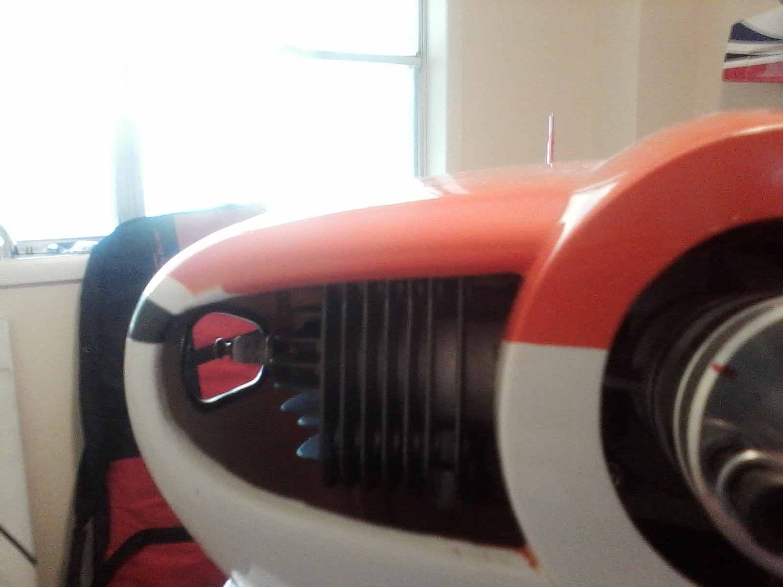

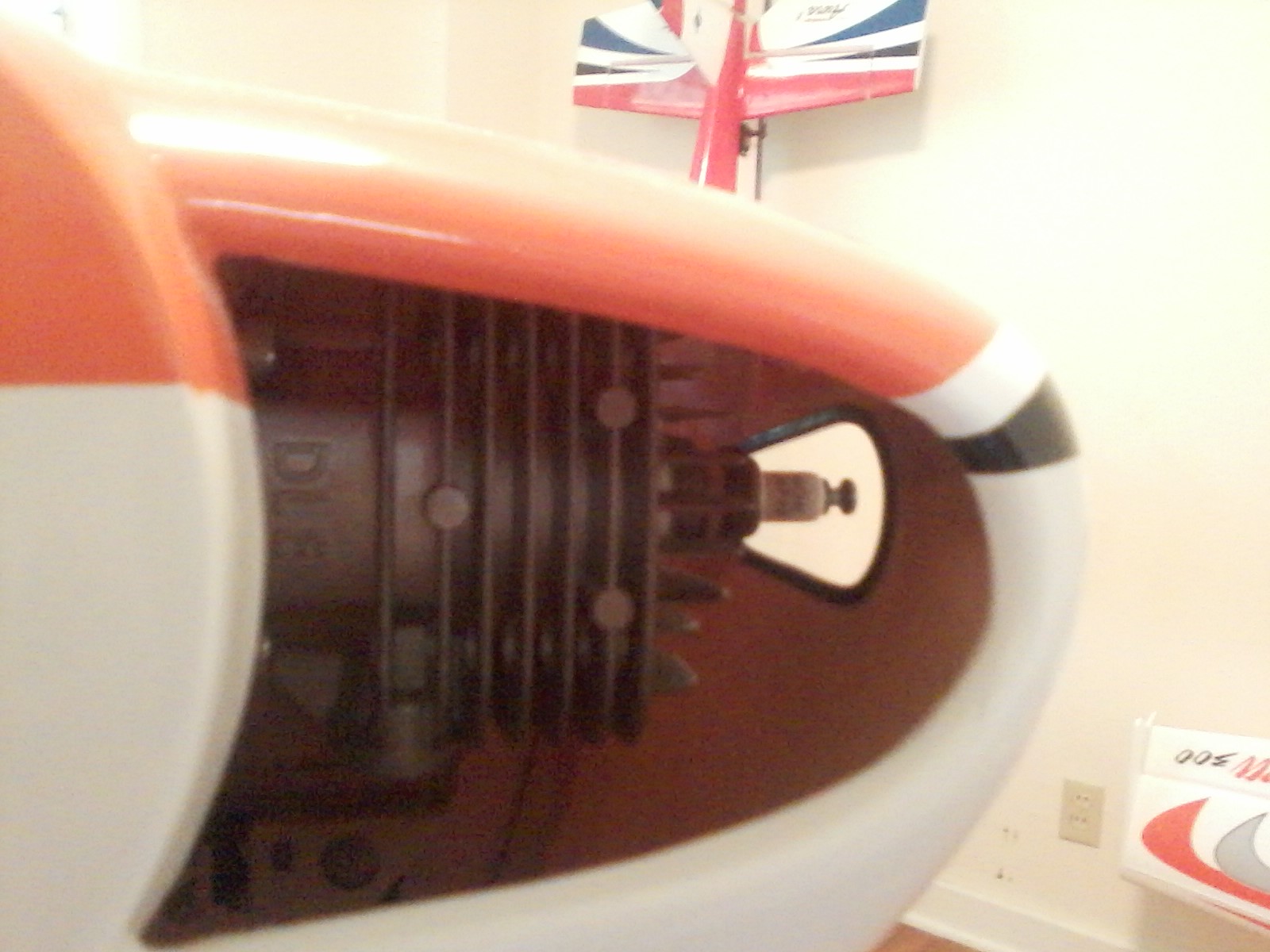

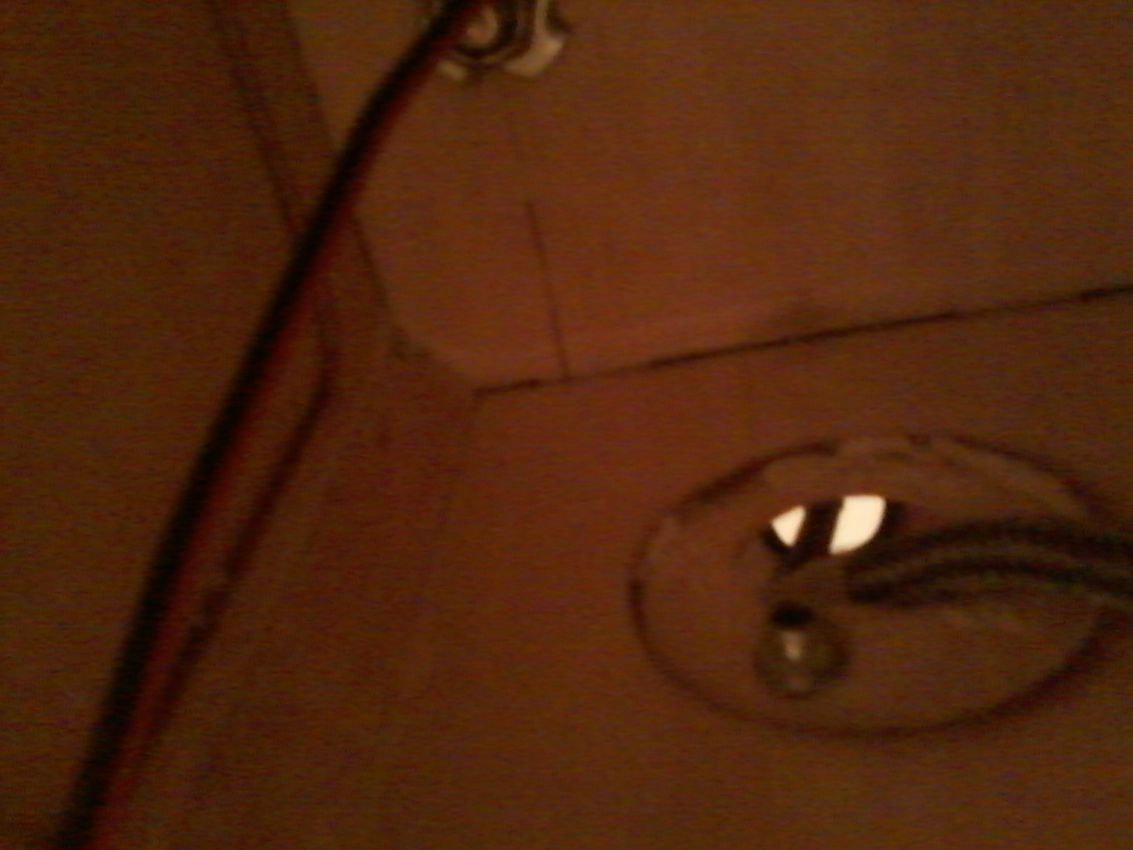

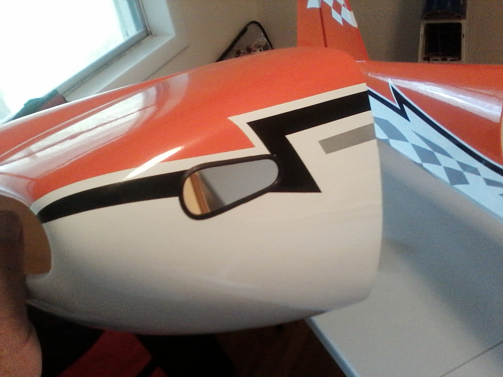

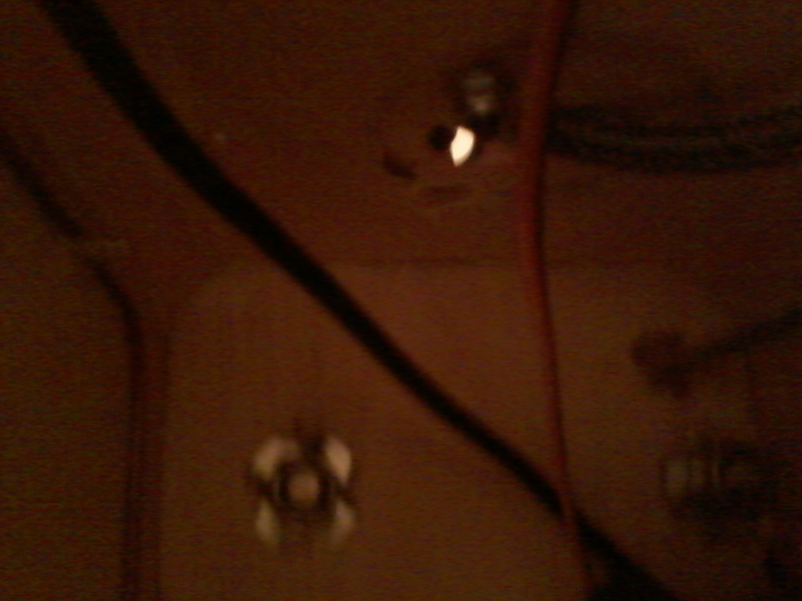

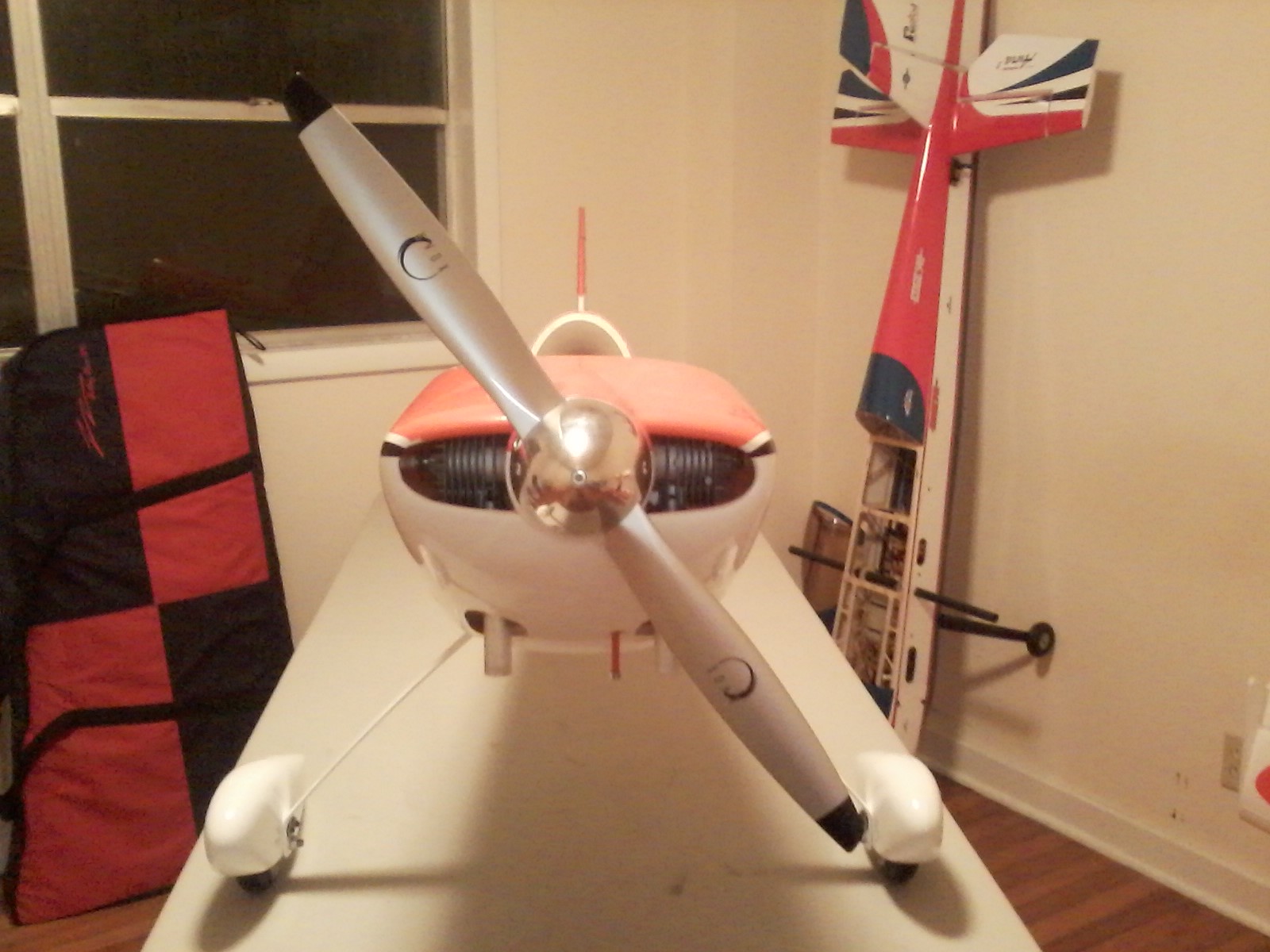

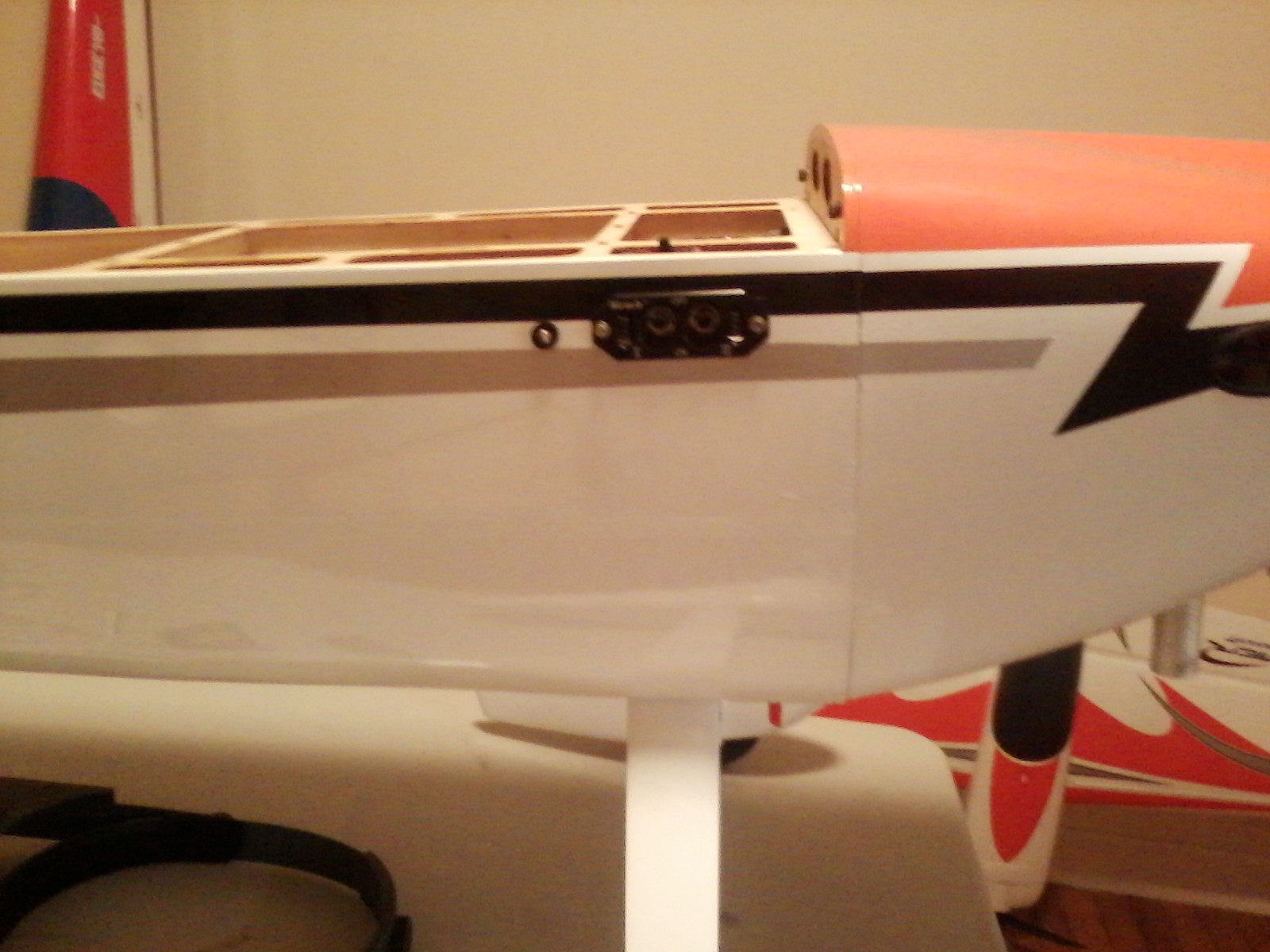

Got the throttle servo installed and centered. Got the plug cap reliefs done.

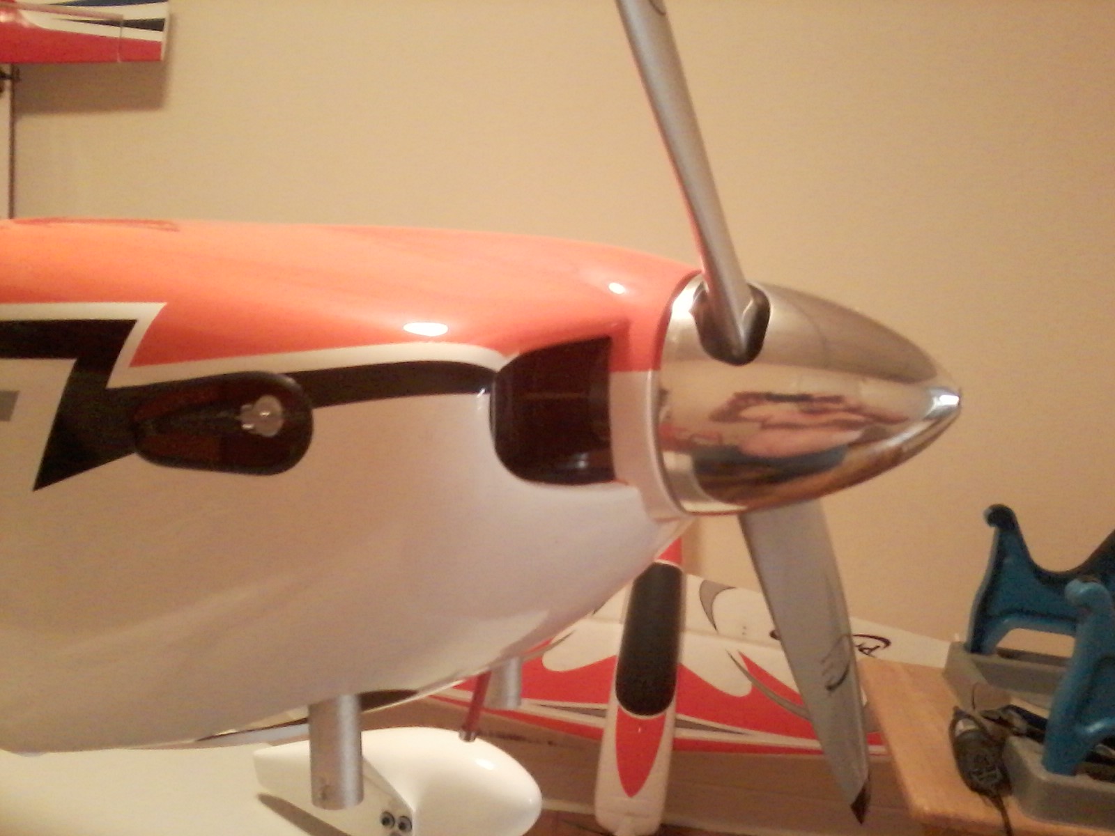

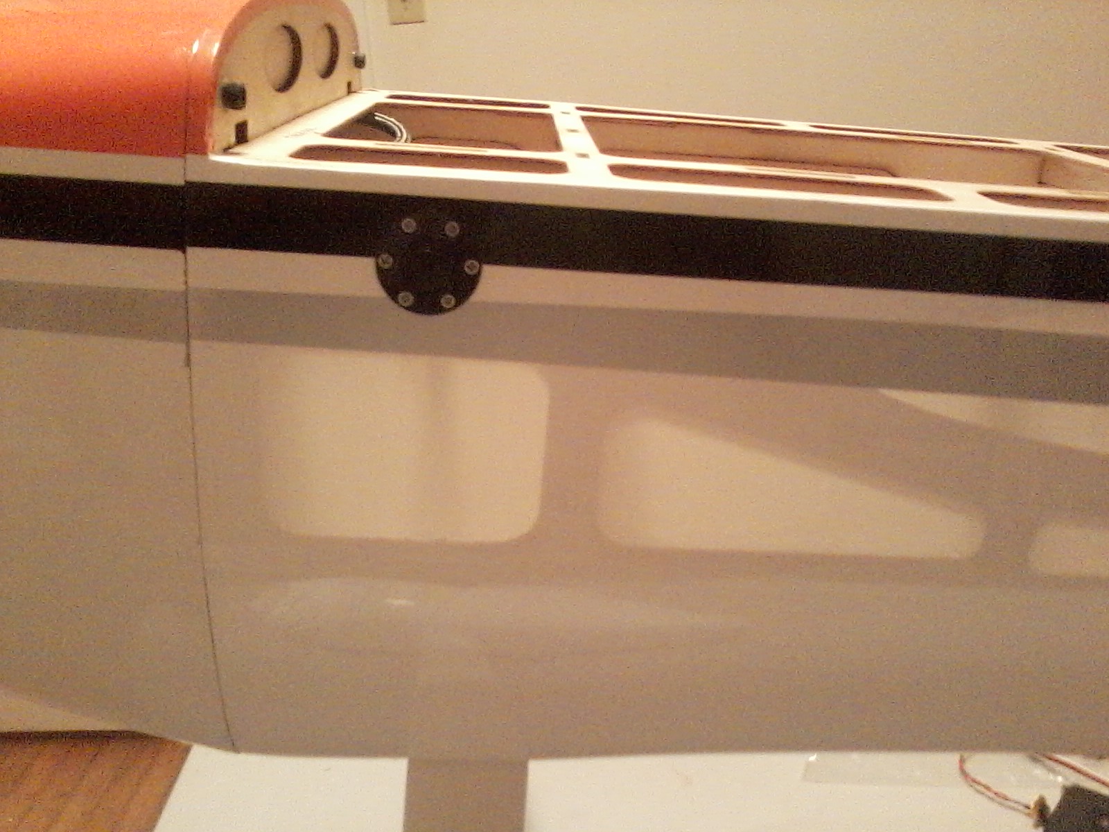

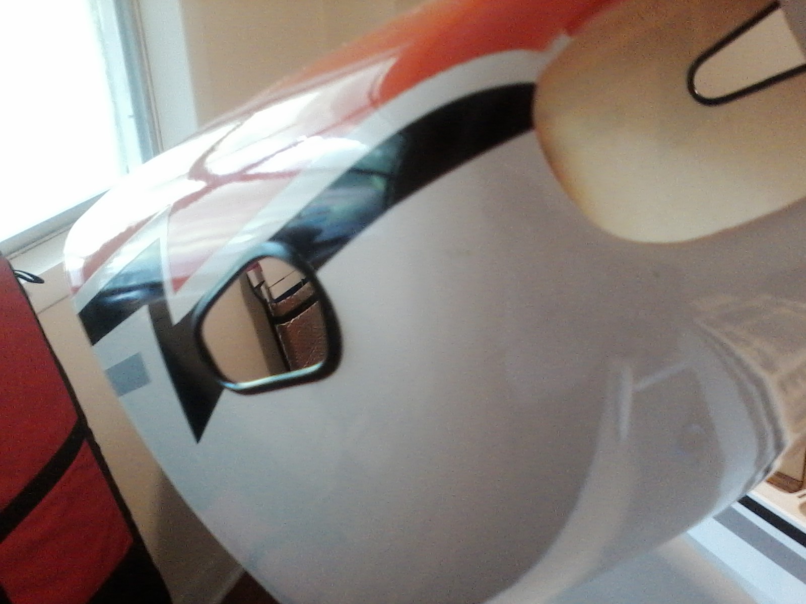

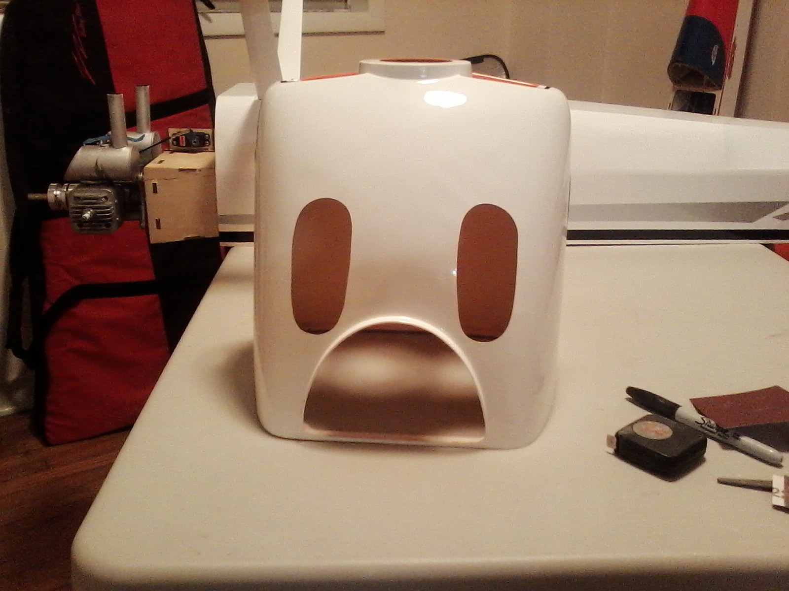

Was a wee bit off on the right side but close enough. Muffler cut outs and cooling cut outs next in line. Will do some simple cooling ducts with the foam stuff. Ordered some more 1/8" and 1/4" u-trim and some ZAP 560 for the canopy. Trying to decide if the canopy gets a bunch of those small black (2mm) button hex cap screws or not. I decided not to do the optional "inspection" see through plates as IMO they weaken the fuse structure.

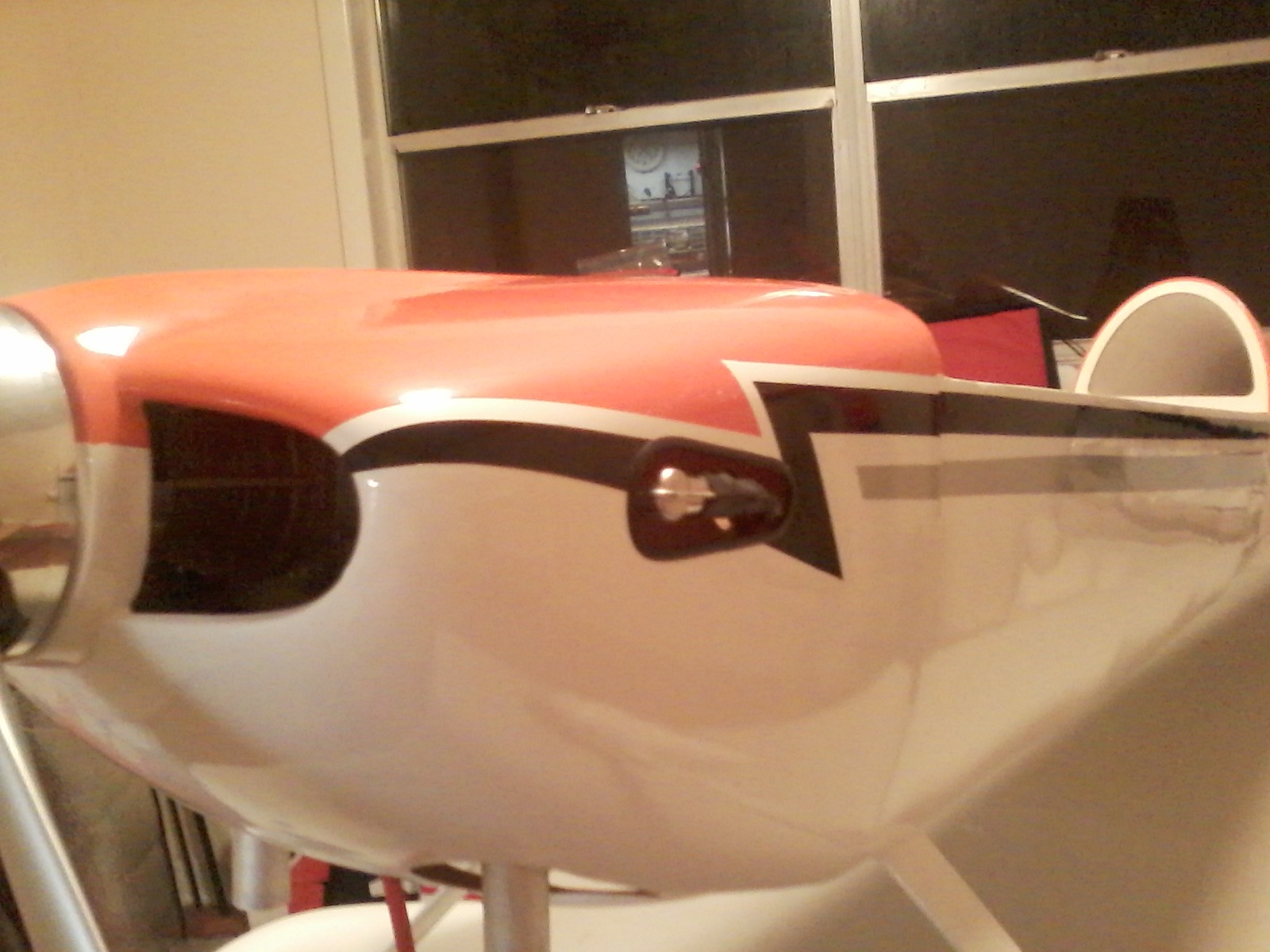

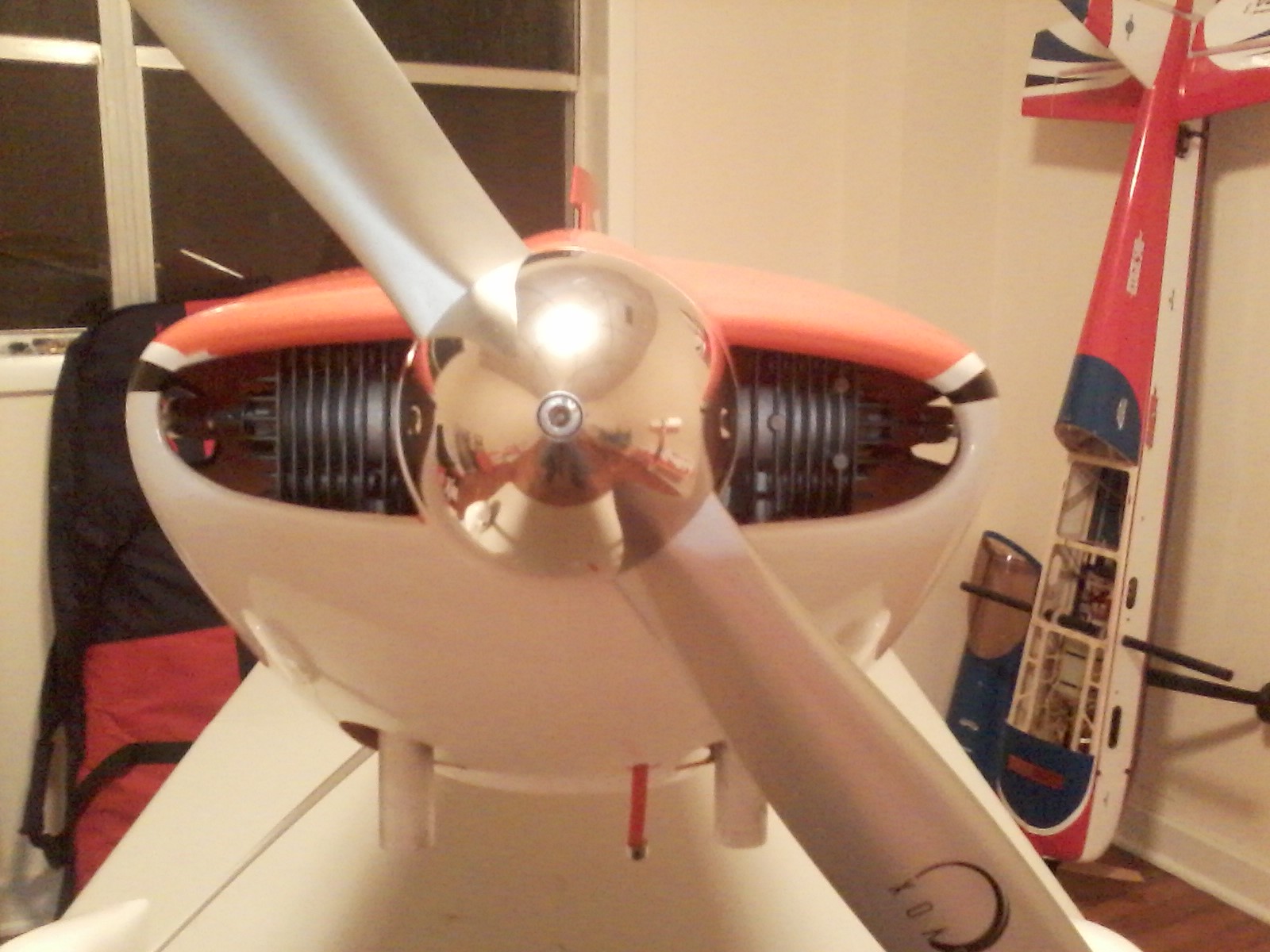

.... and checking my progress

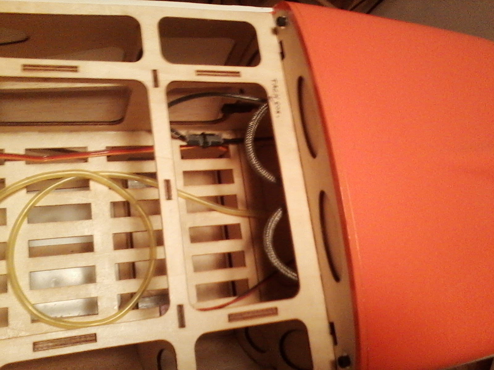

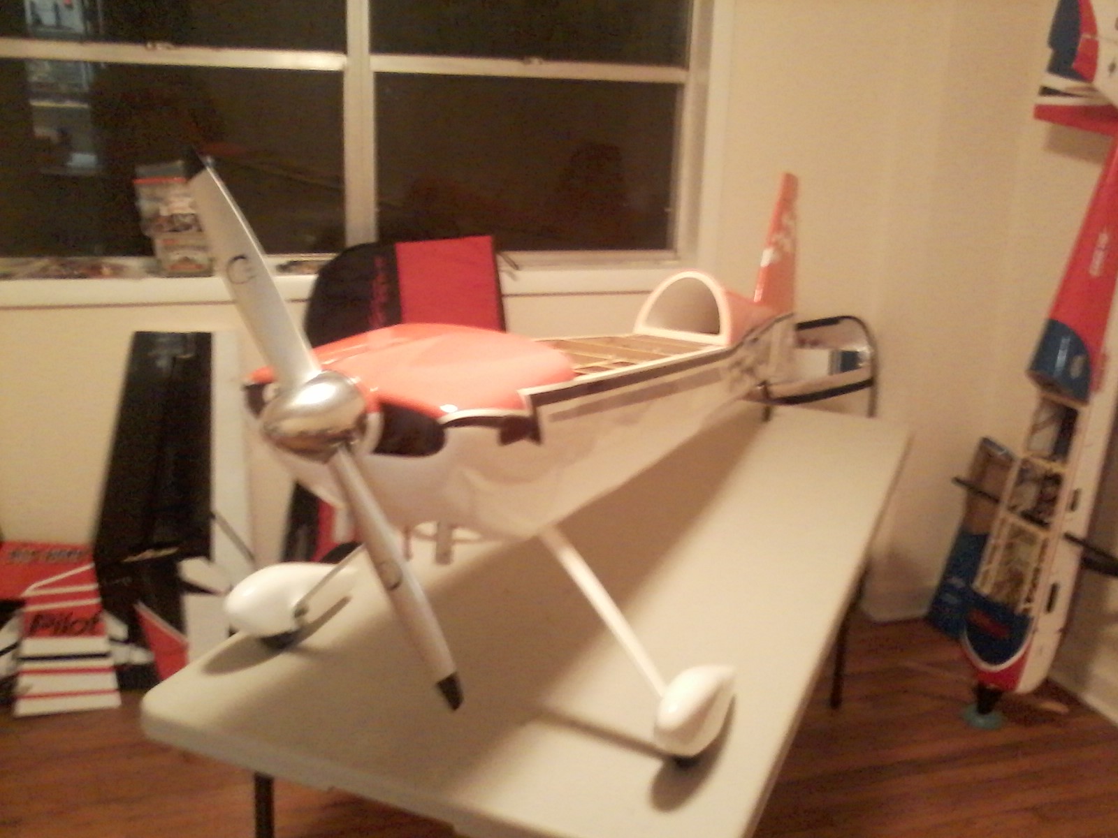

. Guess I am an addict....Just had to get everything under the hood DONE
