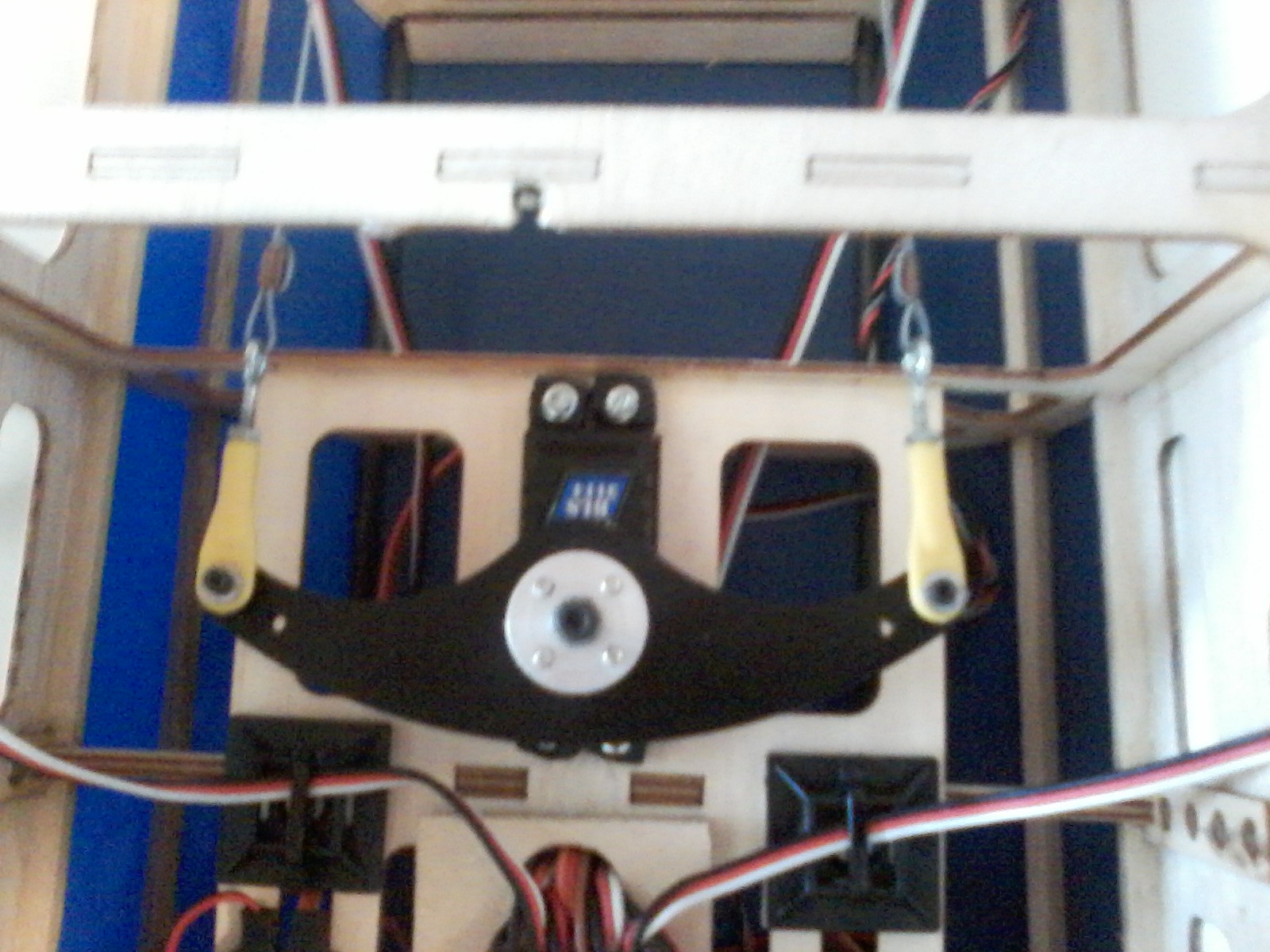

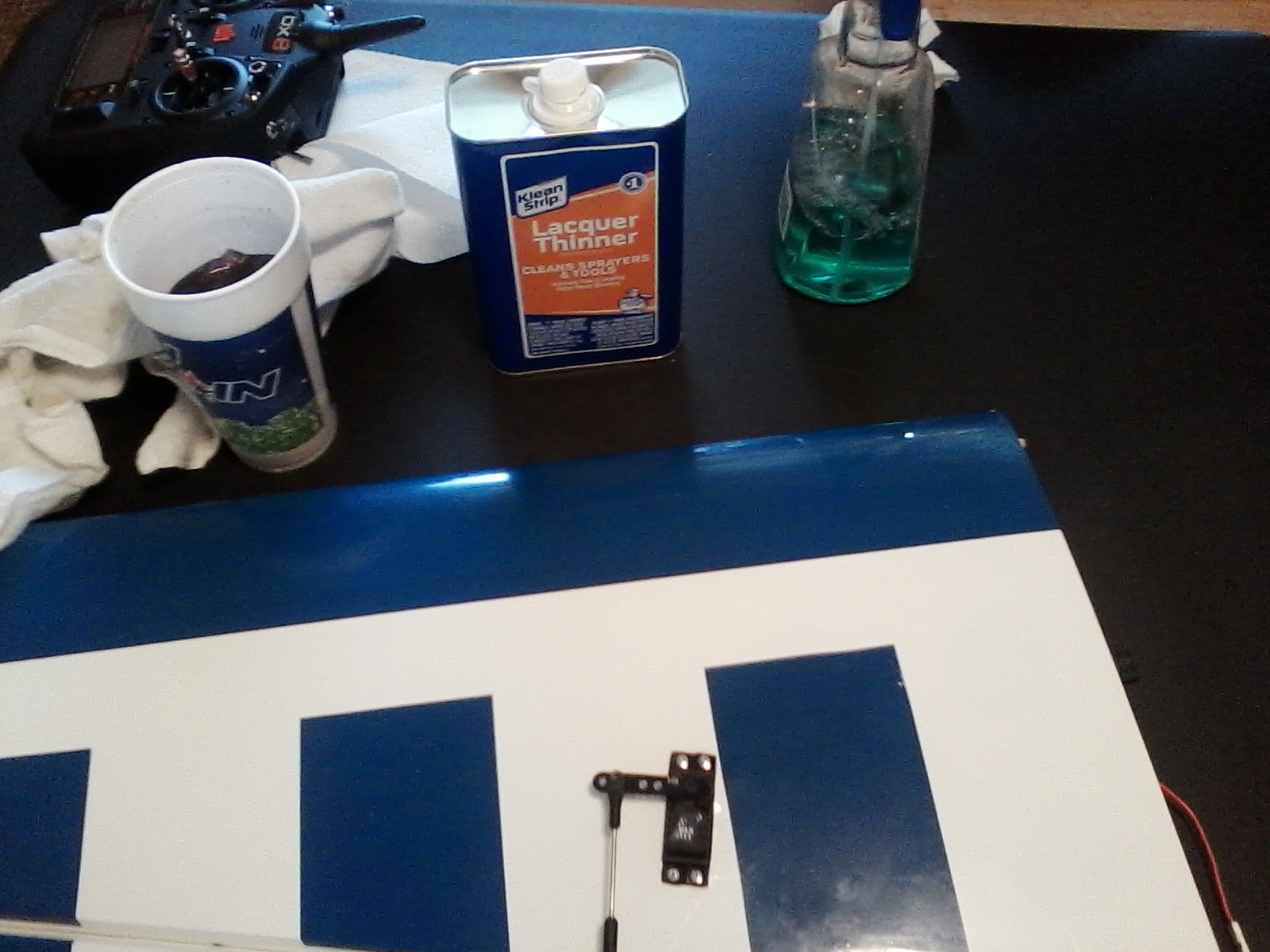

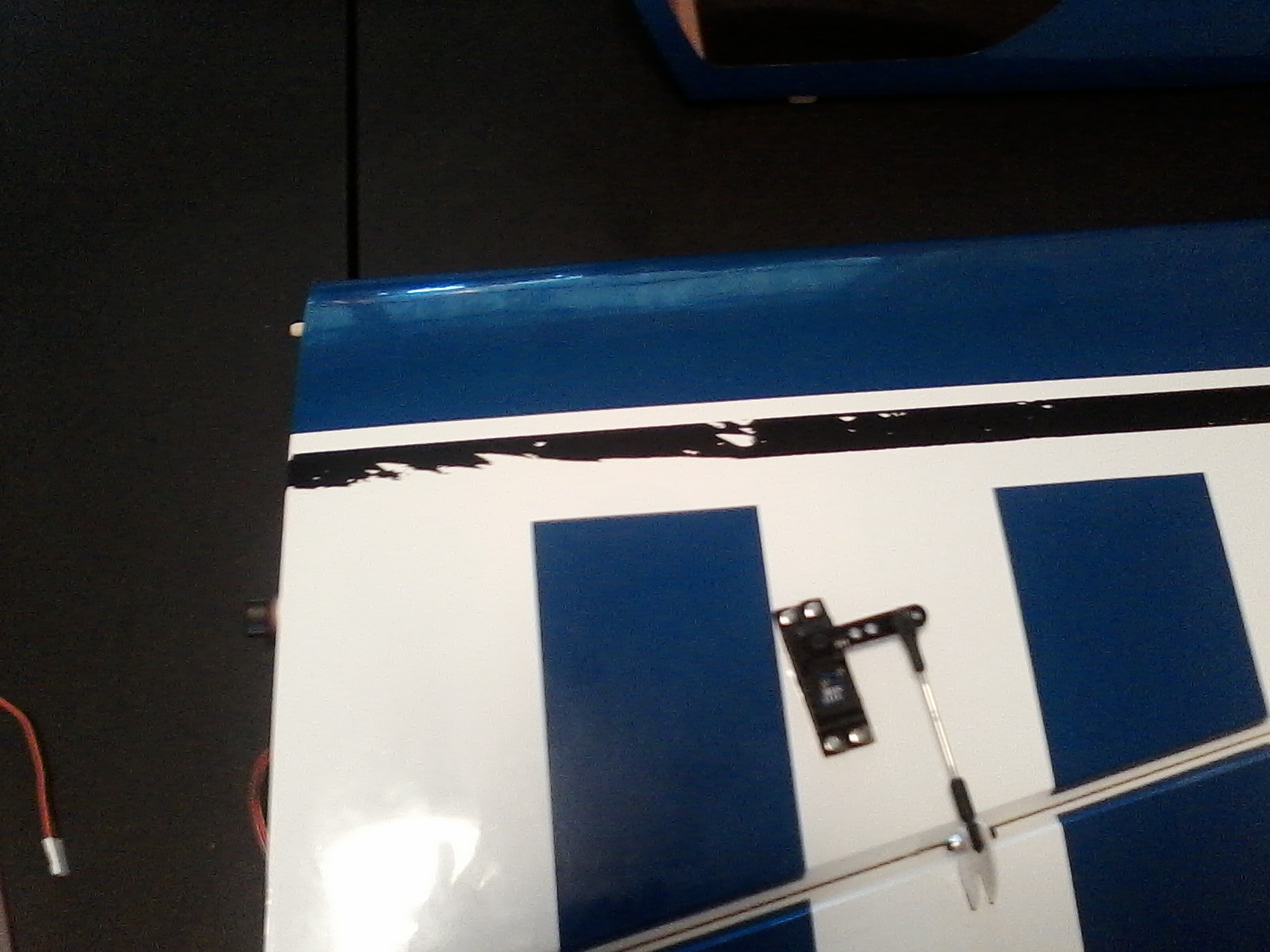

Just been going over my HUGE 26cc tiny plane :p. Replaced the servos with HV blue birds and made a new Pull Pull arm with the metal servo wheels I got. The black striping in the scheme had the mylar separate so I got some lacquer thinner to get the black off the white covering.

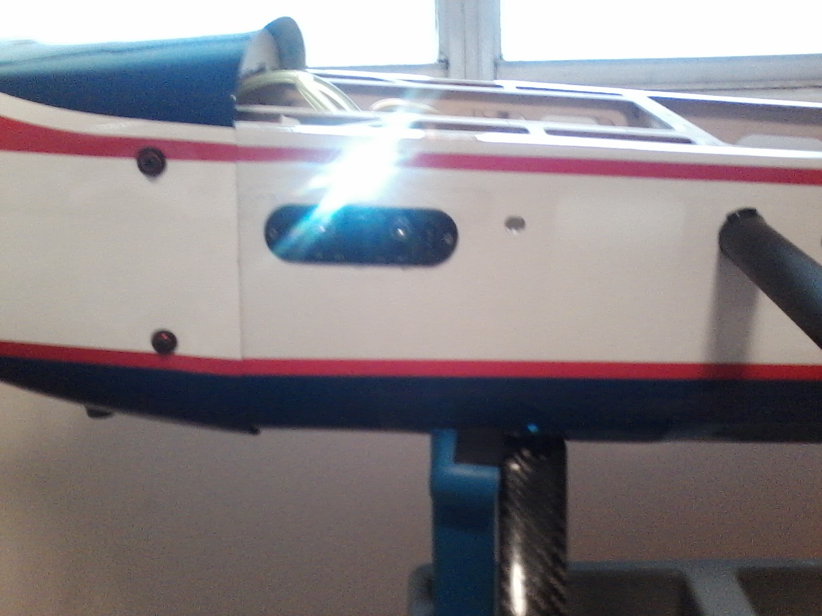

Also installed a bright LED on the RcExcel ignition cut off switch.
