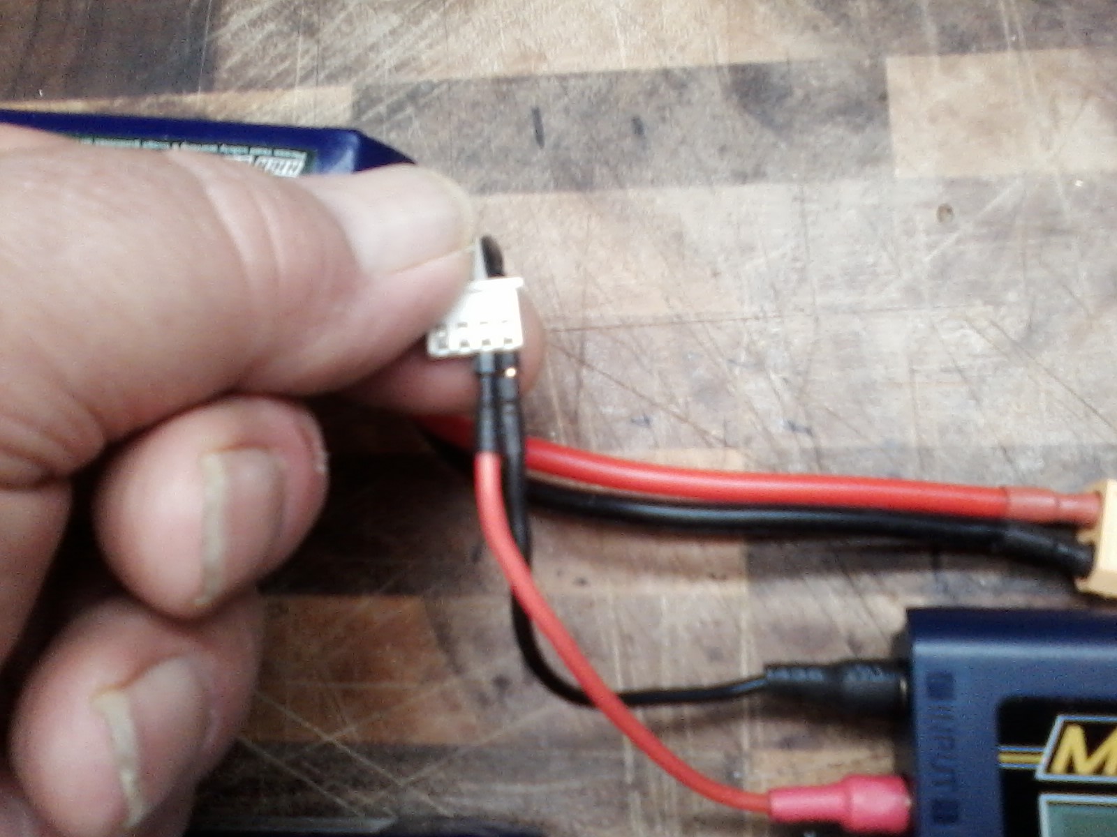

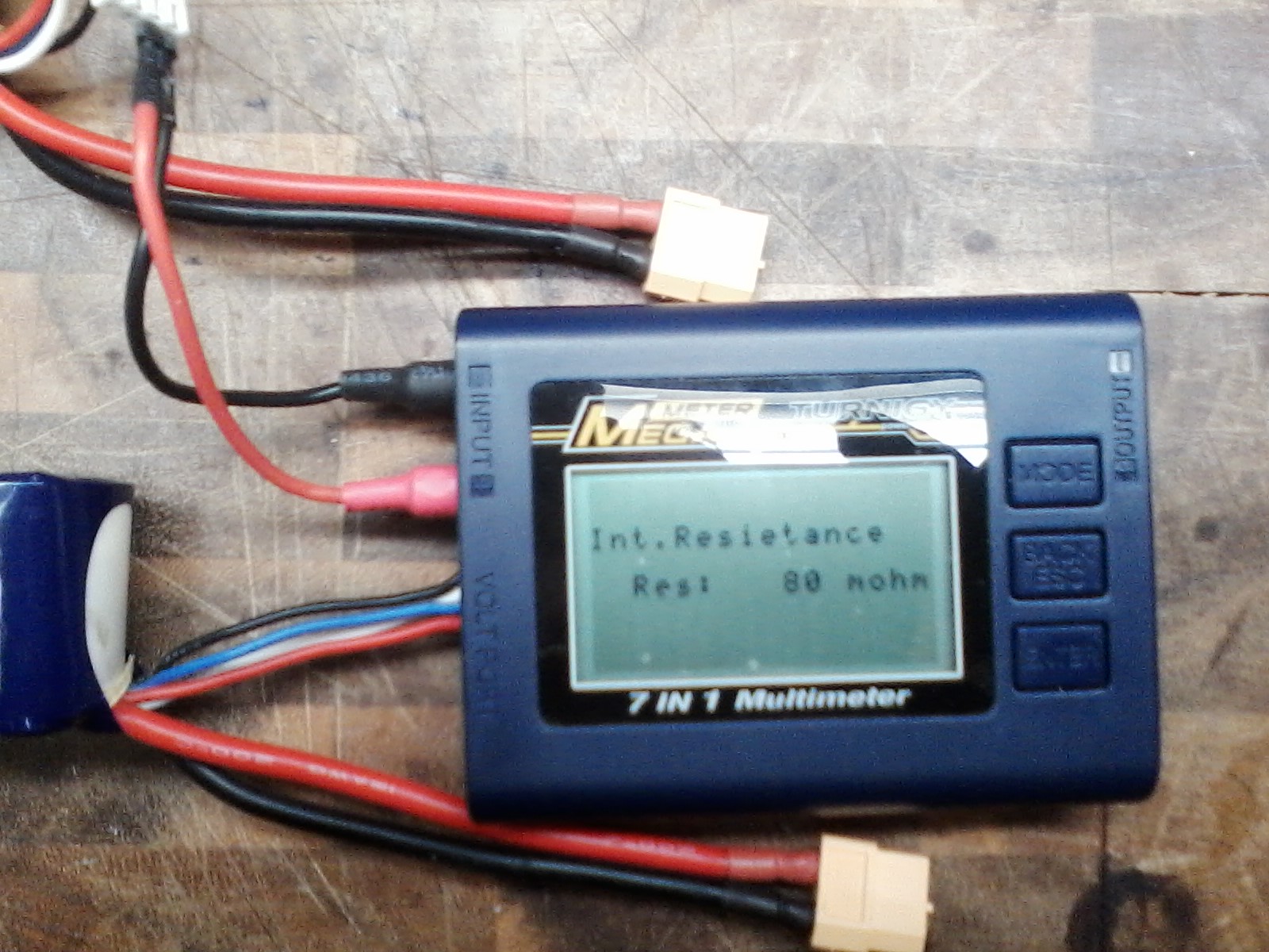

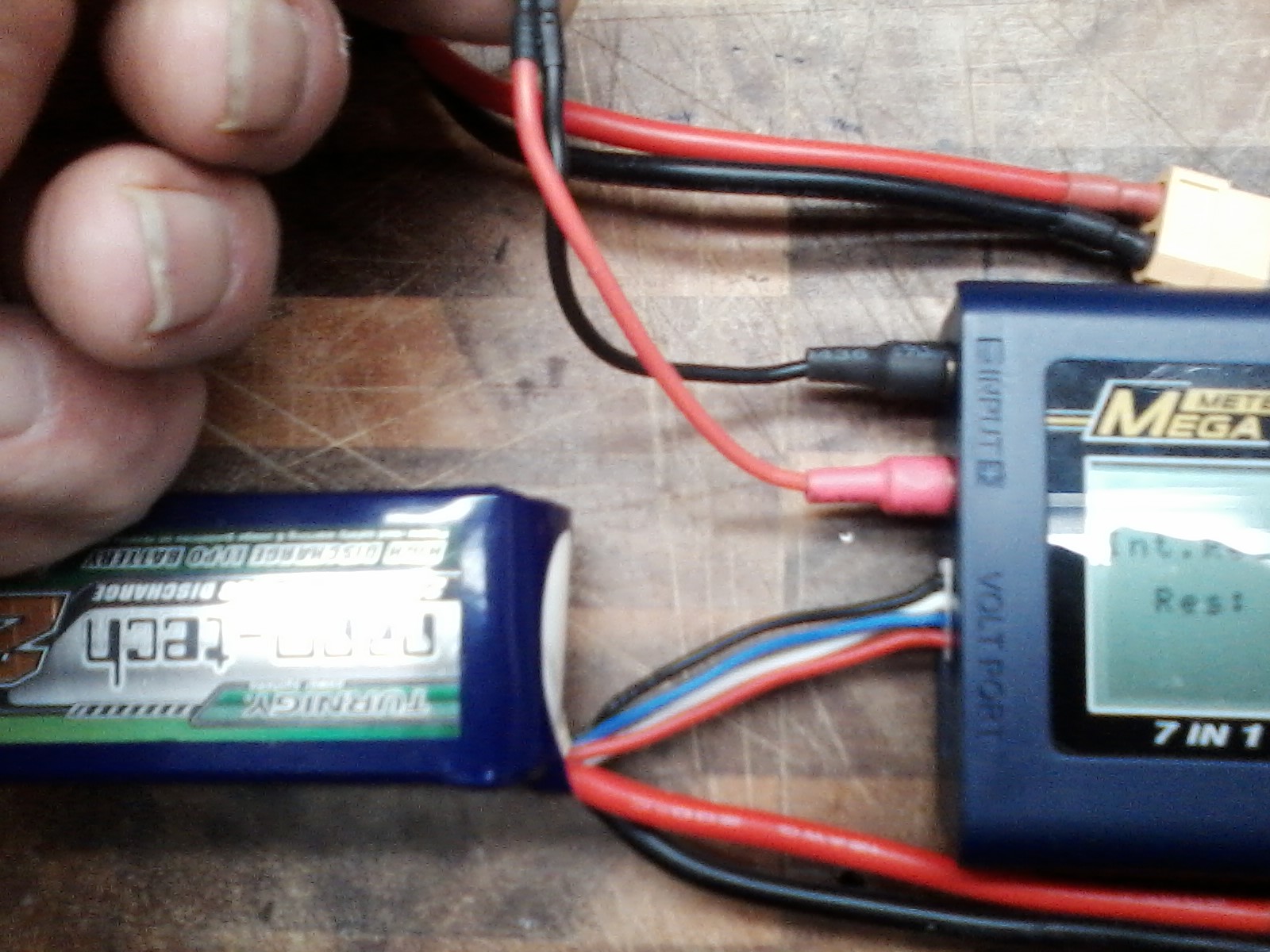

I have always wanted to know what value in Ohms each cell should have or "not go below" before condemning the cell. I got this meter and finally found how to check internal resistance but it only will do the first cell in the pack. You have to plug a same number of cells pack in to the voltage port and use the pin adapter plug that's plugged in to the main battery input. This is one of those 7in1 meters.
It is great at checking the balance state and voltage on each cell but I don't know about the internal resistance feature.
It read 80 mOhms for the 1st cell......The batteries shown I purchased in Dec 2015 and have about 25 cycles on each. I fly the QQ300 with them. They both are still "hard bricks" with not the first sign of swelling. I always store them between 50/60% charged. I have always figured the number of cycles I have put on a pack before considering replacing it. My safe cycle limit is 250 times on any brand Lipo.

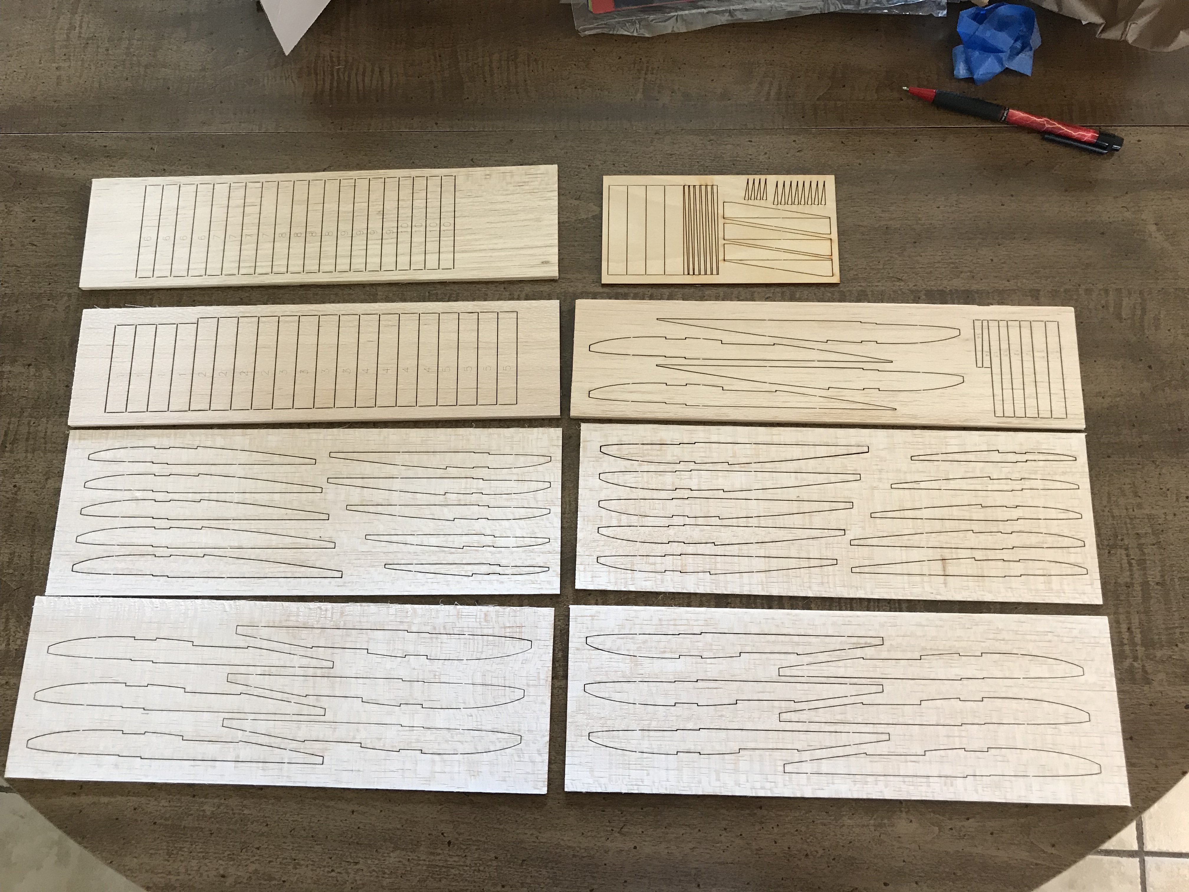

Received a new short kit today. From mountain models for the Allegro RES glider. Really nice looking short kit for what it is. Laser cutting appears to be top quality. Just throwing it out there for everyone to go give the mountain models site a look over. The owner is trying to sell the buisness and if he can’t find a buyer he will be closing up shop. Might be worth it to see if there is anything you want before it’s gone.

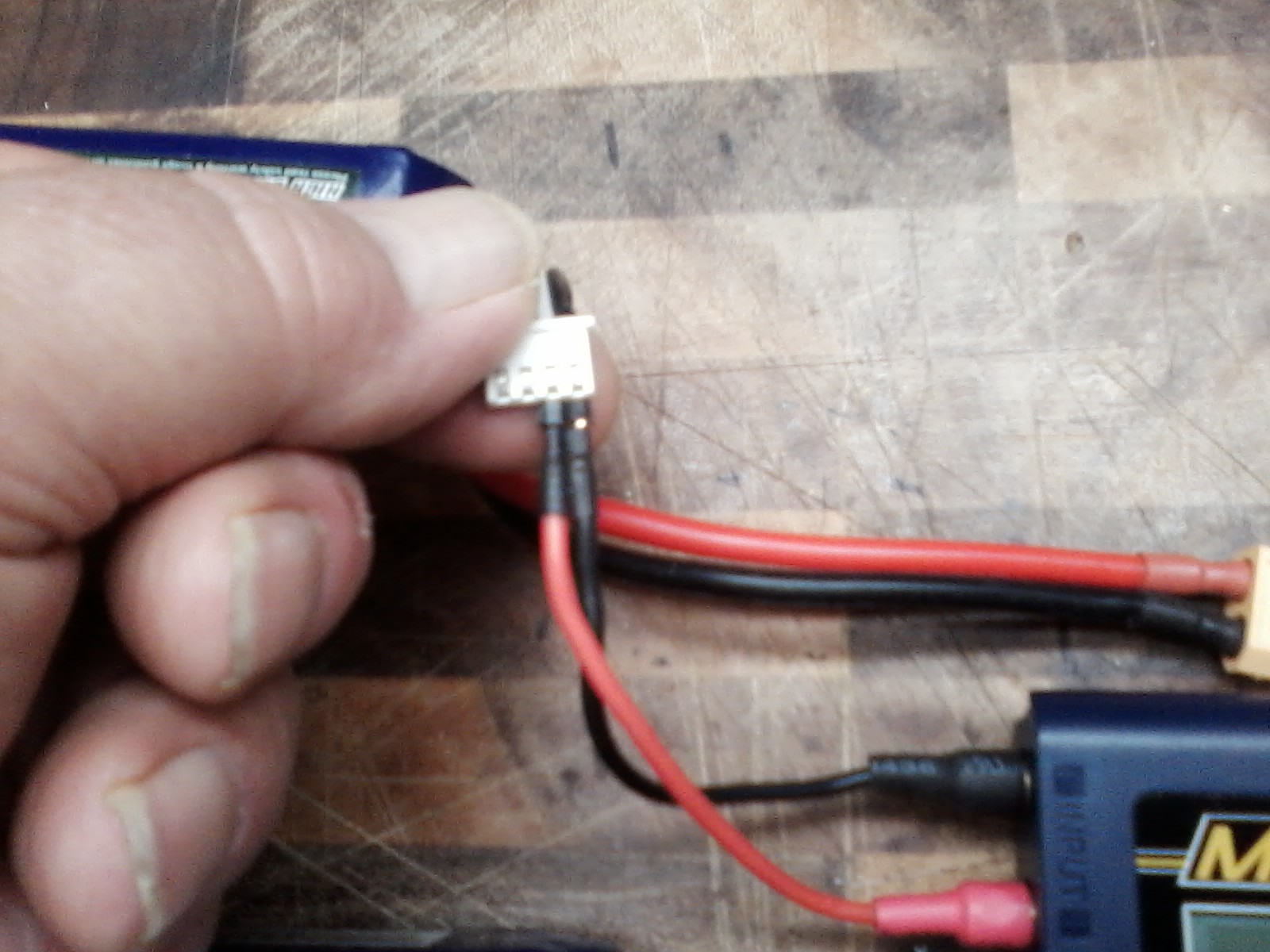

It read 80 mOhms for the 1st cell......The batteries shown I purchased in Dec 2015 and have about 25 cycles on each. I fly the QQ300 with them. They both are still "hard bricks" with not the first sign of swelling. I always store them between 50/60% charged. I have always figured the number of cycles I have put on a pack before considering replacing it. My safe cycle limit is 250 times on any brand Lipo.View attachment 100043 View attachment 100044 View attachment 100045
IR is a difficult thing to do and will change with the state of charge I made jig to do and it still difficult to do. Looking at what you are doing with the plug and wires you never get constant numbers to go by. I have charger that gives me the IR drop but it changes all the time while it is charging. From what I have found out the hard-way is to do it when the battery is at 3.85 volts it gives the same number 90% of the time. But if you are really interested FMA have just developed a IR meter I have been looking at it.
One Thing i do know is if you know the IR drop of your battery as complete unit you can calculate the C rating of the battery and the charge rate but I am still trying to figure that , if someone knows how to do that I would really appreciate how to do the math..
