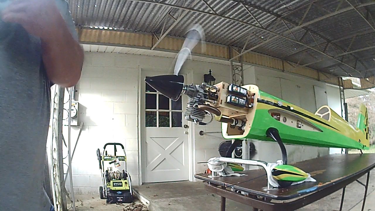

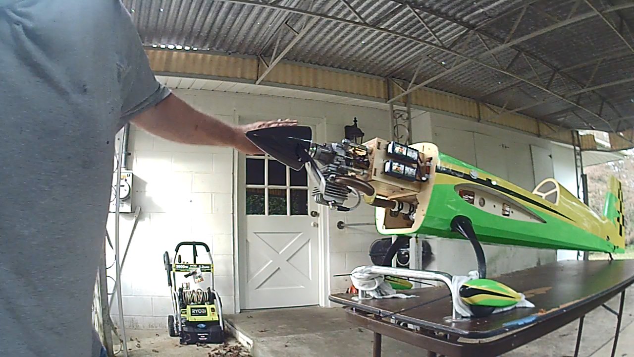

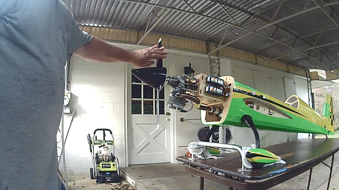

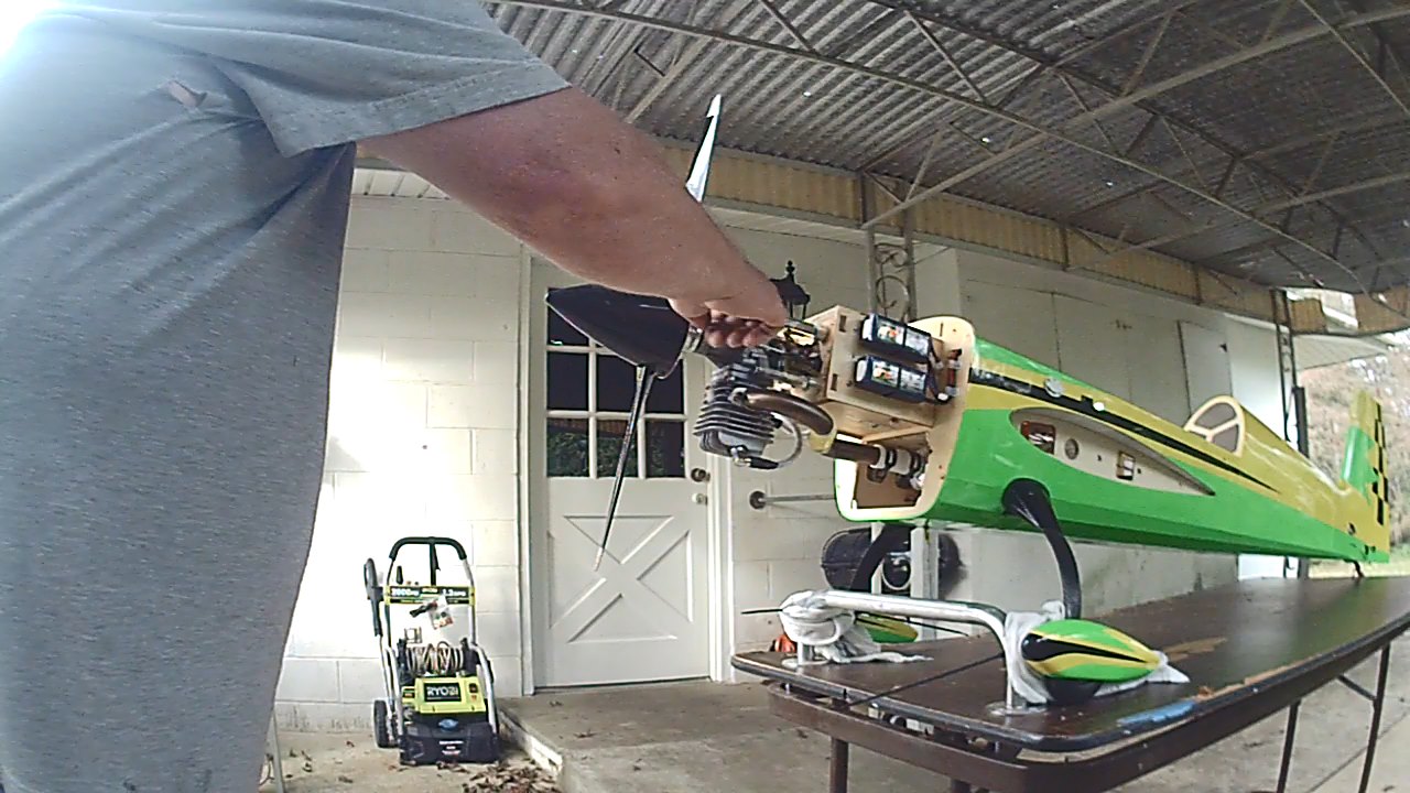

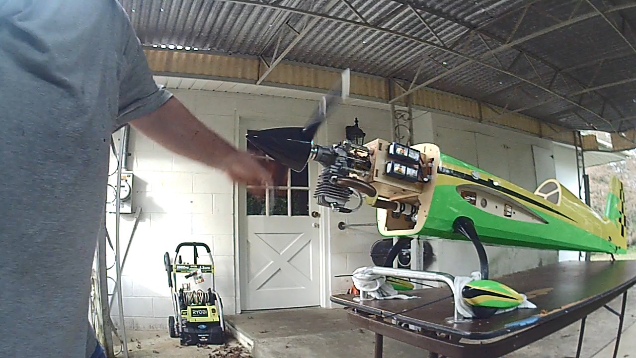

. Yep. it was really flooded BAD
. Pulled the plug and about a 1/4 teaspoon of fuel dribbled out. Hmn...

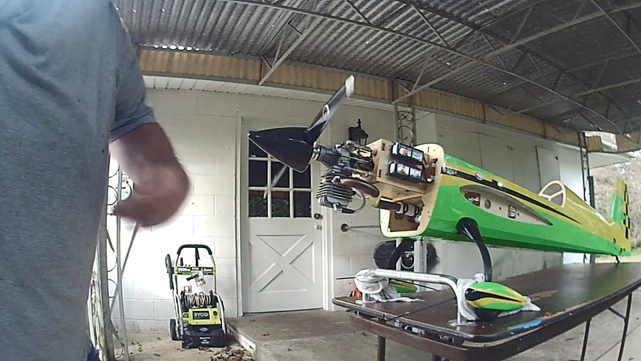

. Checked for spark and what'd ya know?
. No spark. So for the next 30 minutes I chased it down to the pick up sensor
. It had become loose inside the housing and pulled back away from the very end

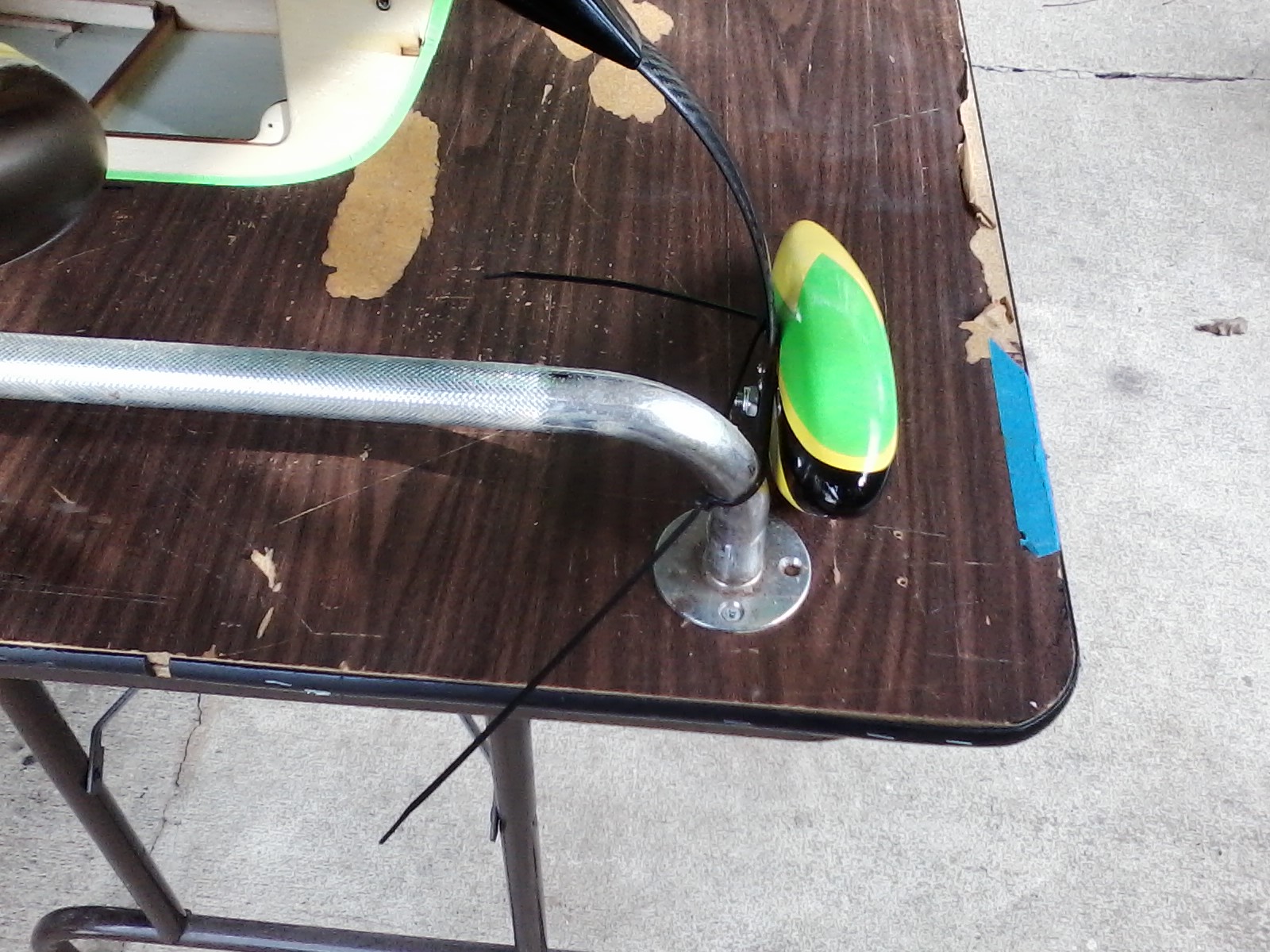

exhaust extensions??? and a good black Sharpe!
