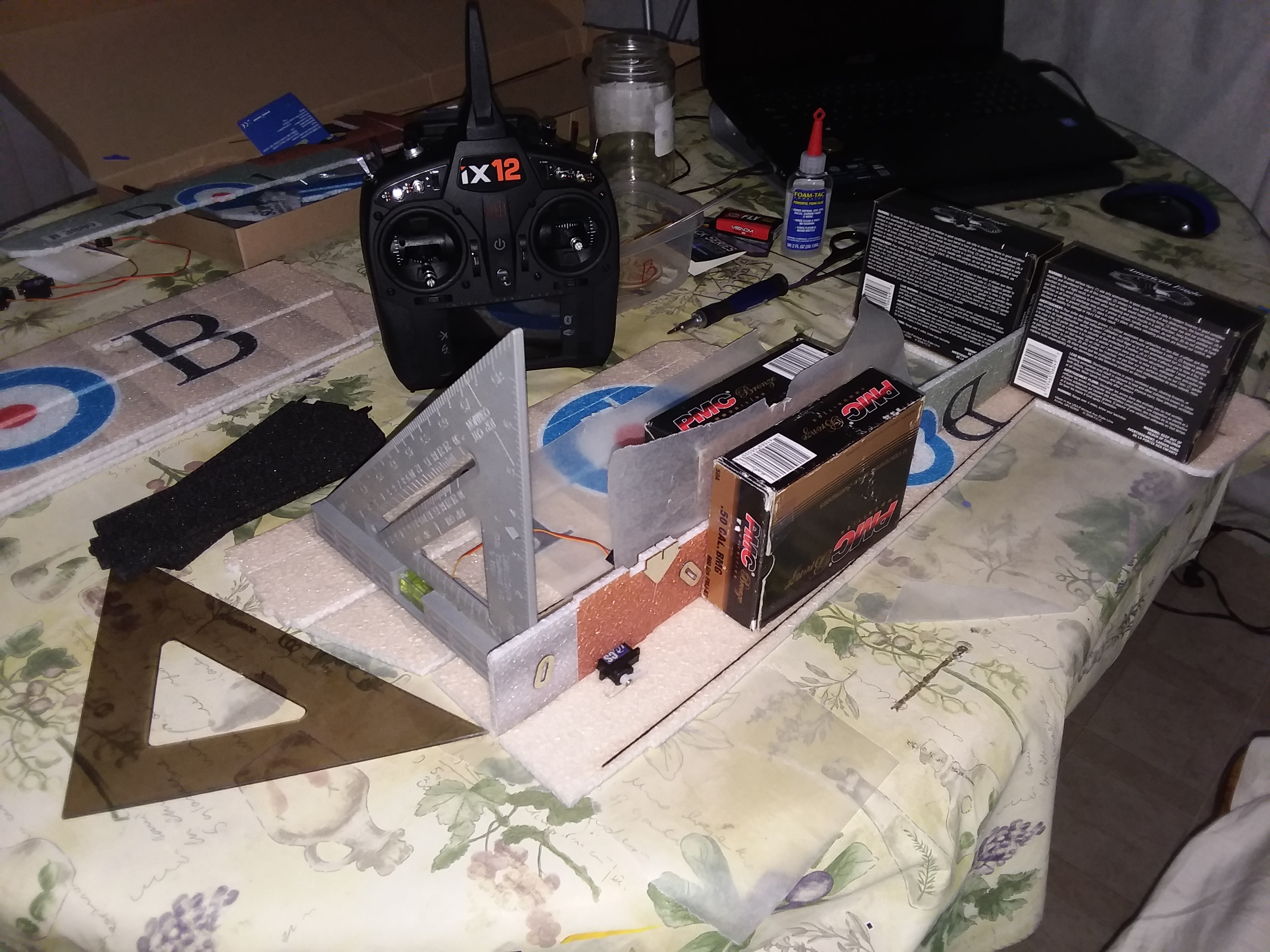

See the new XI12 I will most likely buy one when I go to the Toledo show this spring please keep us informed on the radio and is it meeting your needs and expectation.

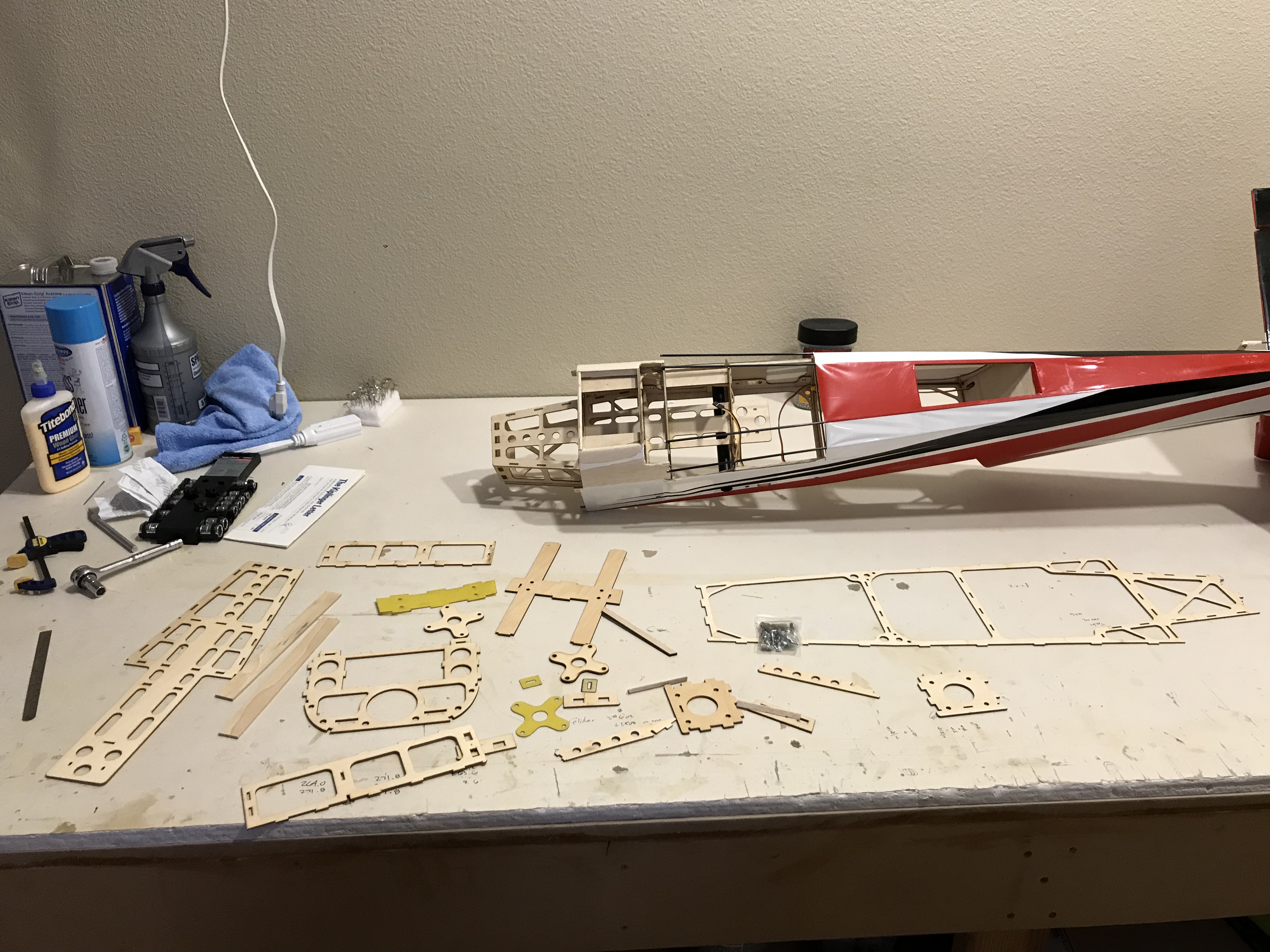

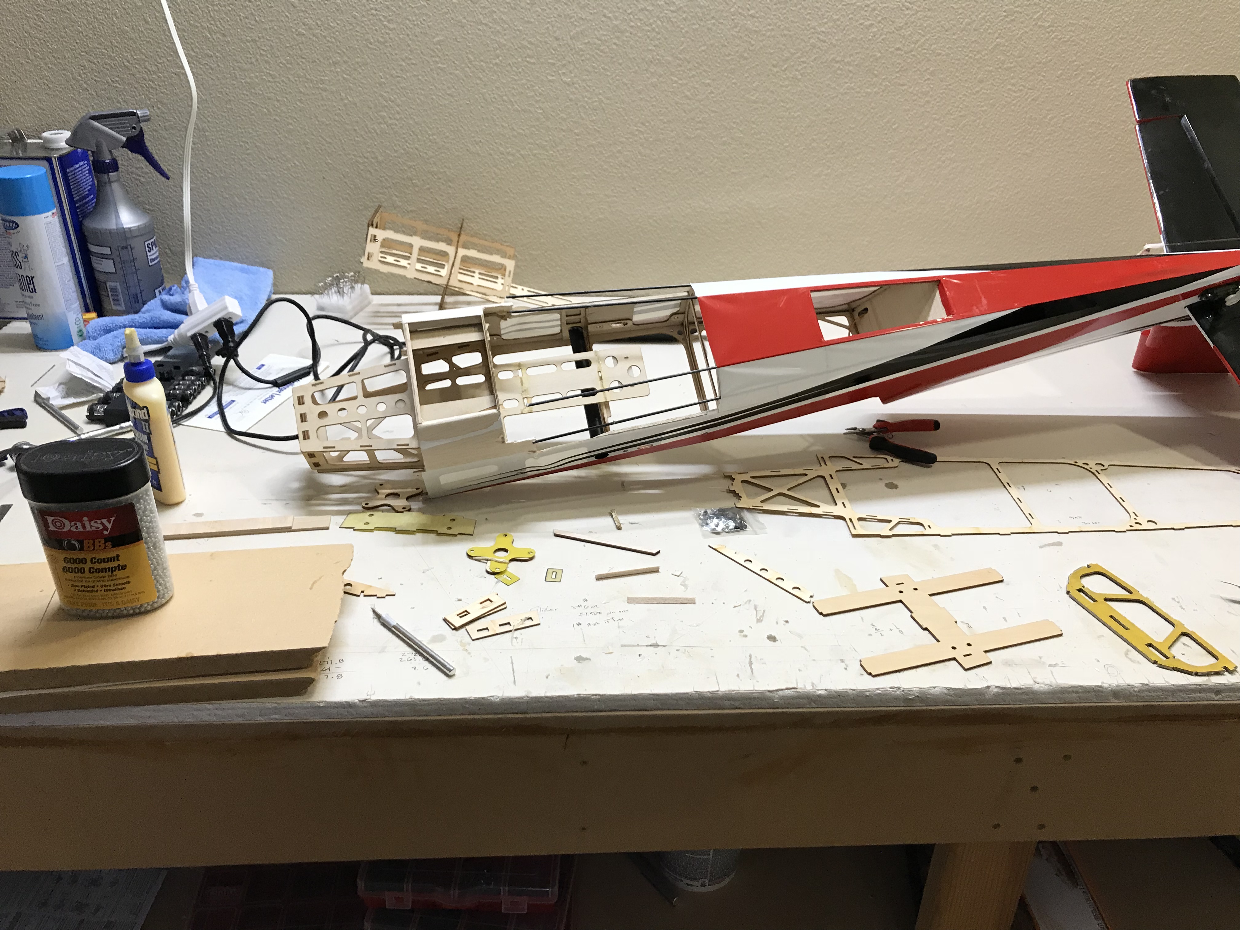

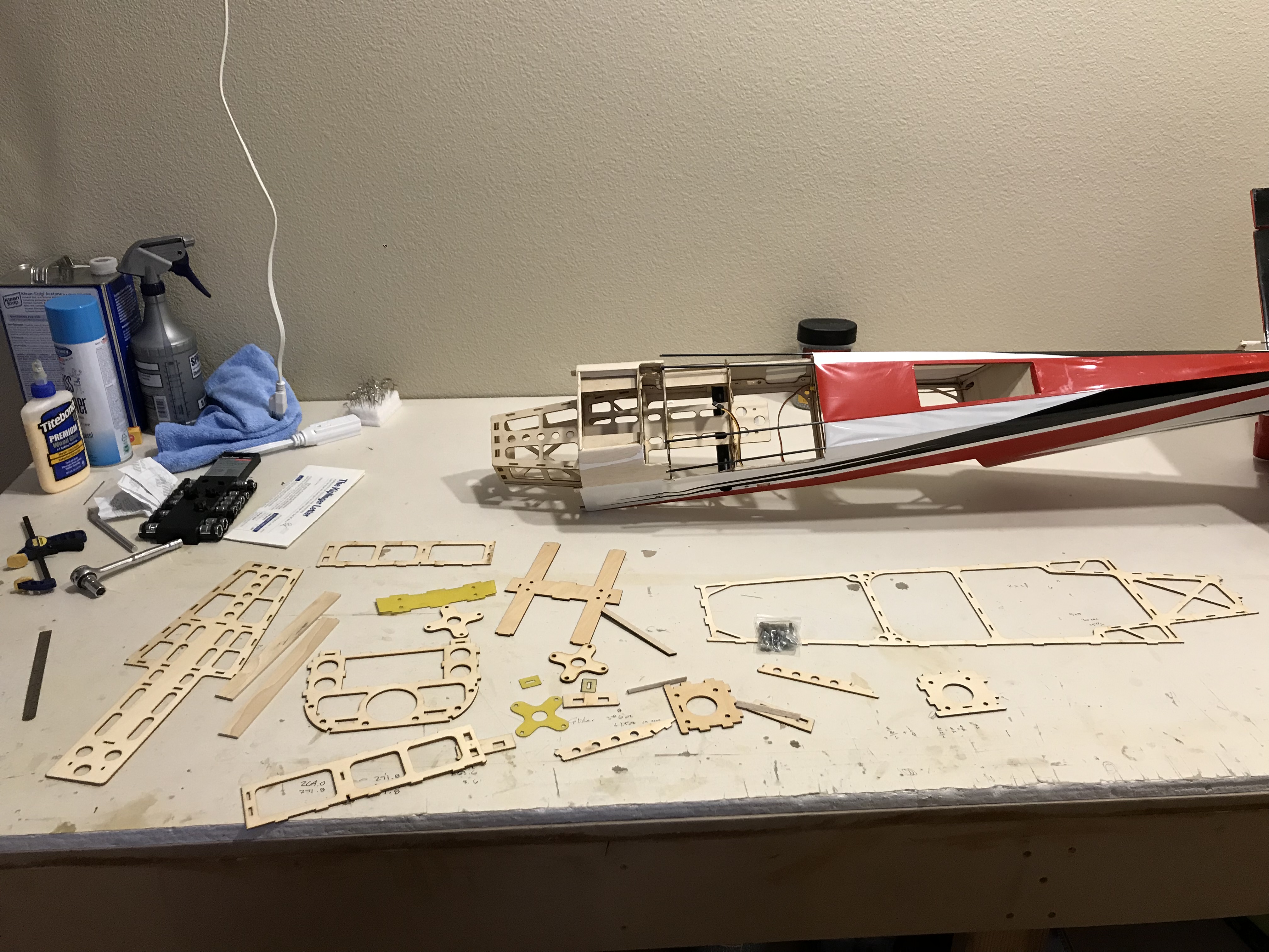

I did not know that EF did this and that the parts were available. That puts EF in good position for me to take a closer look at their stuff in the future. Unfortunately I to bang up a plane every now and again.Started the next project. Repairing the EF 60” extra. Flying in high winds for just a little bit too long and the battery gave up and couldn’t get it back to land it. Blew out the landing gear plate. EF has a wood kit for the motor box for about $22 and had most of the pieces I needed. Just some repair of a couple of frames further back and hoping this goes back together rather easy. We’ll see..

I like your “high powered” weights!

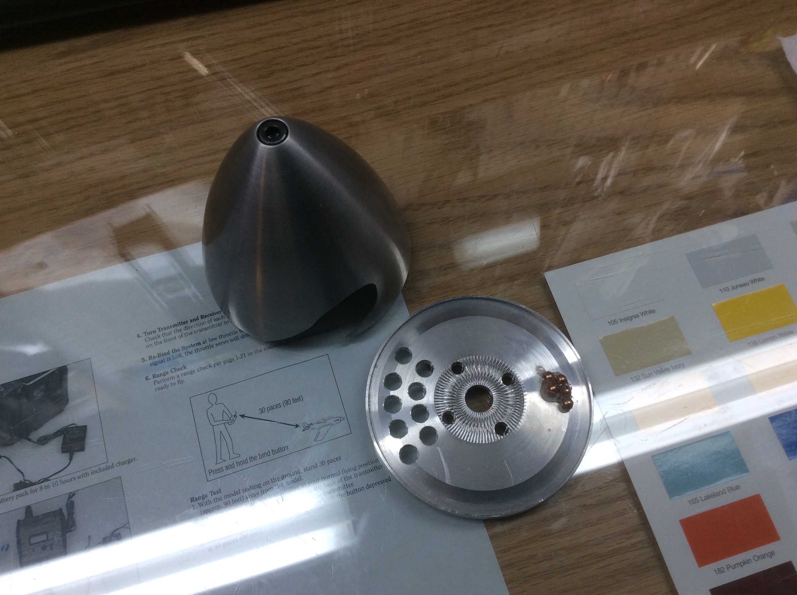

Ok boys how do like this during the last summer my flying buddy had DLE35RA. It never ran well and shook the plane pretty good and just cold never get a good tune. Anyway about six months later I am repairing his Vactor 30cc and I told him I need a spinner to set engine and cowl. He drops the spinner off and while working with it I put the spinner on the workbench and spinner just rolls hard to one side I look at do it again and standing there saying to my self it should not do that. Anyway to make a long story short look at the picture and see what I had to do to make the spinner balance. While doing it, it is so bad that you start doubting yourself and start checking everything but no that is what it needed to balance.
