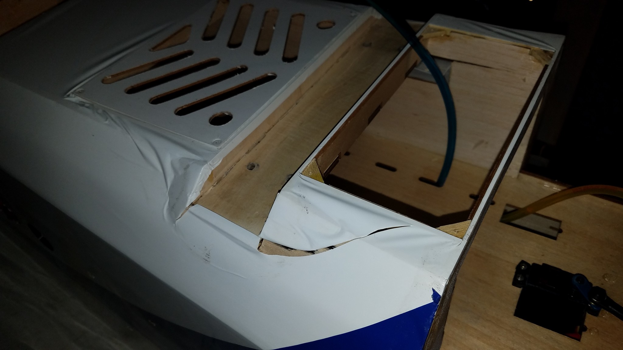

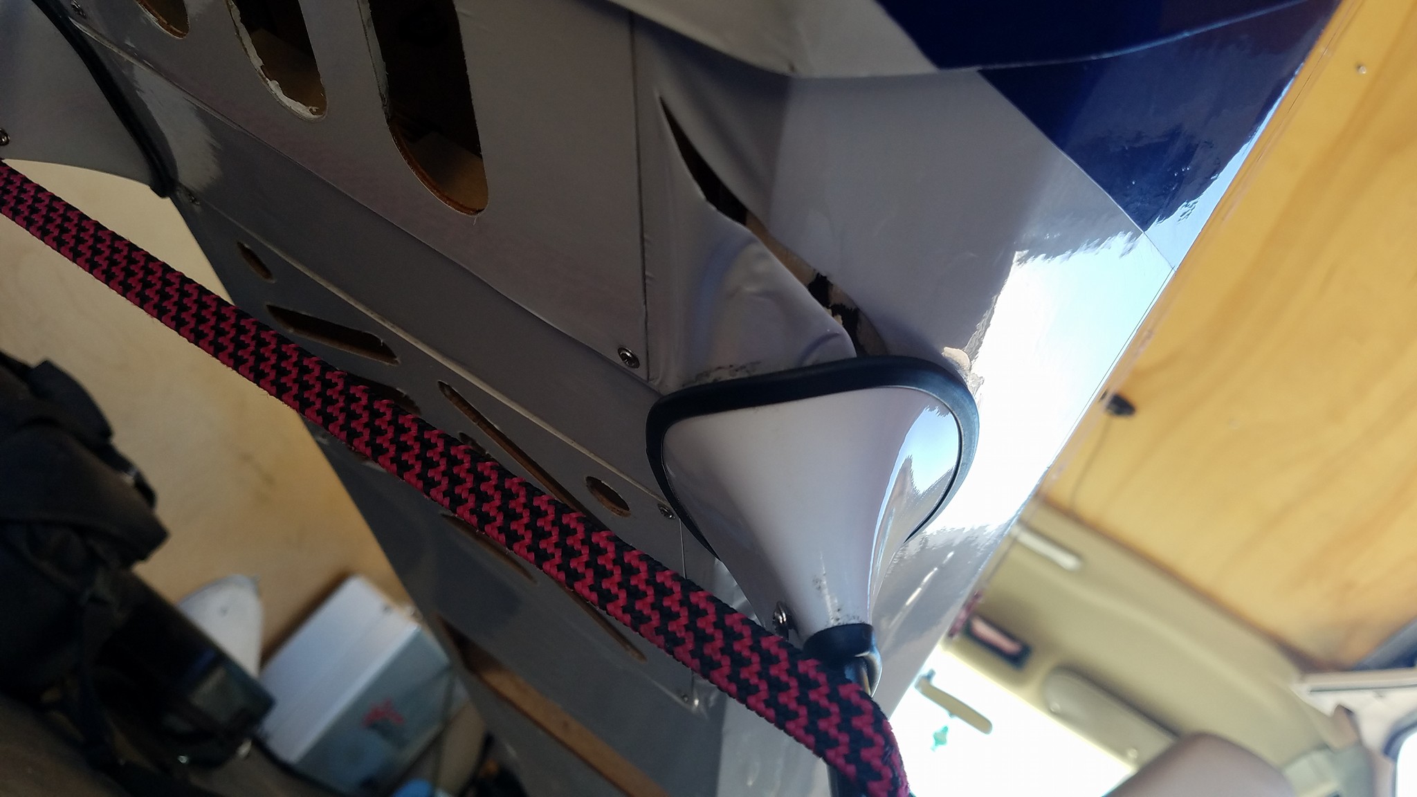

I hucked a little too hard this weekend and broke the LG plate free on the 105 AJ Laser!!
Only noticed this when I went to put the airplane away, who knows how many flights I put on the airplane with it like this.

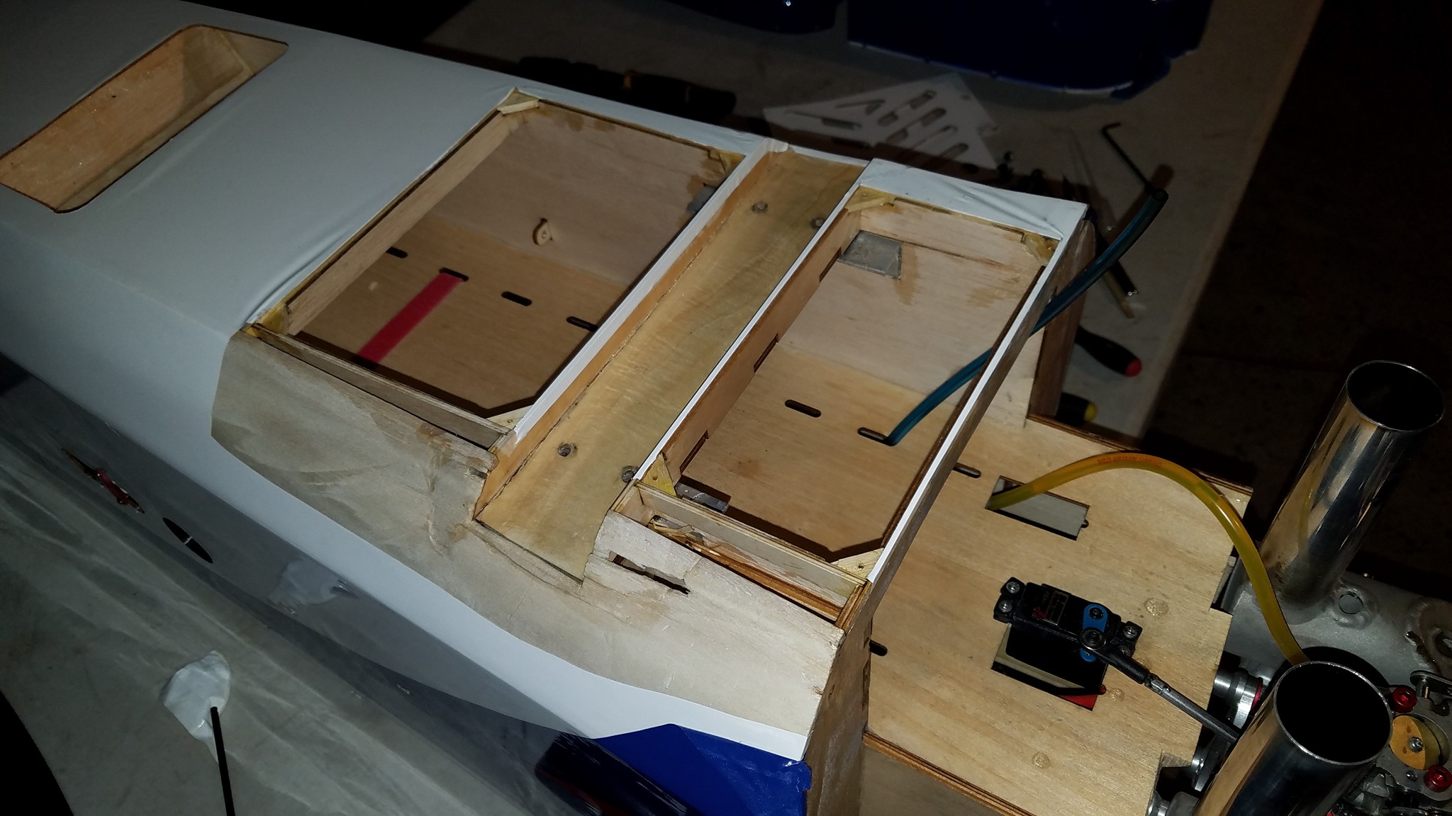

Surveying the damage...

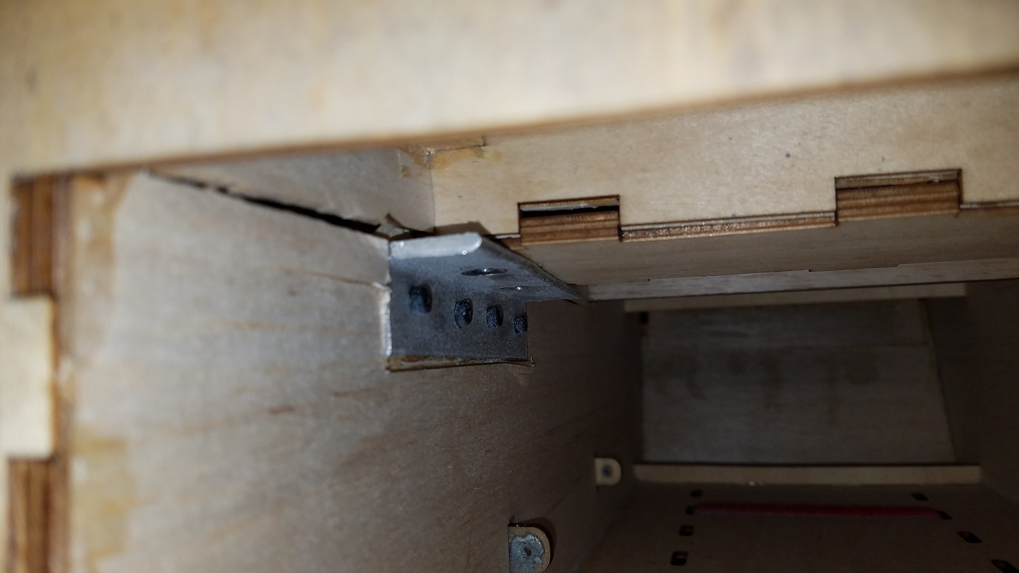

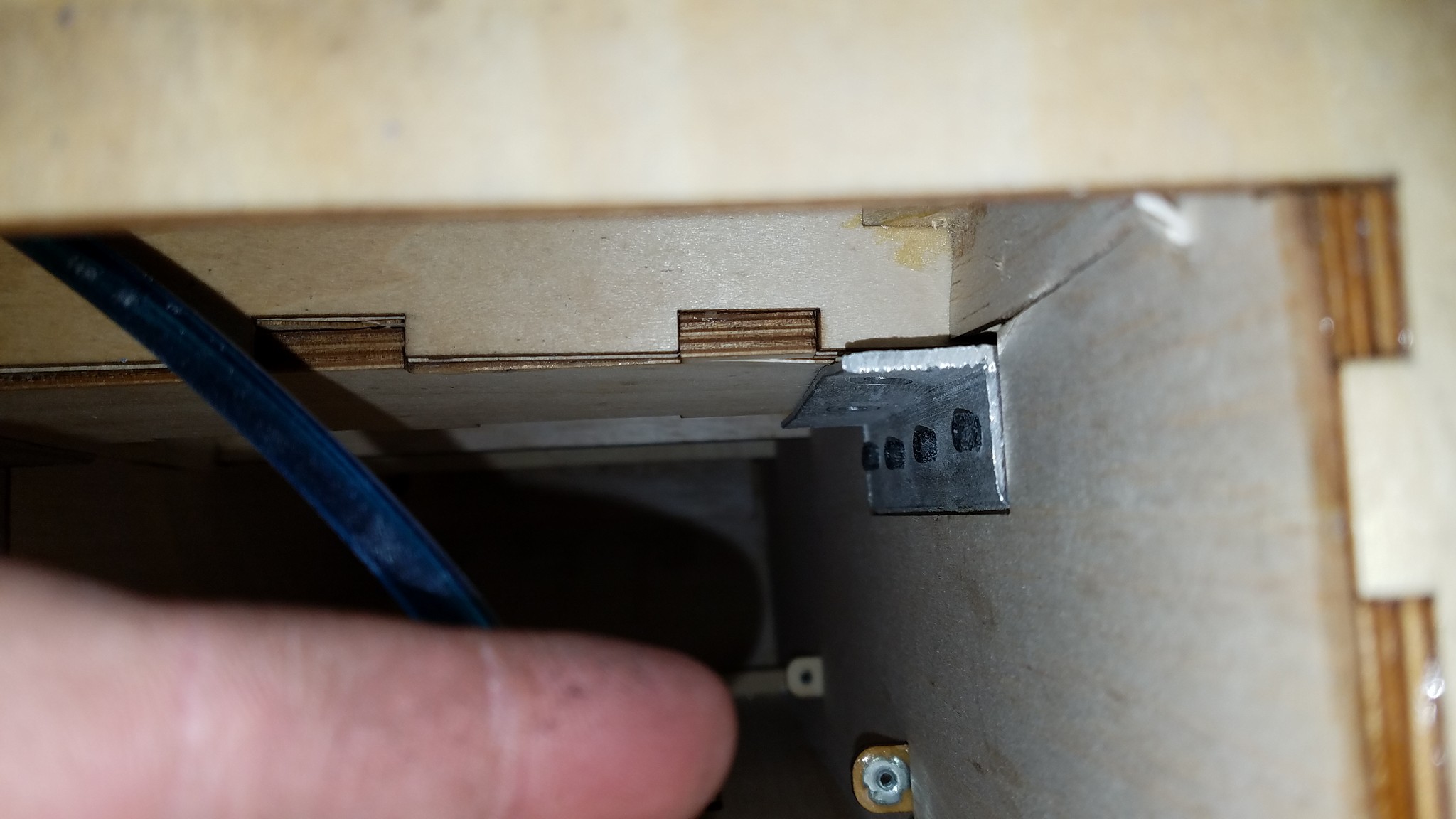

This L bracket got pretty bent and was keeping me from pushing everything back together easily. The brackets popped out once I removed the bolts holding each in. I hammered them flat and straight again on the anvil.

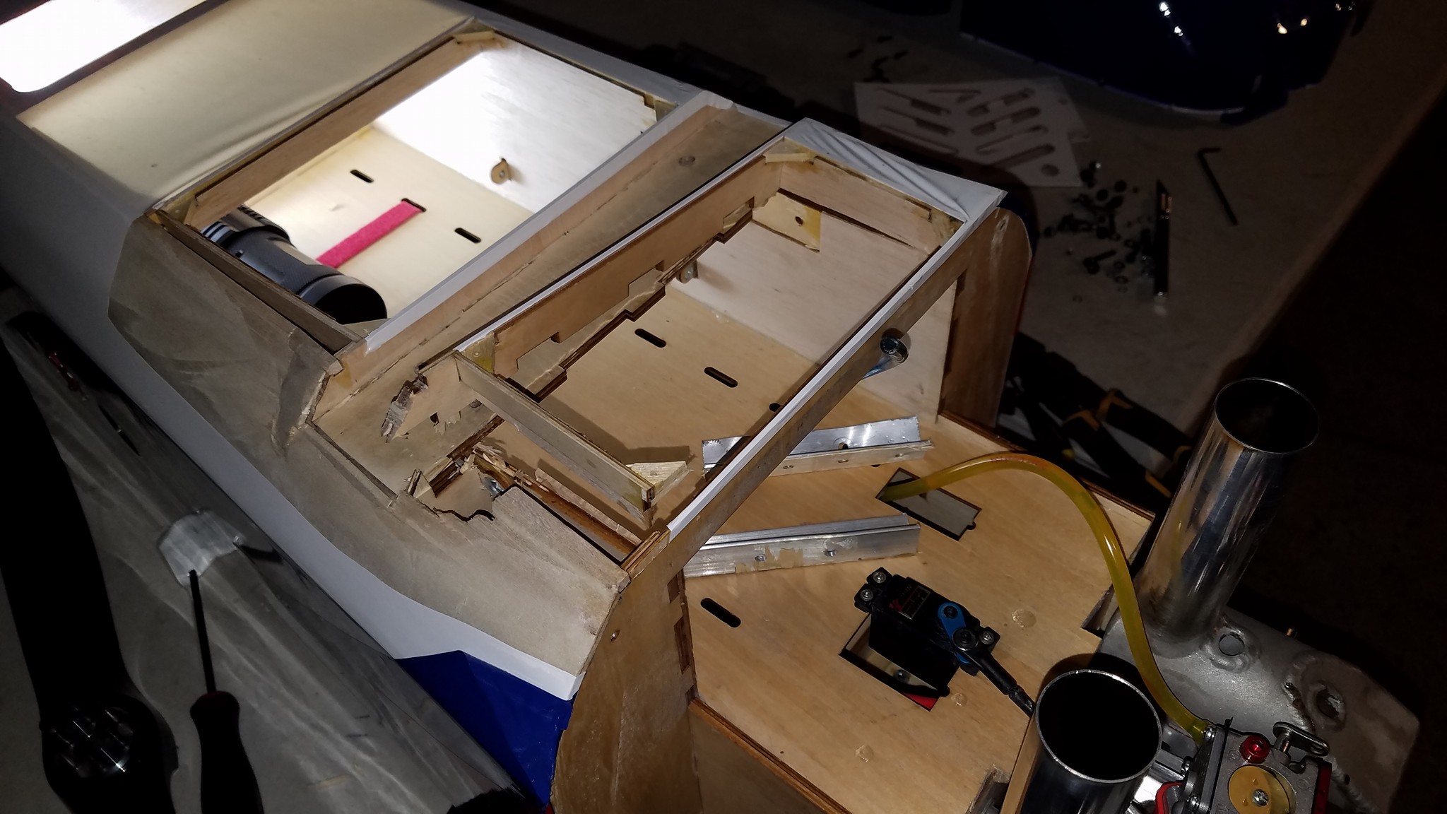

Looks like a big mess....
Pushed all of the loose bits back into shape and slathered a lot of glue in place. There wasn't much that Epoxy would be able to do here as I needed something that could wick into the joints. A half bottle of thin CA was generously injected into all of the soft balsa areas (using a fine applicator) to lock it all back in place and thick CA was spread into the bigger joints and all of the corners. Kicker was not used so that the full strength of the glue could be achieved. It's a strong as new, if not stronger!

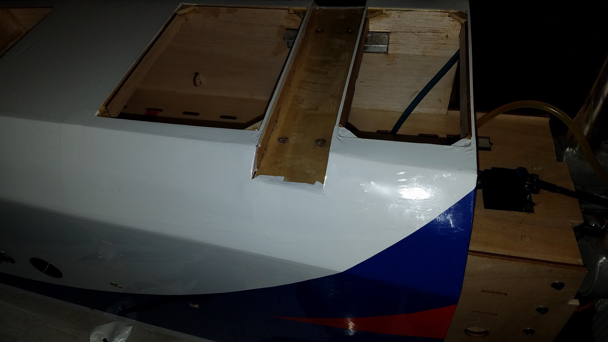

Some of the scrap covering I cut away from the airplane for cooling holes was re-used to cover up the ugly areas. And wouldn't you know it, the color is a perfect match!!

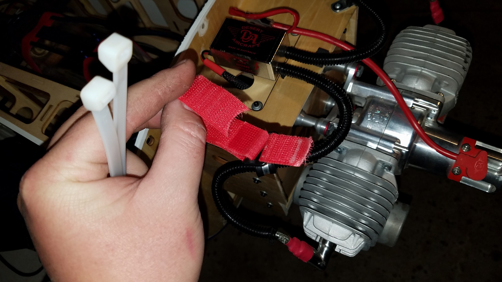

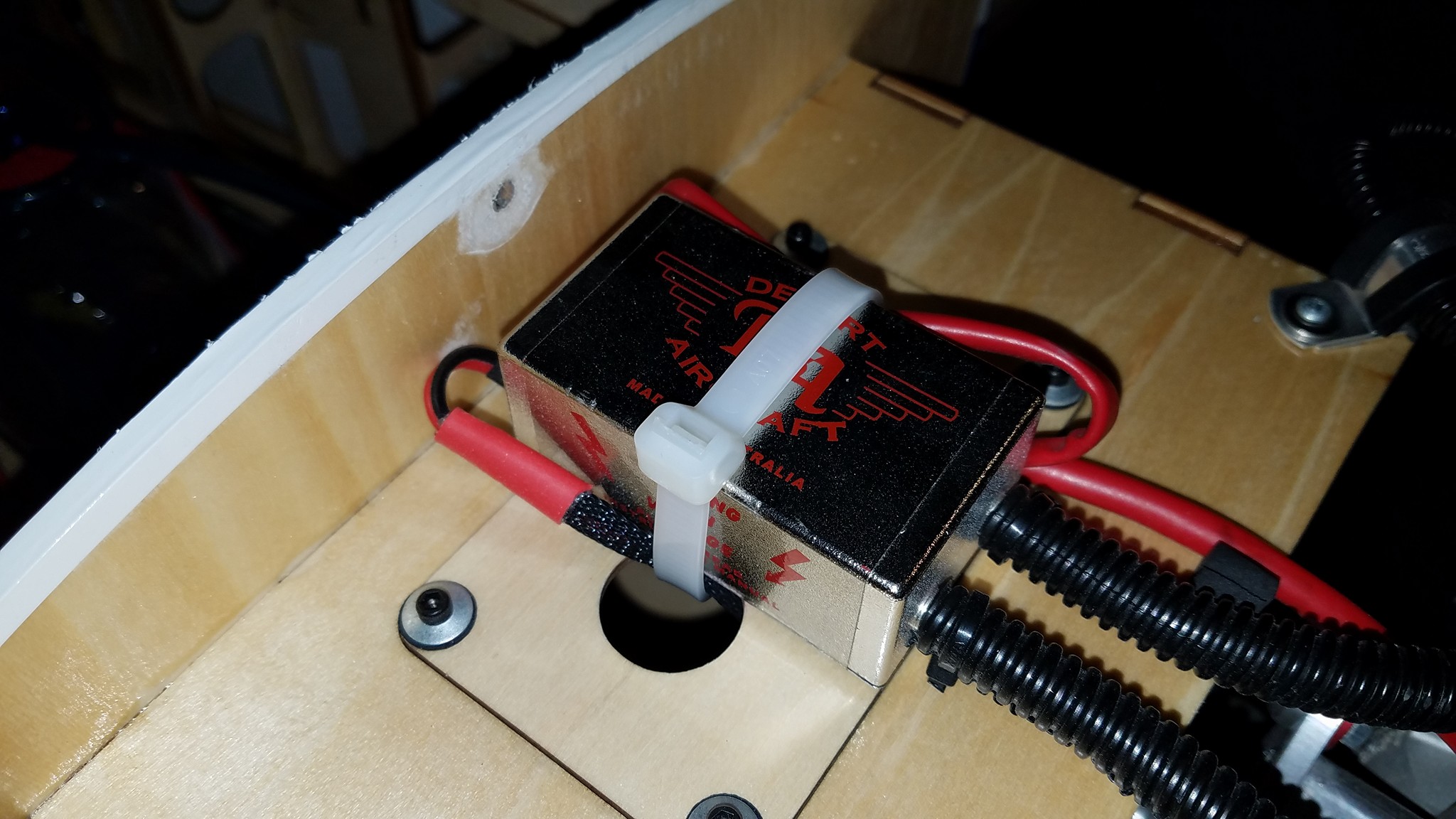

My velcro strap gave up the ghost after almost 100 flights on a previous airplane and 50+ on this one, too bad because I really liked these (no longer available).
A big zip tie will do to lock the ignition back in place.

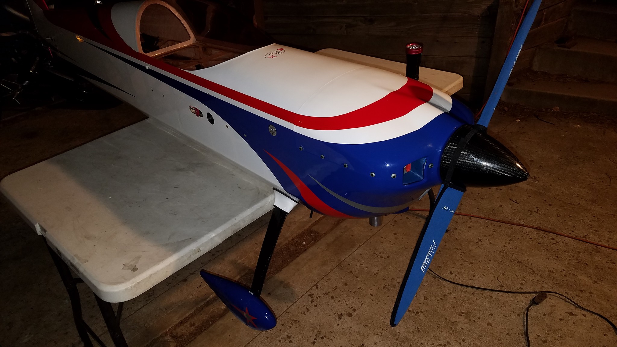

Bolted the gear back on and secured the cuffs back in place (so glad the cuffs are bolted in place and not glued!), she's ready to throw down again!!!
