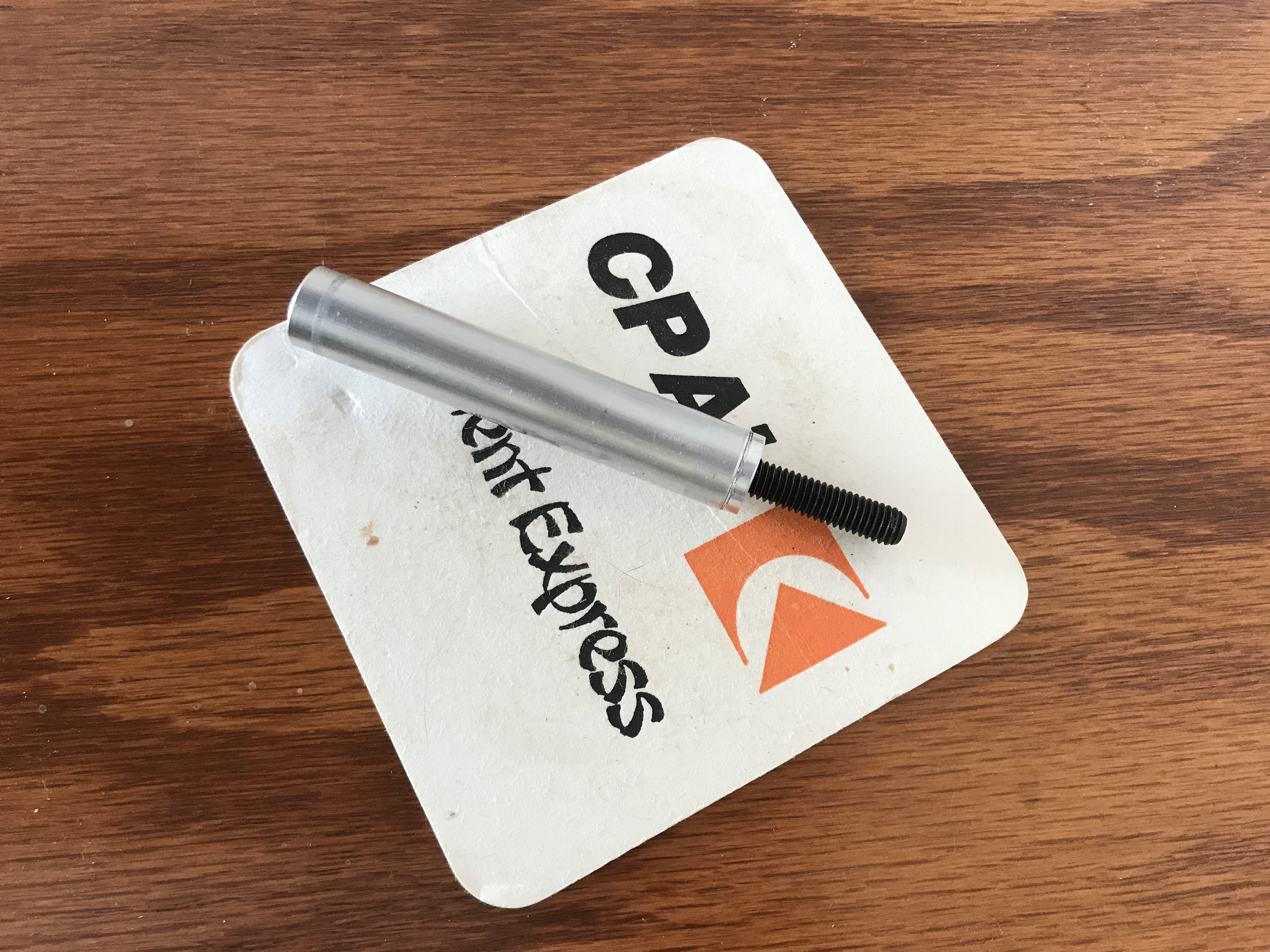

That happened to both wings on my cheap Edge......Of course I took the low road and just glued the wing tube in place. Cuz I CHEAP :laughing:

That is a critical part for the plane you would expect that they would take the time to glue that part in properly just like the firewall. Good that you found it.

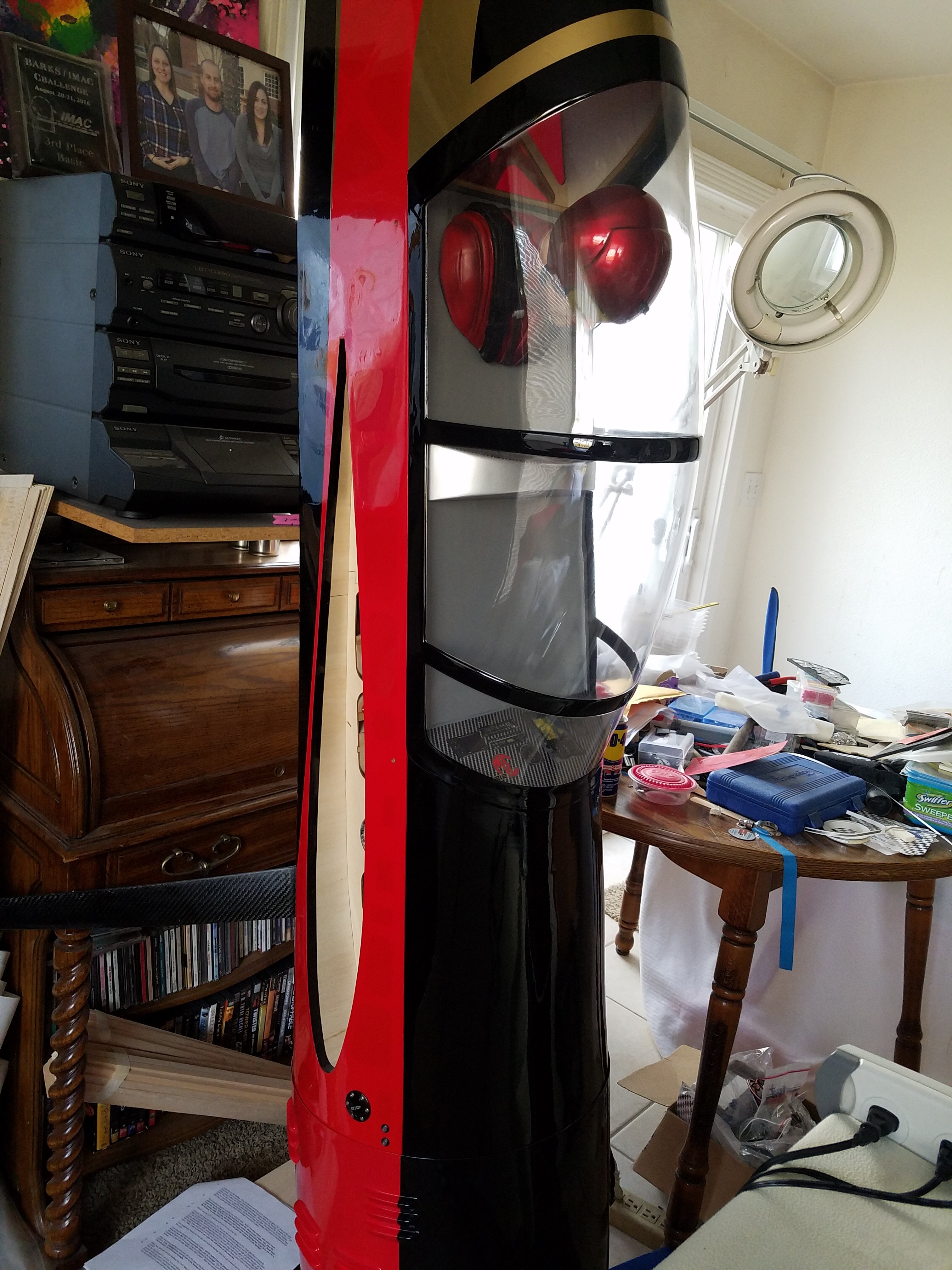

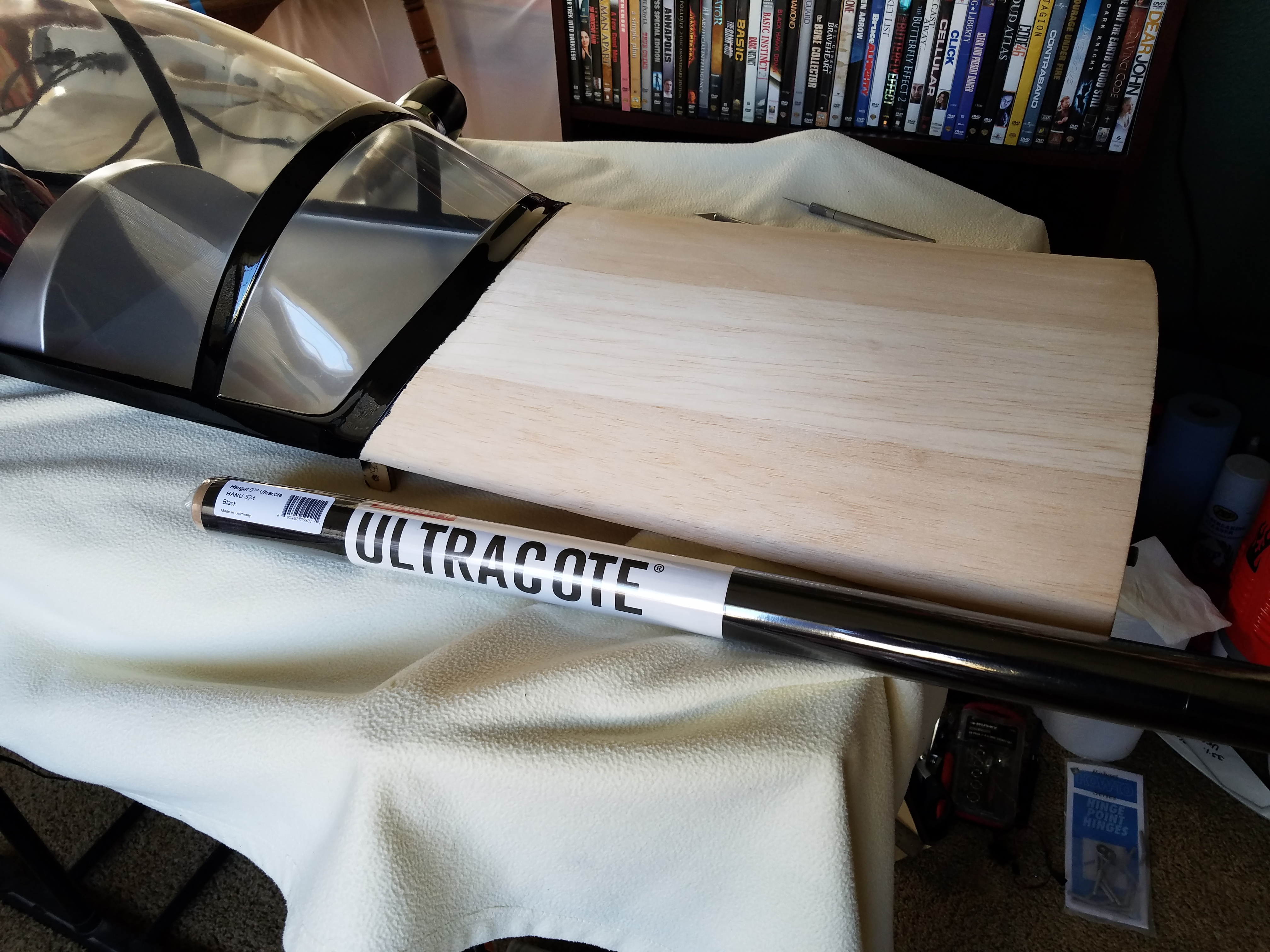

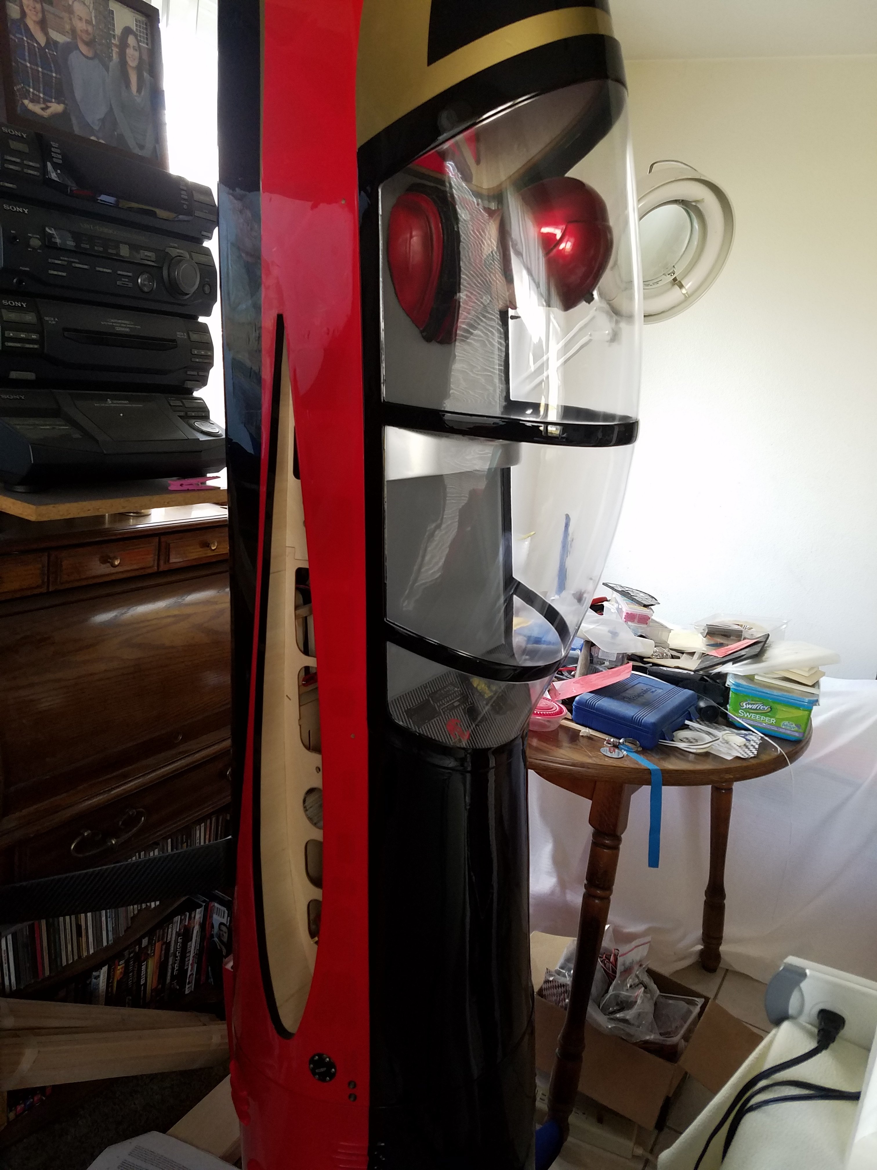

It has been over a week since I painted the new canopy for the Behemoth yak. I figure the paint should be cured enough to handle so now would be a good time to finish the last expensive step in replacing the canopy. What insurance policy can you buy to ensure that you reinstall your canopy bolts after removing them? Spend nearly $250 for paint, covering, and the canopy. If that doesn't help you to remember, nothing will. I started replacing the covering on the front of the hatch this afternoon.
First a very gentle alcohol wipe down of the wood. Then a tack cloth to make sure that there are no remaining particles on the wood. After I was able to get the right curvature of the covering where it will lay over the lip of the canopy, I laid the covering down and sealed it into place.
