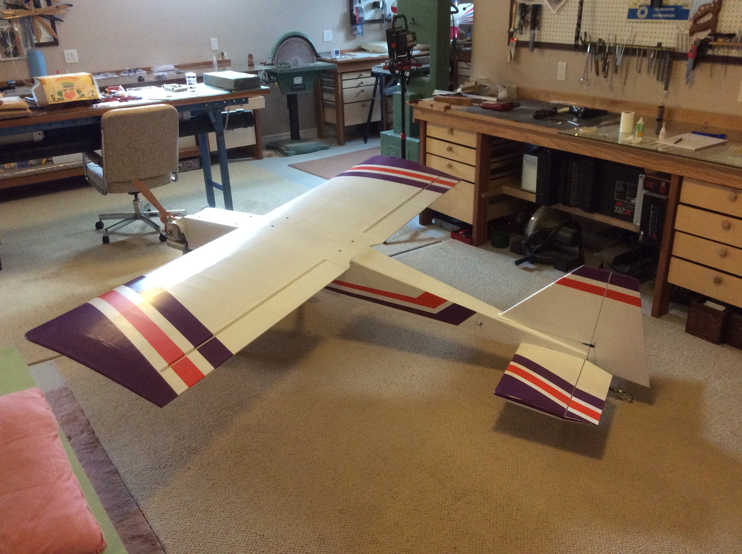

Have a question I have big Stick from AMR great plane made a lot of changes to it but it is still a stick. Thinking of changing the wings. Remove the wings and install a set of wings from a 150cc aerobatic or 3D plane just for kicks. Will need a hole new wing saddle and centre transition piece to go onto the fuselage and connect the wings. But should be fun to do. Now all I need to do is get my hands on a set of wings.

As far as the stick, I personally wouldn't bother with trying to make it do something it's not really meant for (3D). Just my 2 cents. What about a clipped double wing double beveled stik!

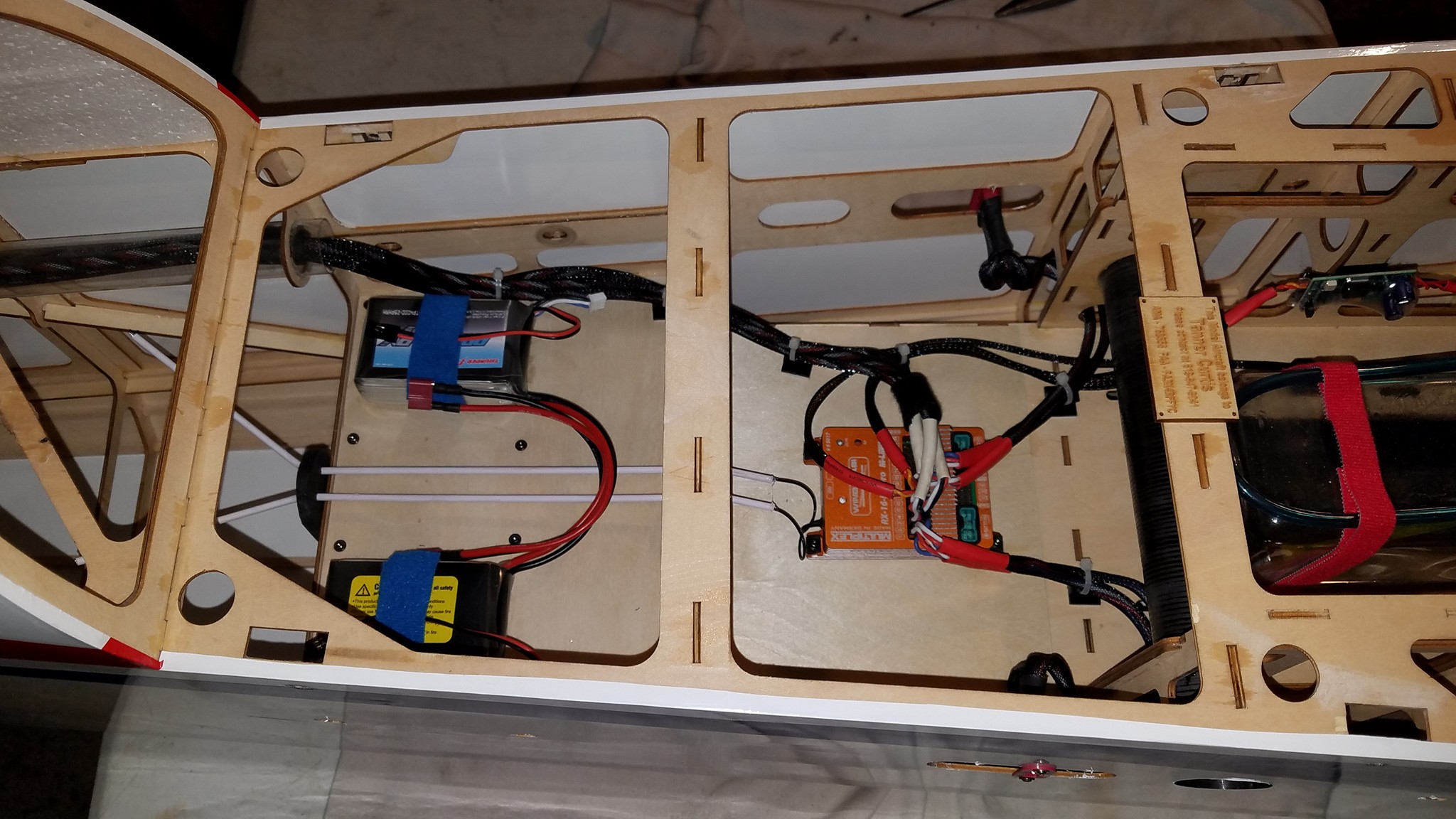

Cleaned up the interior of the 105 Laser last night. Cut a new 1/8 ply plate to mount my rx packs to, which was screwed in place so that it can be removed later if I need to work on something (like moving the elevator wires around). Then a 1/16 ply plate was cut to shape to let me mount the rx to. Antenna wires were routed through plastic tubes to keep the look clean.

What happened to the Expert system you were using I thought you liked it. I belive it was by expert or am I wrong.
The XPS X24 was a fantastic unit but it's not compatible with the equipment I'm using now, so I removed it and have already sent it to a new home.
I may still have a wing set from a 100cc yak.
