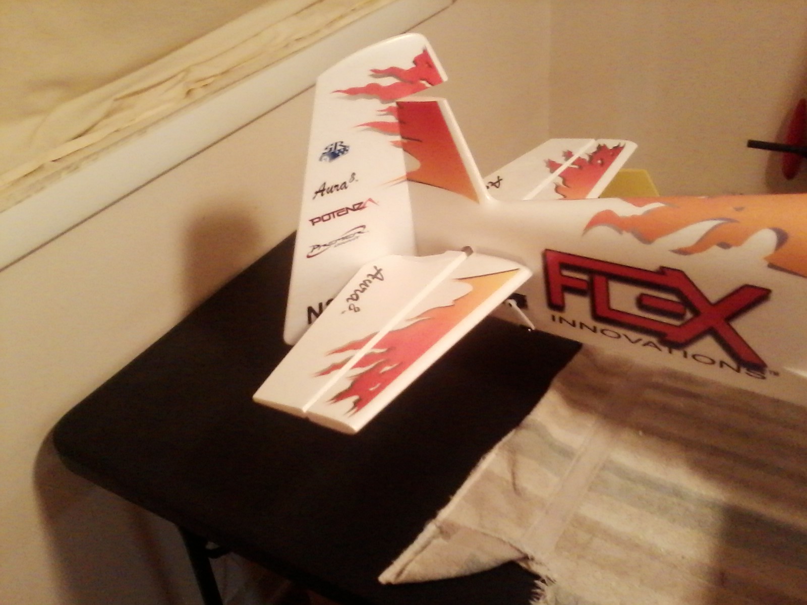

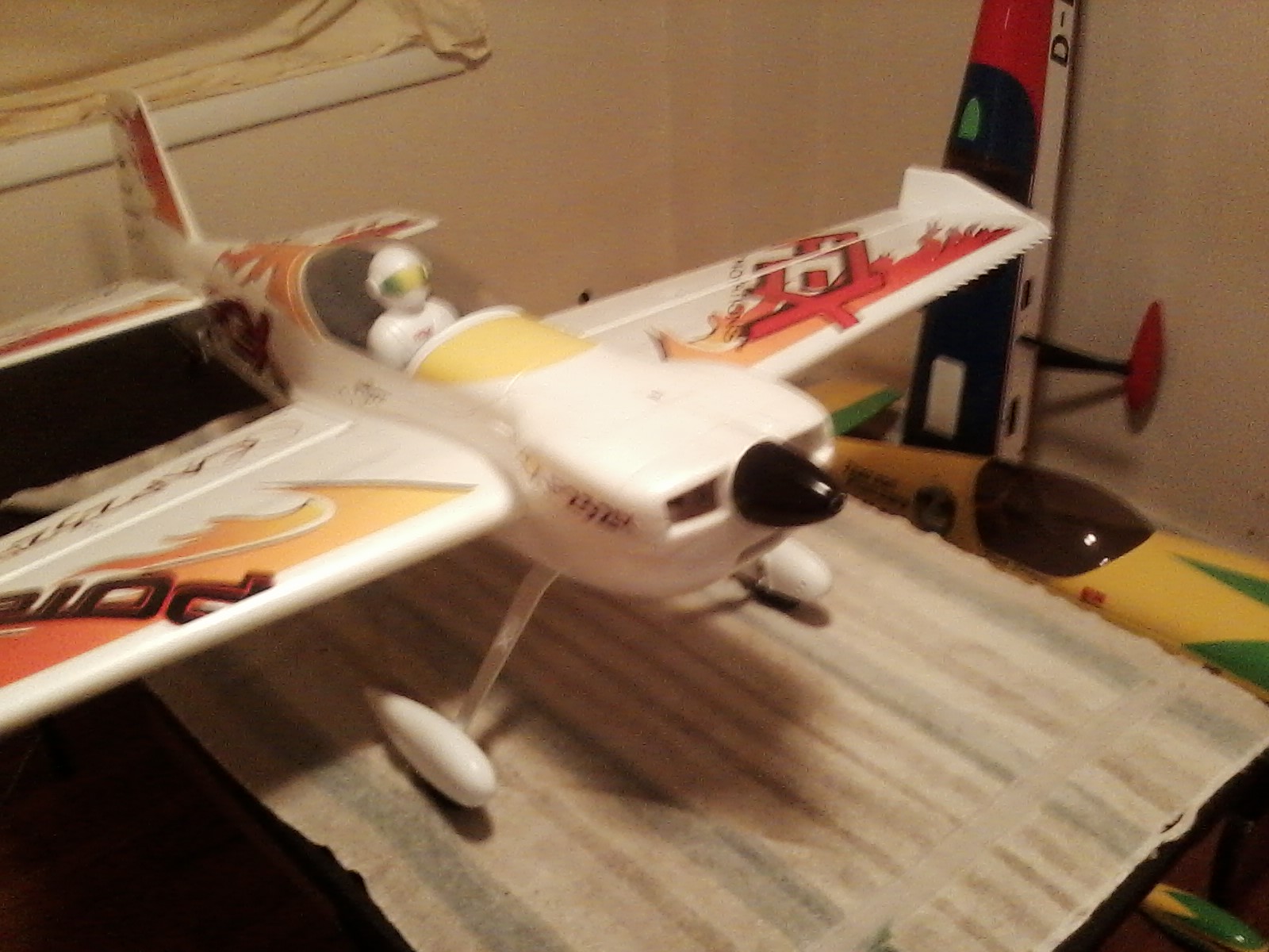

Could just use a better scheme that's all.

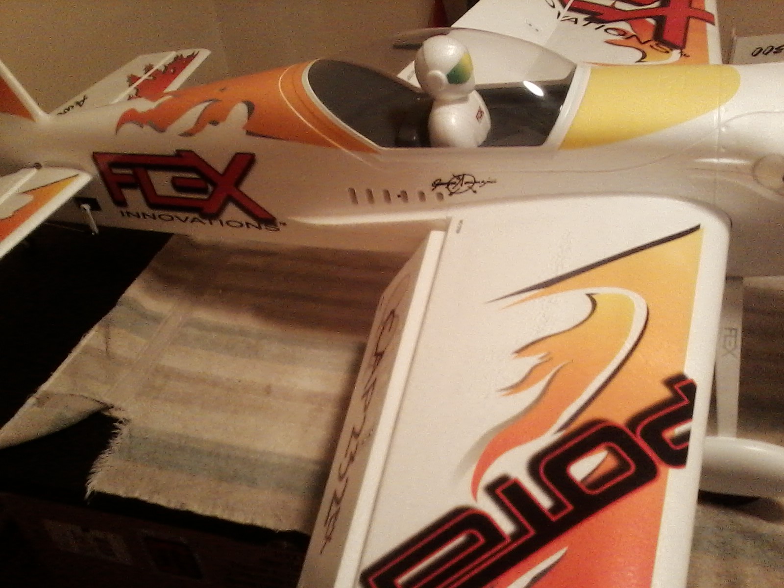

I'm ok with it but a real paint job not just stickers would be nice. Maybe a future project ???

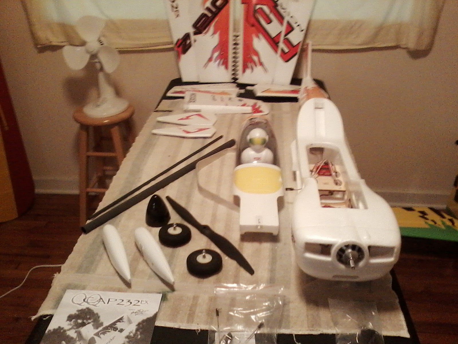

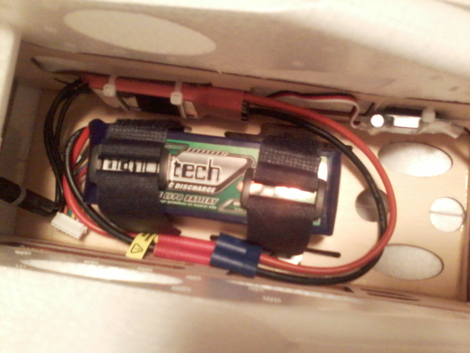

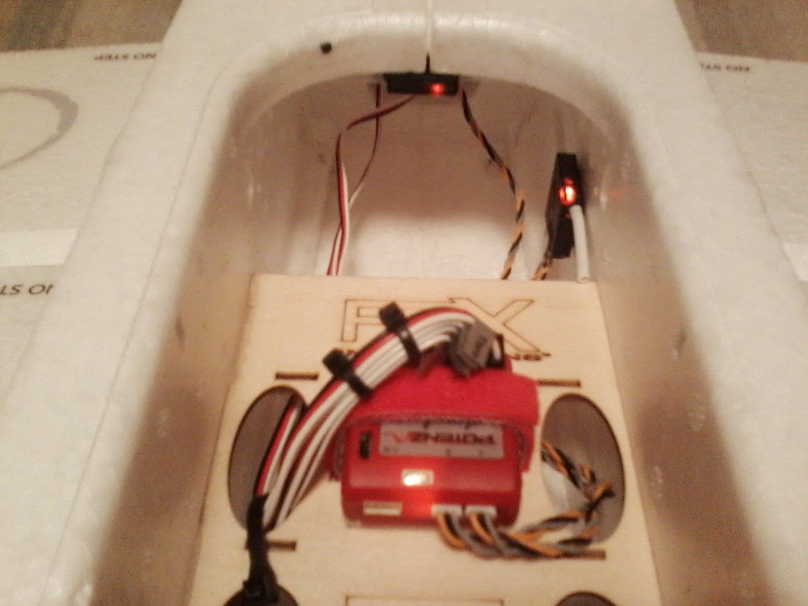

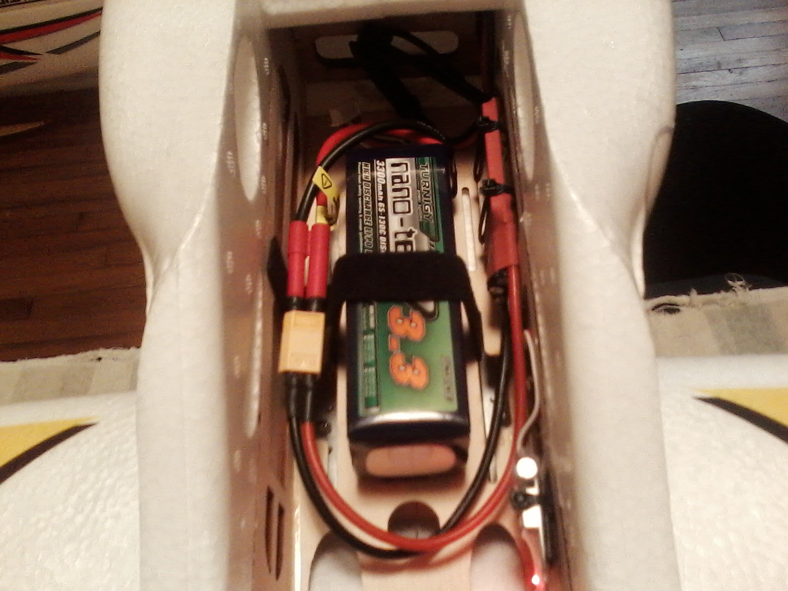

Got it all out of the box......Going to make an "EasyLoad" battery mount. The two stock straps are very difficult for me to manipulate.

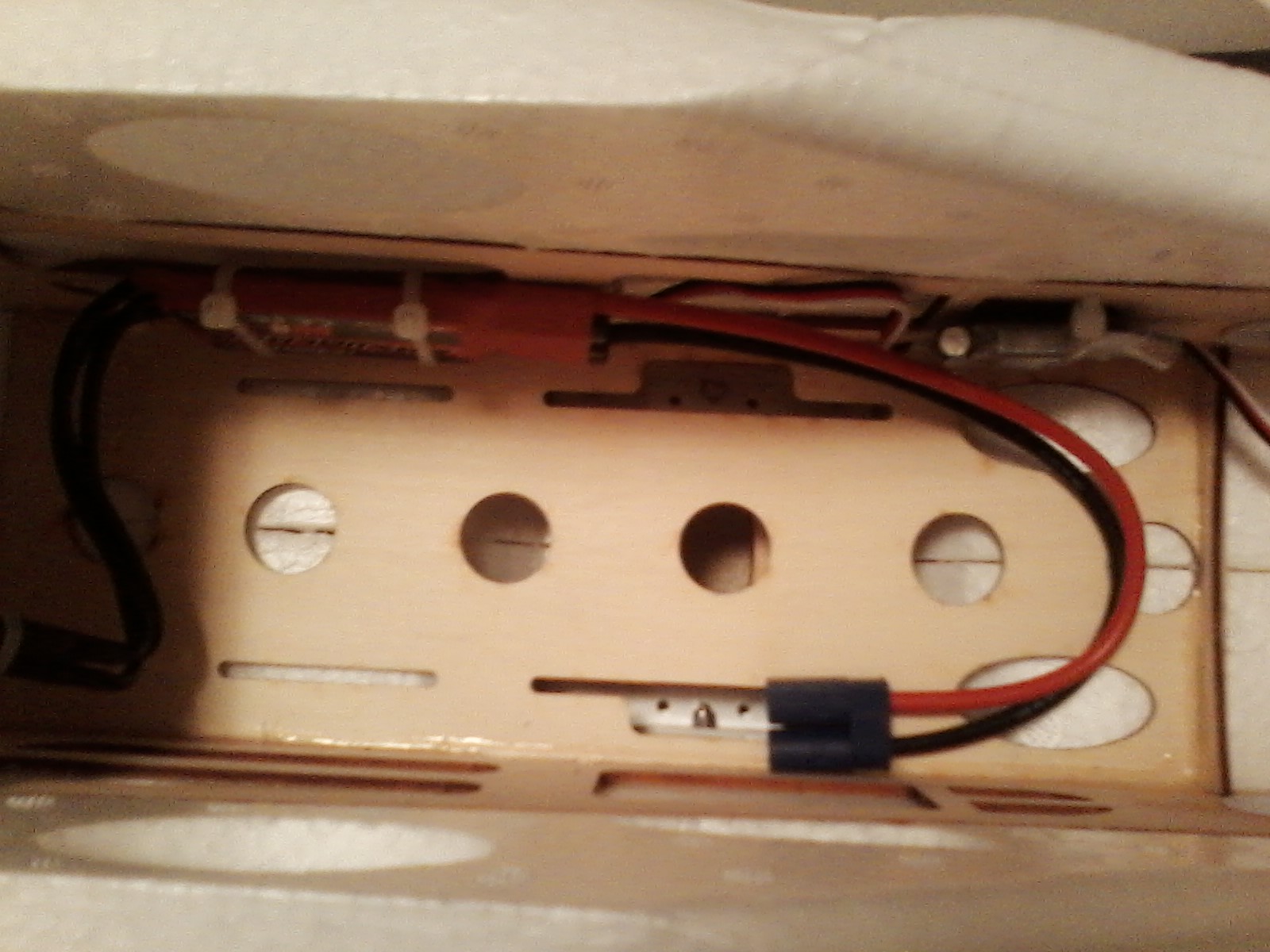

Just one strap and some Velcro for the tray deck and battery will work great. First thing to do is get the connectors swapped out. XT60's will be fine for this. And "Gort" (Day the Earth Stood Still) is a

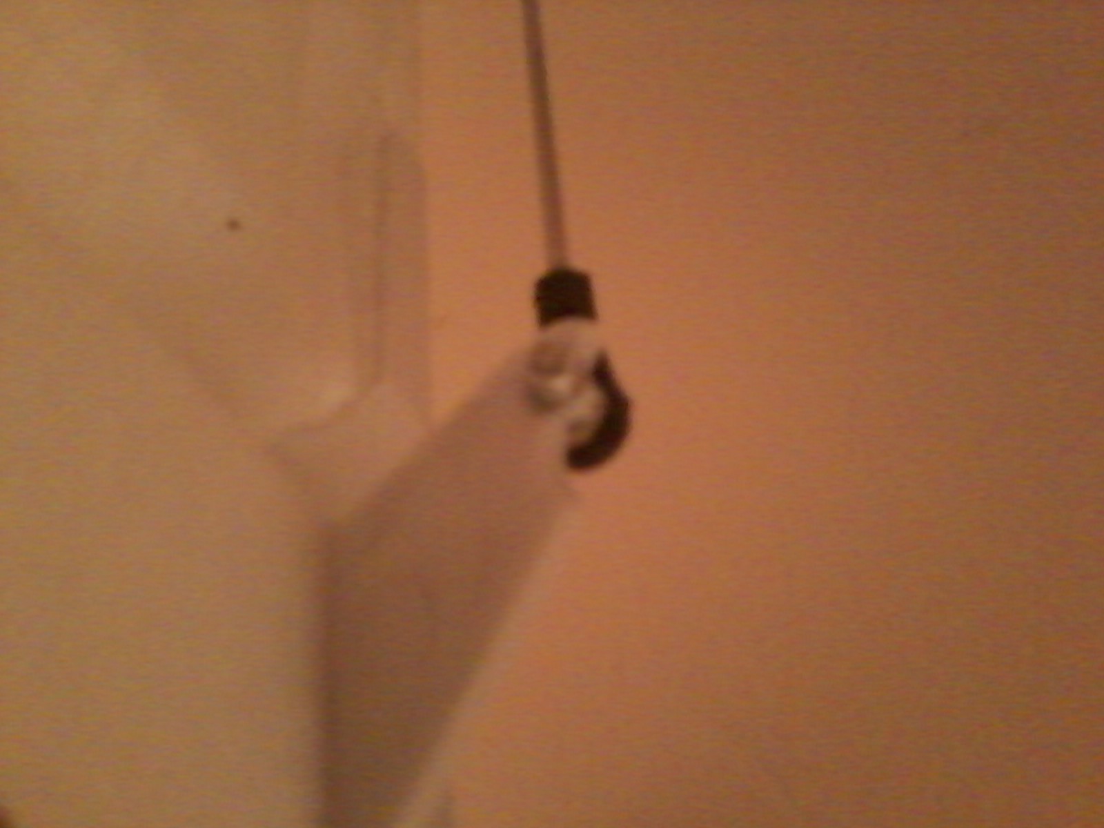

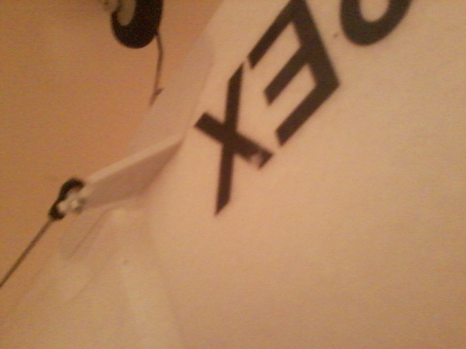

. All control hardware should be snugged down with blue locktite and careful not to over tighten.
