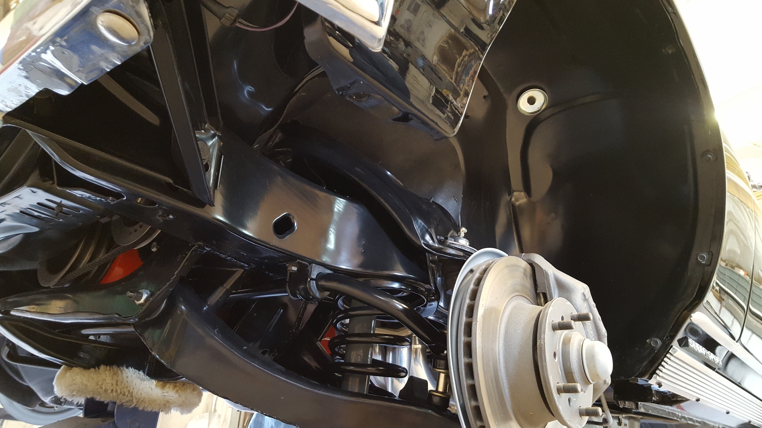

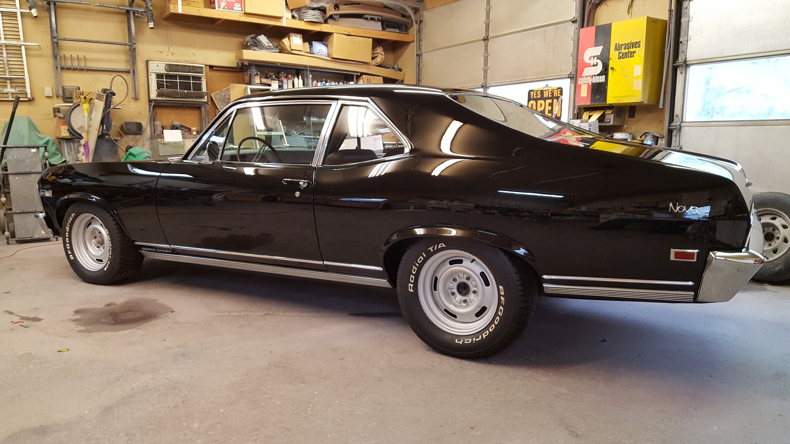

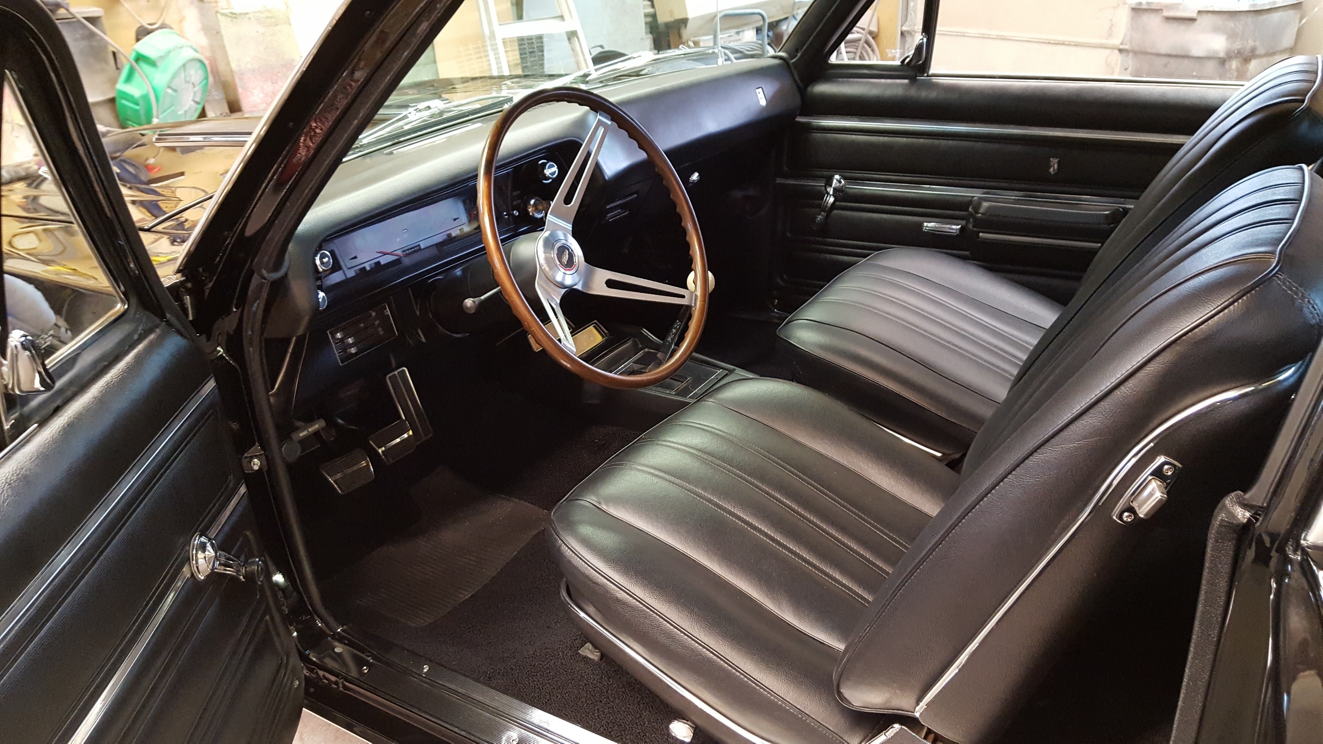

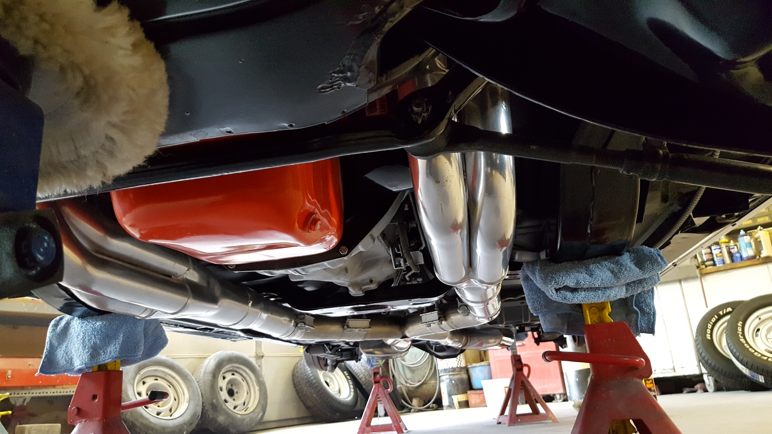

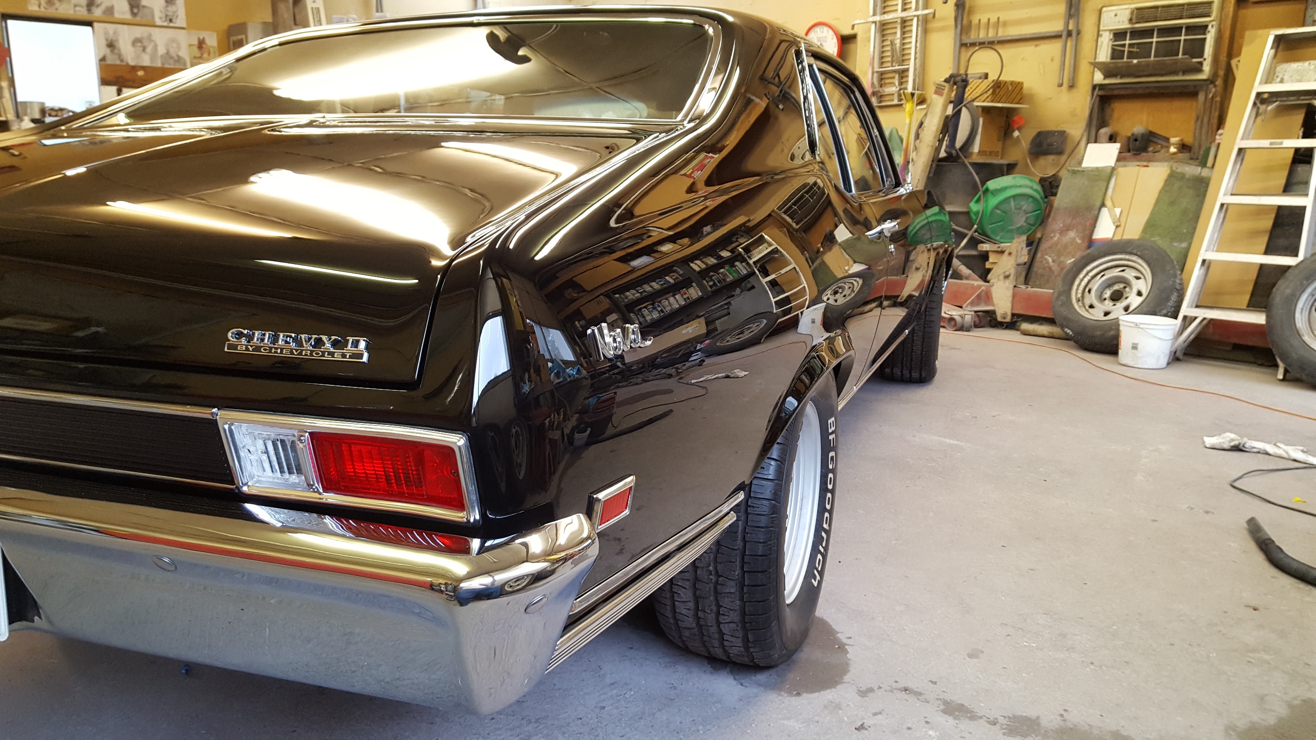

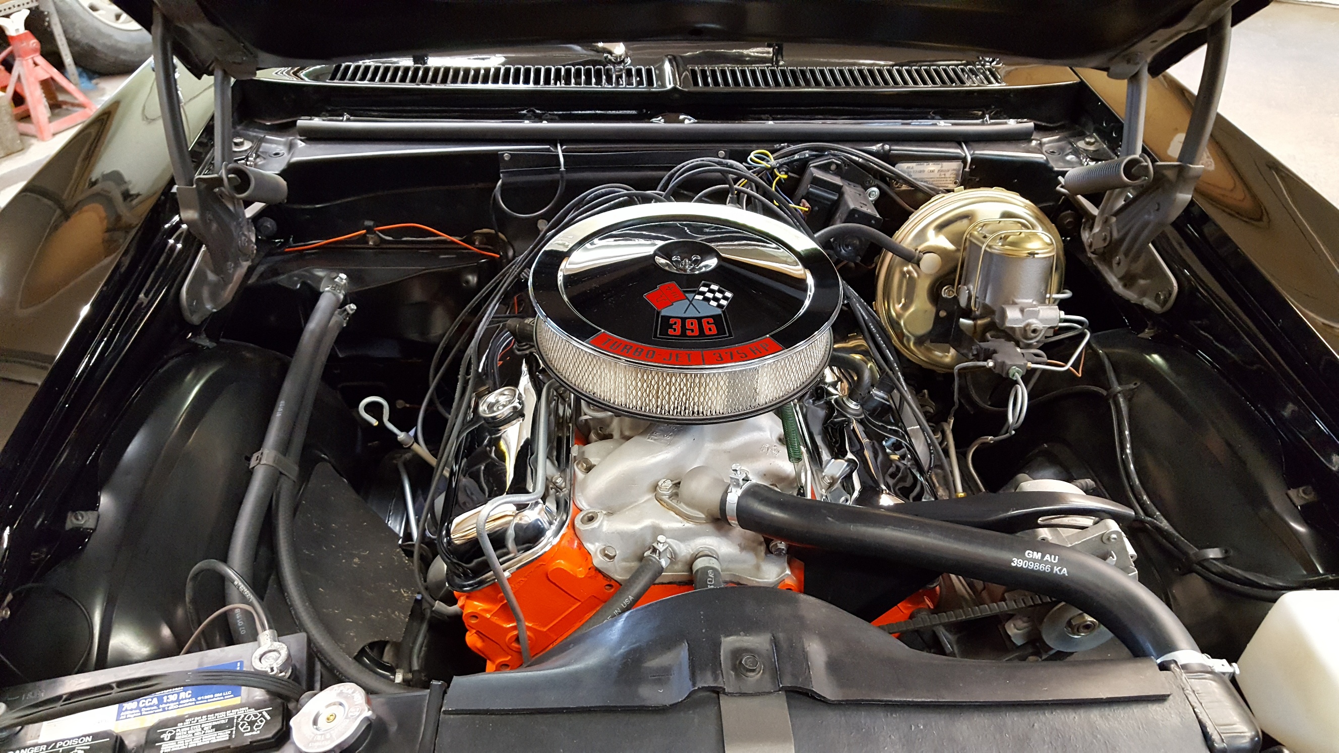

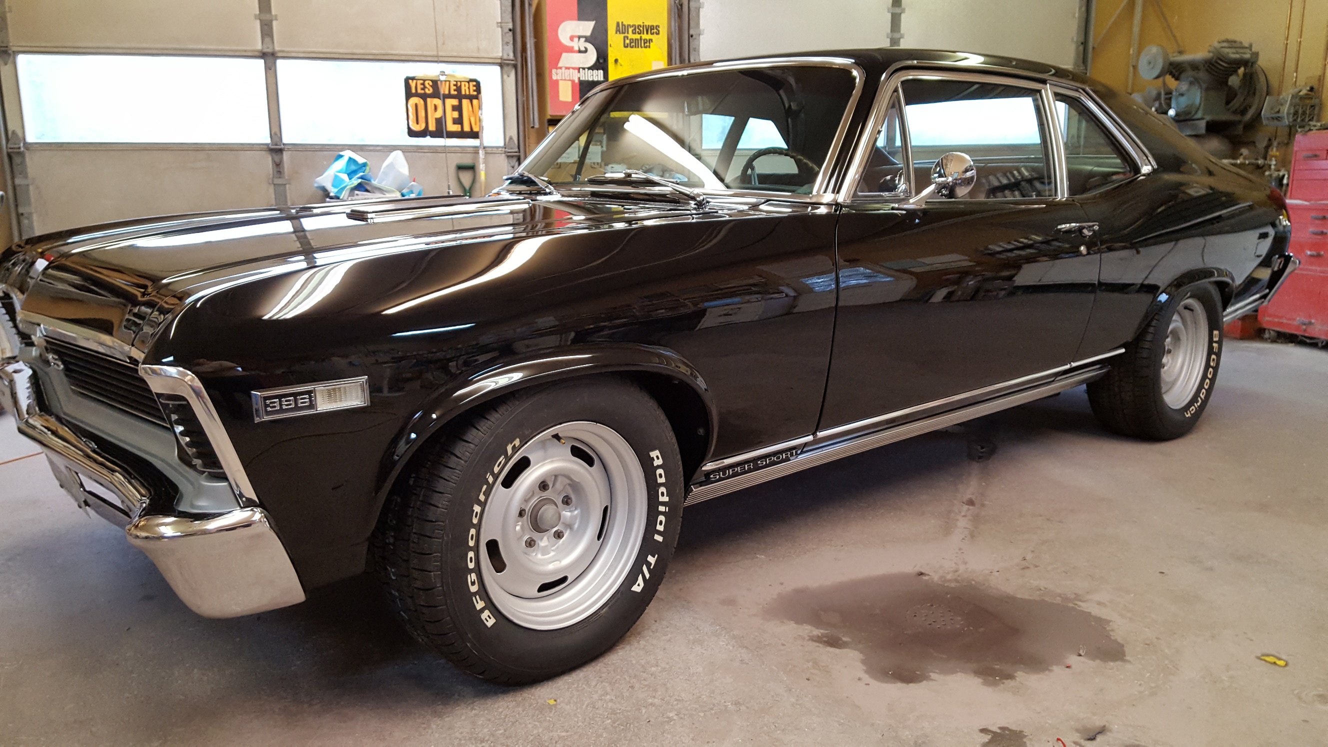

Today I had to work, but I think I'm finally finished with a long term restoration project. The owner still hasn't brought the trim rings and center caps for the Rally Wheels, but he says he's bringing them when he comes to get it next week.
View attachment 105504 View attachment 105505 View attachment 105506 View attachment 105507 View attachment 105508 View attachment 105510 View attachment 105511
Whoa! Gorgeous!!!

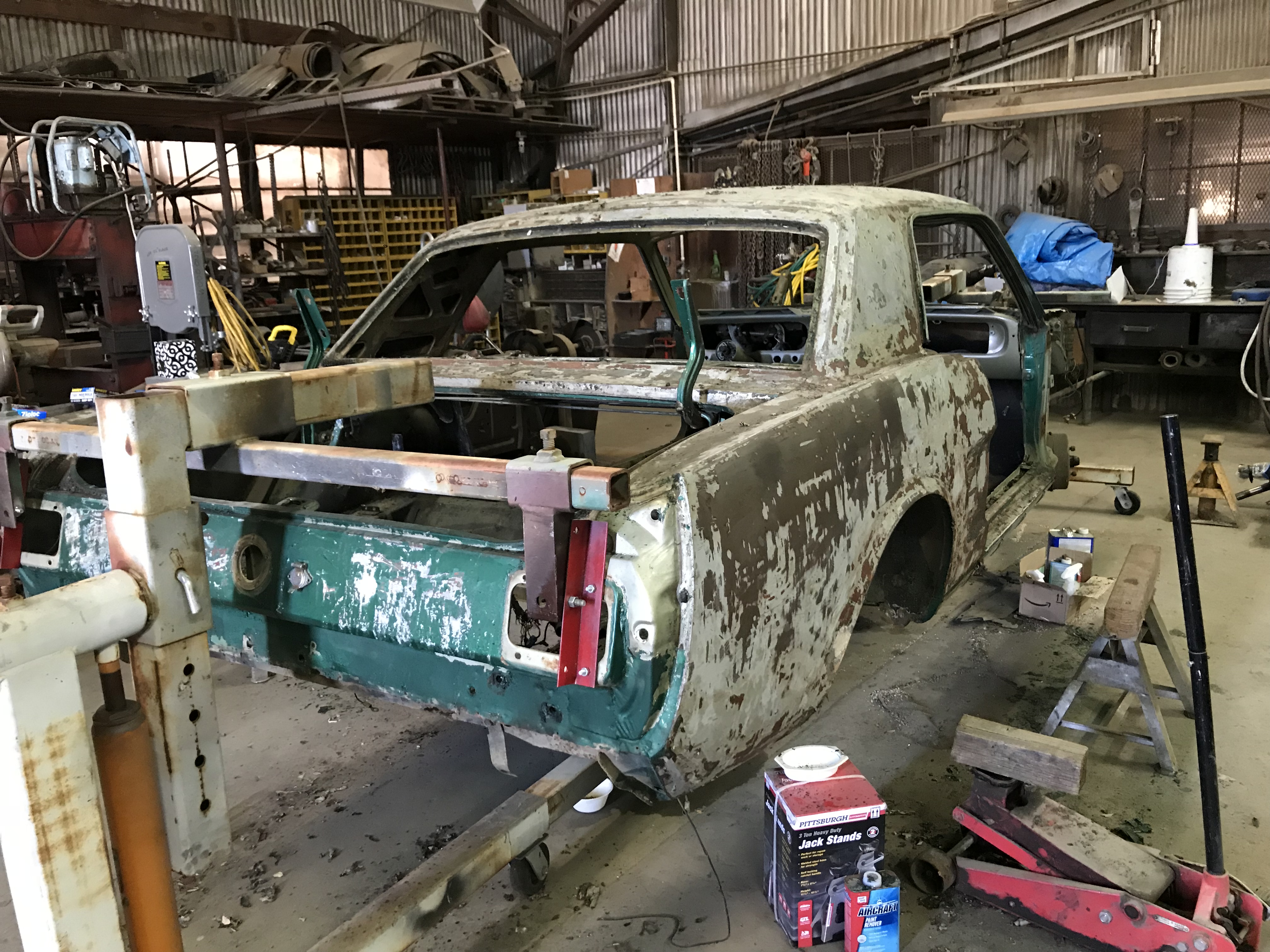

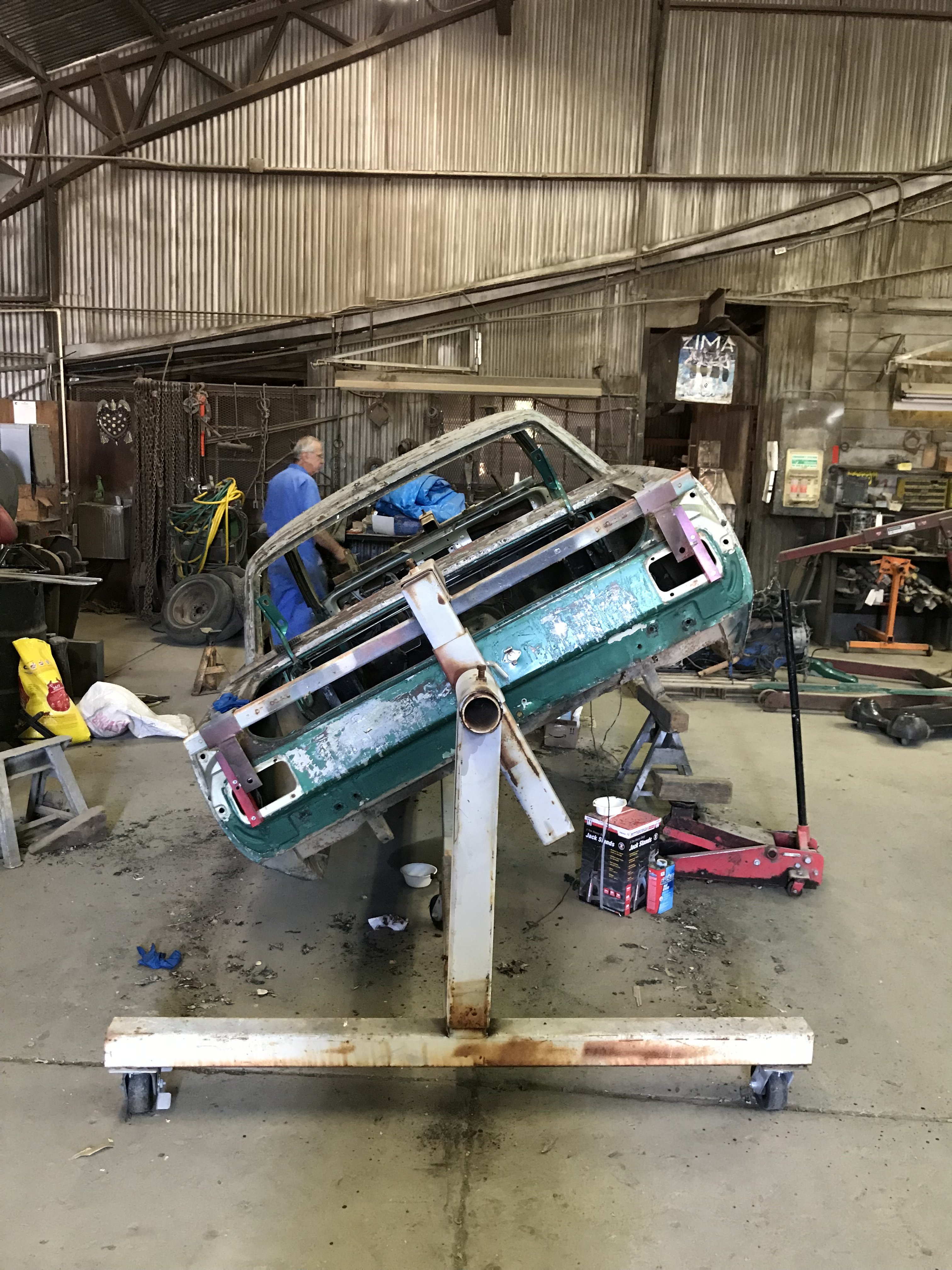

Here’s the current state of our (my son’s and I, and grandpa too) 66 mustang project
