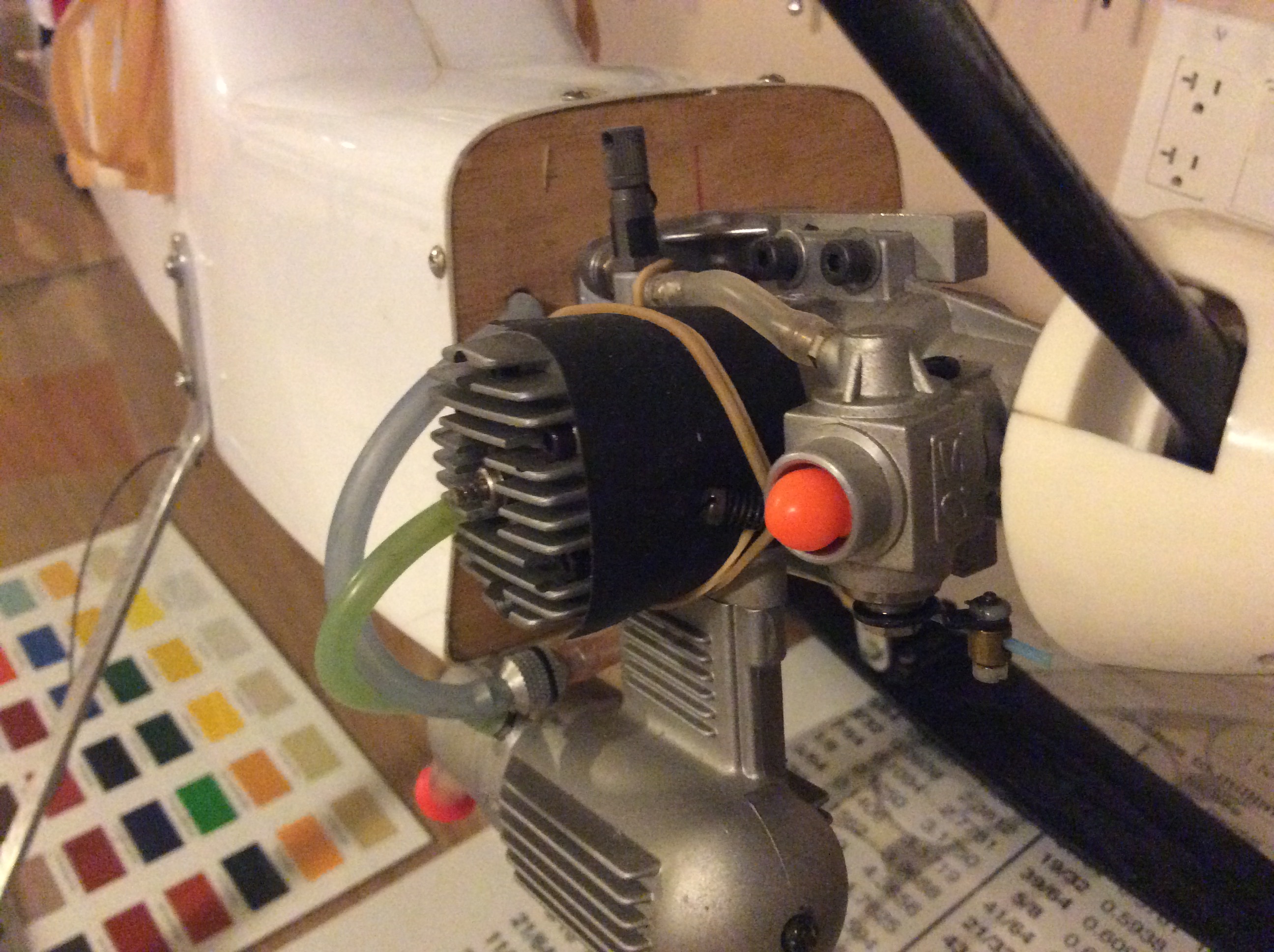

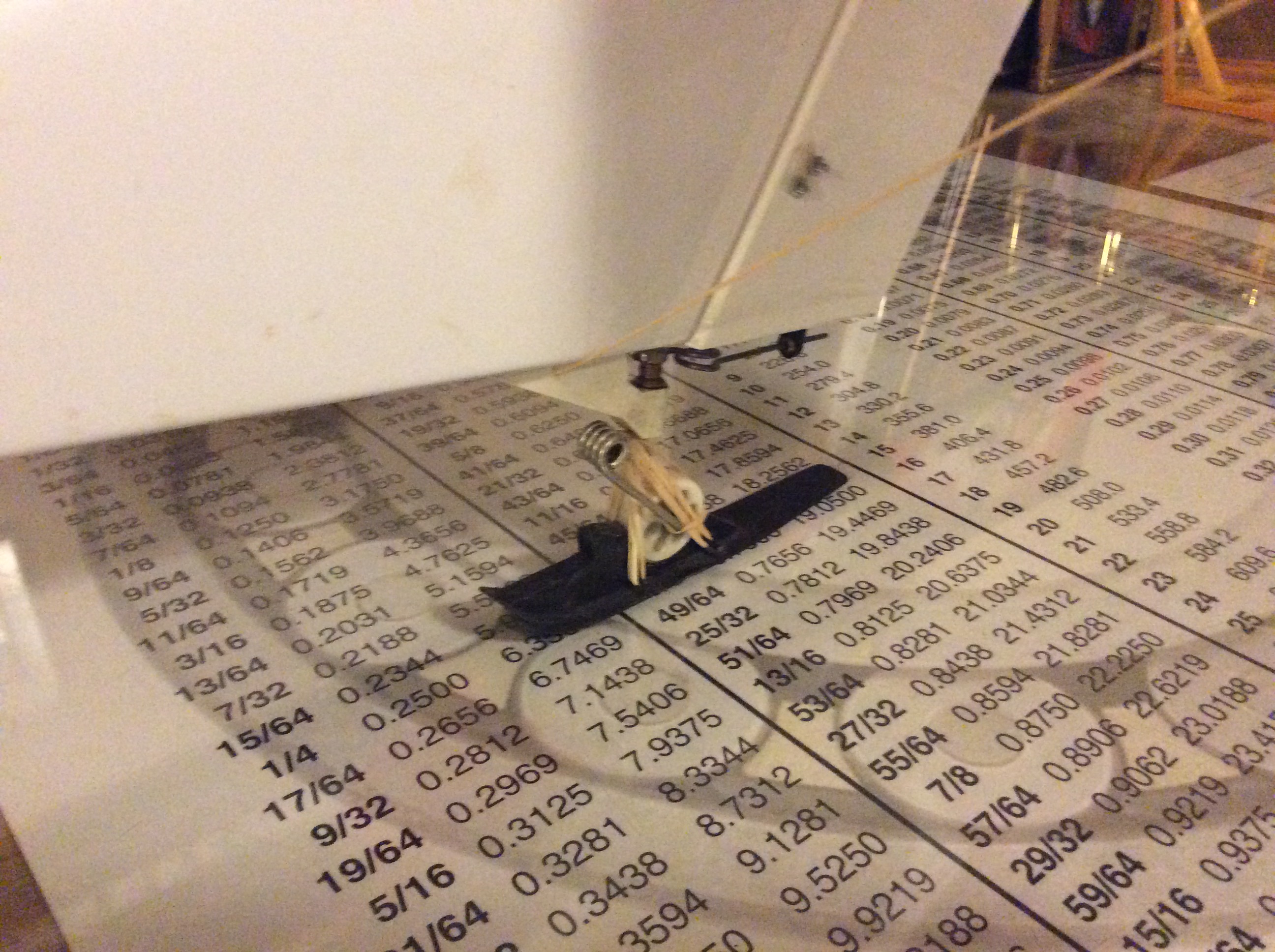

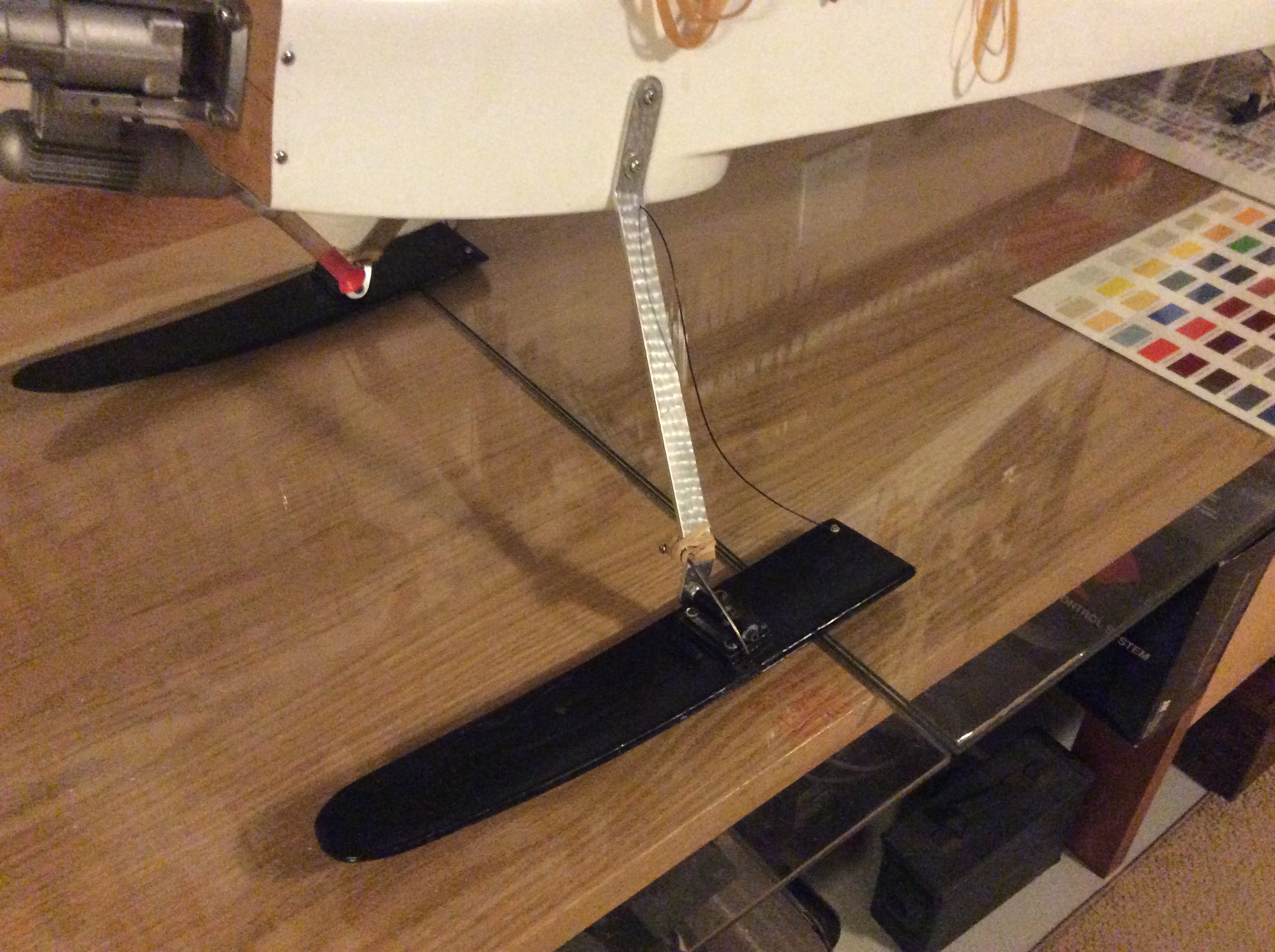

Well with the snow on the ground it was time to to get the winter plane ready for the winter. Got the three skies installed on the plane and the engine covered up so that it can operate properly.

Look at this at #8998. These skies I designed and built. At one stage in my early years of rc planes I just loved flying in the winter I actually enjoyed it more than the summer. The skies you see on that plane is years of development. Every year I would build a new set and what you see is the end result. If you would like more info just ask.

Where am I looking?

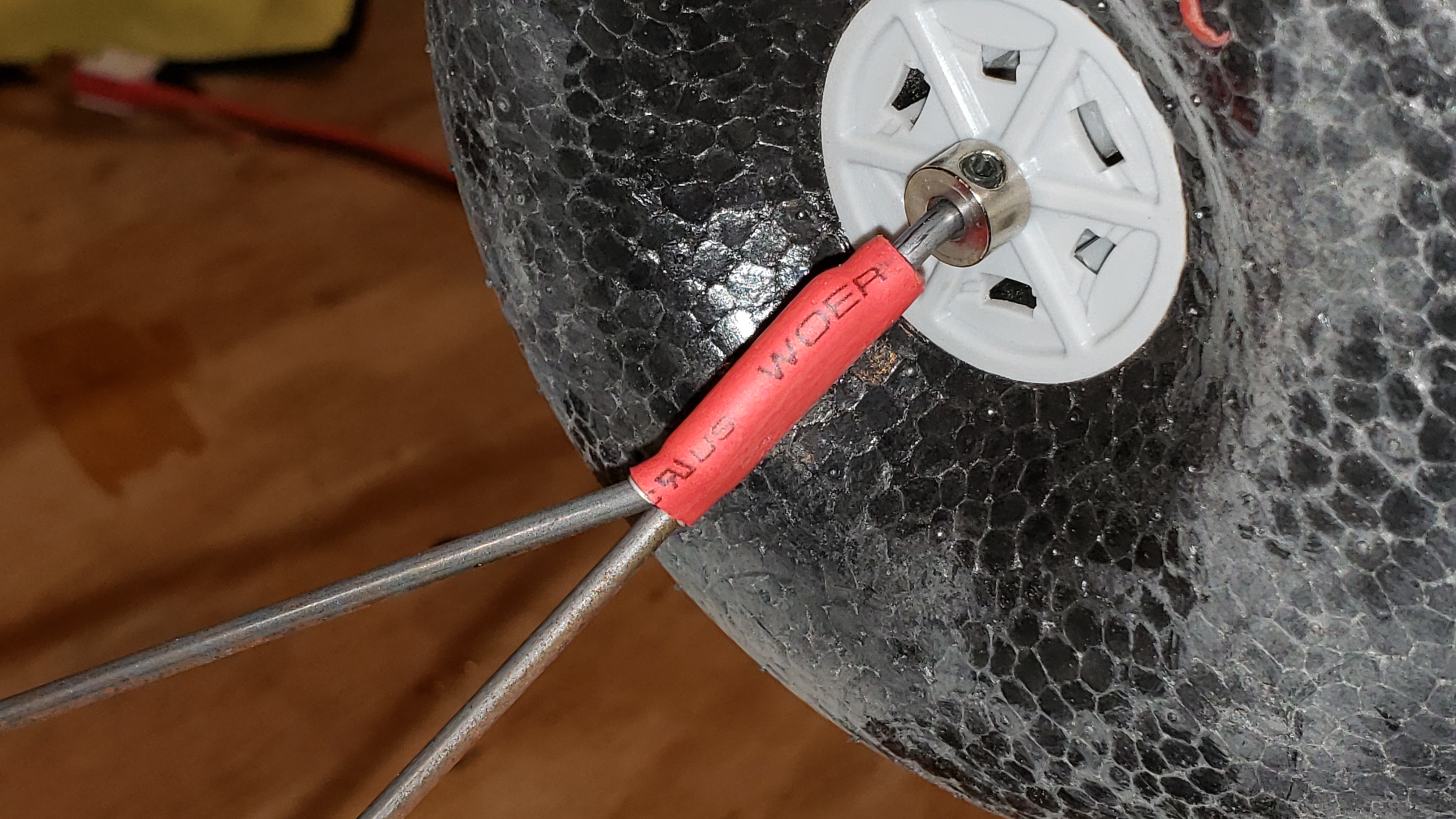

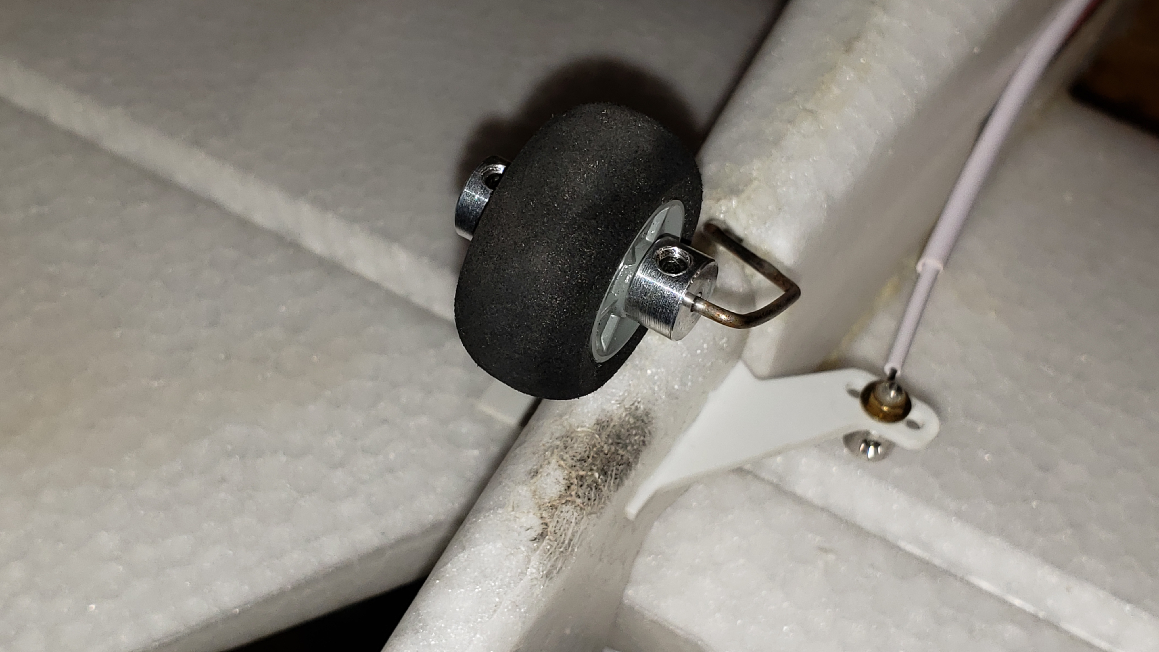

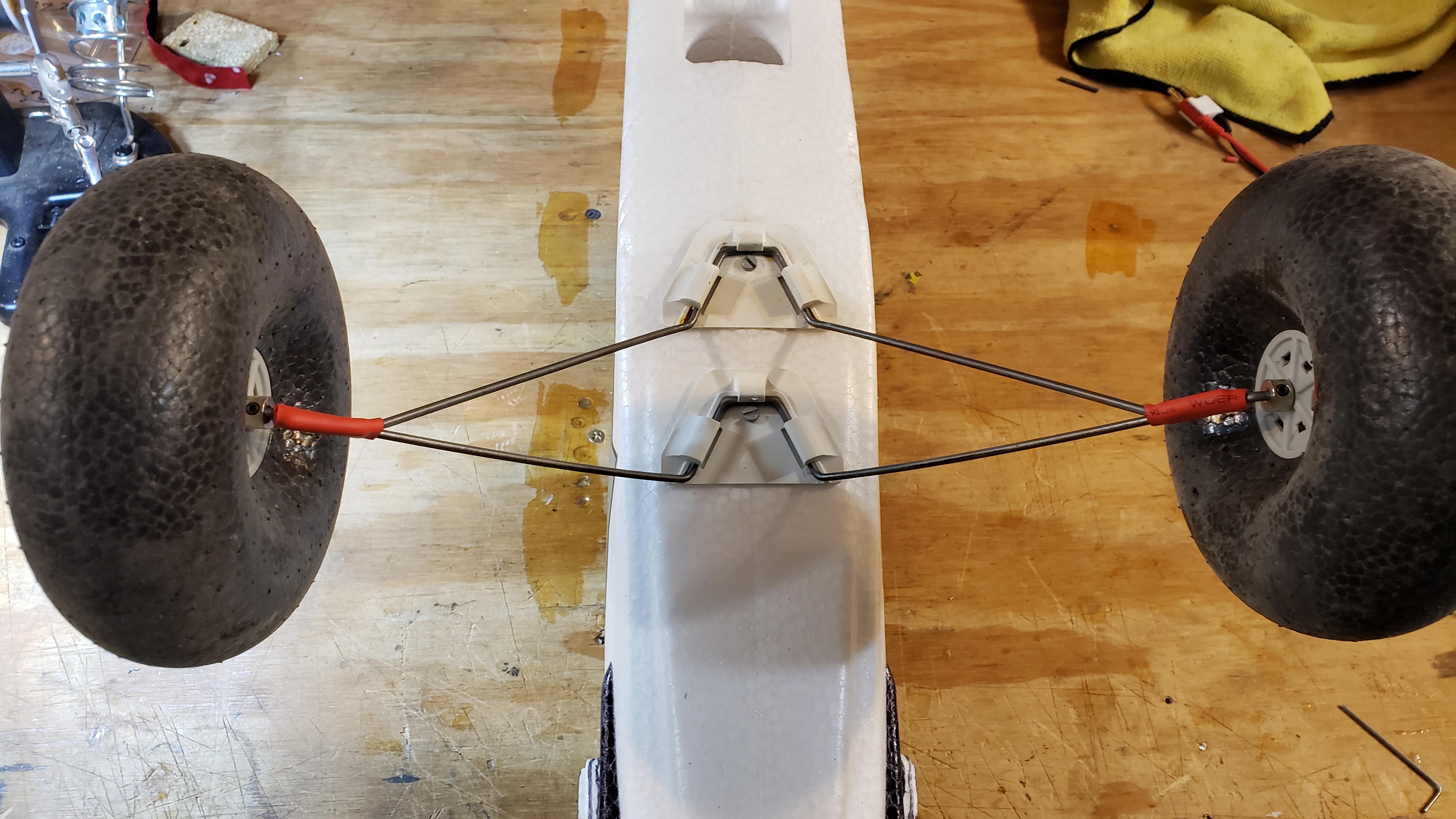

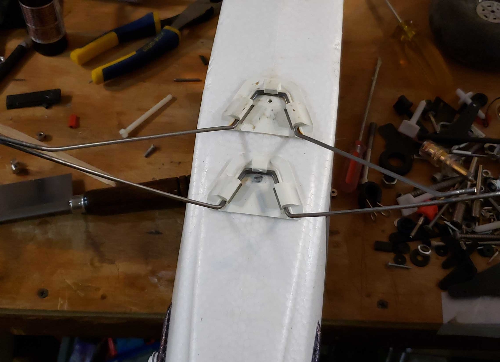

Did a little mod to the FunCub last night. Over the weekend I noticed the landing gear was being a little too flexible which was causing the prop to drag in the soft sand on short landings. Had a spare landing gear wire and mounting block, bent and cut the wire to shape then used some industrial strength marine heat shrink tubing to secure the wire ends together. This stuff has a hot melt glue in it that bonds to everything and dries very stiff, should hold up real good :cautious: I also ditched the lame tailwheel in favor of a nice soft foam one I had from a wrecked Rockstar. She aught'a land real nice and firm now.

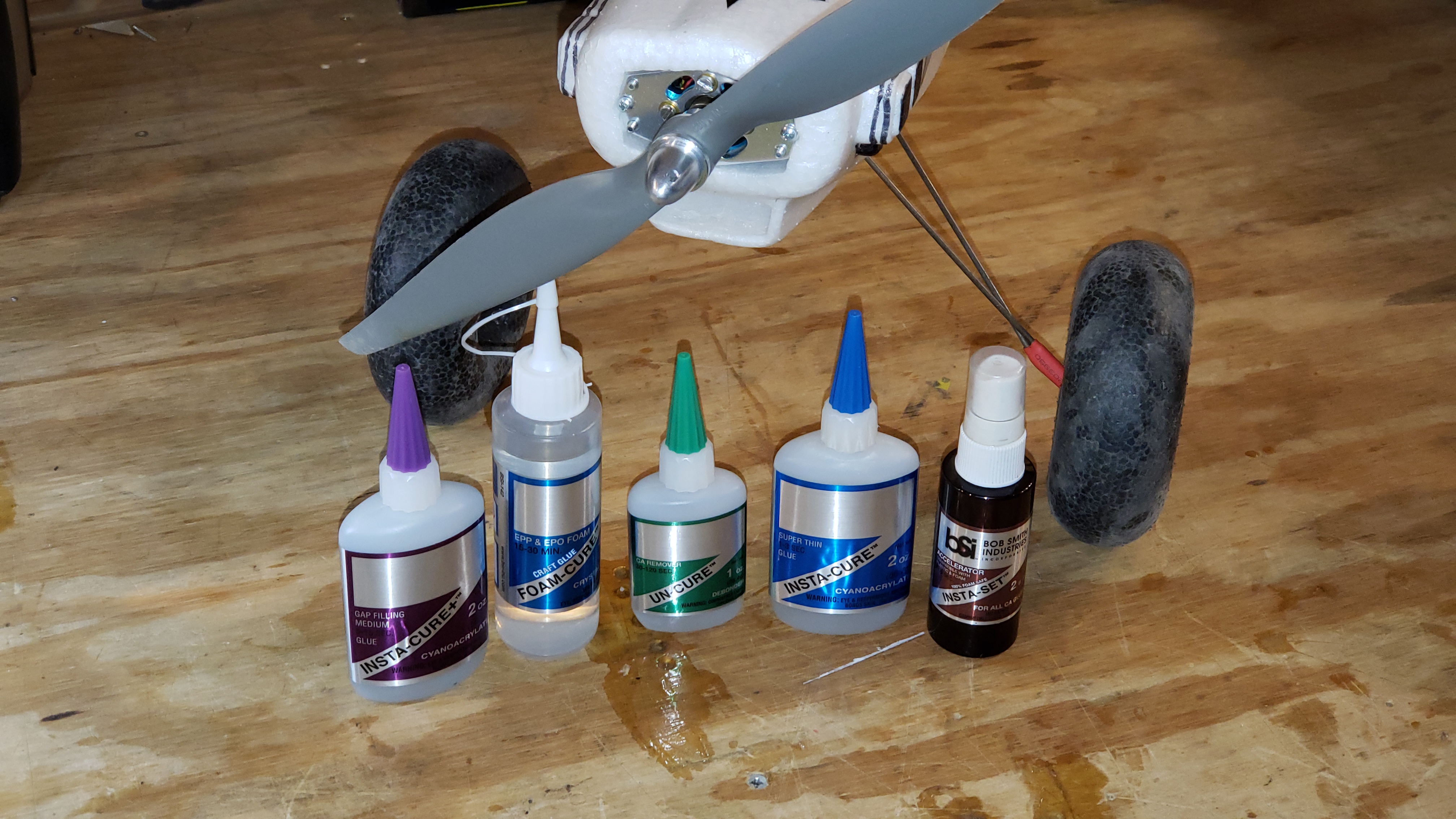

Little shout out to BSI Adhesives. They have always been a top tier glue manufacturer for me, and their brew quality is extremely consistent from batch to batch. I used all of the products pictured below on my little mod, and always suggest them for any glue work on Multiplex Elapor models :yesss:View attachment 106814
Nice mod!!
