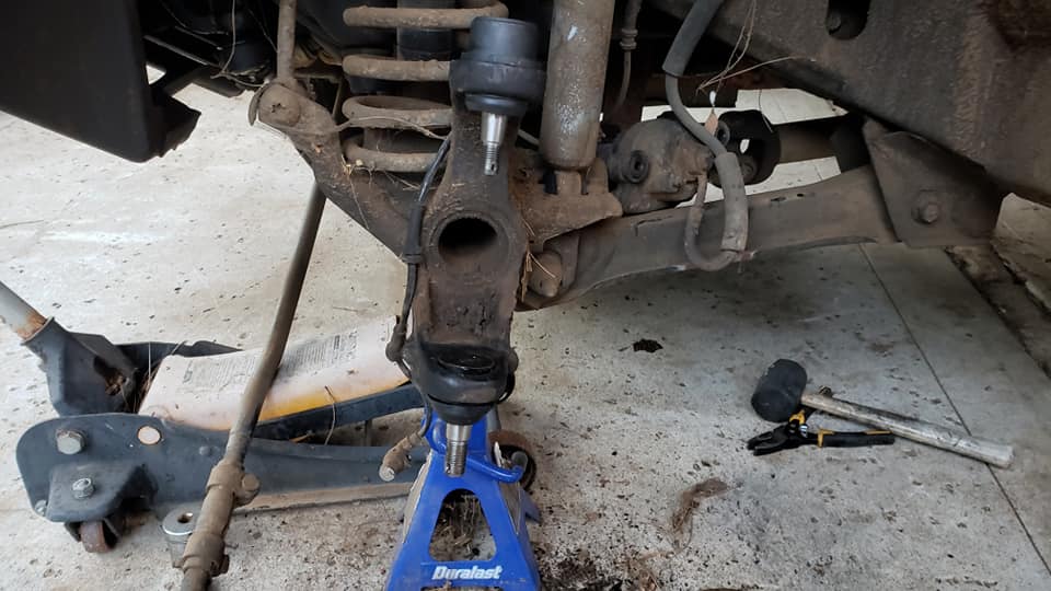

As rusty as that stuff looks I'd swear it was from here in the midwest.I am SO ready to get back to working on something not made of metalDid the driver and passenger side ball joints on my Jeep, the passenger side lower was being a bear and not wanting to press in straight. That's one obstacle out of the way
Does yours have the rear disc brakes? Those can be tons of fun when they're rusty. The rusted up emergency brakes on my brothers 2012 Liberty really sucked.
 Working on stubborn car parts is quite a feat. One day I'll get smart and pay someone else... until then....
 Working on stubborn car parts is quite a feat. One day I'll get smart and pay someone else... until then.... I shall curse, and curse I shall.

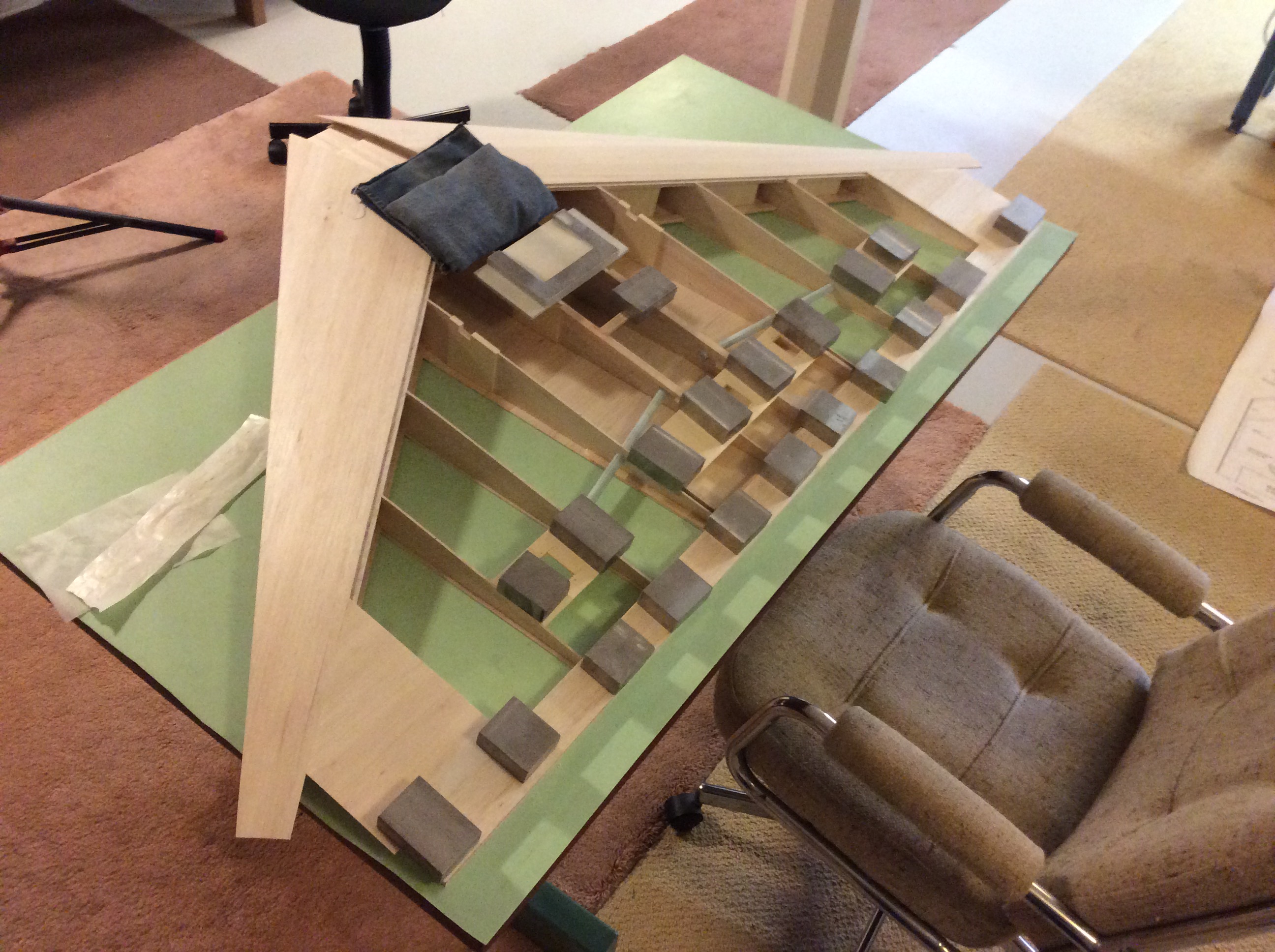

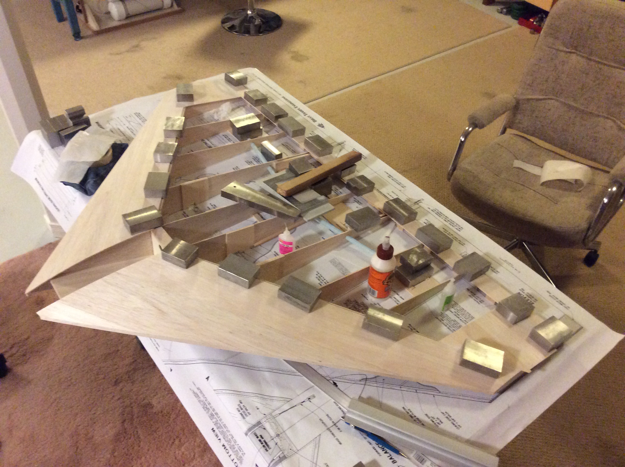

 I shall curse, and curse I shall.The delta is coming along slowly got some more sheeting done and the wing tips done on one side. All the shear weds are in. Need to get the centre section sheeted and then lift it off and flip it over.
Nice steel blocks for weights. Where did you get them?
Dang son, that wing is kinda cool looking. And the steel weights are very cool too. I see you answered the question previously asked on where you acquired them. I was curious also. I could use something like this. As for interest in your build...you just keep the photos coming. Believe it or not, there are numerous people....(me) that can always learn a new trick or two. Old guys rule...right Earle? But we can still learn new tricks.Guys I do not know if I am giving to much details and pictures on the Delta build. My concern is that I am sure if there is a lot of interest in this type of plane please let me know.

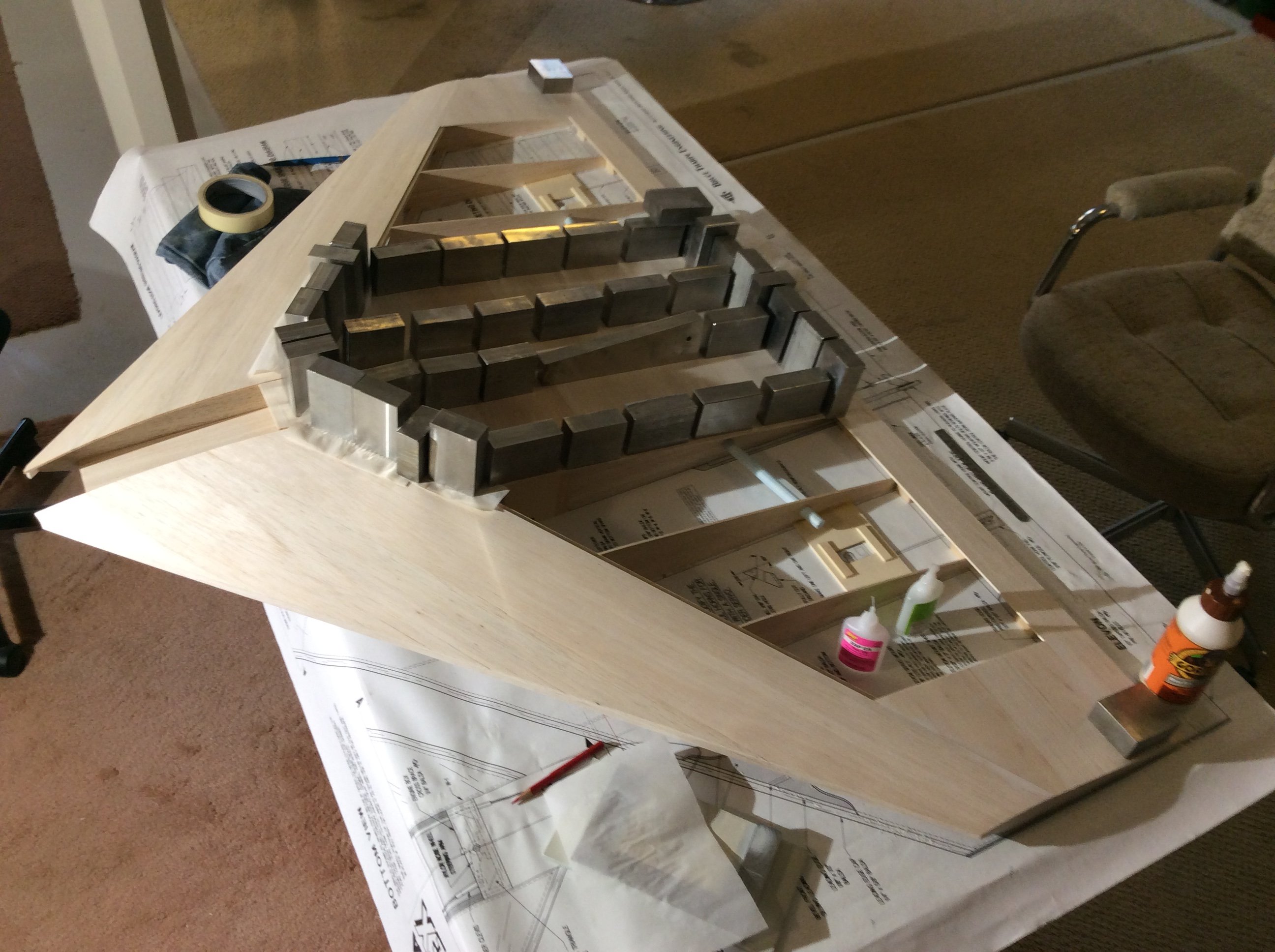

One picture of the centre section this is a little difficult to get right most use two sheets and join in the center. But what I did is wet the bottom so that the sheeting with the amount weight used conforms to the dihedral angel and the curve of the ribs. Takes a little doing once it fits it looks clean and no seams down the centre and stronger.
