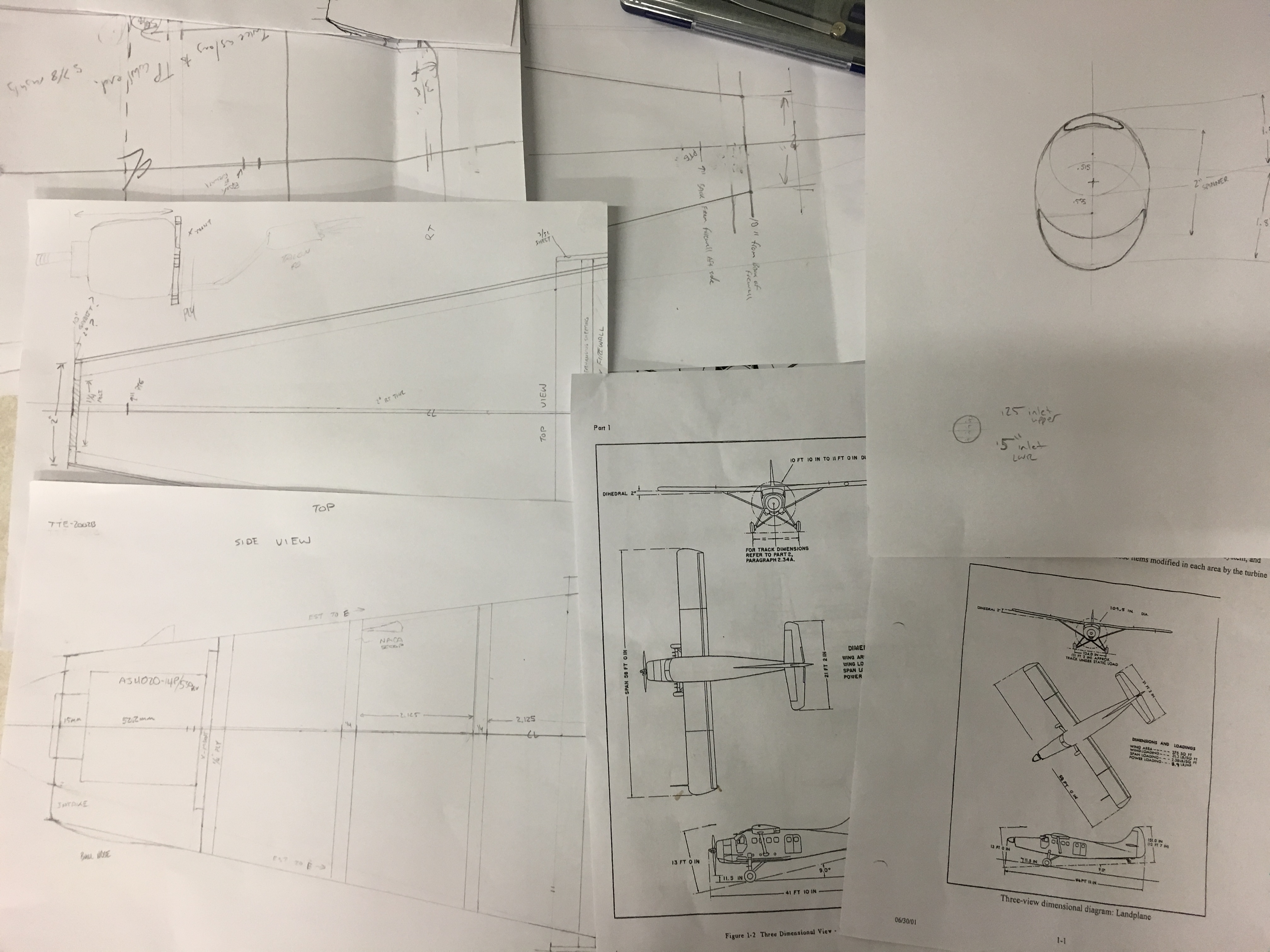

The blue prints are coming together. Little factoid, the otter when turbonized added 5.08 feet to the planes OAL. That’s a 10.8% increase in length!!
Puts me at a 7” increase to the nose.
I’m thinking of just plugging some balsa formers every two inches with 1/4” sq balsa along the outside for support and sheeting it. Should be plenty strong...? Especially with a few gussets in place. I’m hoping a motor for a 60” plane should fit nicely. So probably a torque 4016/500kv with a 2” spinner, 16x7, with a talon 90 should work. It’s basically the same size as my 84” TBM except a little smaller and heavier I’m guessing.

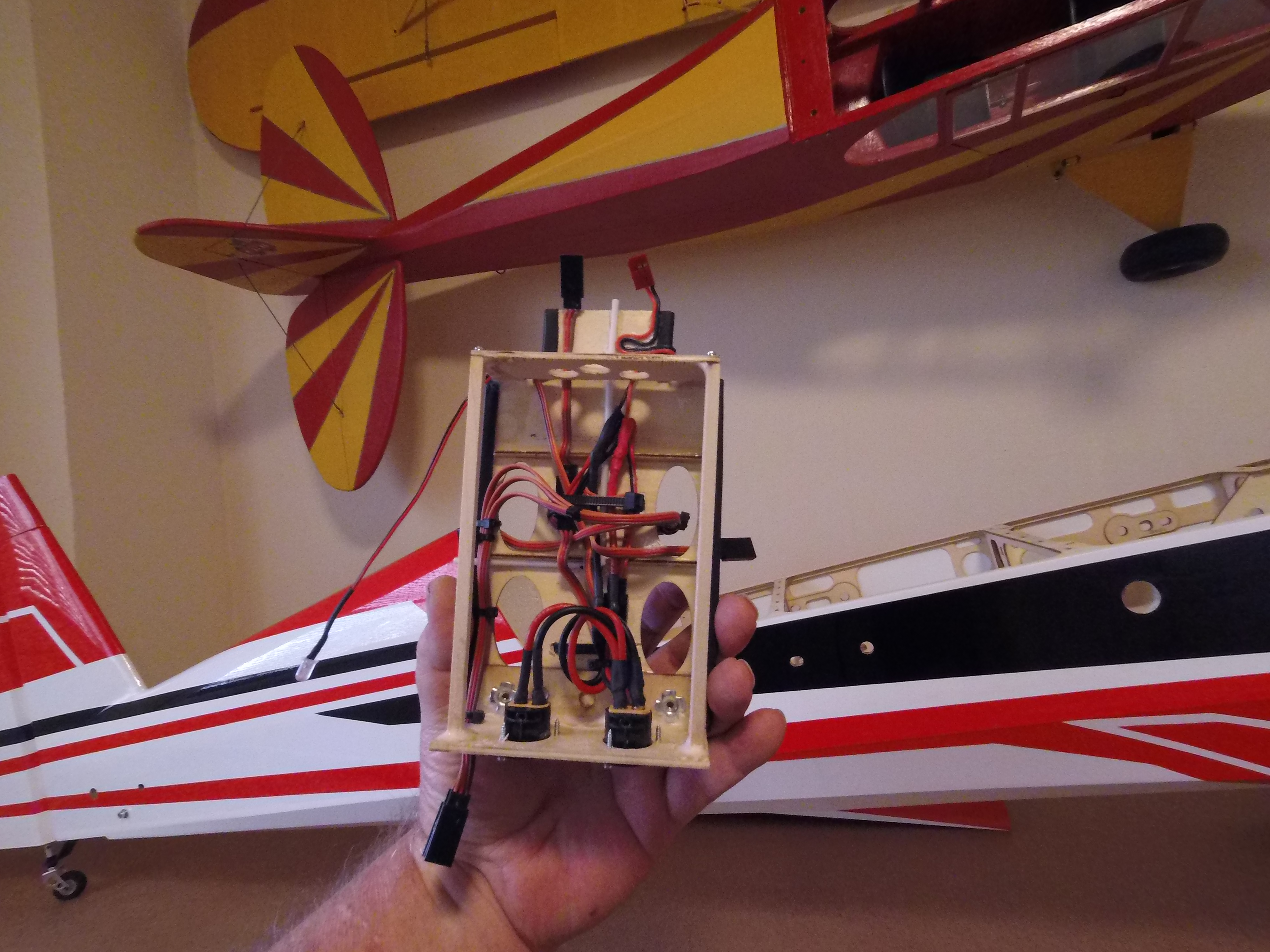

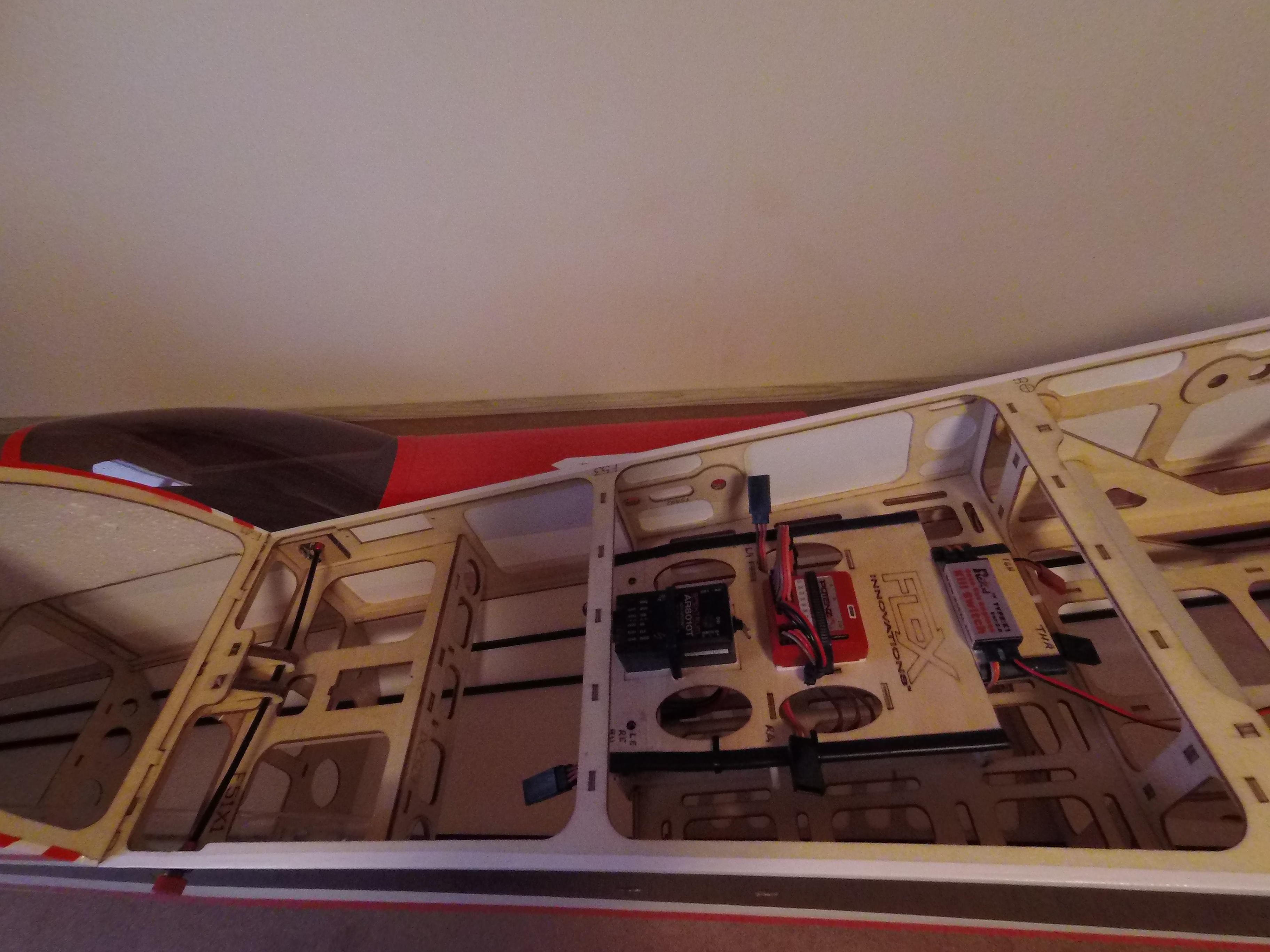

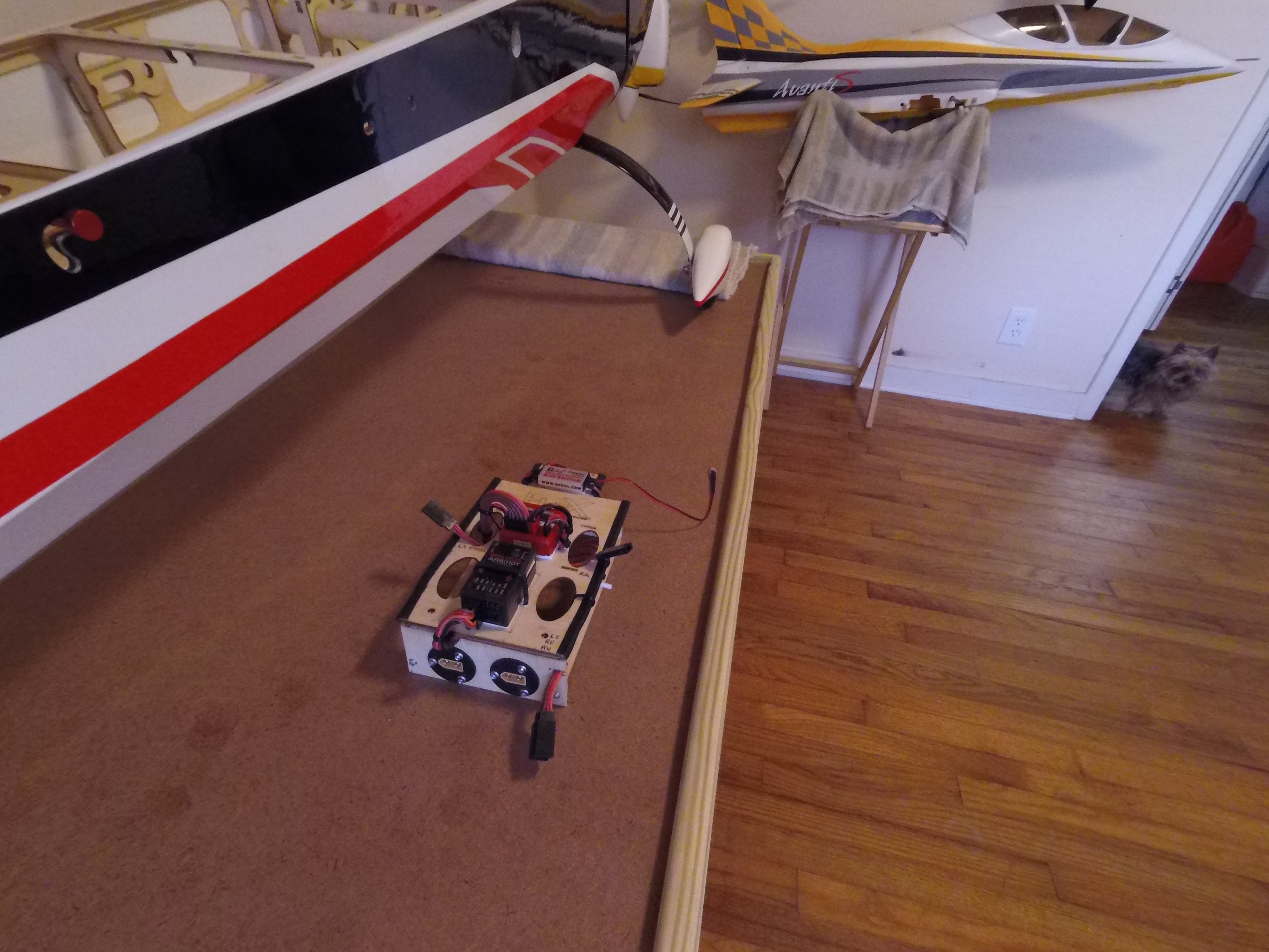

With all the "Electric Buzz" going around my half witted mind came up with a new Idea for a gasser....:ooh?:.
With Pilots new "Quick Release" Canopy system I decided to go "Switchless" o_O.
I made a removeable flight control board and "bused" power to "everything". Two 2S 2000mah Lipo's will get mounted under the rudder servo tray (One to the left of and one to right of rudder servo). All servos and ignition power simply plug in to it. To power up for a flight simply plug in the two batteries. When finished with a flight release the canopy and unplug the batteries. Like an "electric" :D.
View attachment 108273 View attachment 108274 View attachment 108276 View attachment 108277
