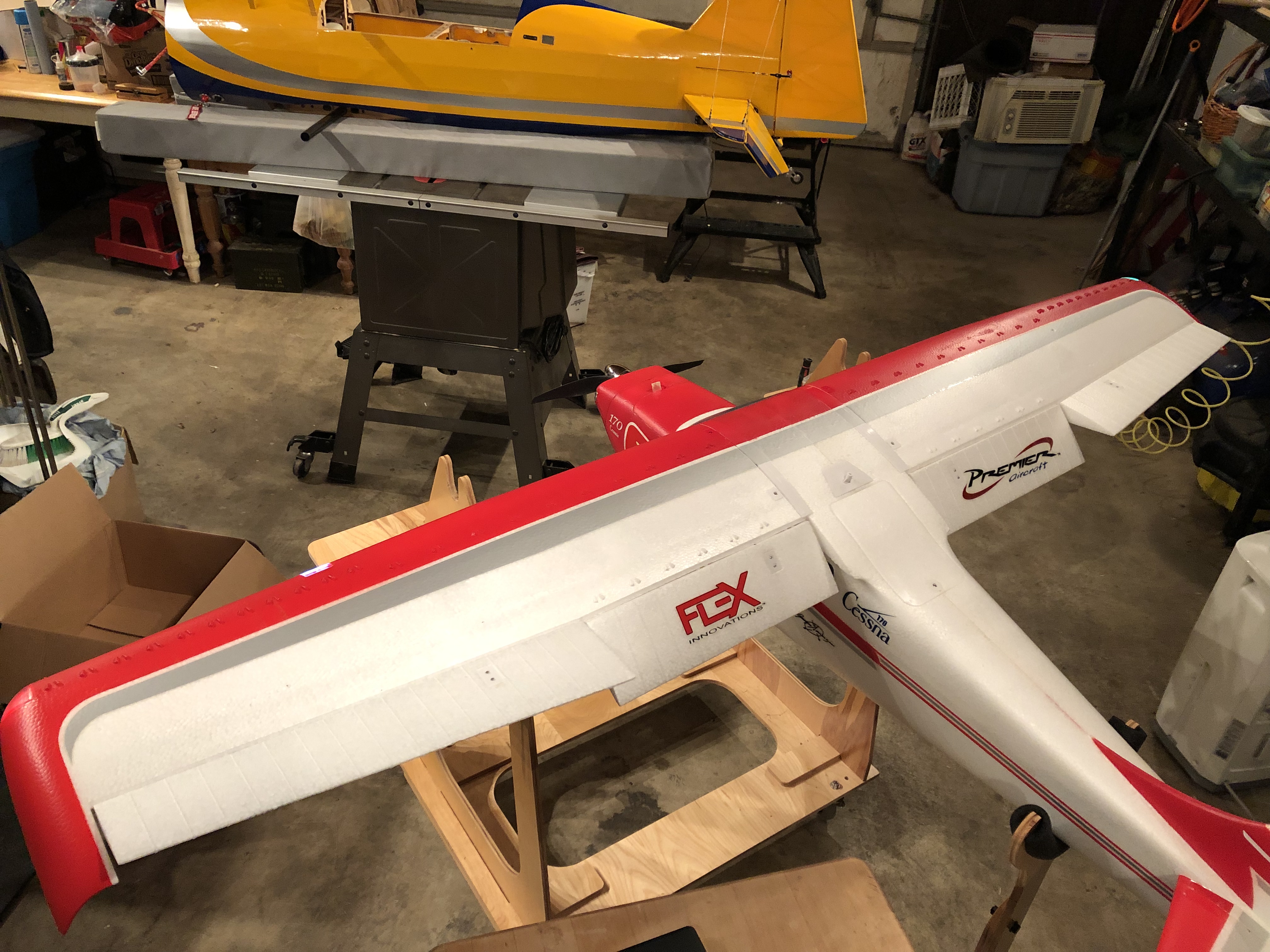

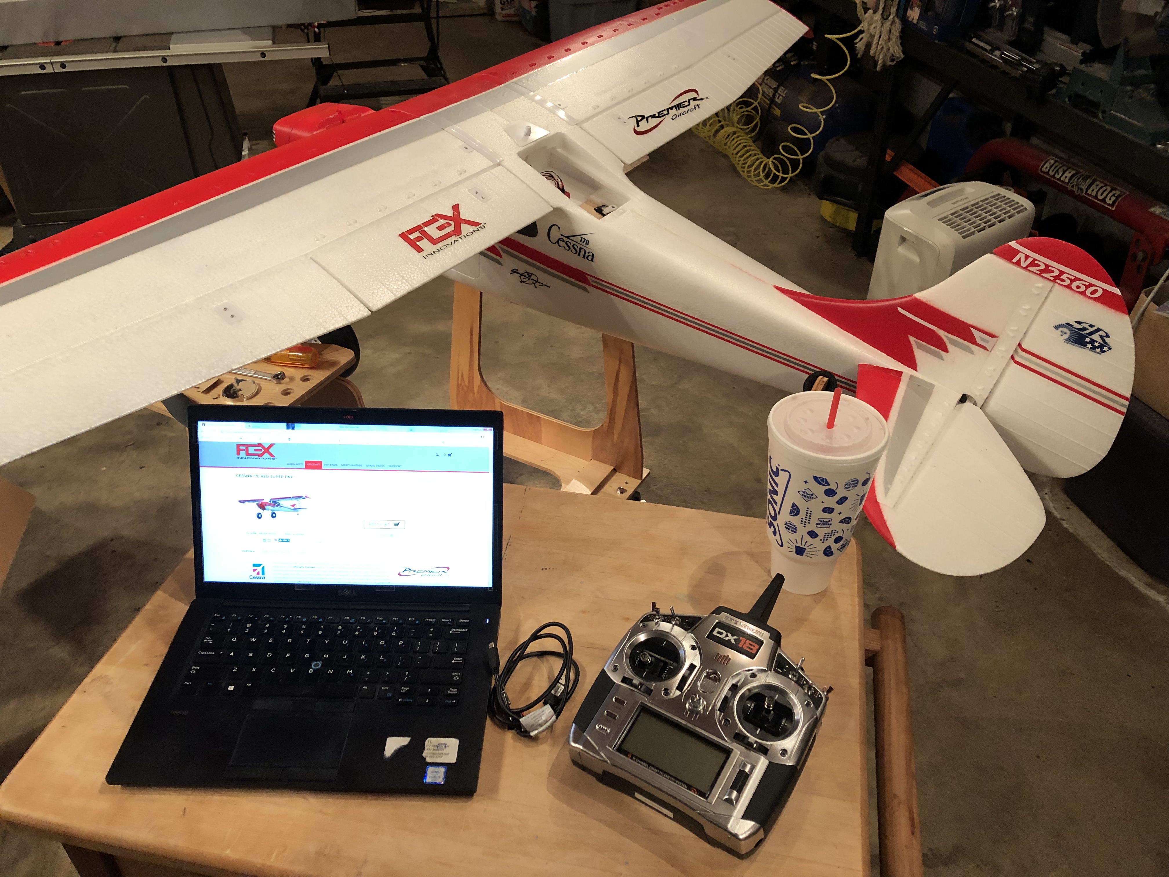

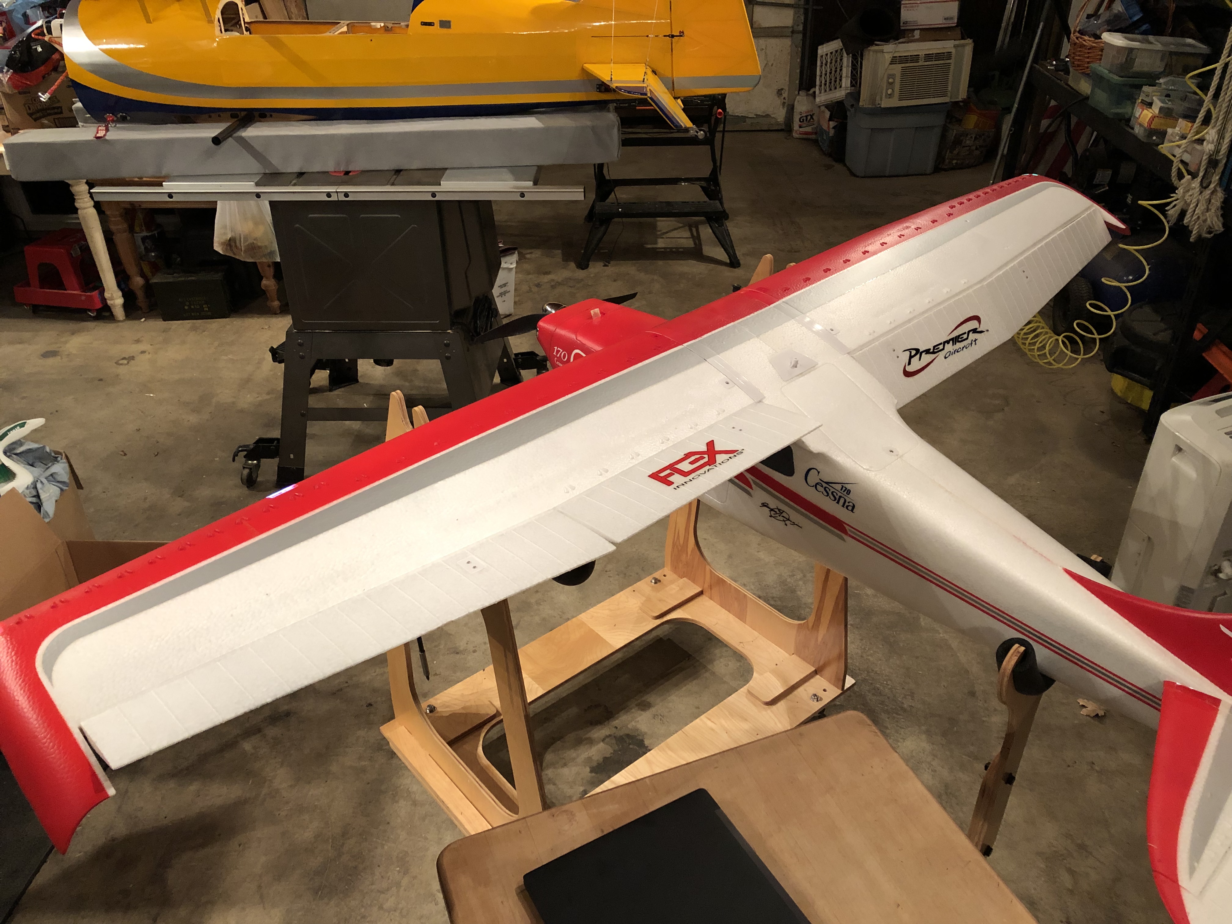

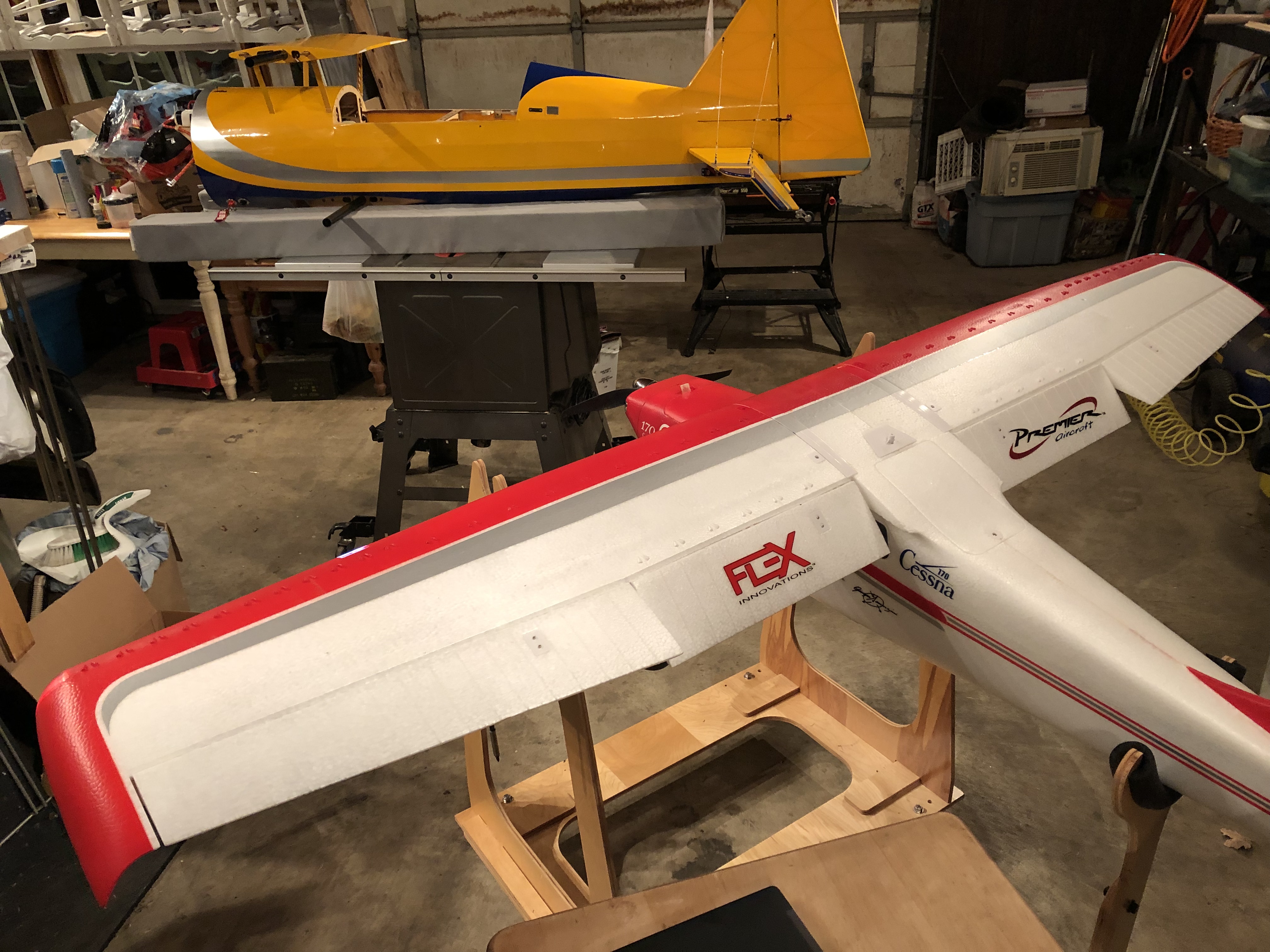

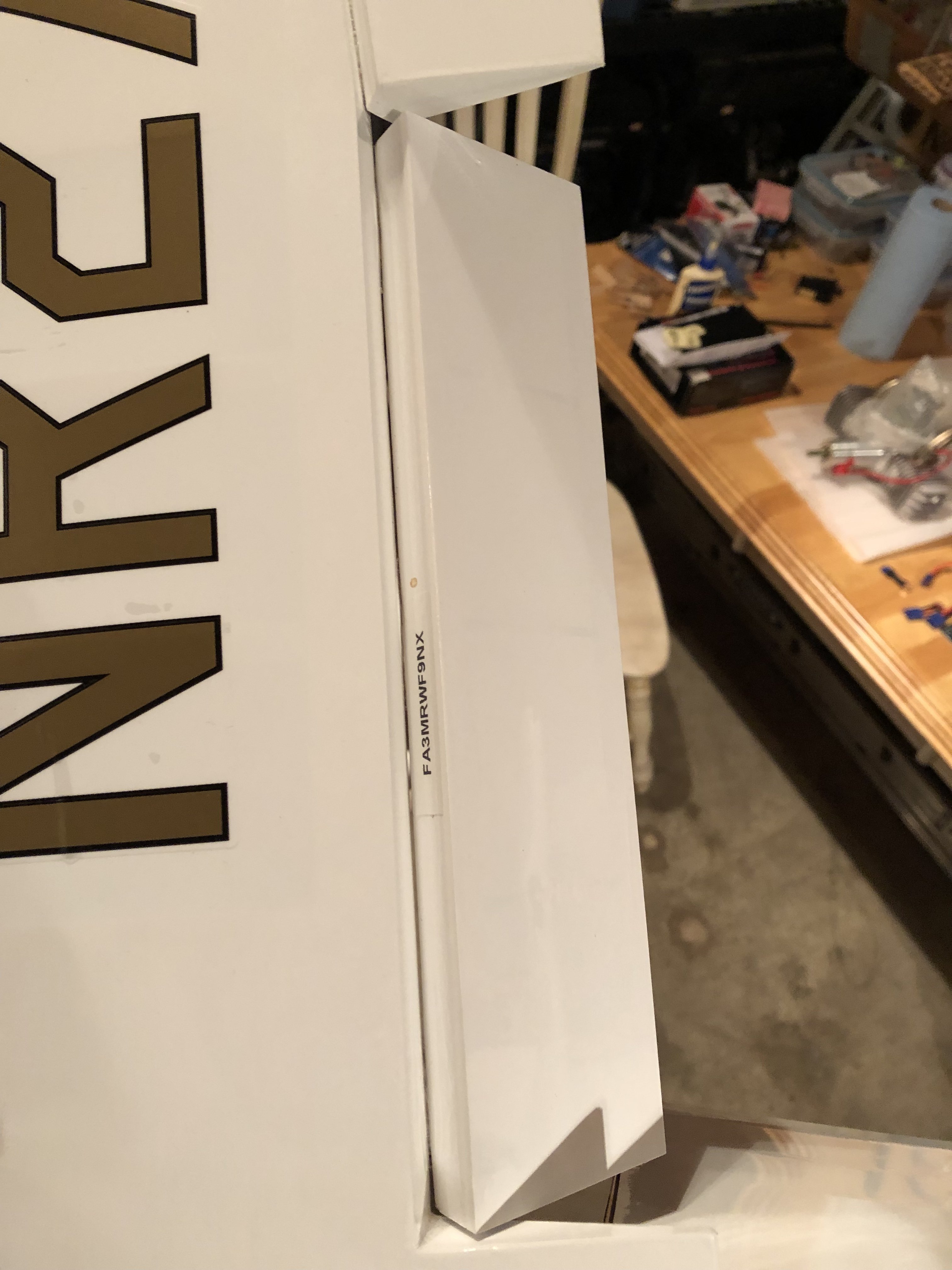

Tonight was all about fun with the Aura and Flex Cessna 170. I installed their Extreme profile which provides 3 Flight Modes with Crow and full span ailerons in addition to the normal ailerons and flaps. Took a bit of configuration to make it all work correctly, but I’m very pleased. Can wait to fly this thing!

That is one very good plane and it fly’s absolutely wonderful.

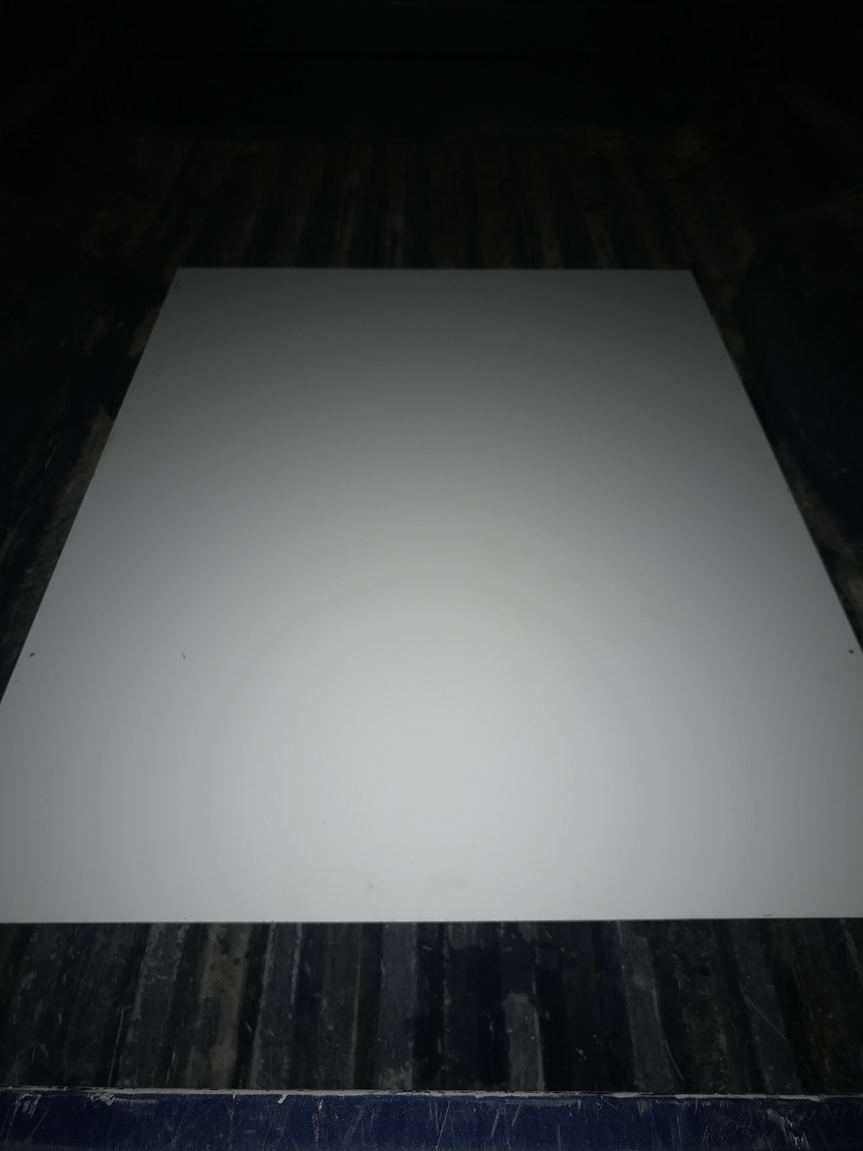

This should be fun to try out but not sure when. At work they where going to throw out a nice magnetic sign. On the other side is work stuff but this side is nice and clean. Might I also mention it’s dead flat and 3’x4’ so it will be perfect on smaller builds to try out building with magnets.

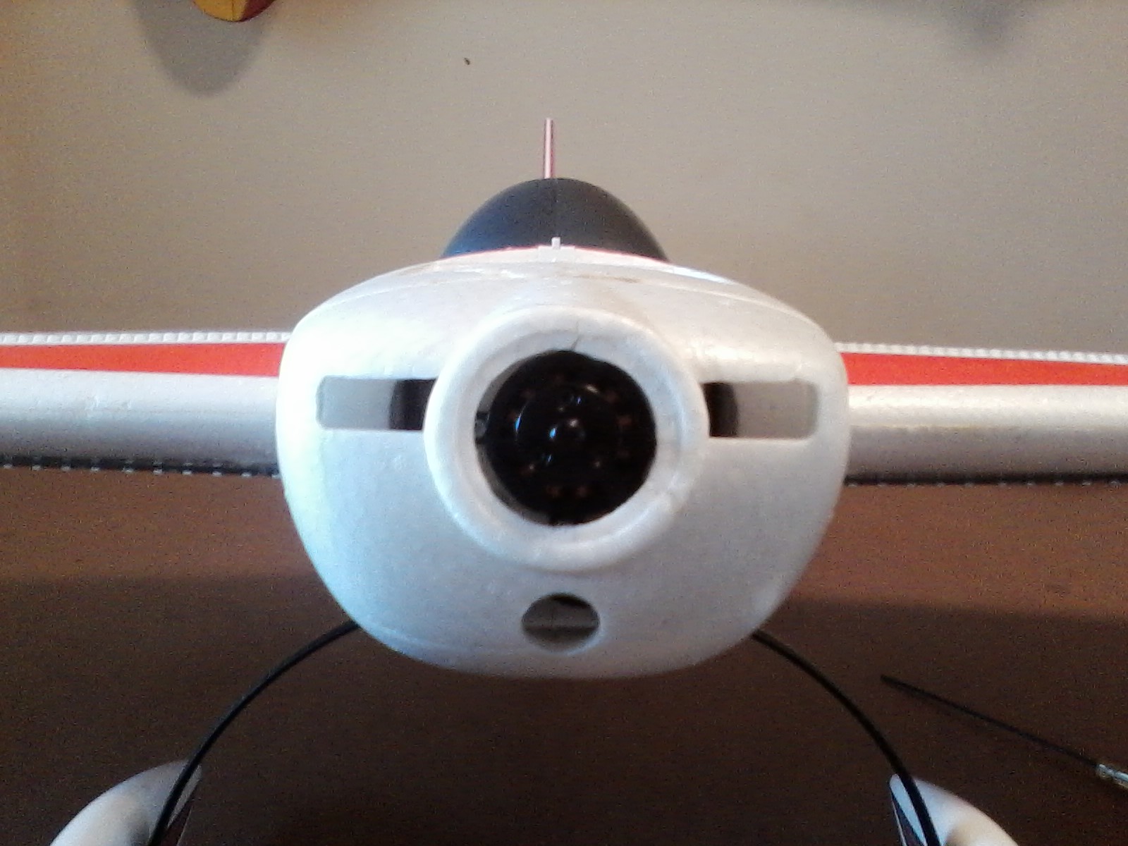

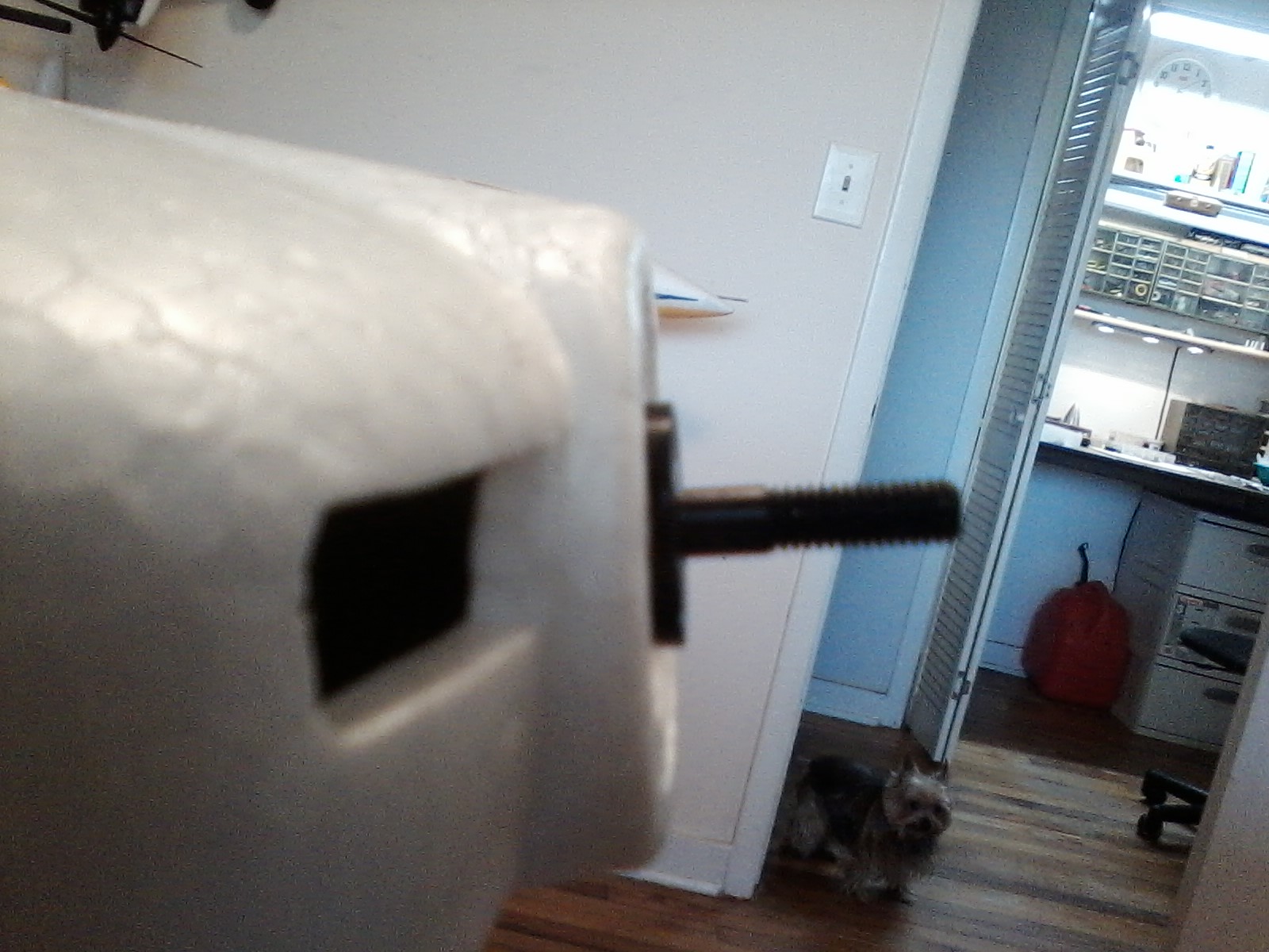

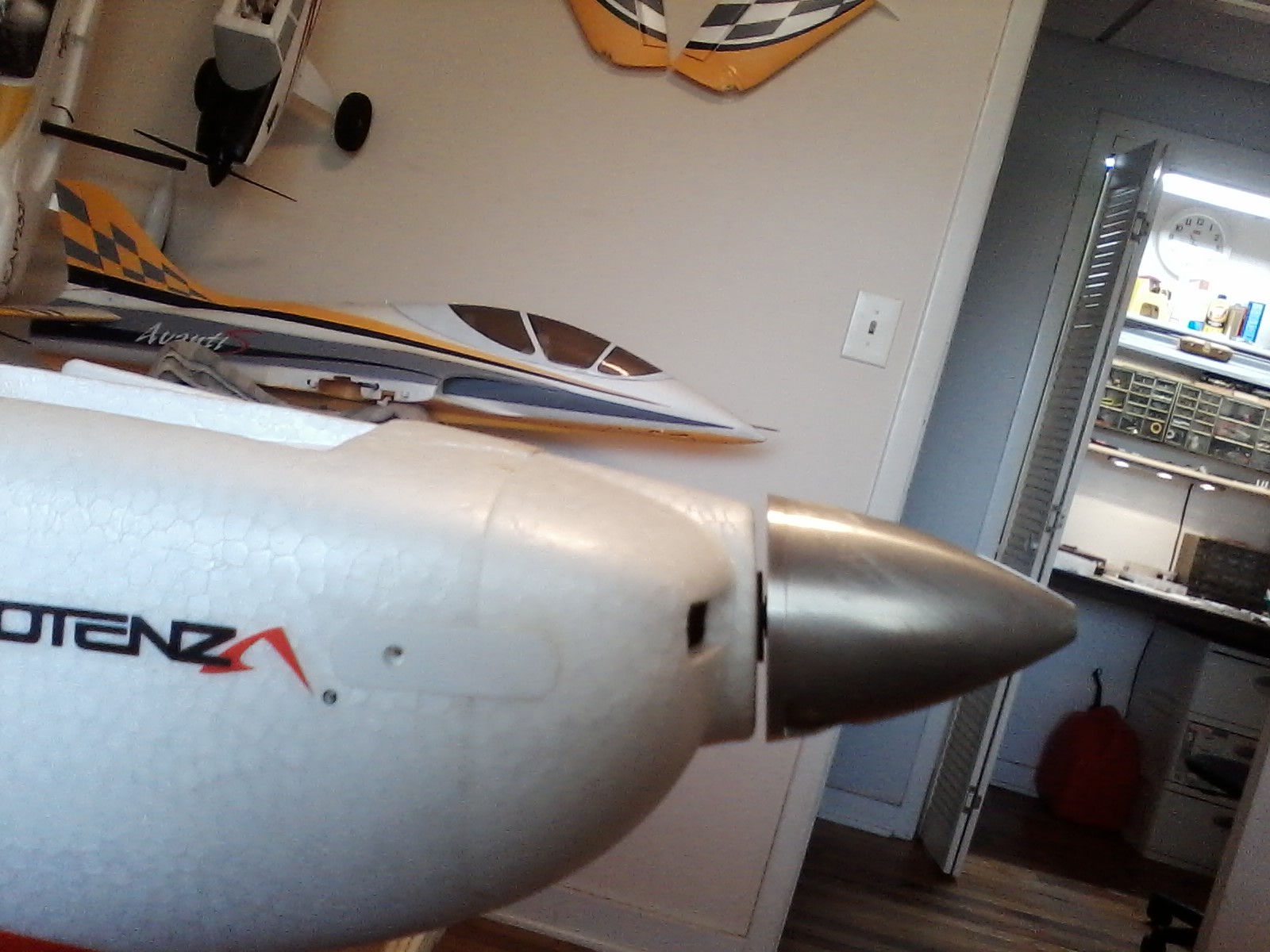

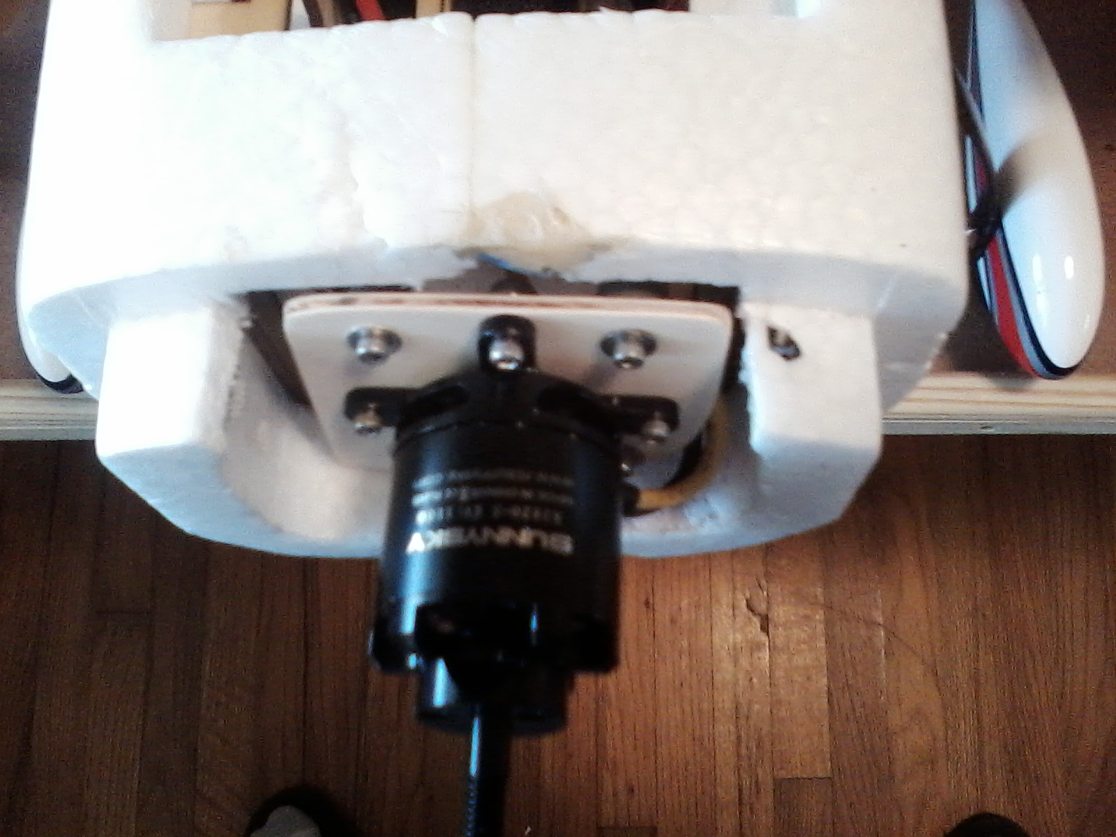

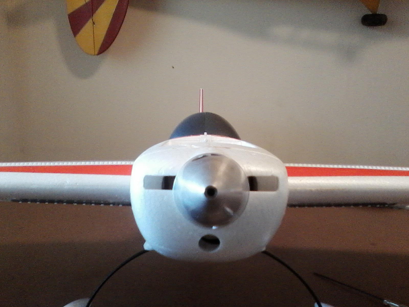

Got my "SunnySky" motor all mounted up to the "Not your mothers QQ300" :D.
Just need to find me 12x6 prop and 54mm electric spinner. The 2.25" aluminum spinner shown is too big and heavy. A 4S 3000mah pack will do the power up of this HV hybrid. Will need to make some adjustments to the Aura 8 so it handle's the boost in performance smoothly. Flying weight has gone from 3.2 to 3.8 pounds with all the mods and bigger battery. Hope to have performance similar to the QQ CAP 232EX.
