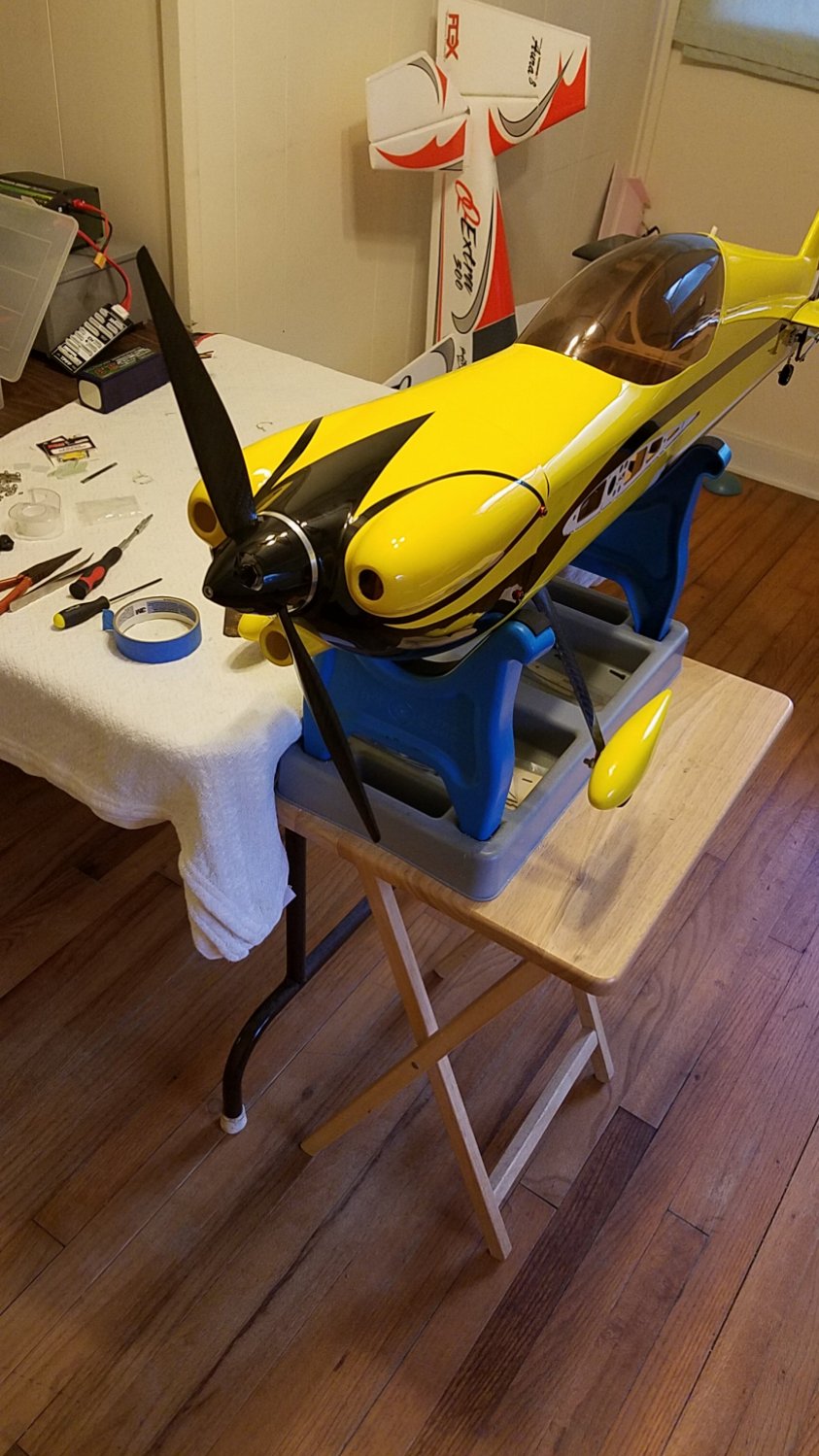

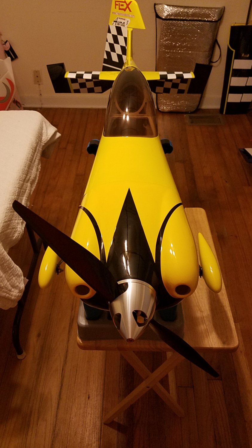

Had some trouble with the servos in the 330sc so more than likely it will be fall before I can give a flight report with a big gasser and this radio. I have directed my attention back to the electrics and will have an EF 64" MXS ready to go shortly with the radio and an Aura 8 .
20160624_202304.jpg 20160622_173332.jpg 20160622_173344.jpg 20160624_052157.jpg 20160624_052100.jpg 20160624_052231.jpg 20160624_202241.jpg
The Turnigy SK3 5055 is a powerfully smooth motor and turns the 15 x 7 carbon to "Beast Mode" quite nicely with out even breaking a sweat :). This project is SOOOOOO Mo Betta Than that CHEAP HK Plane:epic:.

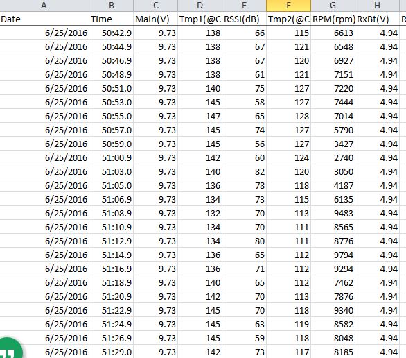

There was about a 20 - 30C degree temp difference between the fins, located in the back of the engine, pushed up against the 2nd fin, which and pushed up to the head, and held in place with silicone tubing vs the ring under the spark plug.
Attached is the file from todays flying session. Temp 1 and Temp 2 represent the individual cylinder head temps, and all are measured in degrees Celcius. It was a 30 Degree C today, no wind.
Engine is a CRRC 55 GFii Twin, spinning a 23x8 Xoar CF prop.
Plane is a Yak 54, 88" Wingspan 18Lbs. engine is baffled.

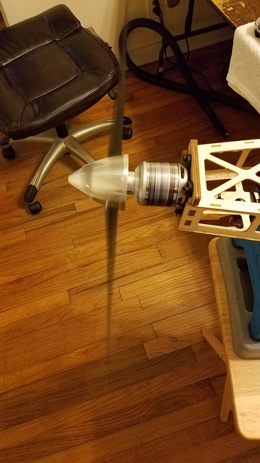

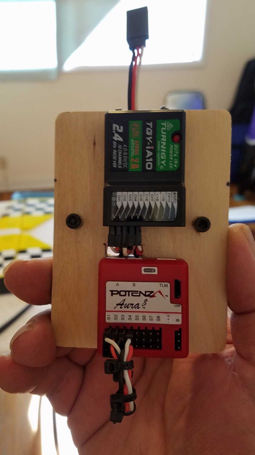

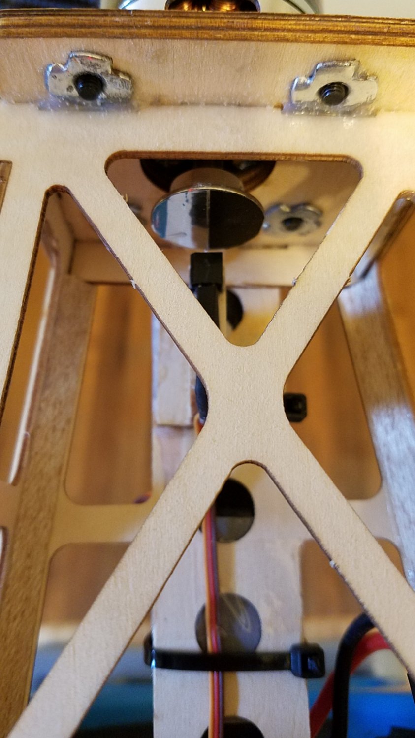

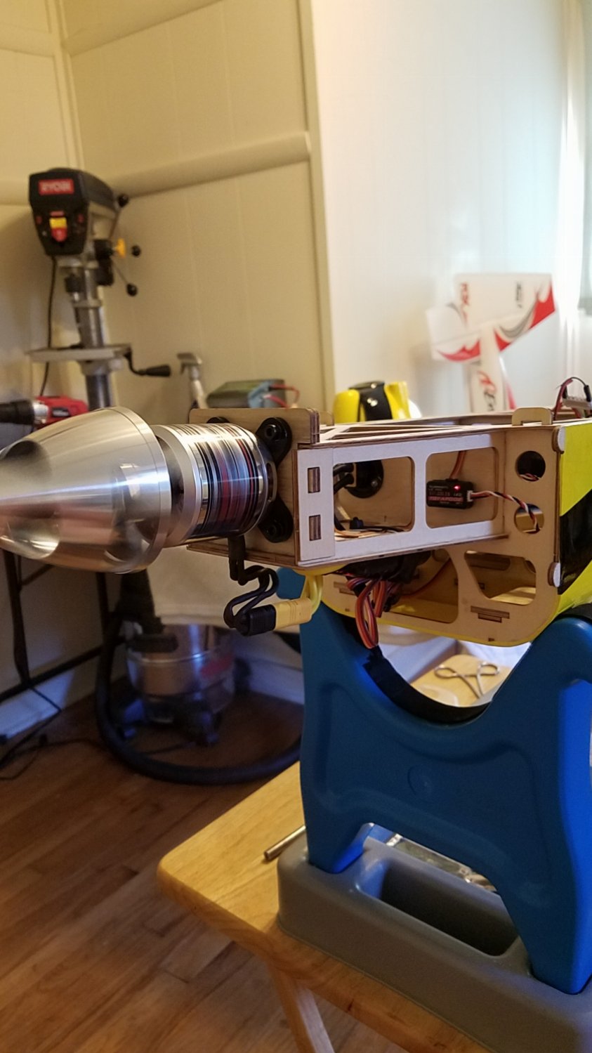

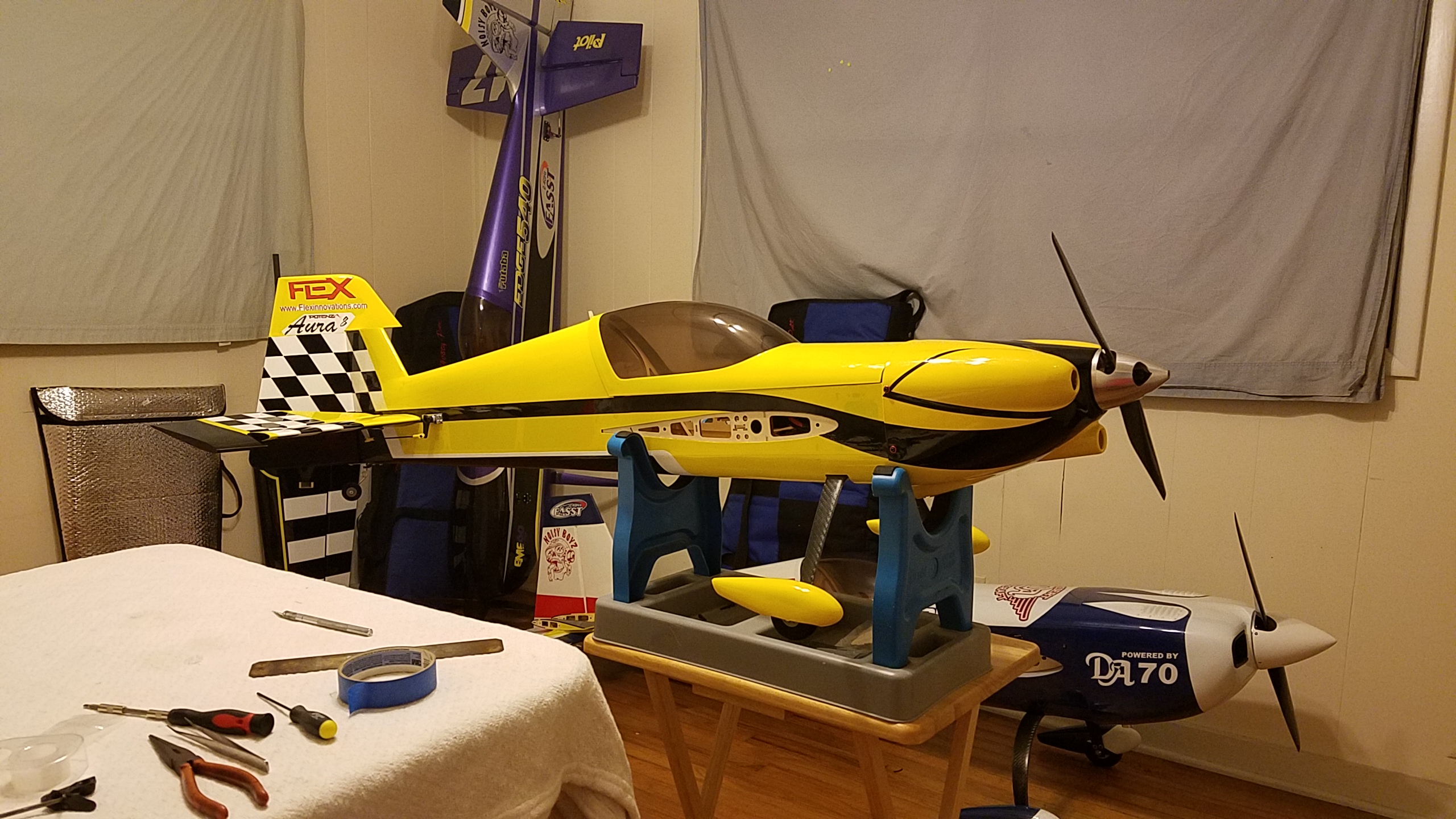

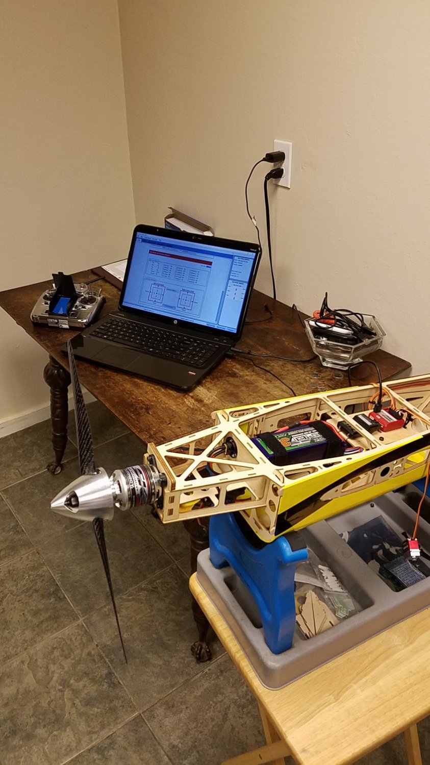

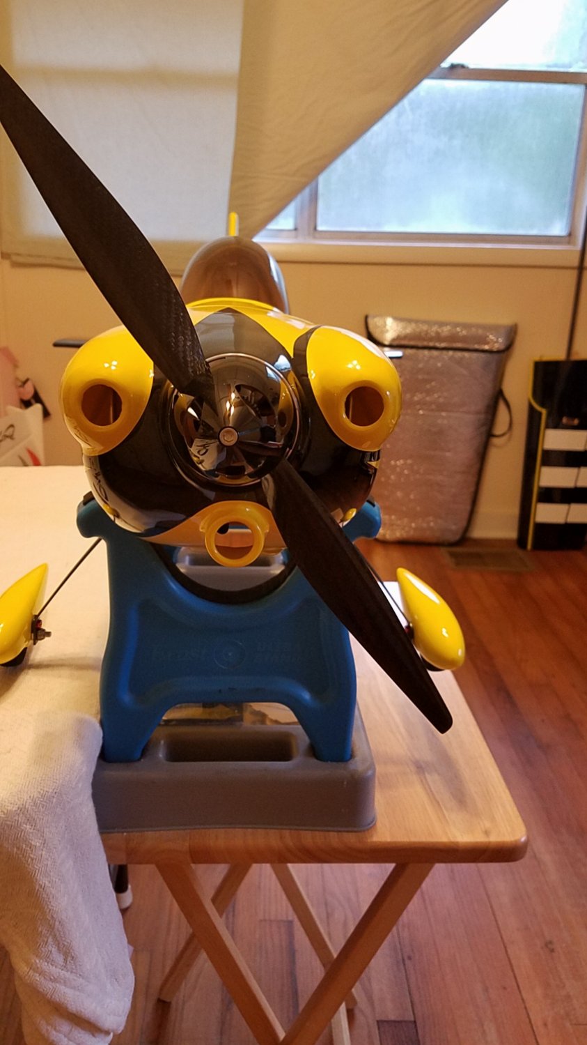

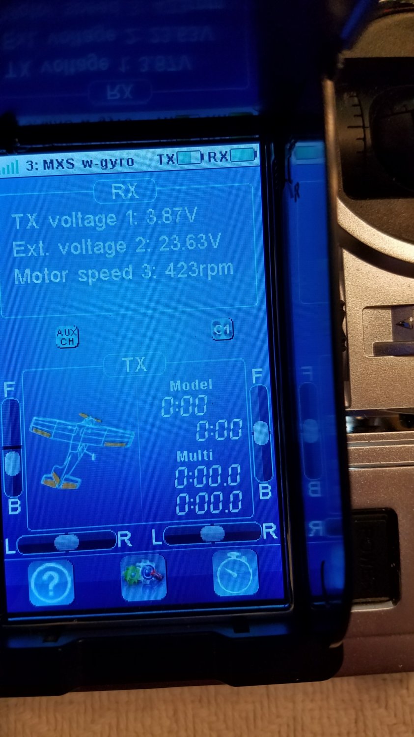

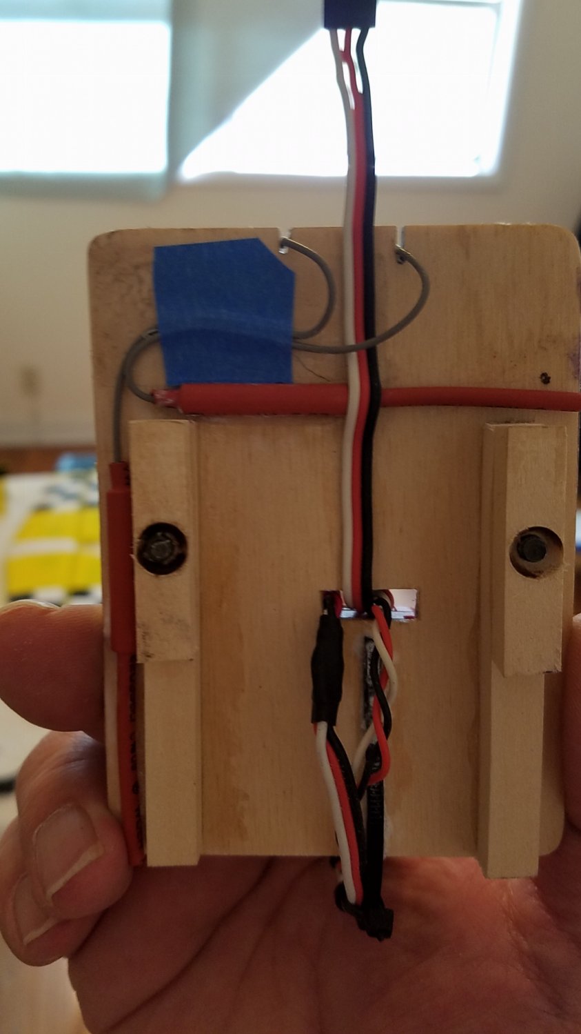

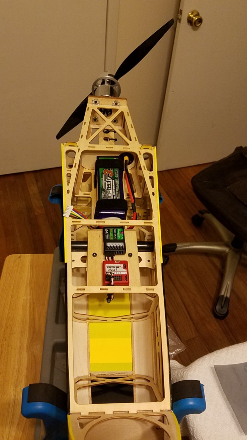

Installed some telemetry. Power Pack voltage is monitored. Receiver voltage is displayed as a battery Icon (always will show full due to BEC). Transmitter voltage is displayed both ways in volts and an Icon. I made a optical reflector for the rpm sensor out of a large wheel collar and punched steel cap from a old fuel tank stopper. Attaches to motor shaft with a grub screw.

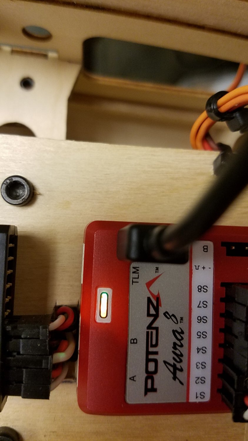

I still have the wings to finish but that is easy peasy and hope Saturday morning will yield cooler temps so I can get a radio check done and some flights in. Need to order some more temp sensors so I can get the motor monitored. @Snoopy1 you had mentioned for me to tell the bad things about the radio. Way earlier I pointed out I did not like the switch locations of the two long stem switches ( hard for me to reach) and that the Aura 8 system was not compatible and that a larger capacity battery would be nice. Well the Aura is compatible. I had to reflash the firmware to its original configuration to get the Aura to work. See; I had updated it to get the multi rotor menu but it included a controller configuration for on line fpv racing which screwed things up. I think you do not like the programming lay out and that's cool. You need to post too what you like and don't like. I asked for users of this radio to post here back on page 1.
