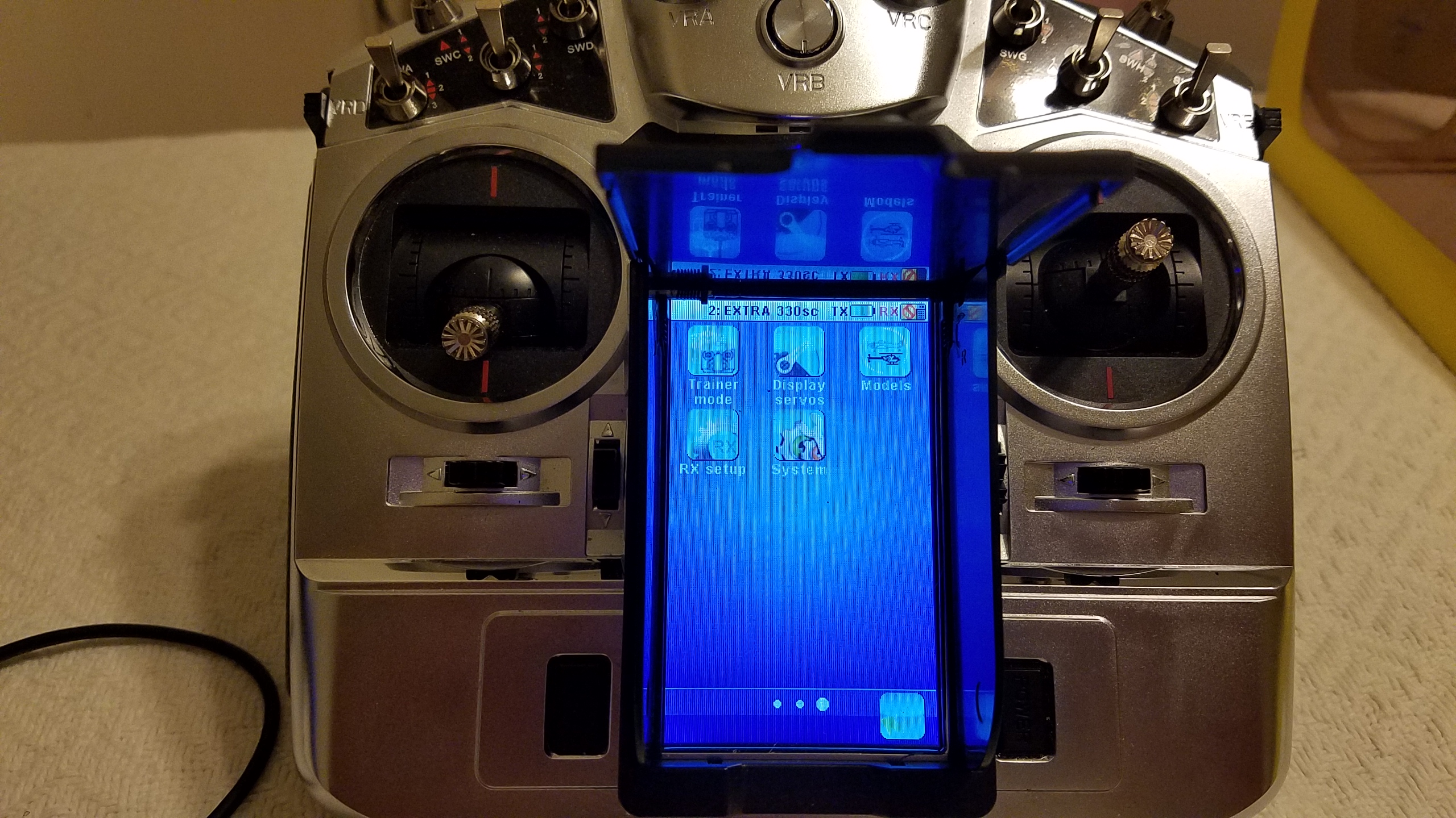

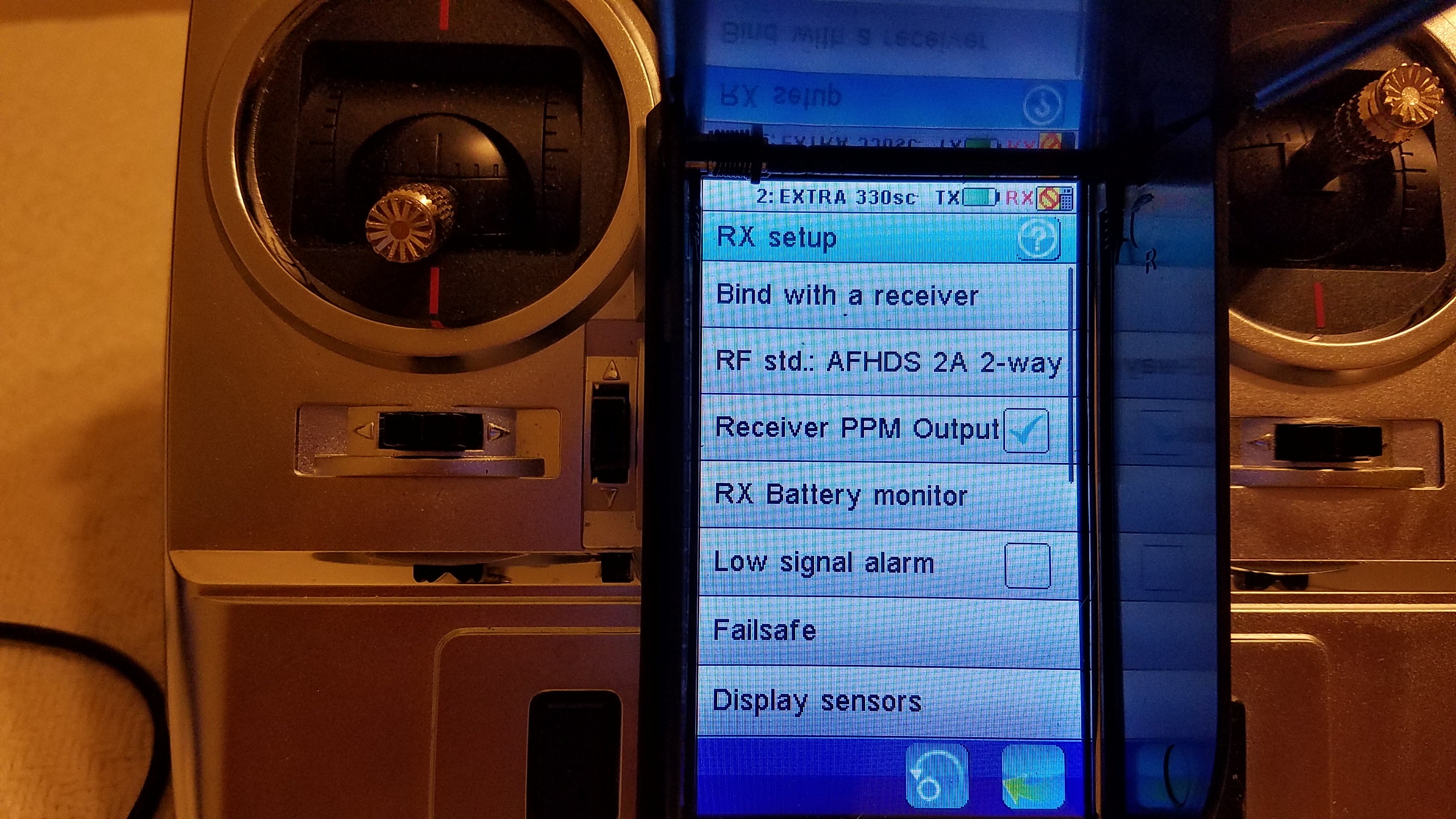

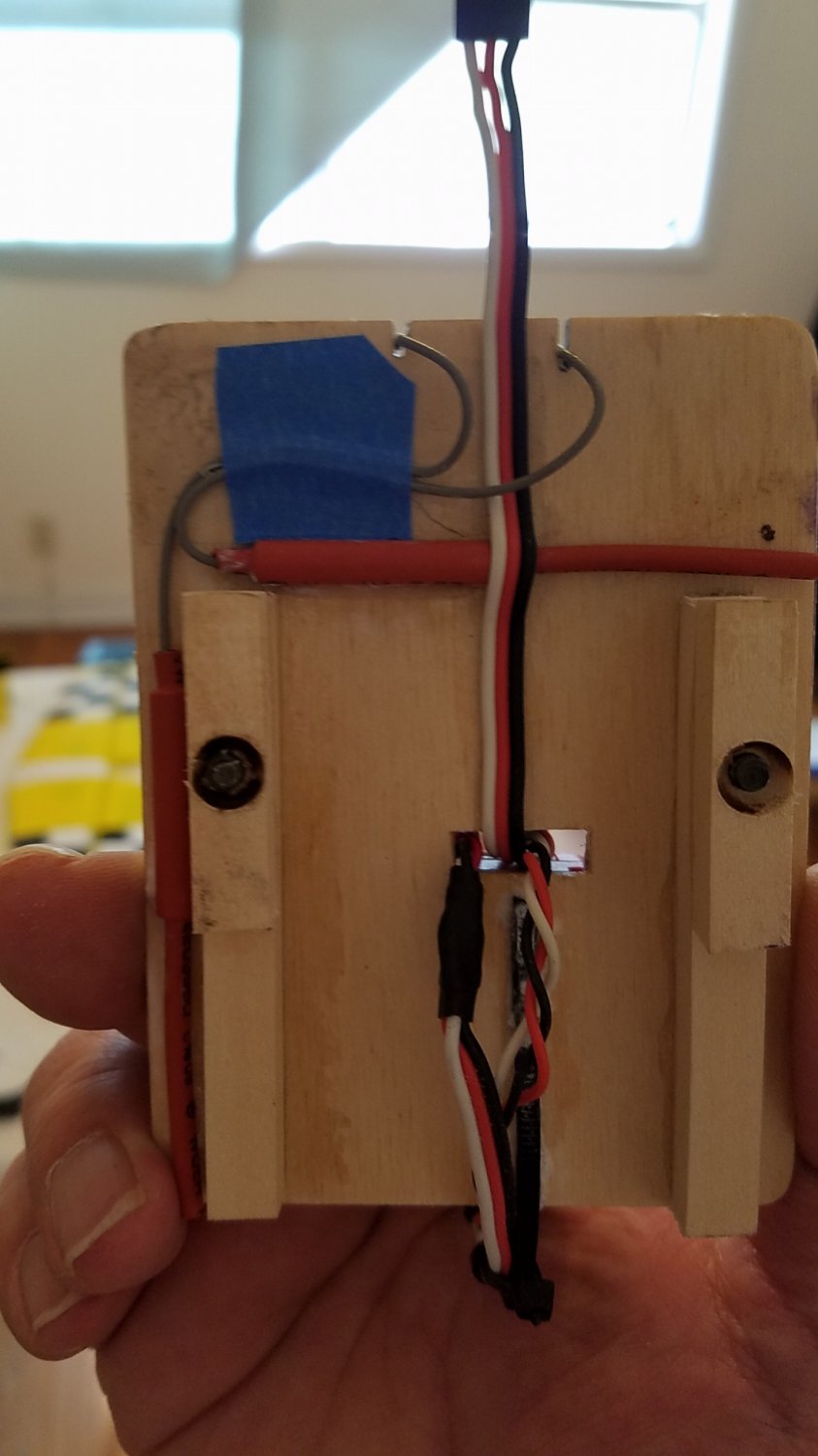

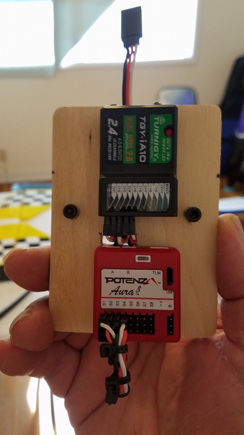

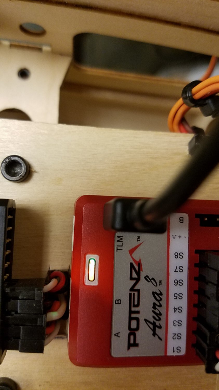

Ok I got a nice radio case for the i10. But even better I got the Aura 8 to work with the i10 like Futabas Sbus!:).
Set your transmitter up like directed. Go to the receiver set up menu and check the box marked PPM. That's it!

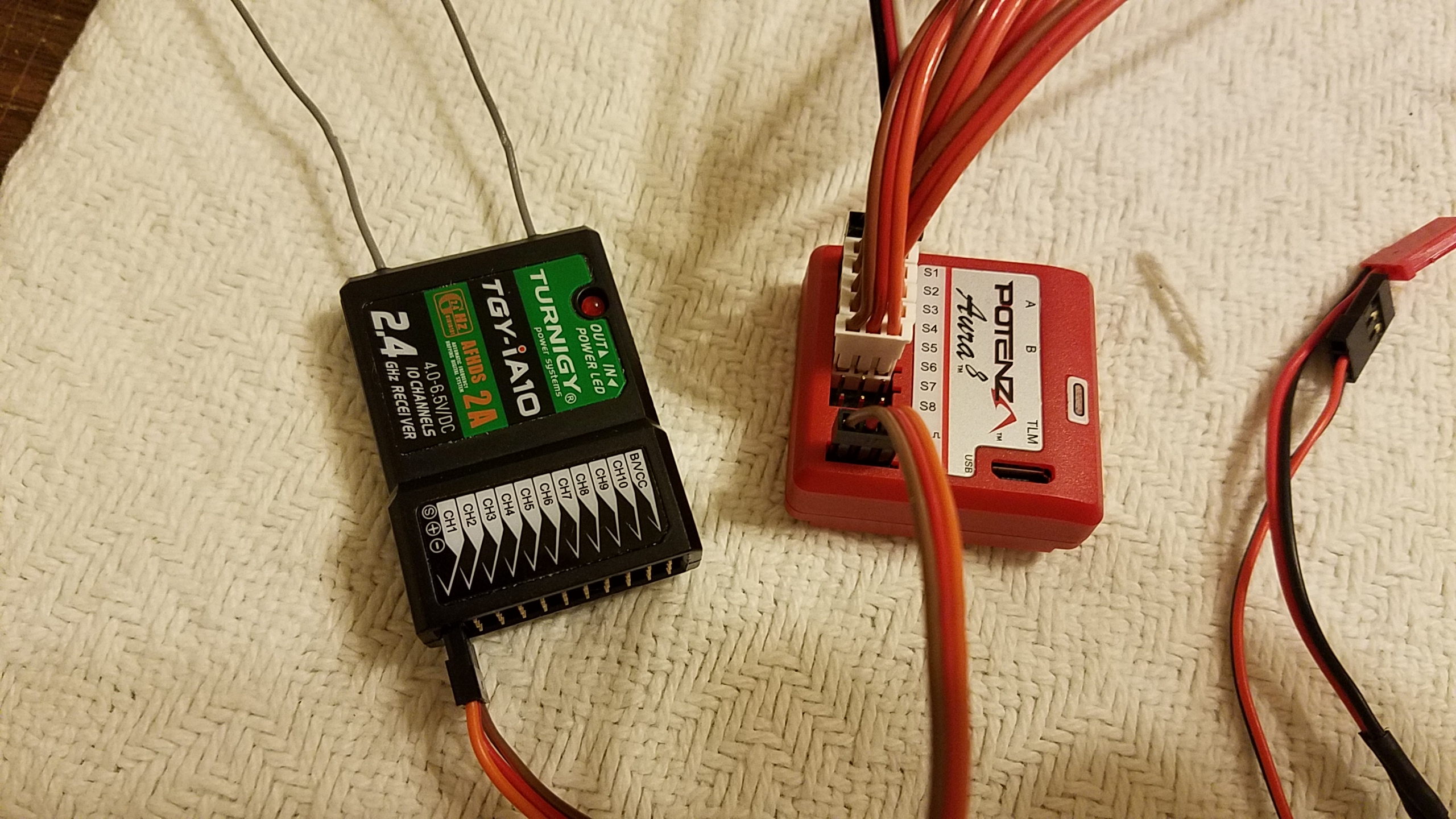

You simply plug a male to male connector from the channel 1 port on the i10 receiver to the B port of the Aura 8!

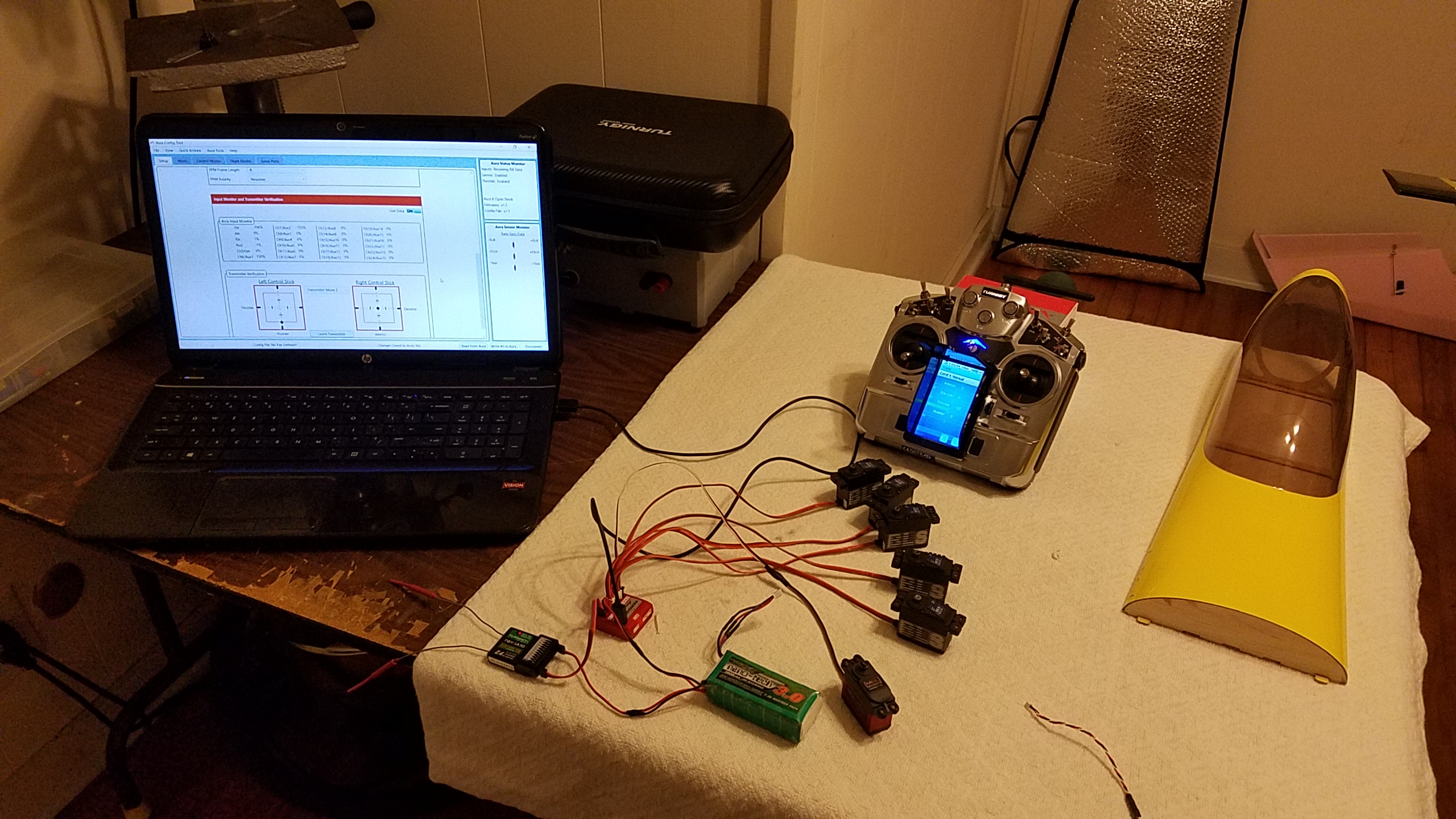

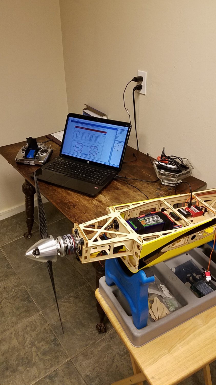

I used the Aura tool to set the Aura up for 3D with 2 ail servos, 2 elev servos and 1 rudder servo. All servos travel as they should because the Aura does it automatically!:).

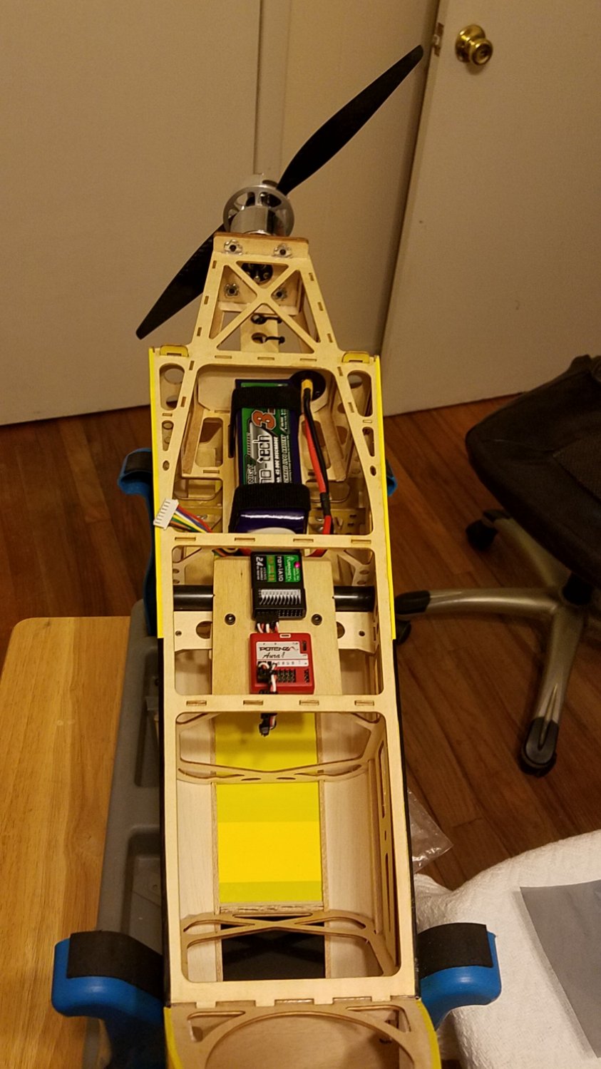

Had some trouble with the servos in the 330sc so more than likely it will be fall before I can give a flight report with a big gasser and this radio. I have directed my attention back to the electrics and will have an EF 64" MXS ready to go shortly with the radio and an Aura 8 .

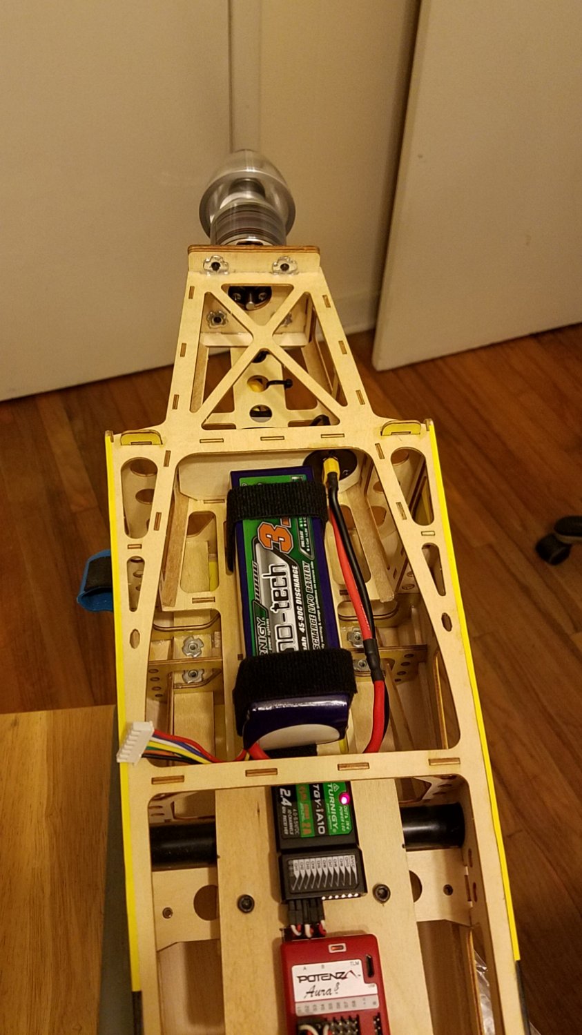

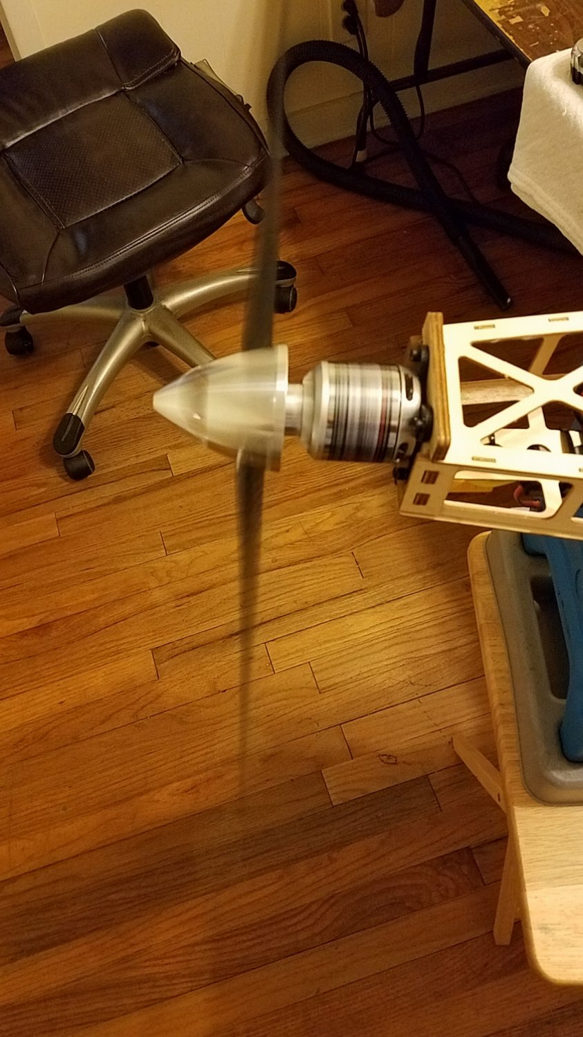

View attachment 83636 View attachment 83637 View attachment 83638 View attachment 83639 View attachment 83640 View attachment 83641 View attachment 83642
The Turnigy SK3 5055 is a powerfully smooth motor and turns the 15 x 7 carbon to "Beast Mode" quite nicely with out even breaking a sweat :). This project is SOOOOOO Mo Betta Than that CHEAP HK Plane:epic:.
