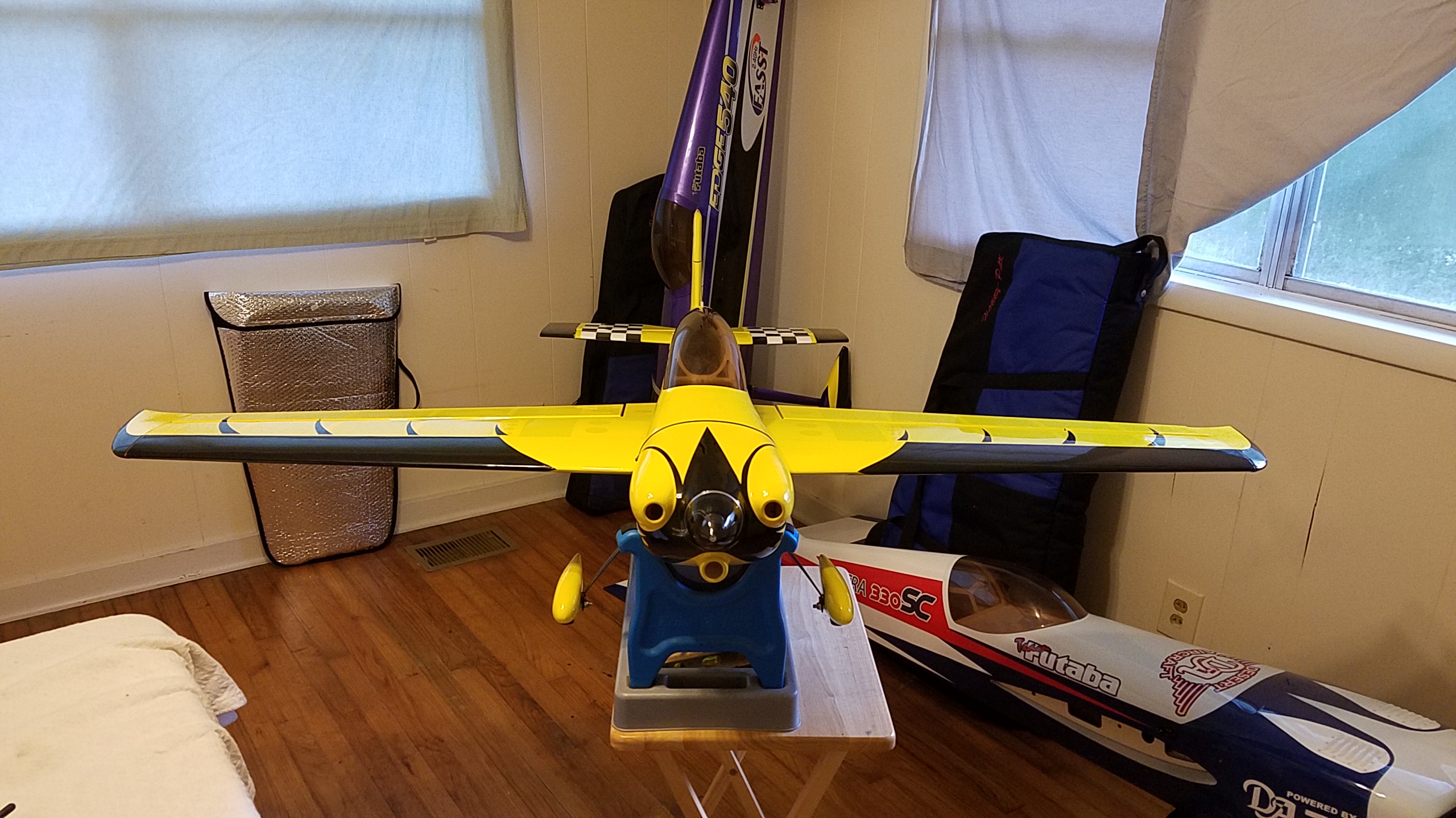

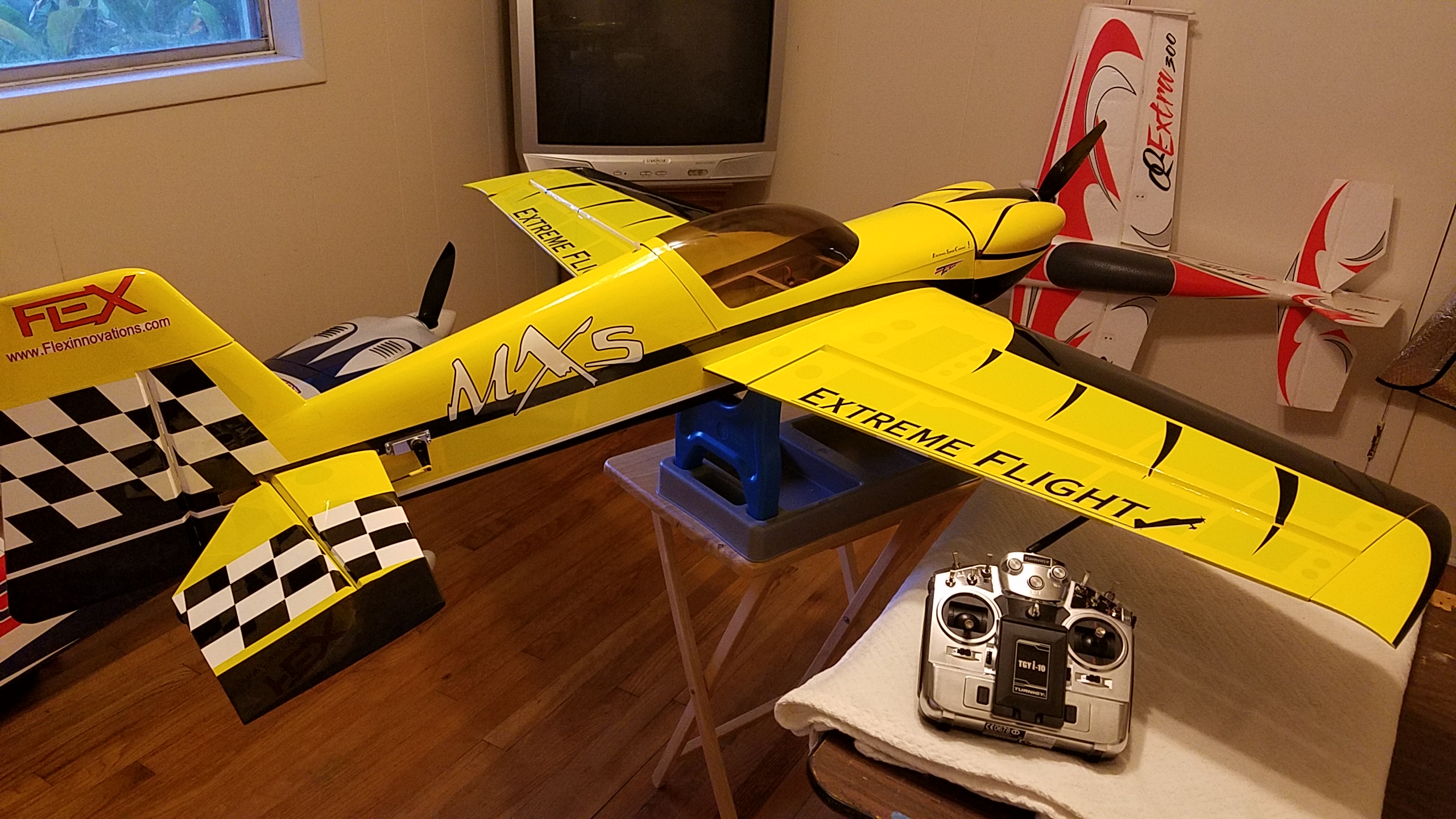

Everything finished but the stickers. Aura set up and it looks to be doing what it is supposed to. Real test Saturday:).

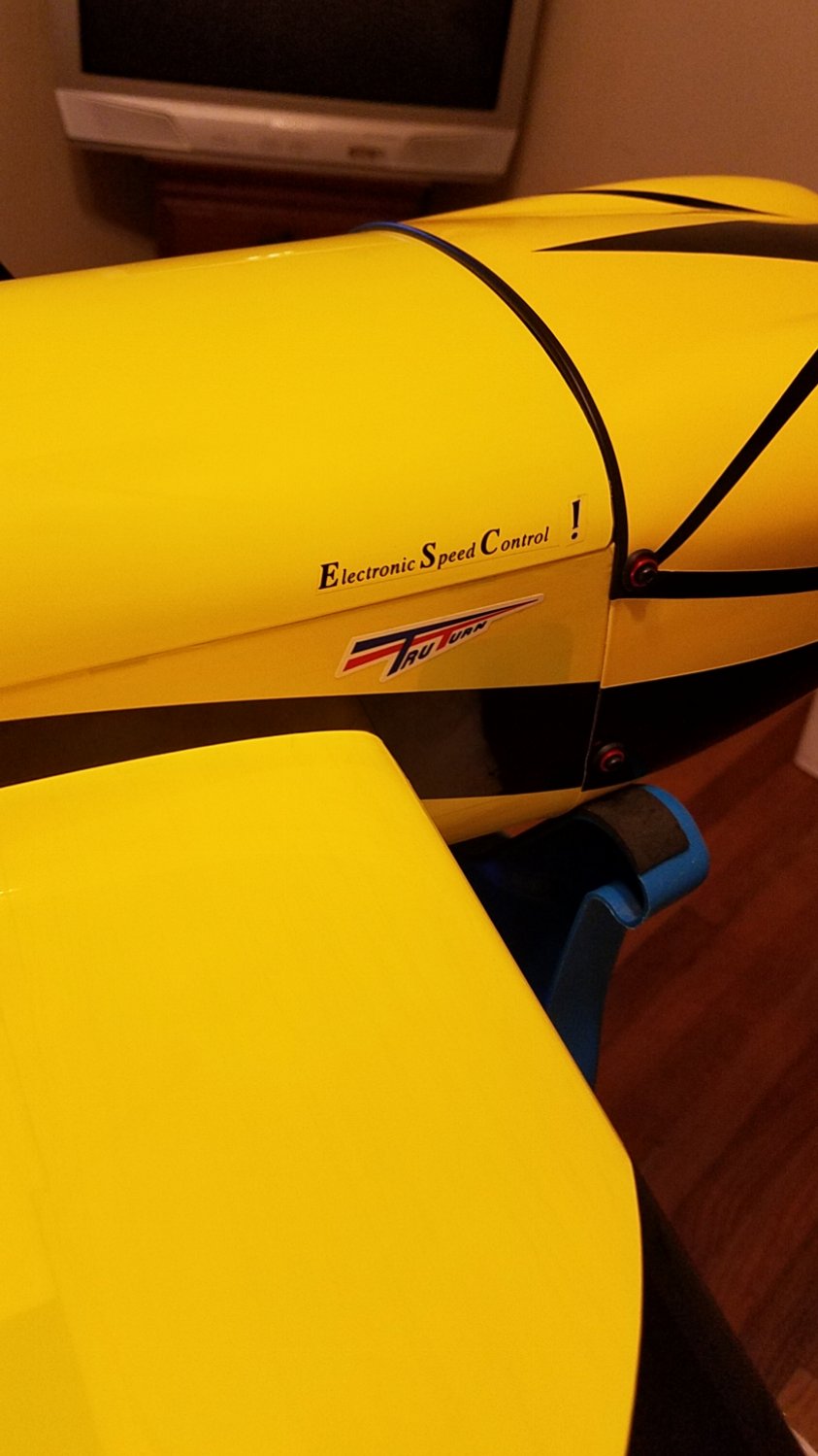

Look! It even got an ESC! lol

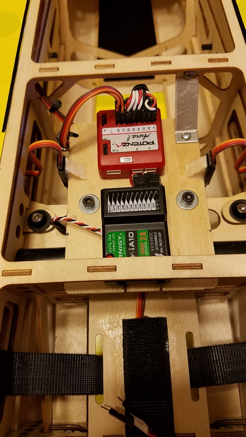

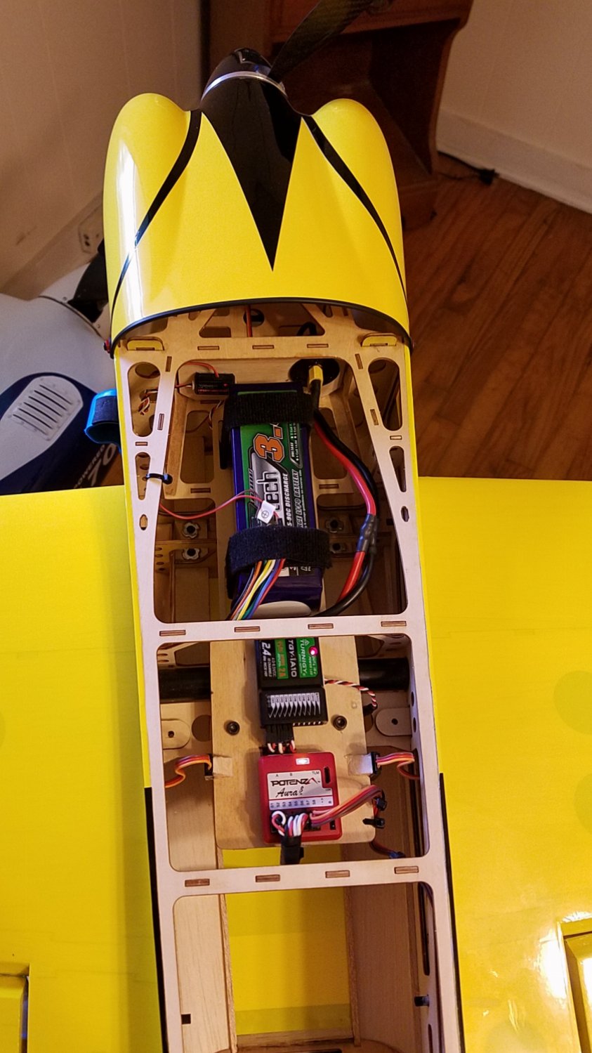

Serious though......Had to install an aluminum bracket to keep the receiver / gyro mount from shaking. It was causing the elevator servo to flutter. Been completely through the radio set up and put the stickers on! Plane weight is 6 pounds 4 ounces w/battery.

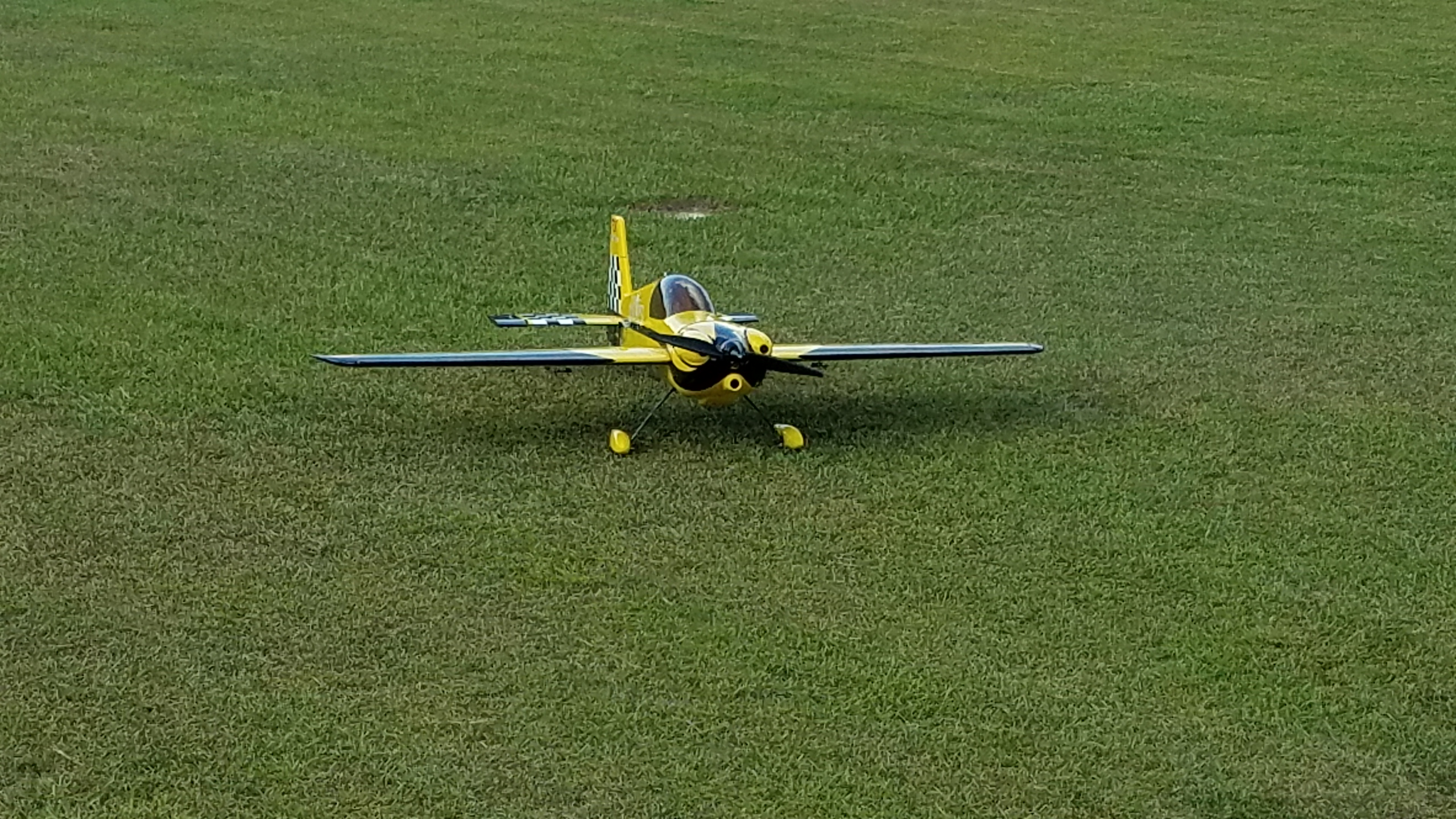

The Maiden with this radio and an Aura 8 is in the books. The only thing noted was that the elevator and rudder servos would jitter but would stop as soon as the sticks where moved. I believe the jitter is due to the "switching" BEC of the speed control. Once rolling for take off all was smooth and the plane flew amazingly well! Not the first glitch, bump, bounce or any other behavior that makes us pucker with fear :attaboy:. The telemetry was useful in setting a throttle up switch. I set it so the motor will always idle at about 1000 rpm.
This completely takes out any "cogging" if the prop was to stop spinning during ground taxi or in flight. The Aura 8 was AMAZING!
This neat little gizmo makes flying a comfortable and enjoyable experience. You just have to experience it on smaller less stable air frames to see. I have not tried it yet on a bigger gasser but I am working up to it! I have an EF 74" edge EXP I will be doing as an electric next for my self evaluation of the Aura 8 in bigger planes. If it to does well there then it will go in the 32% Extra 330sc.
It is always nice to get the first flight over with then the fun starts and after the tenth you love the plane and it is all good from there.

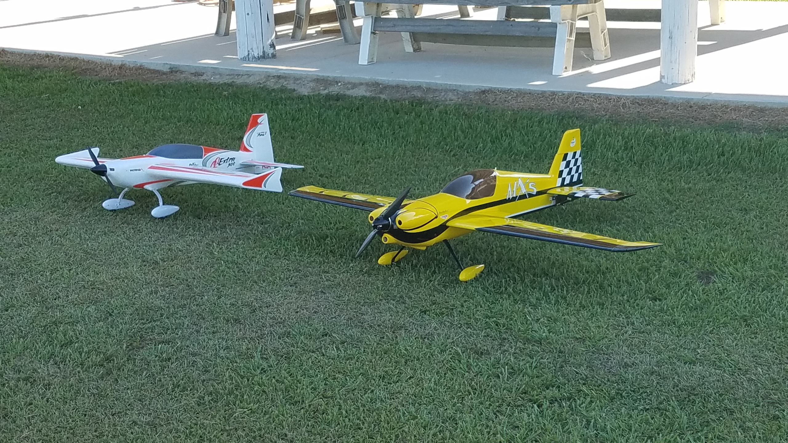

Interesting. with the Torque motor, the EF 60" extra, and a 15x7 APC I am getting 6.5 minutes on Glacier 6s 3300's (30c) batts at around 22.6volts. Very cool photo! Liking the MXS?
Yes I am. Very light plane! 5 pounds w/o battery. My 3300 6S Nanno Tech's are brand new and need a few more cycles (deep) to reach their potential. I suspect about 6 minutes or better once their "broke in". I was really surprised how well the 10c 5200's did in series. Not quite the punch of the 90c but still plenty of power to turn the 16x8 :).
Alky6
ooh. I missed the 10c part. You've got some cool stuff going on. That 5 # is very light! I haven't weighed mine.... Regardless, it is one heck of a flyer! 16x8 the way to go? Better punch out of a hover than the 15x7? Are you seeing much temp differences between the two props?
