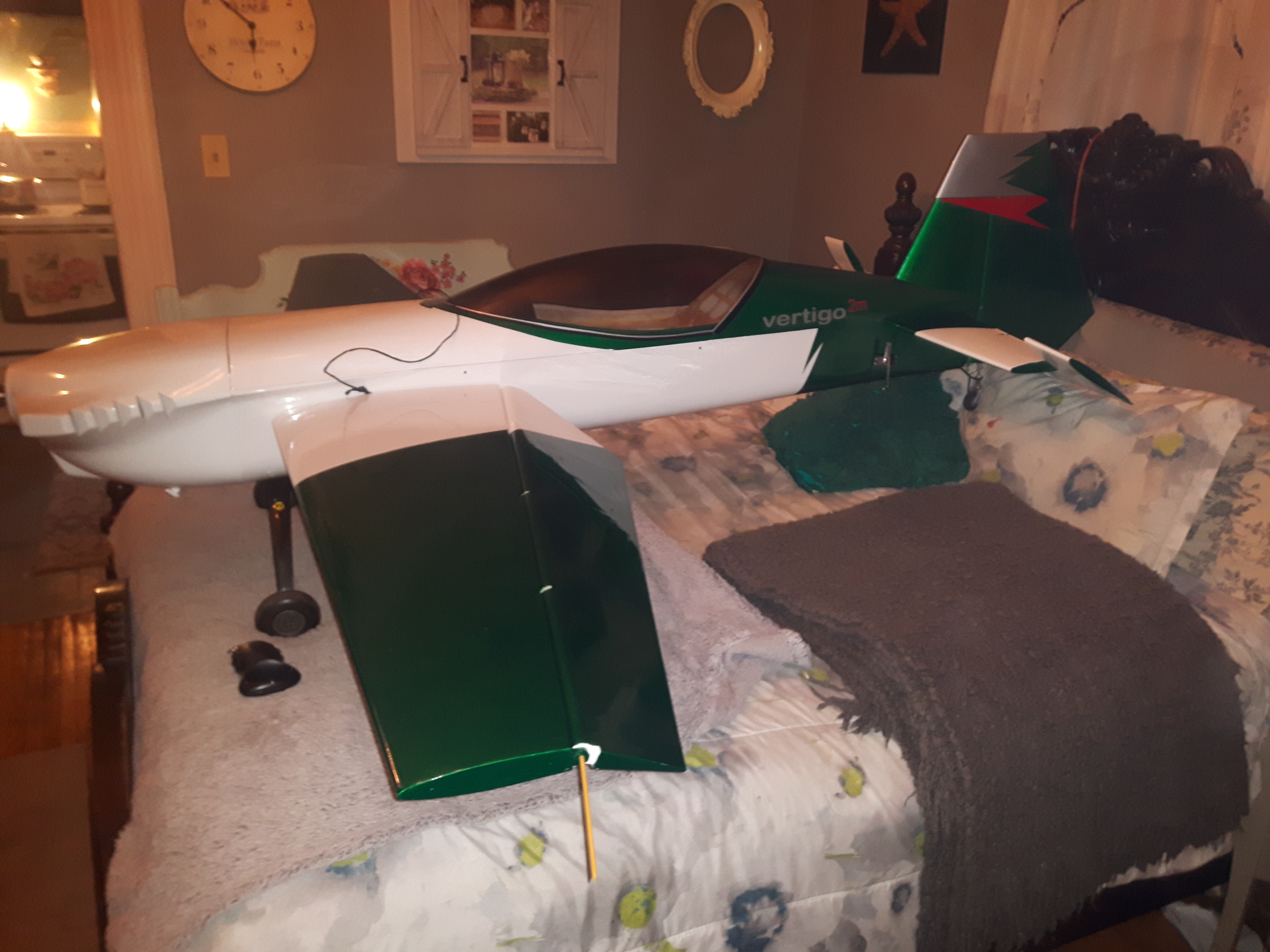

3D Vertigo build, any interest in a build?
Discussion in 'Giant / Scale Scratch and Kit Build Threads' started by -Rick-, Nov 23, 2020.
  1. Not a scale plane, just designed to be different and light.

  3. This was the hardest build and covering job I have ever done. Usually covering is my favorite part of the build, but not on this plane. Fought with it all the way. It seems like because the 1mm balsa over the foam and sheeting glue is so thin air has nowhere to go. Nothing but air pockets if I did no put it on right. It was, pull it tight, iron on a bit and so on. And it still has the worst coving job I have ever done, not proud of that part! I have been covering plane with monokote for a long long time.
    I feel like ordering a nice stick built plane from sig to get back to enjoying building and covering again!!

    Sorry to hear that building should be enjoyable. Getting frustrated with certain elements is normal but not the whole plane. Look at the bright side it will most likely be an incredible plane fly.

    So what you are saying is someone else started it and you finished it that is always difficult to do. Done that a couple of times never again. I will help someone fix a smashed plane but never complete a plane that someone could not or would not finish. But I must say from the pictures it looks really good.

  9. As far as I know I am the third owner of this kit. The first gent bought it and ran into big problems rather fast. All he did was skin the lower half of the fuse. He was not a builder, never had built a plane before. The second owner bought it and never did anything with it, I think he was overwhelmed with the amount of work to it.
    I bought it and knew its history, but because of what went on with it I got it for less than half price of a new kit. Yes there were a few screw ups but for the most part it was easy to fix.
