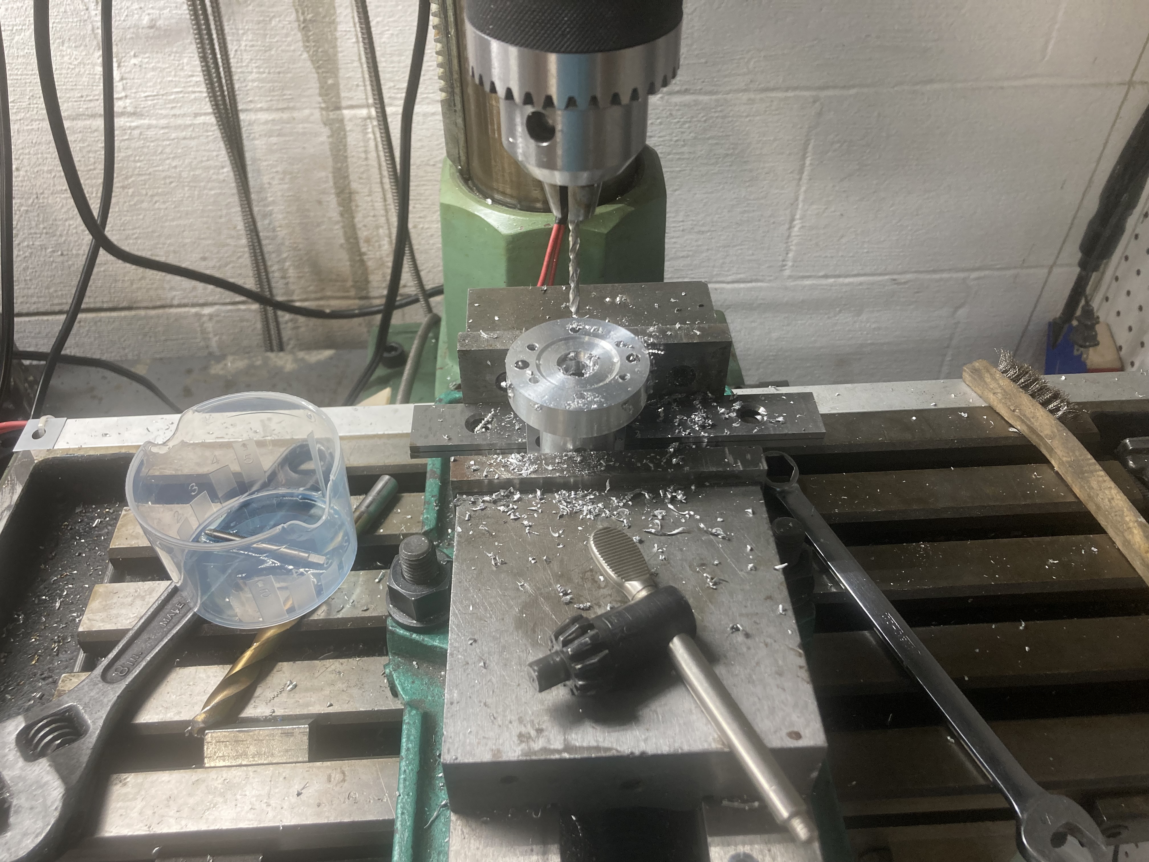

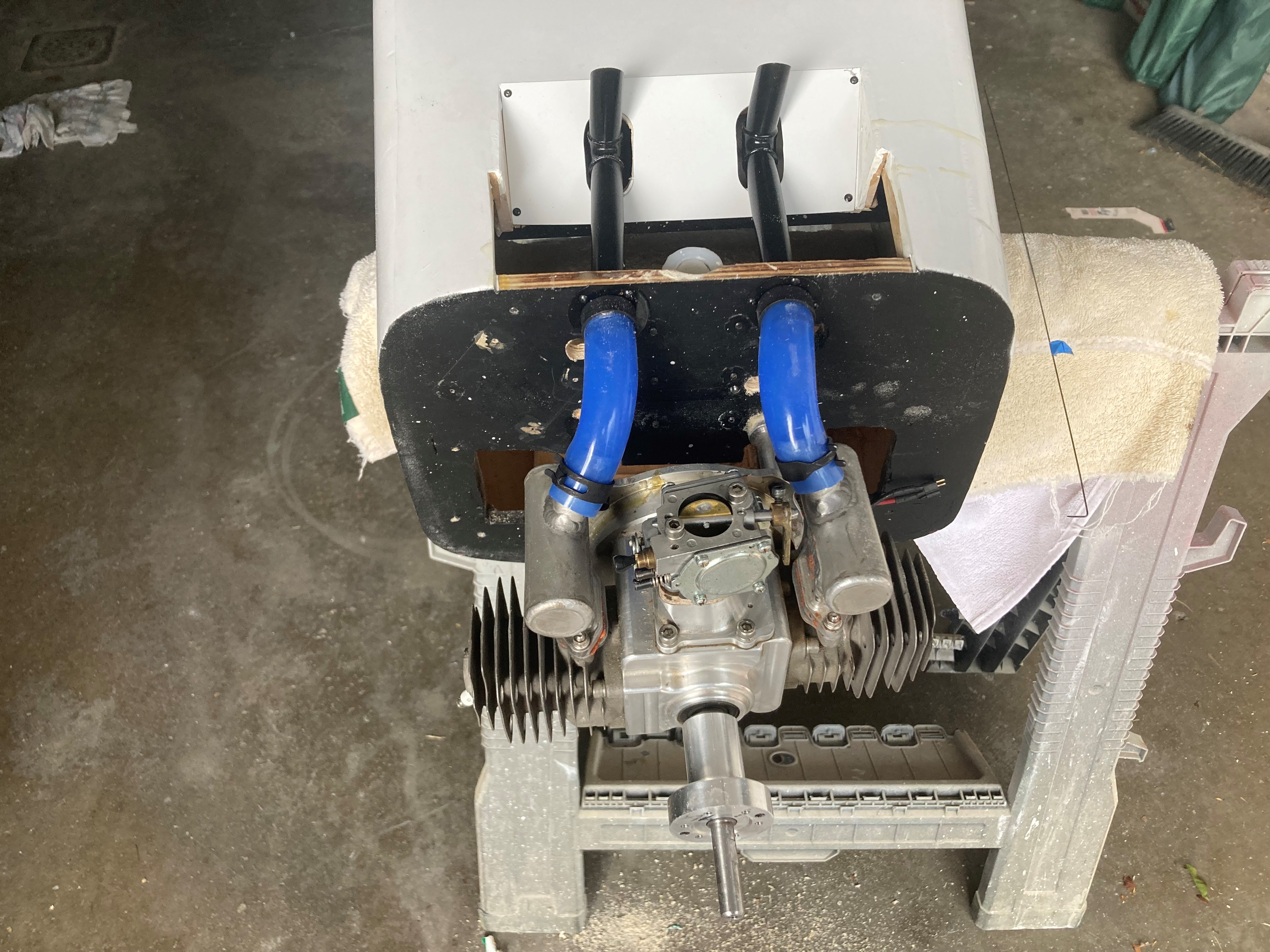

I have 2 D&B 3.7 cubic inch engines that came from an estate sale, I don't believe either was ever ran. I put one in the original Cherokee and had the throttle limited to 60%, it easily flew the plane at 1/3 throttle with a 20 x 10 three blade prop. I decided to use the well run engine for this build. Since the engine was in a mishap the prop runout was checked and found to be .009". Removed the hub and checked the crank it was less than .001", the hub was mounted and checked 3 times with the same result. The runout was mapped on the hub, the hub was set up in the lathe to the runout readings and skin cut. The resulting runout was less than .002". The prop mounting on the D&B is a singe 5/16" diameter bolt with two drive pins, of course todays props are all 10 mm, while it was off decided to convert to 10mm 6 bolt style. Used the same bolt circle and 4mm bolts as the Roto since the spinner was already drilled for it. The engine has a WJ 38 Walbro carburetor that has an accelerator pump, decided to rebuild the carb since it had some soil on it rom the encounter with earth, I think I found the last accelerator kit on earth for it, should be here on Monday. The engine was converted to 1/4-32 spark plugs due the clearance issues, I think I will put the CM10 plugs back it.

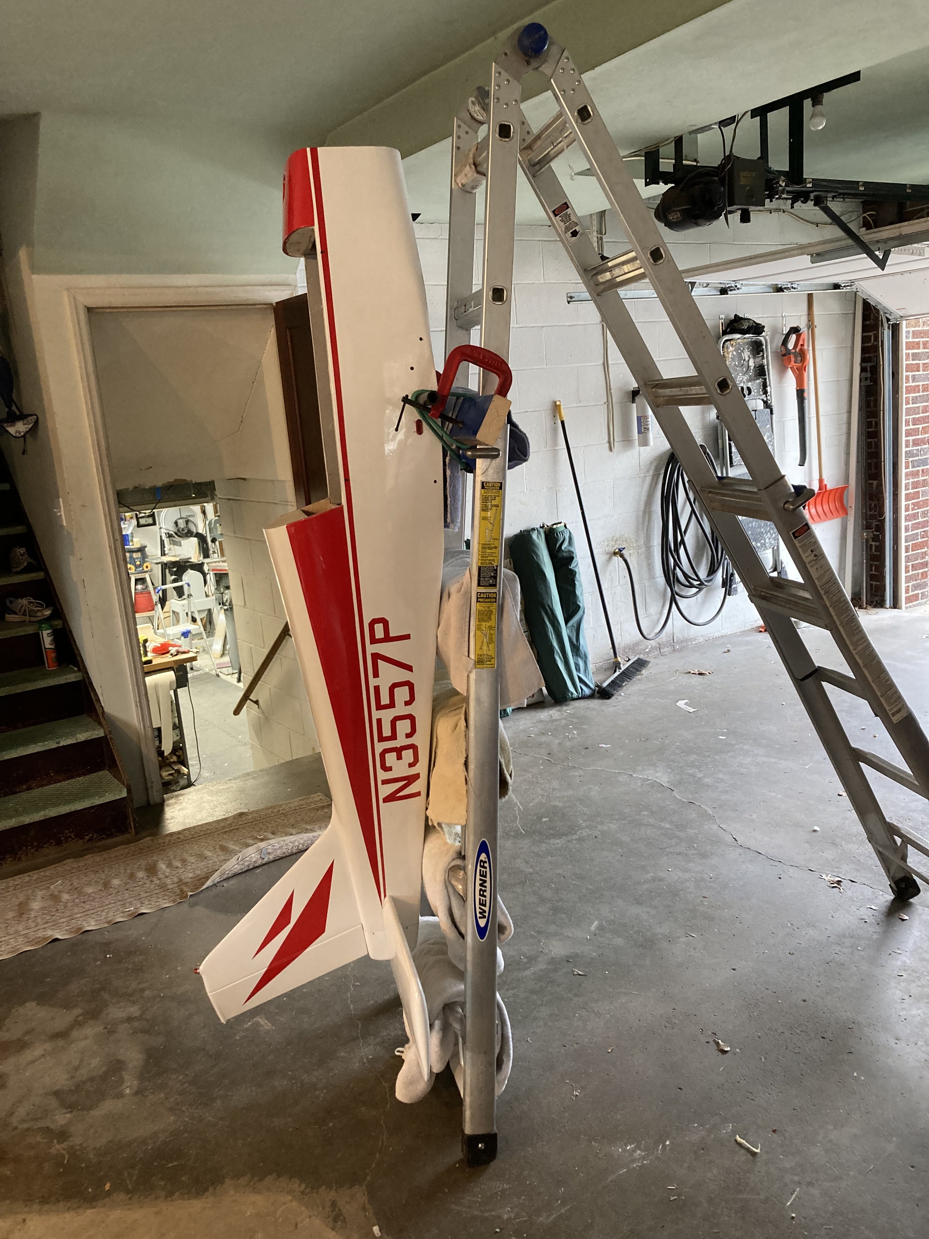

Tomorrow I need to figure out how to stand the fuselage on it's tail to center up the engine in the cowl.

Yeah! Tall ceilings are a must. I have an RC sailboat waiting final rigging because only a couple of rooms in the house will accommodate the mast on the hull. Even with the hull sitting in a stand on the floor.
Yep! Big Boat! Tall mast!
