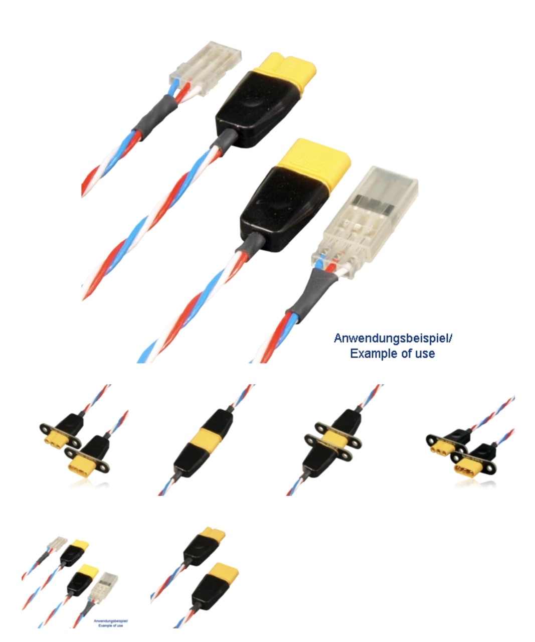

I’m really liking using the MR30 plugs for all those type of connections. It’s going to be a new standard for me.
There are also locking connectors from Hanson hobbies that would work too if it’s more than one connection.

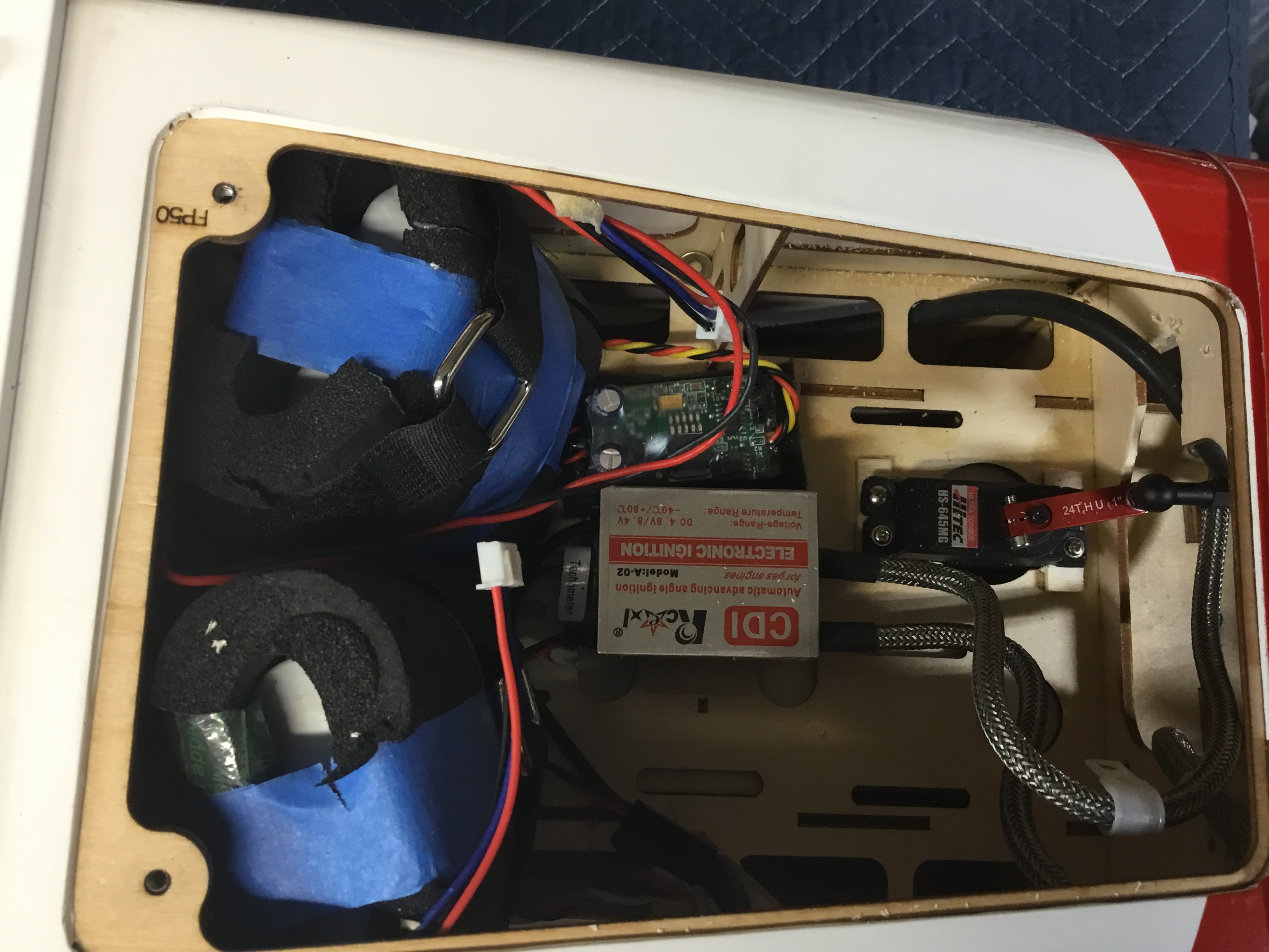

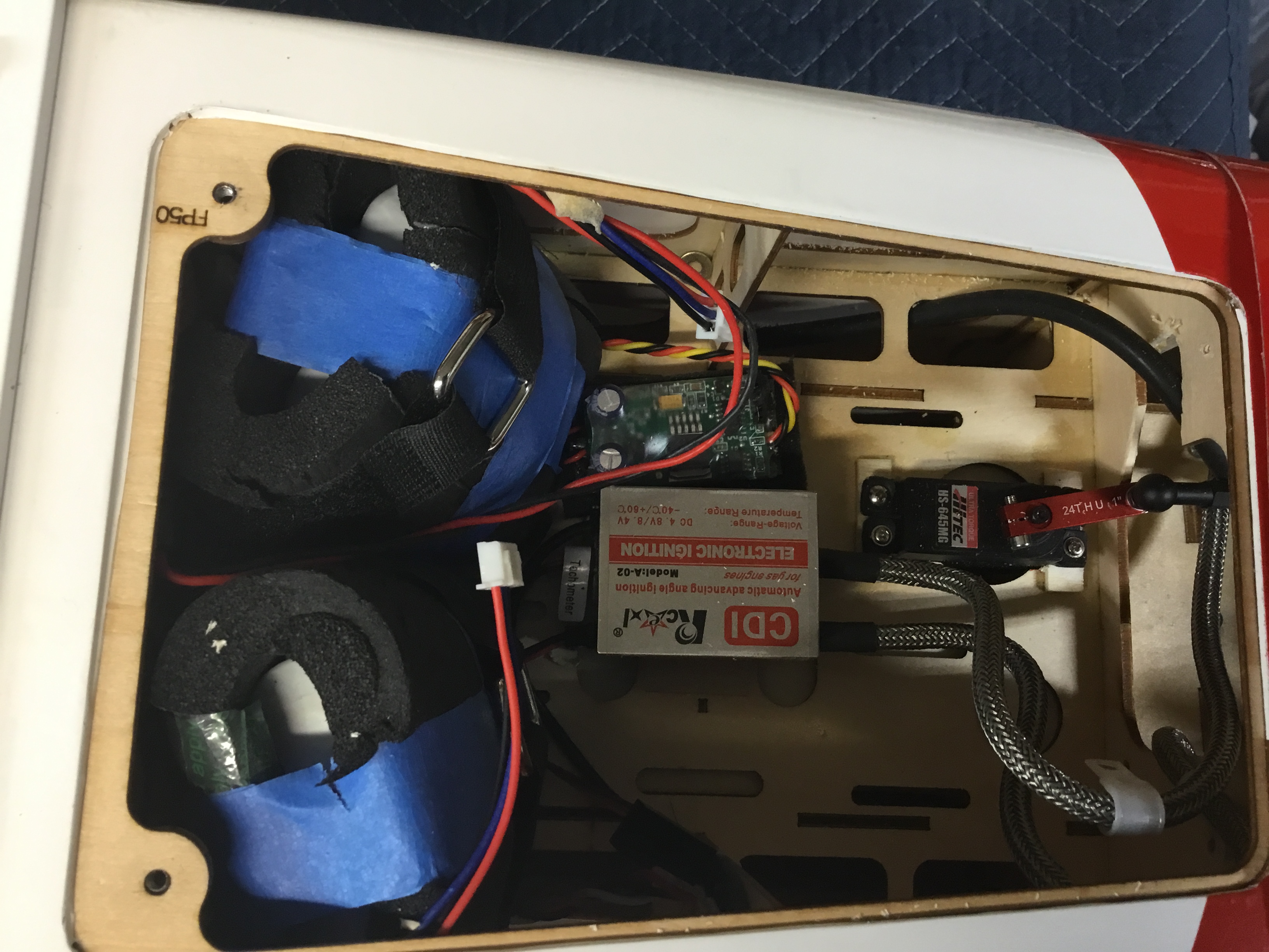

WMcNabb

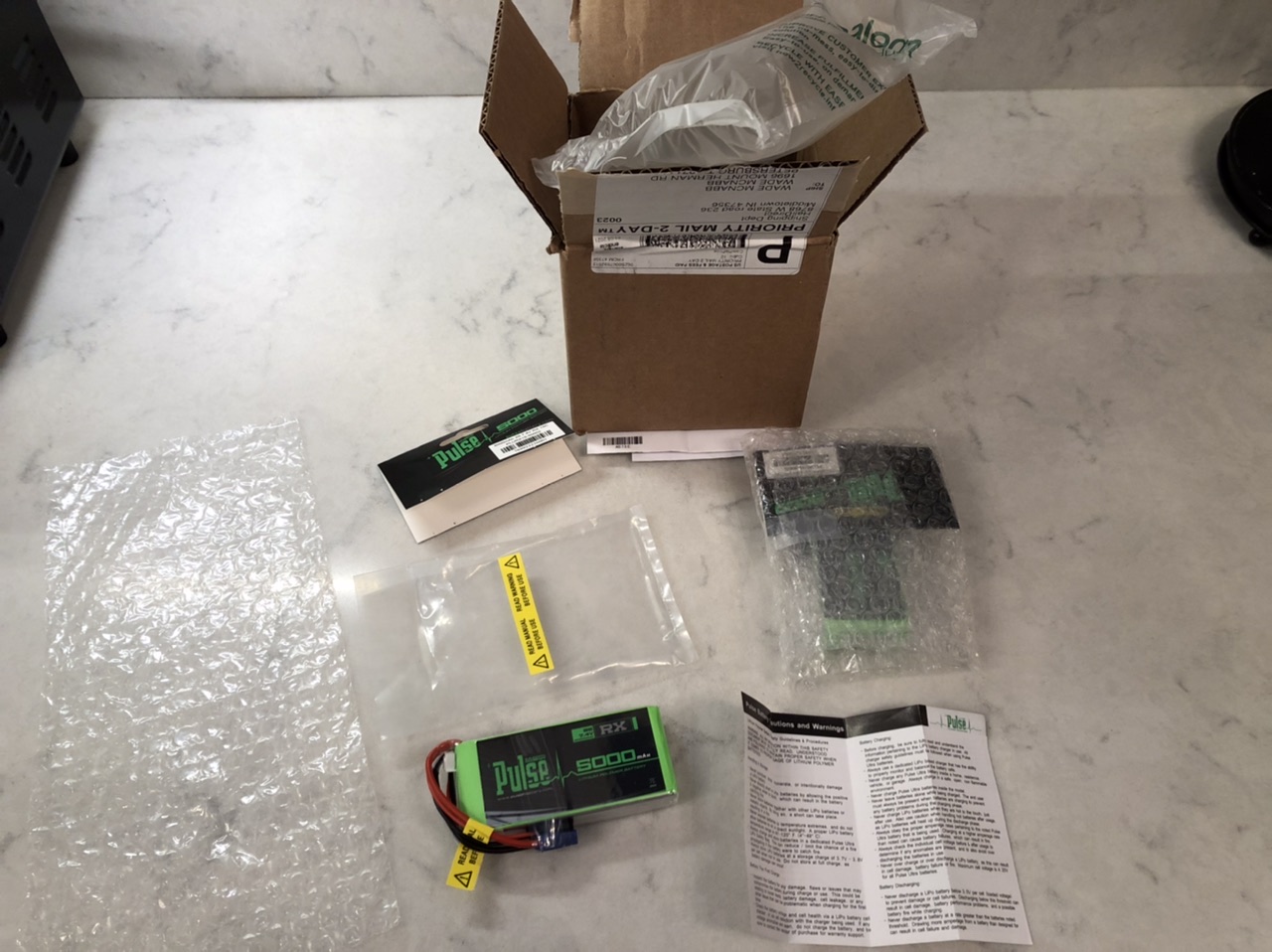

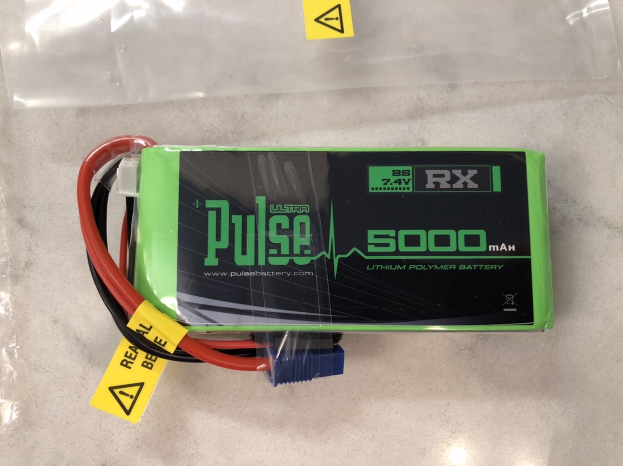

New batteries arrived today. Amazingly quick service direct from Pulse.
Ordered last Friday and arrived today by USPS.
I wanted more capacity and now have the PowerBox, which opened up the option of 2-cell LiPo.
These should do the job, and then some!
Not sure had look around but could not find it. But could you do me a favour, take a picture of a standard JR connector next to the MR 30 connector

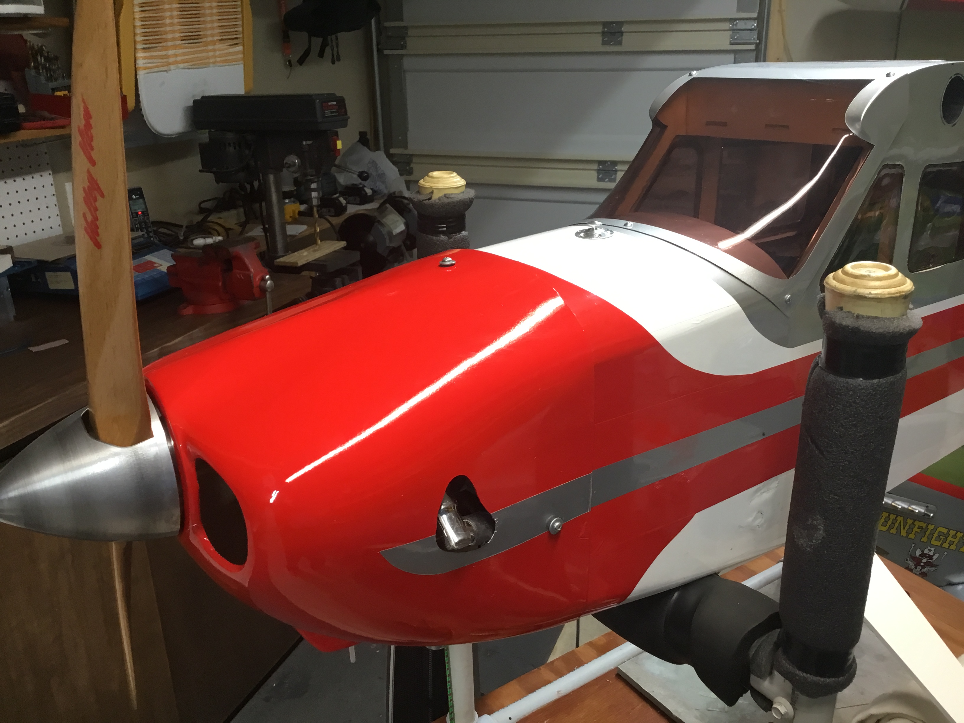

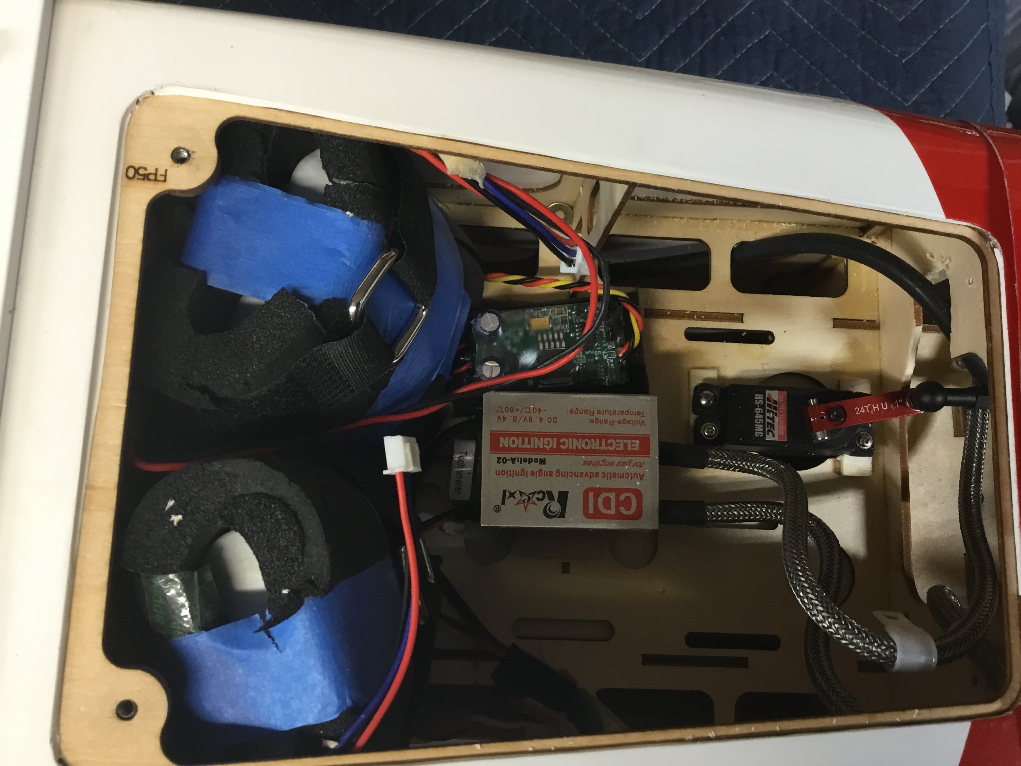

Three trips to the flying field and 10 total flights. Still don’t have the elevator/flap mix dialed in. I set the lowest flap at 85% of total throw and with 25% down elevator mix, it still balloons too much to be useful. Mid flaps and 15% works great. Realize that this is the first time I have flown in nearly 3 years, so it’s taking me awhile to get back into any kind of piloting skill. At least I was smart enough (or nervous enough) to enlist an instructor! Thanks Maurice!

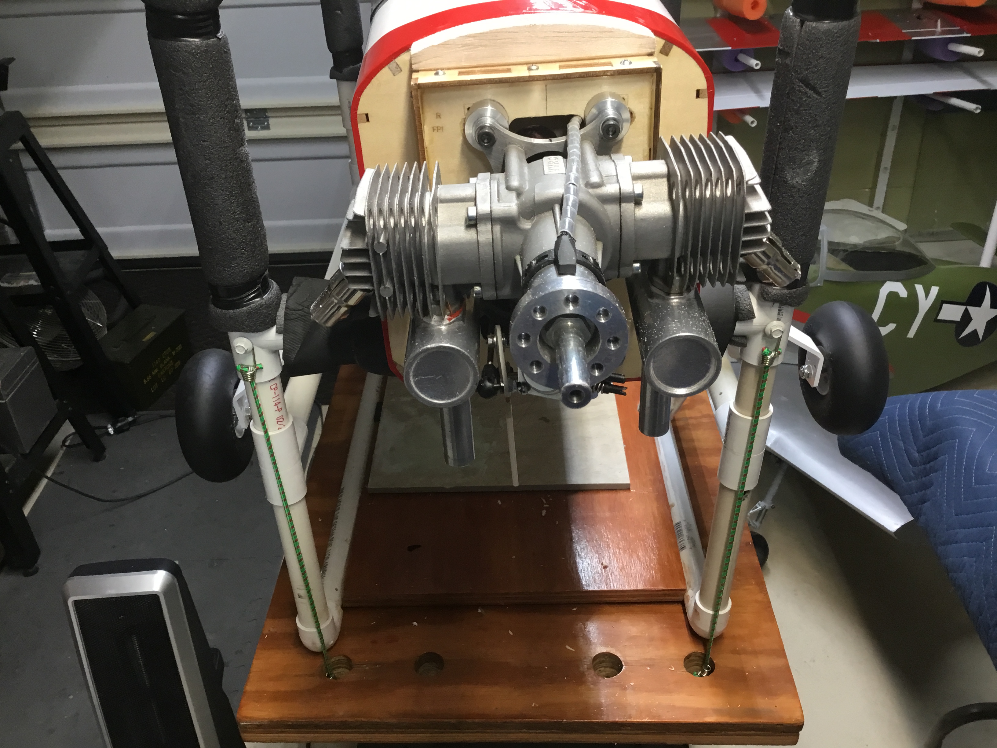

The Valley View 40 twin is a great choice for this plane. It hadn’t been started in over 6 years and even then didn’t have an hour of run time. Still not dialed in just right, but on the last flight, it hand started on the first flip.
