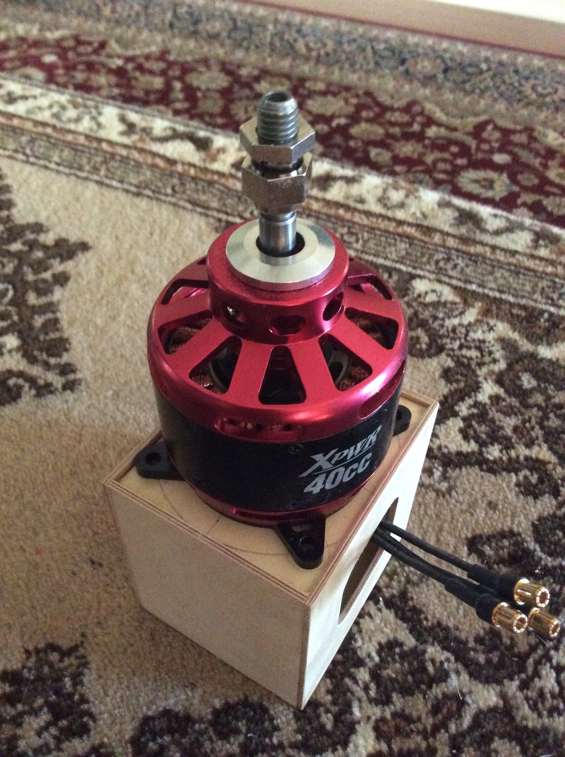

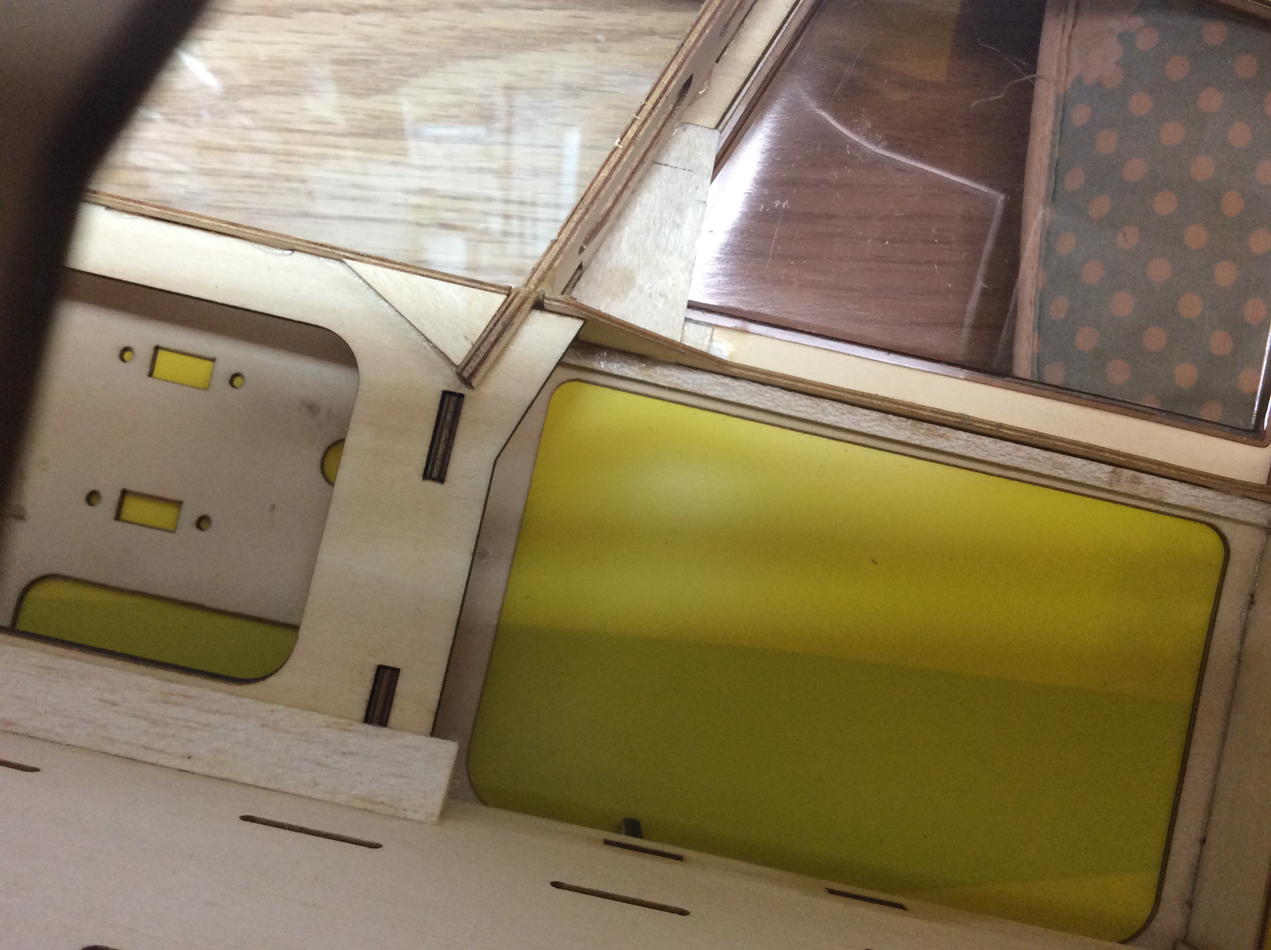

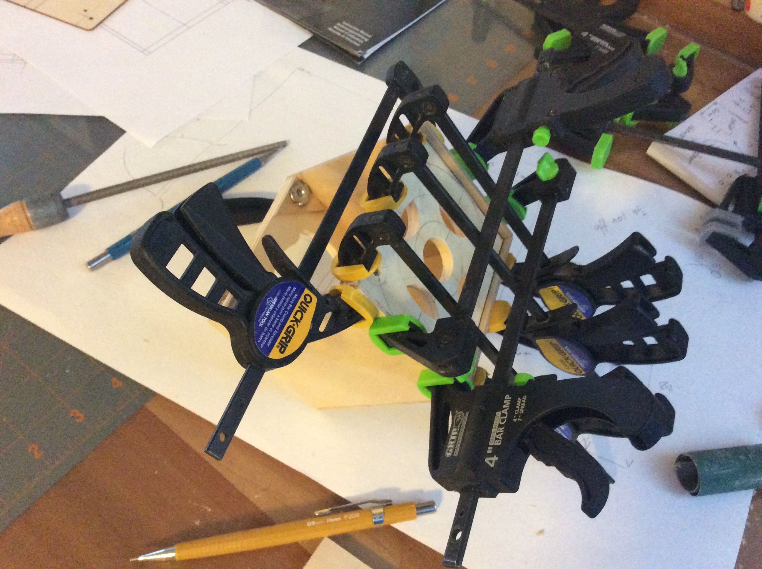

Weather was not good again so did a little work in the shop. Made a start on the new E-Power motor box. And did a little reinforcement as AKNick has made us aware of some of the weaknesses in the plane.
Added the same block as AKNick and another triangle at base of the window.
View attachment 111270 View attachment 111271

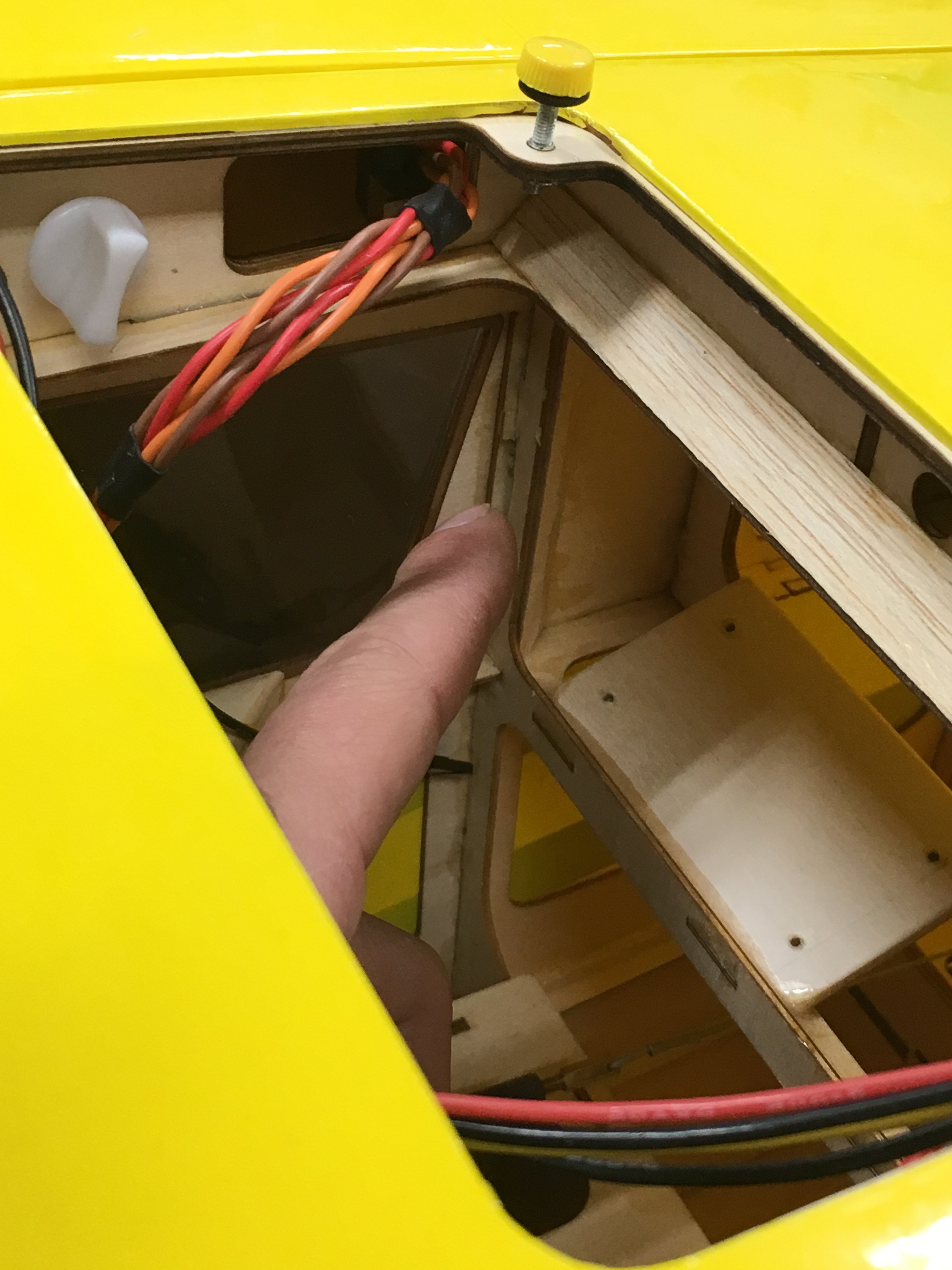

I’ve been adding tristock as well. Also more CA and epoxy!
Tri-stock just forward of the wing bolt.
My finger is pointing to a defect. Added tri-stock behind it.

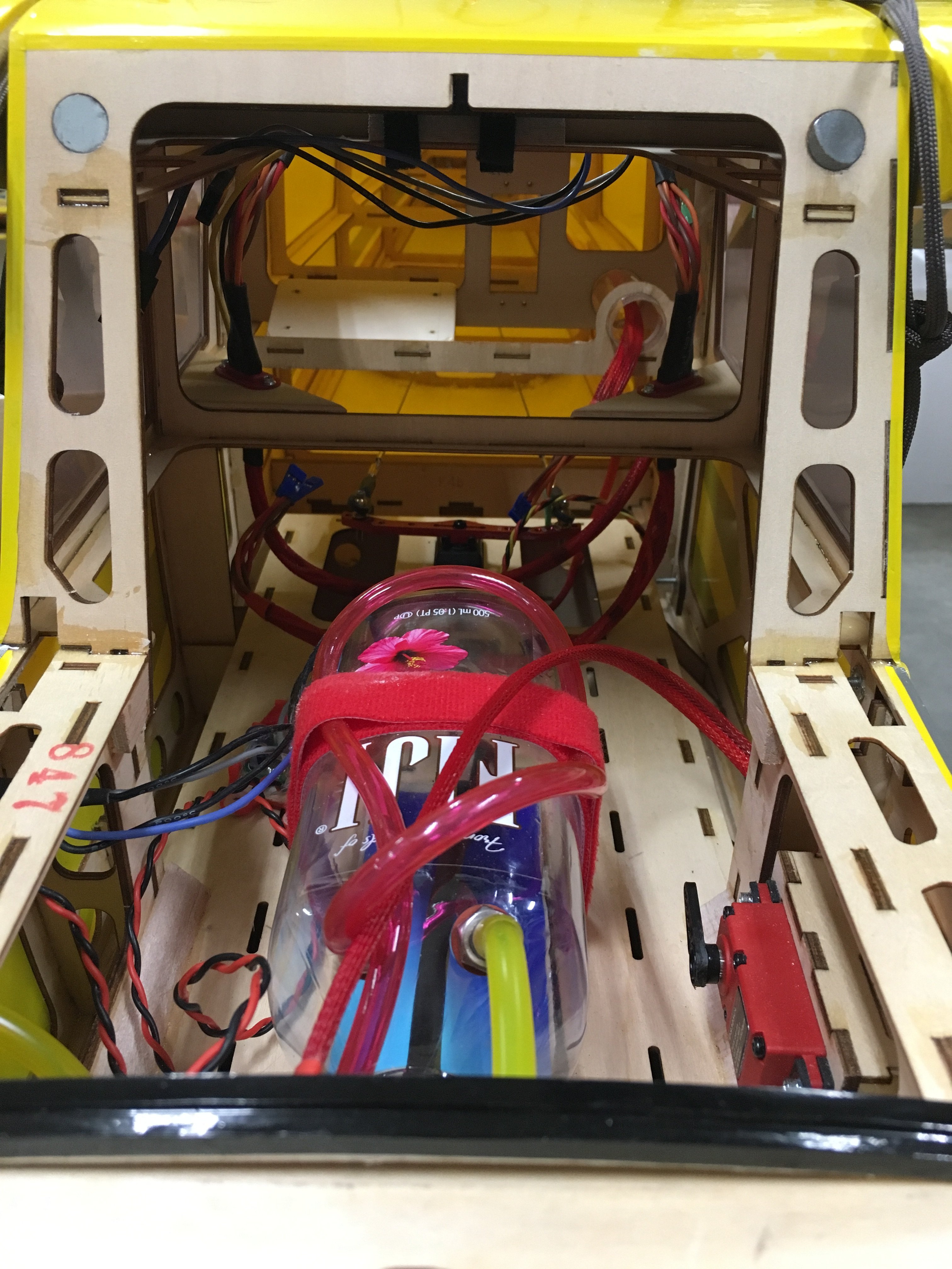

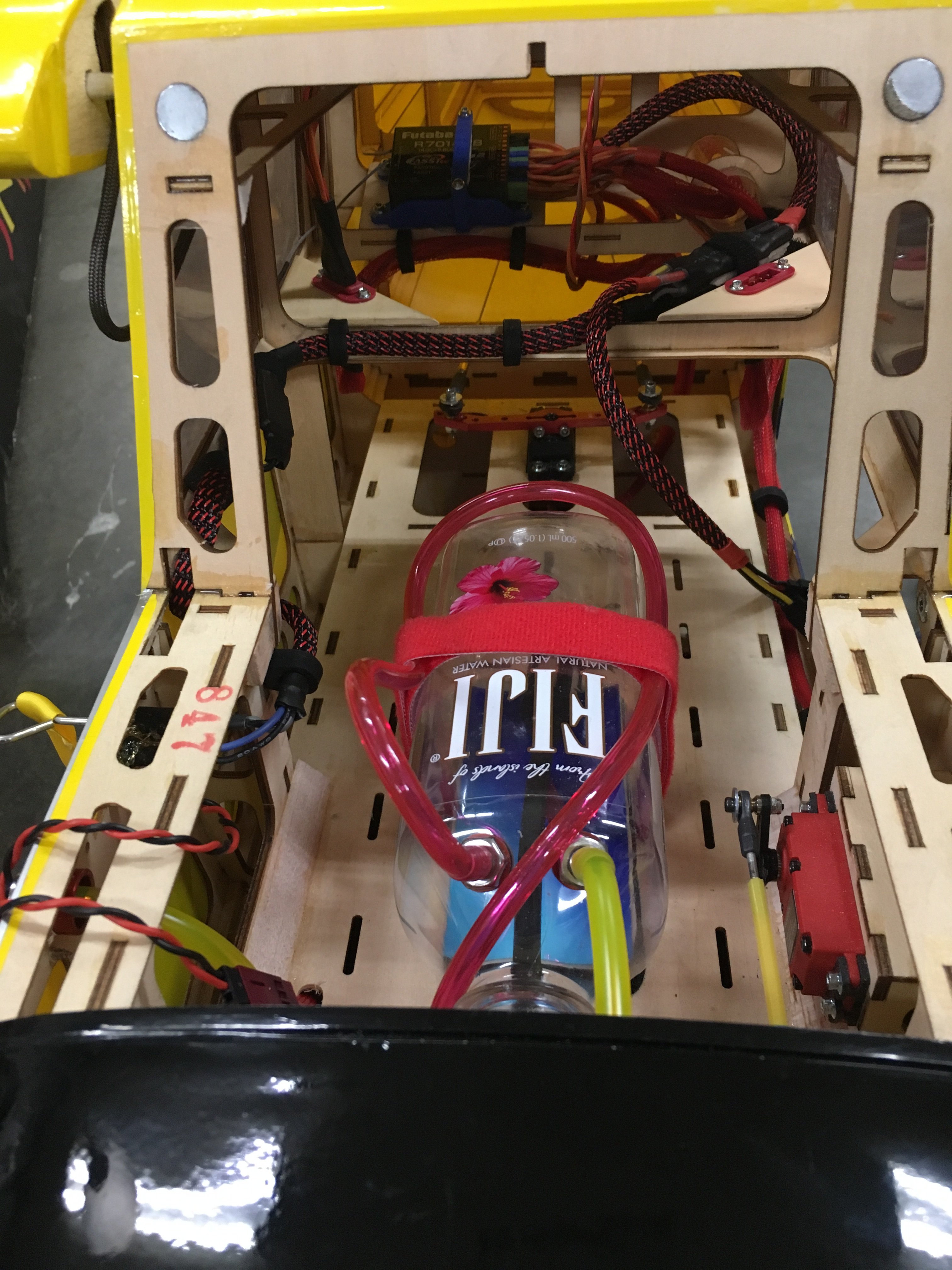

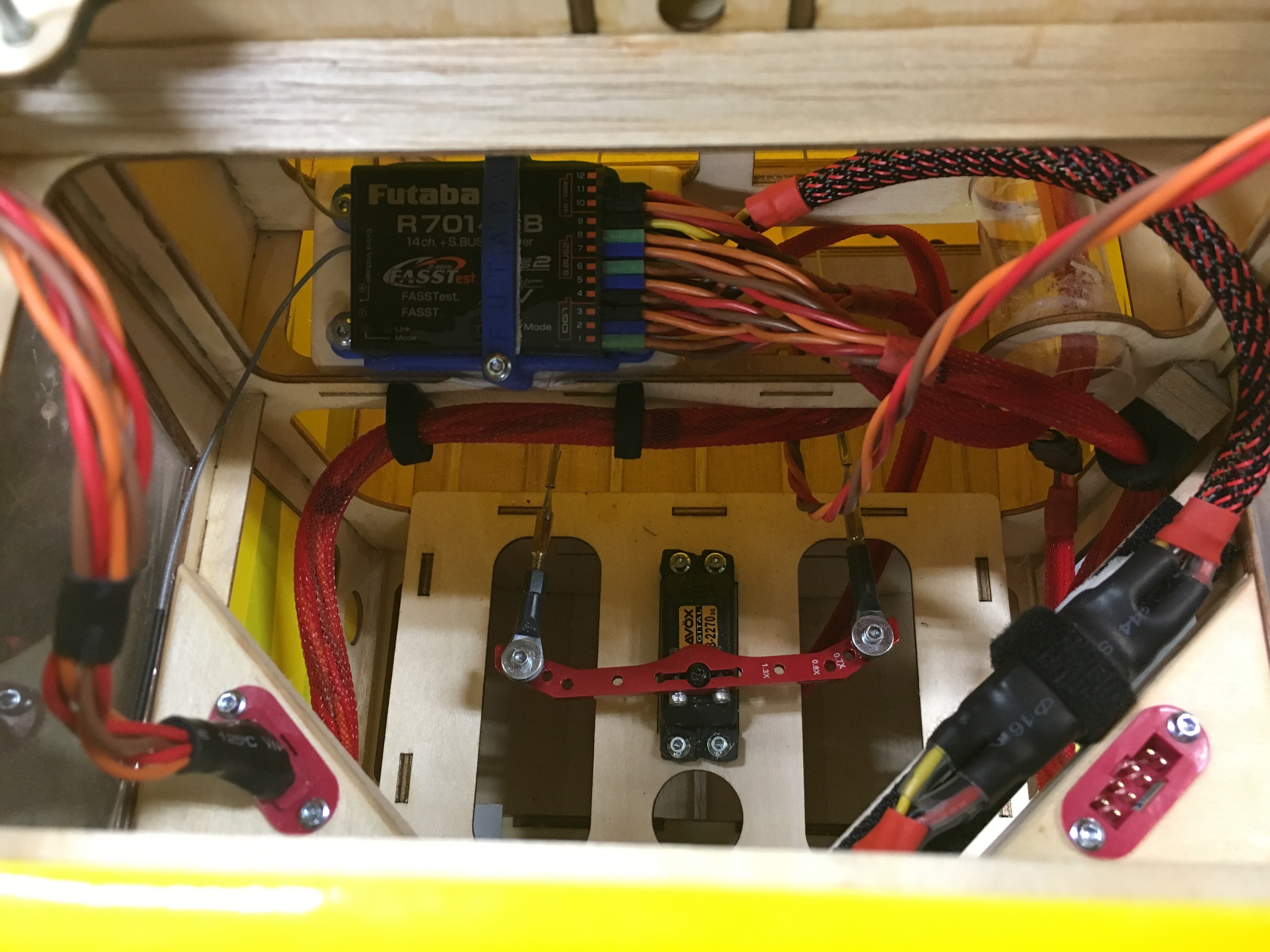

Just another fuse shot of my progress. You can see how I laid the receiver tray in the back. Put it at an angle, I liked how it provided good access and visibility.

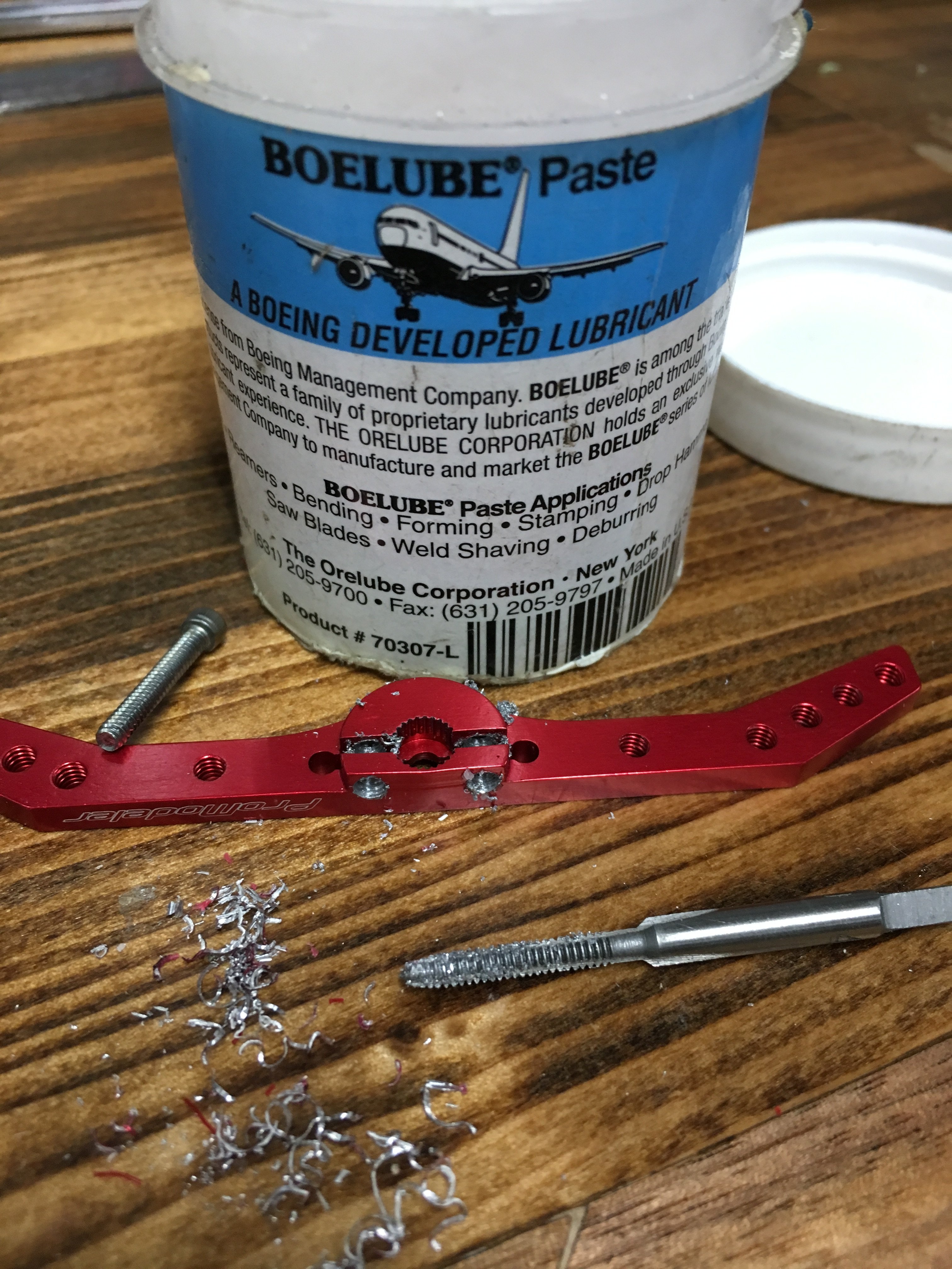

Did some much needed servo setup. Got everything done, except the elevator servos. Then I’ll be into programming. I’ve said this before, the promodeler double servo arm looks cool, but that’s it. The Allen screws stripped with two fingers on the wrench. So I drilled them oversize to a 4-40. Not much material left... might be a temporary fix until I get another offset arm.

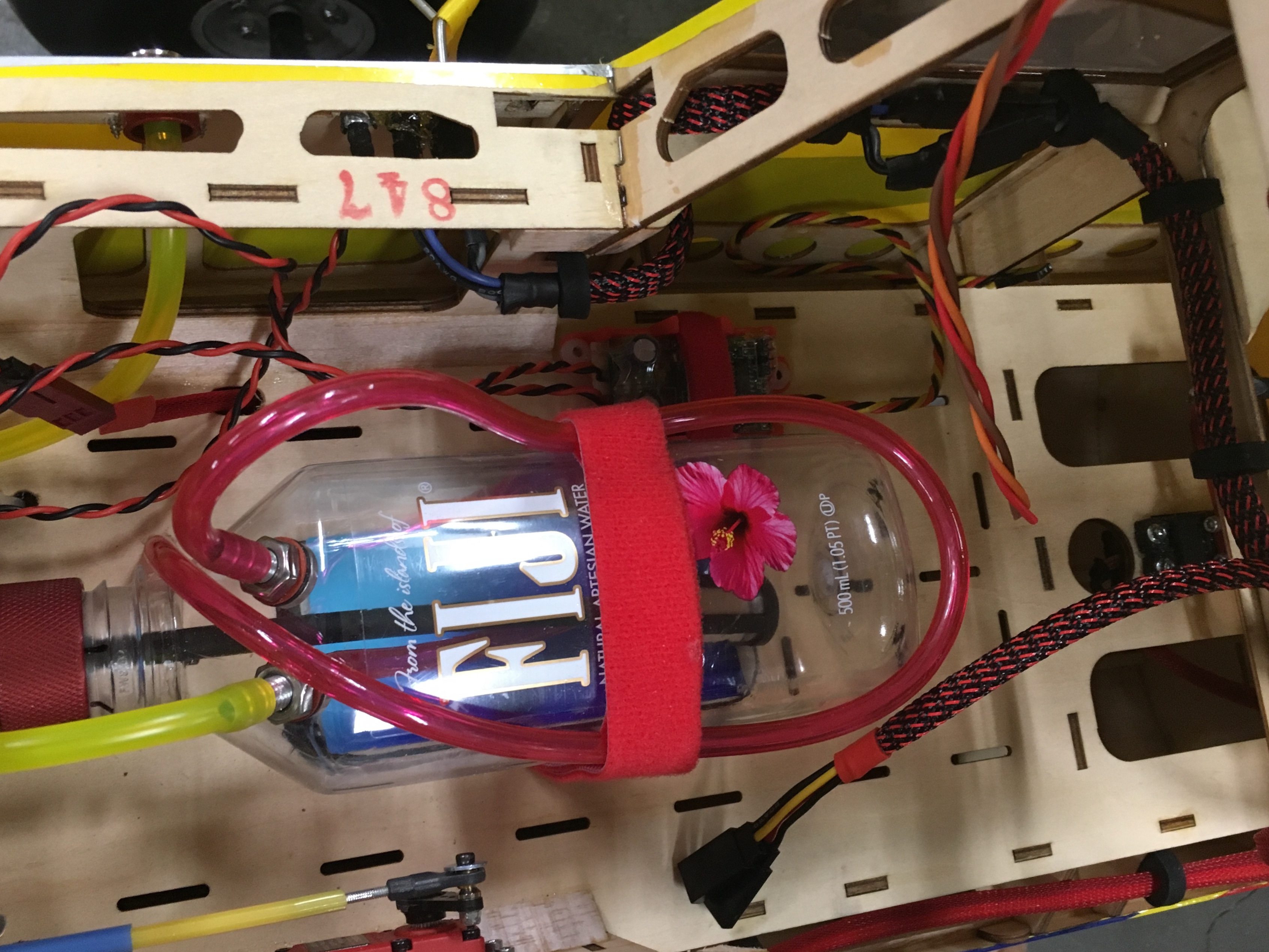

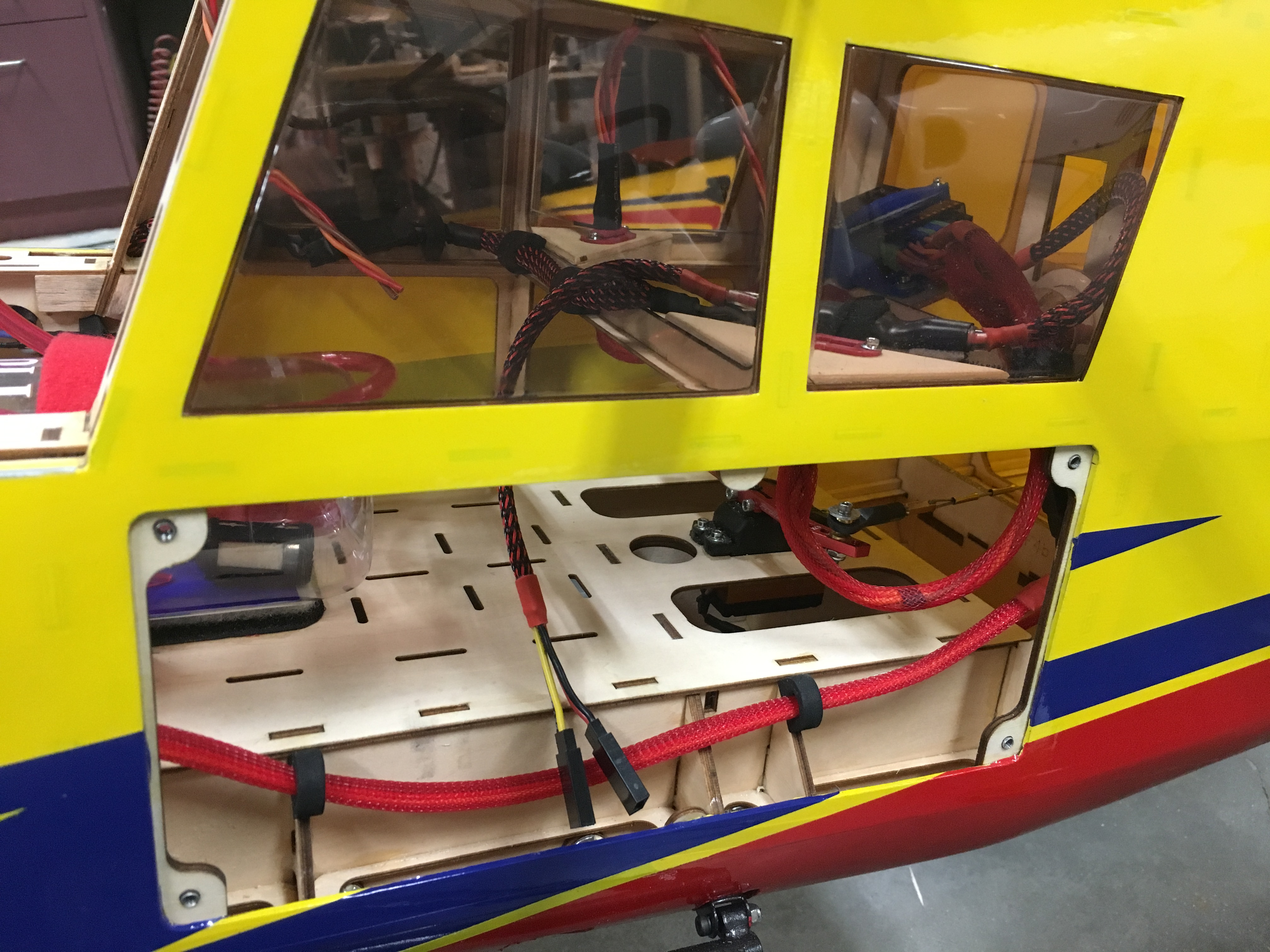

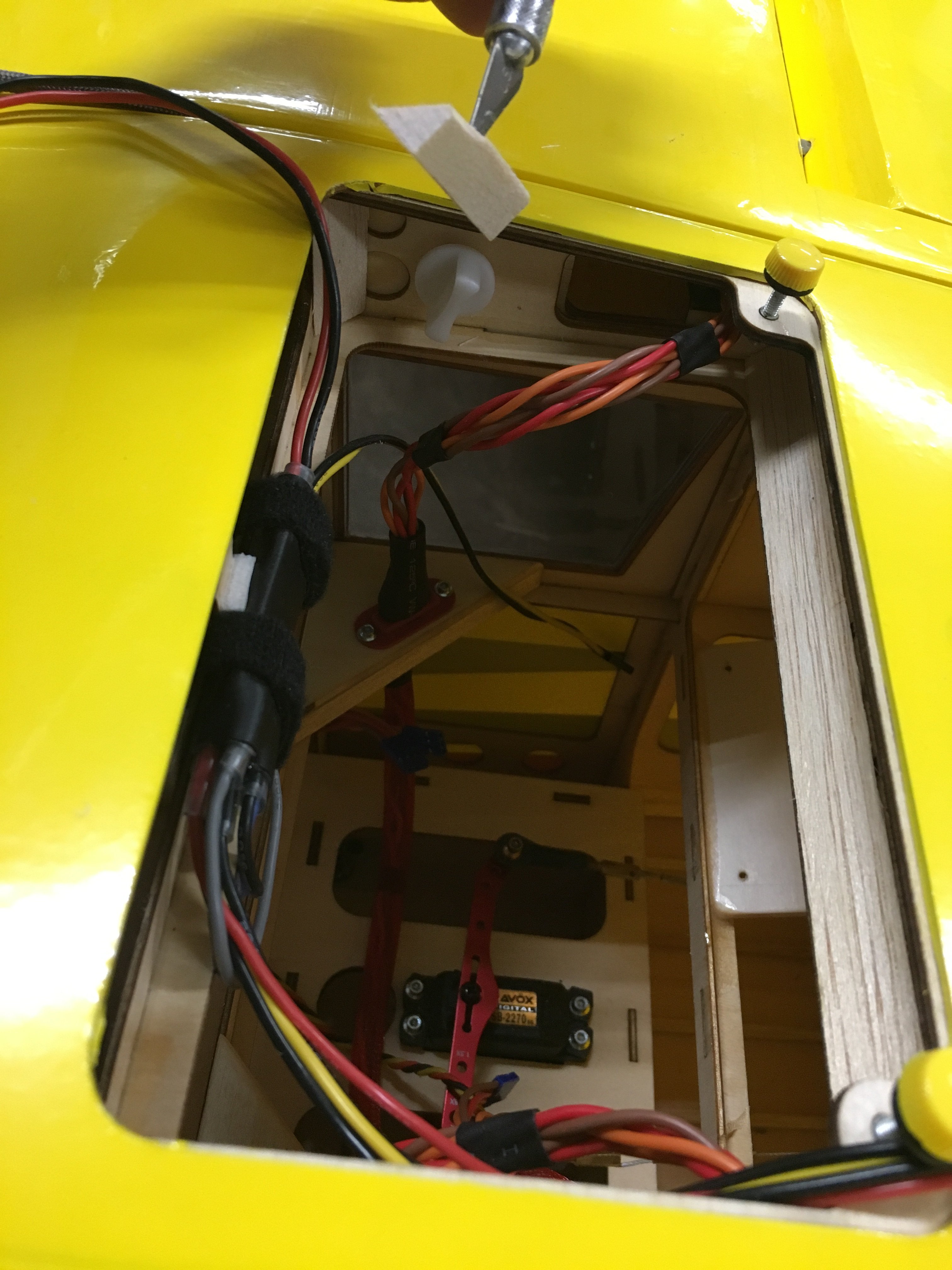

Been working on the interior the last couple days. Relocated my booms pin flag switch for easier wire routing. All I have left on the inside is my tech aero, set my antenna orientation, battery’s (were shipped and returned to sender by usps... darn, hope they reship with no issues), and lastly the elevator set up.
E3BCF1F1-5EFB-46ED-956F-2ECF84558B57.jpeg 401F4314-A37C-4E63-B40E-28E9E9C67C89.jpeg 1A0D9D8C-1103-4B85-A35D-93F2B1149471.jpeg
Okay is my tech aero too close to my pin flag switch if I put it here? My ignition module is basically under my fuel tank.
