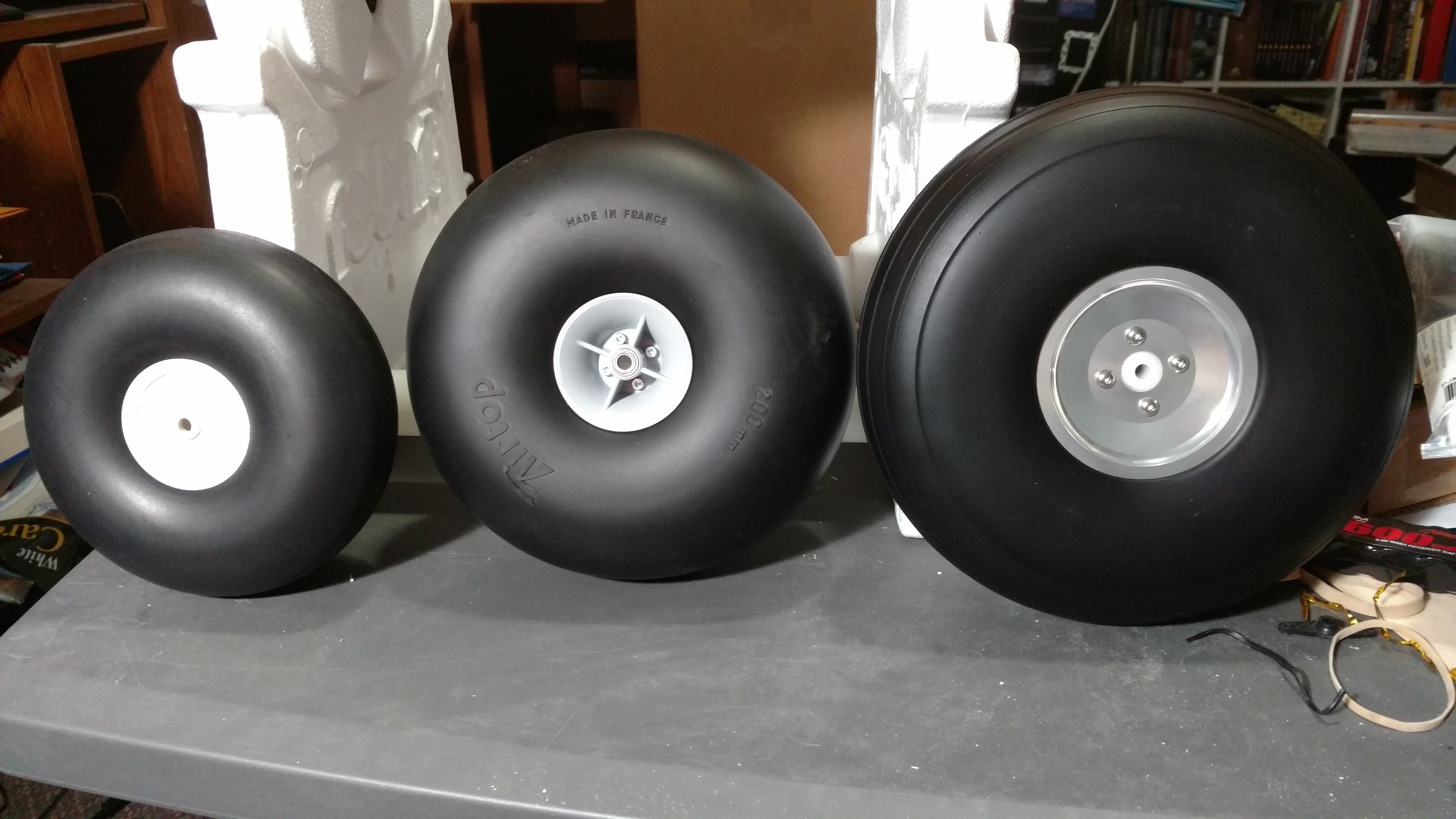

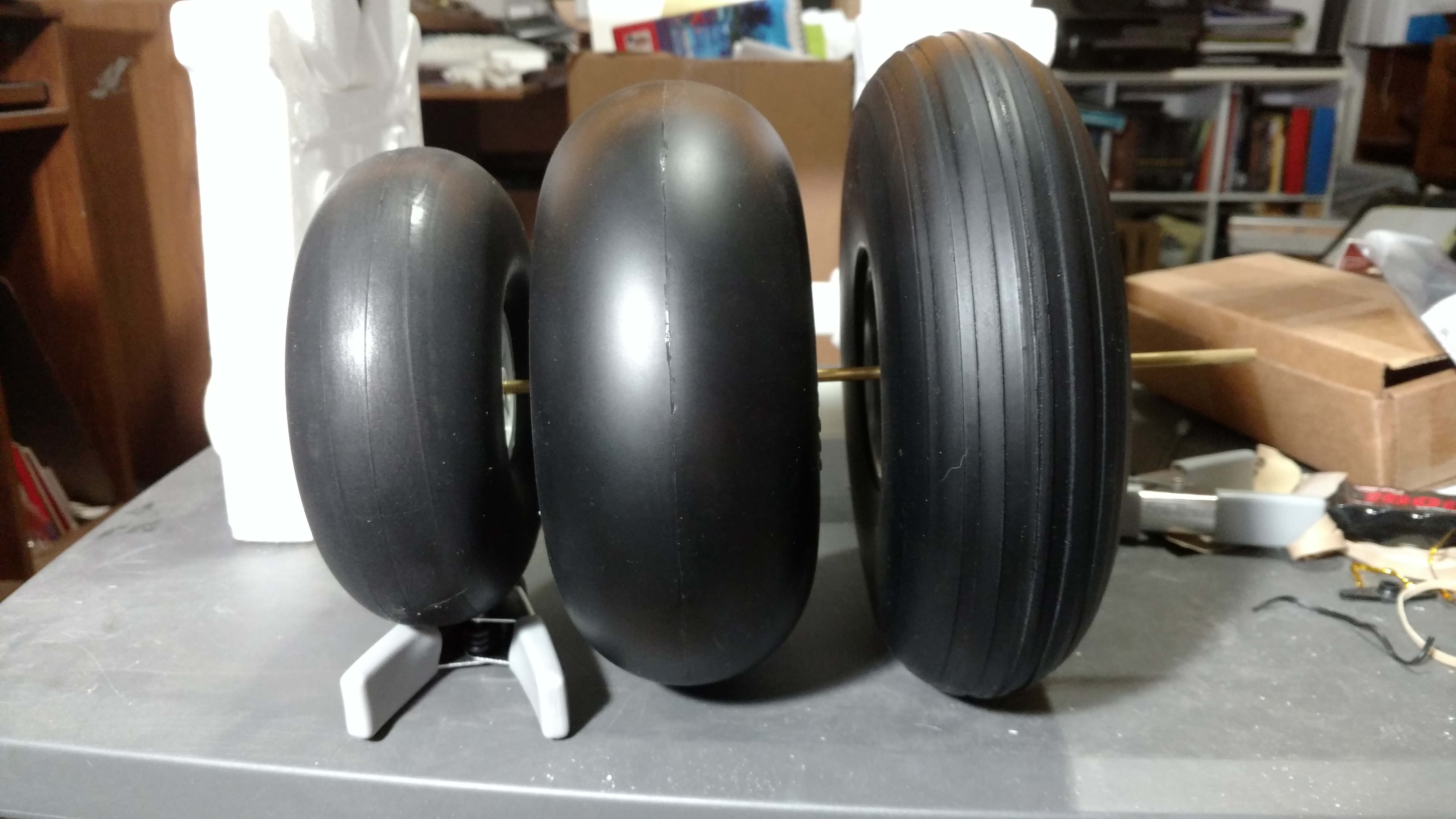

Here are the Pics:
BSteeve
I think they will be the ones I run with to start out. I wish they made them 8.5, 8.75 or 9.0 !! Who knows what could take place with the Timber Bush planes hitting the scene ??

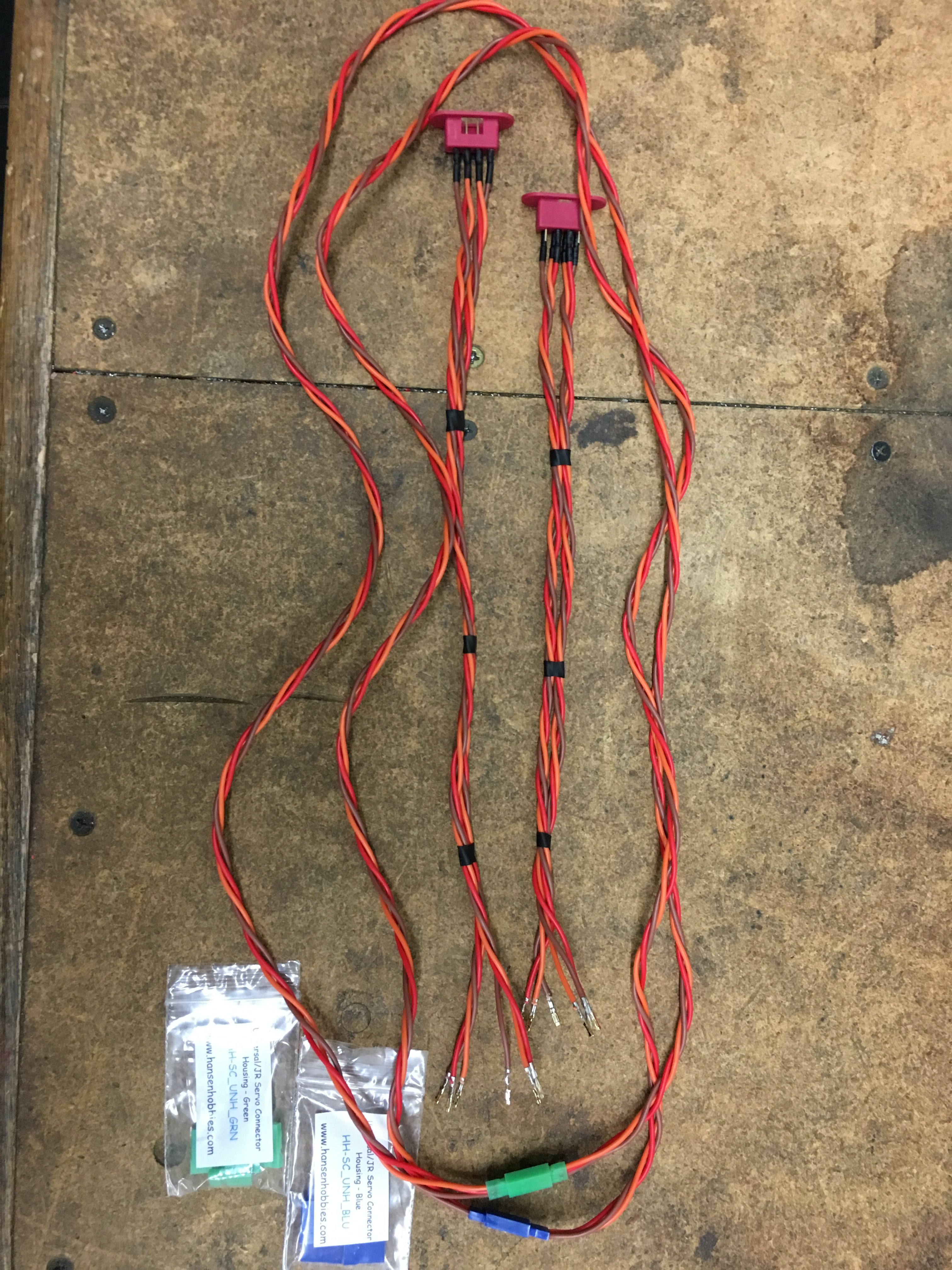

Made the other half of my MPX connectors. I must have deleted my photos of the finished product.
I like the Hanson hobbies wire, easy to work with and crimps nice. I’m using the blue for the left and green for the right. Also made the elevator wire extensions.

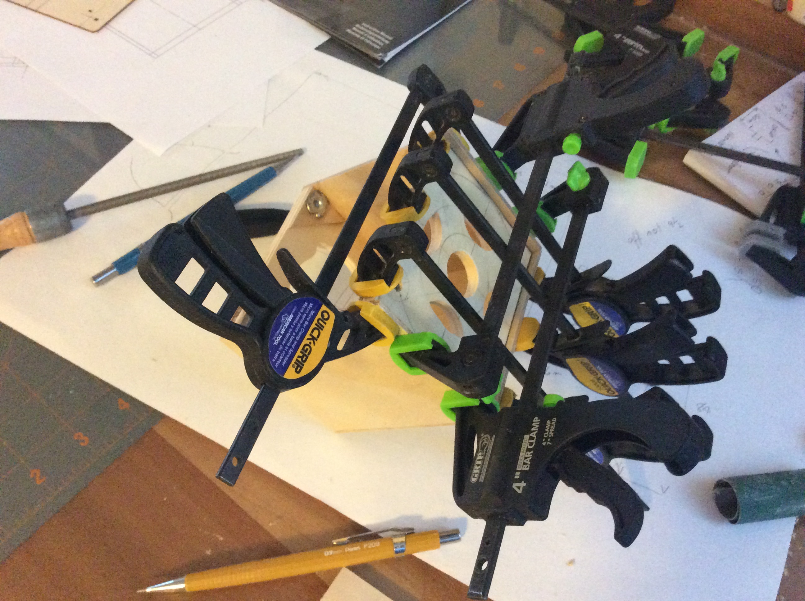

Glued a ply tray near the glider servo slot for my receiver. Created a model in my 18SZ, linked the receiver.... I am getting close!! Need to make may throttle linkage and finalize my servo setups.

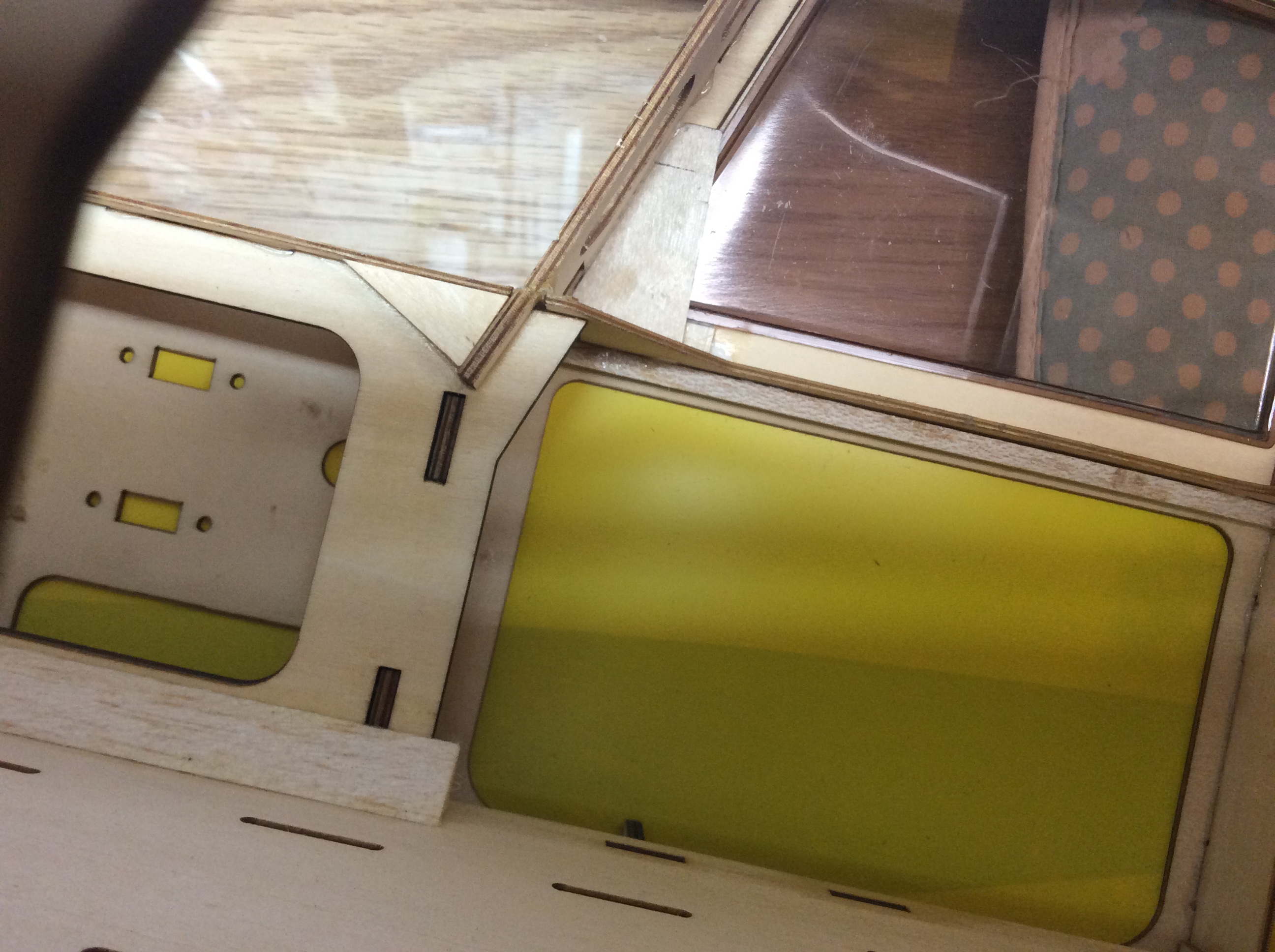

Weather was not good again so did a little work in the shop. Made a start on the new E-Power motor box. And did a little reinforcement as AKNick has made us aware of some of the weaknesses in the plane.
Added the same block as AKNick and another triangle at base of the window.
