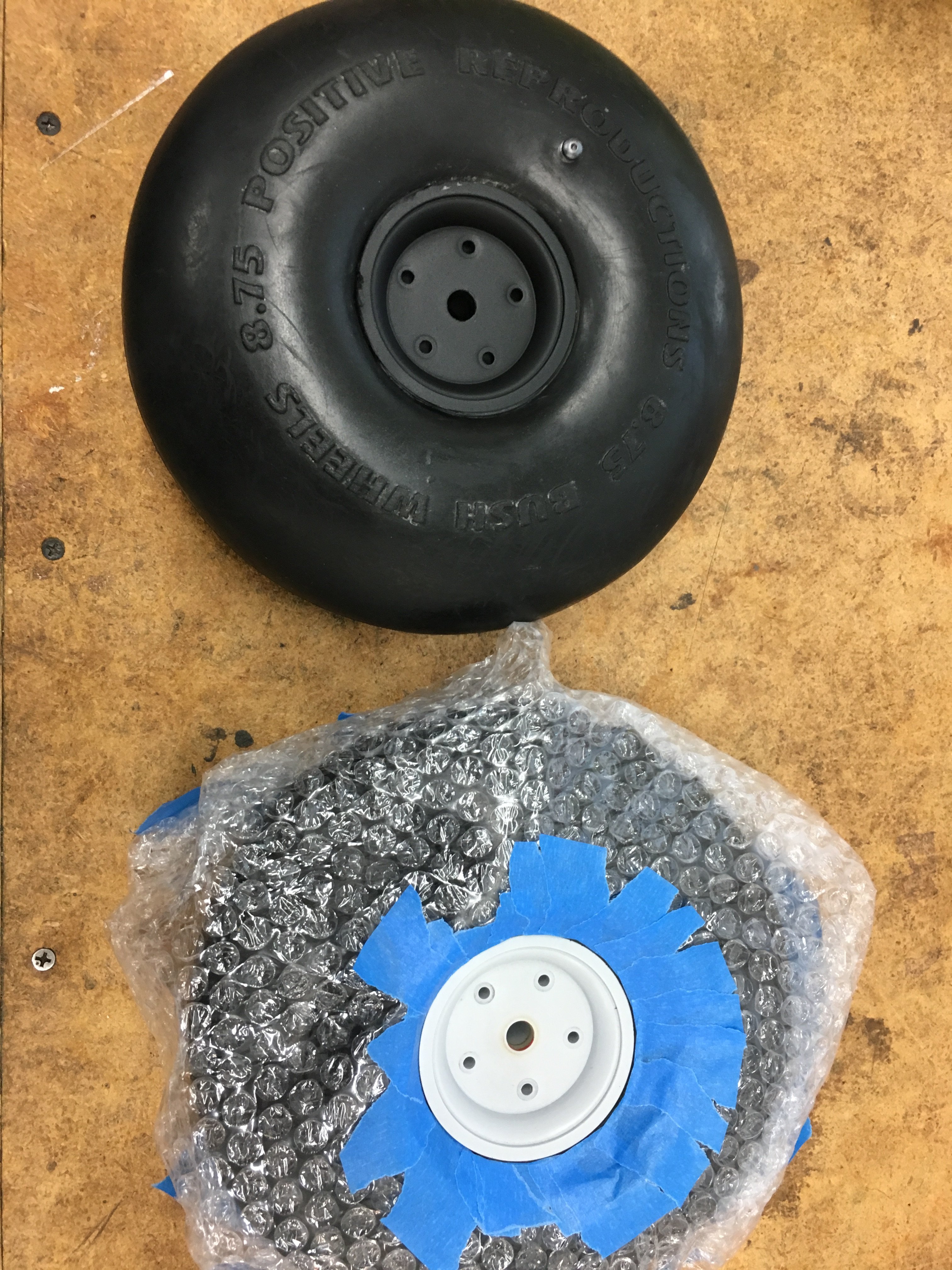

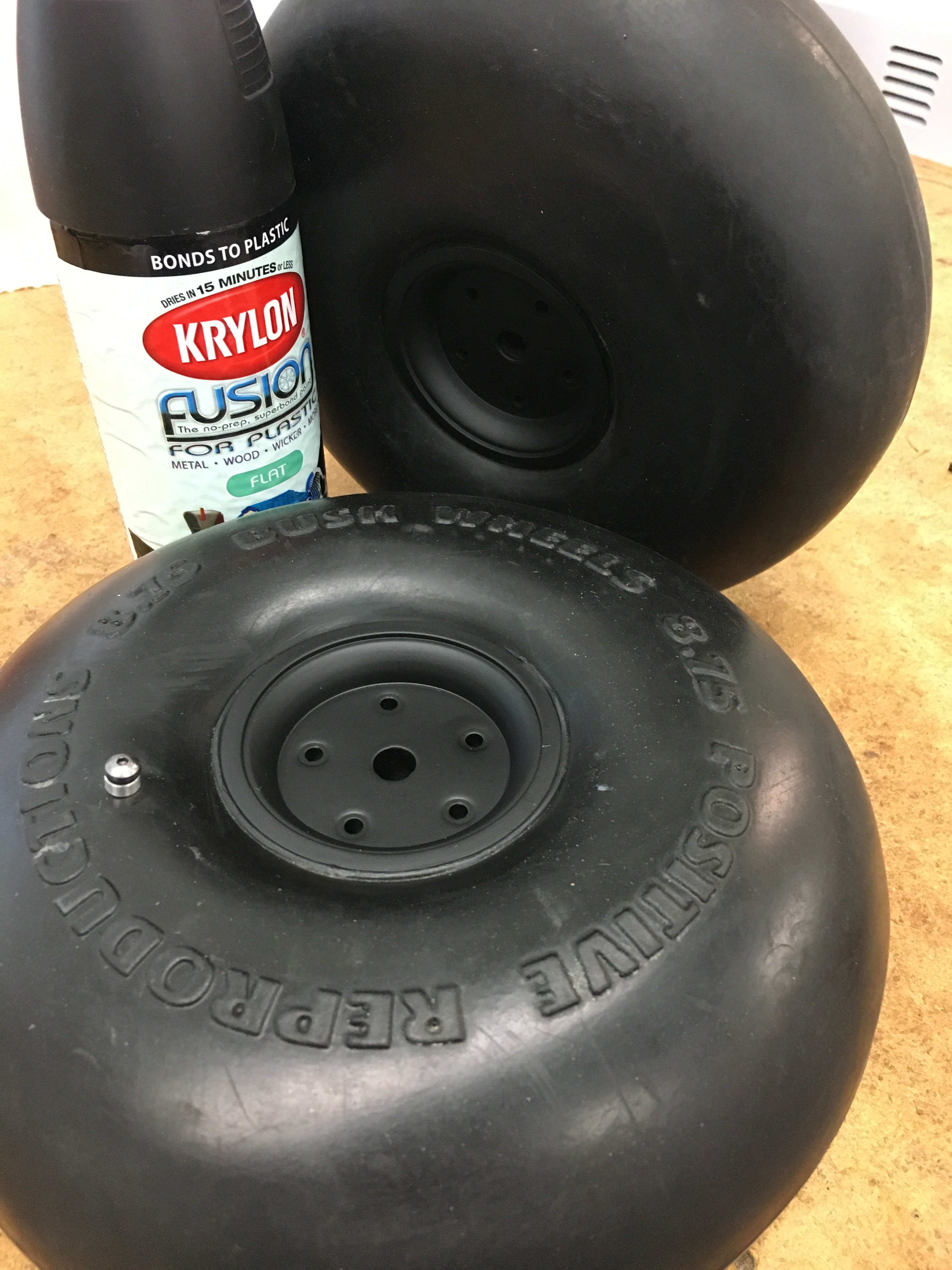

Played with my PR bush tires as promised. Painted the wheel hubs Krylon fusion flat black.
Can’t say it looks that much better, but has a nice personal touch to it that resembles Alaskan Bushwheels.

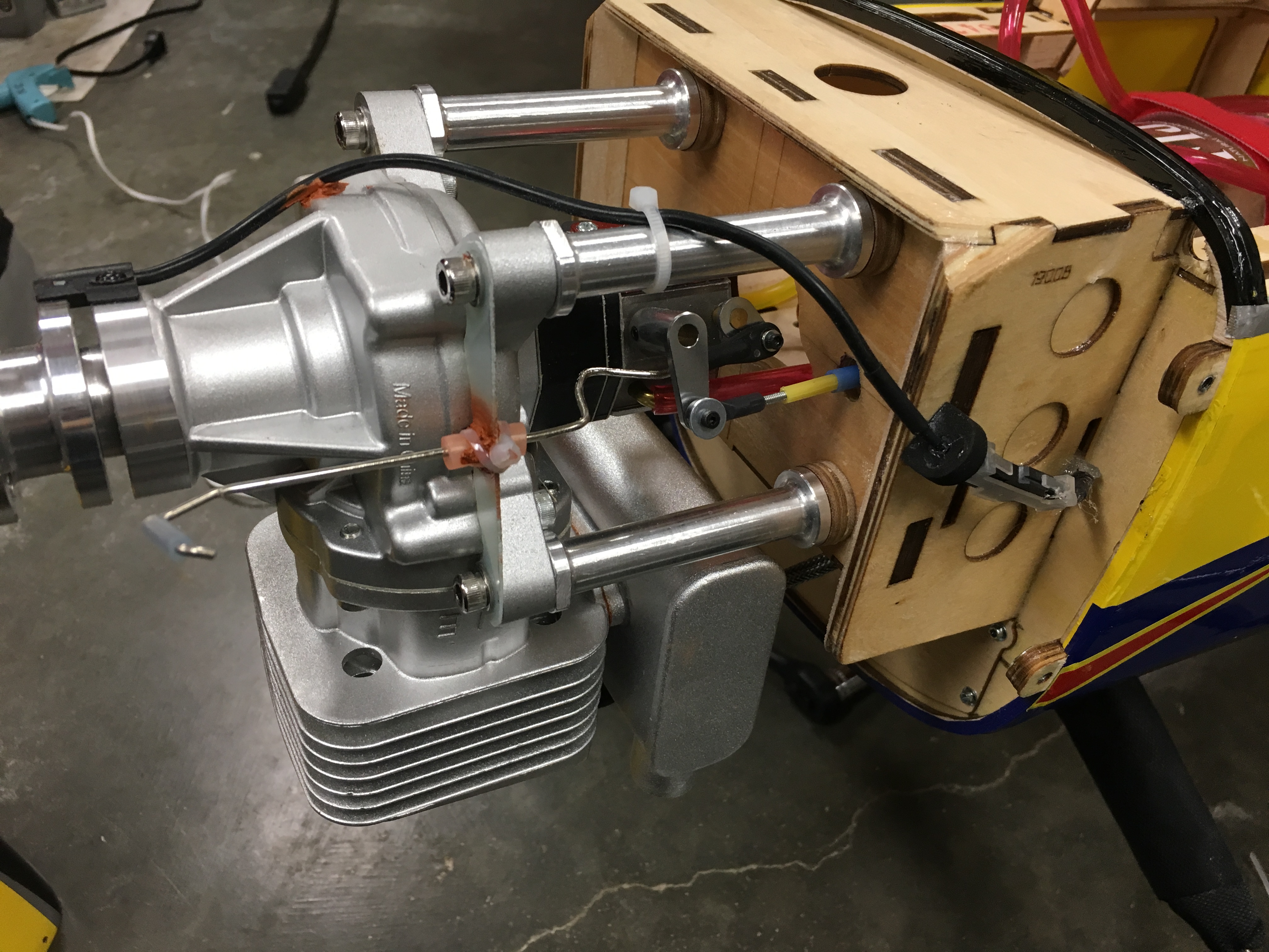

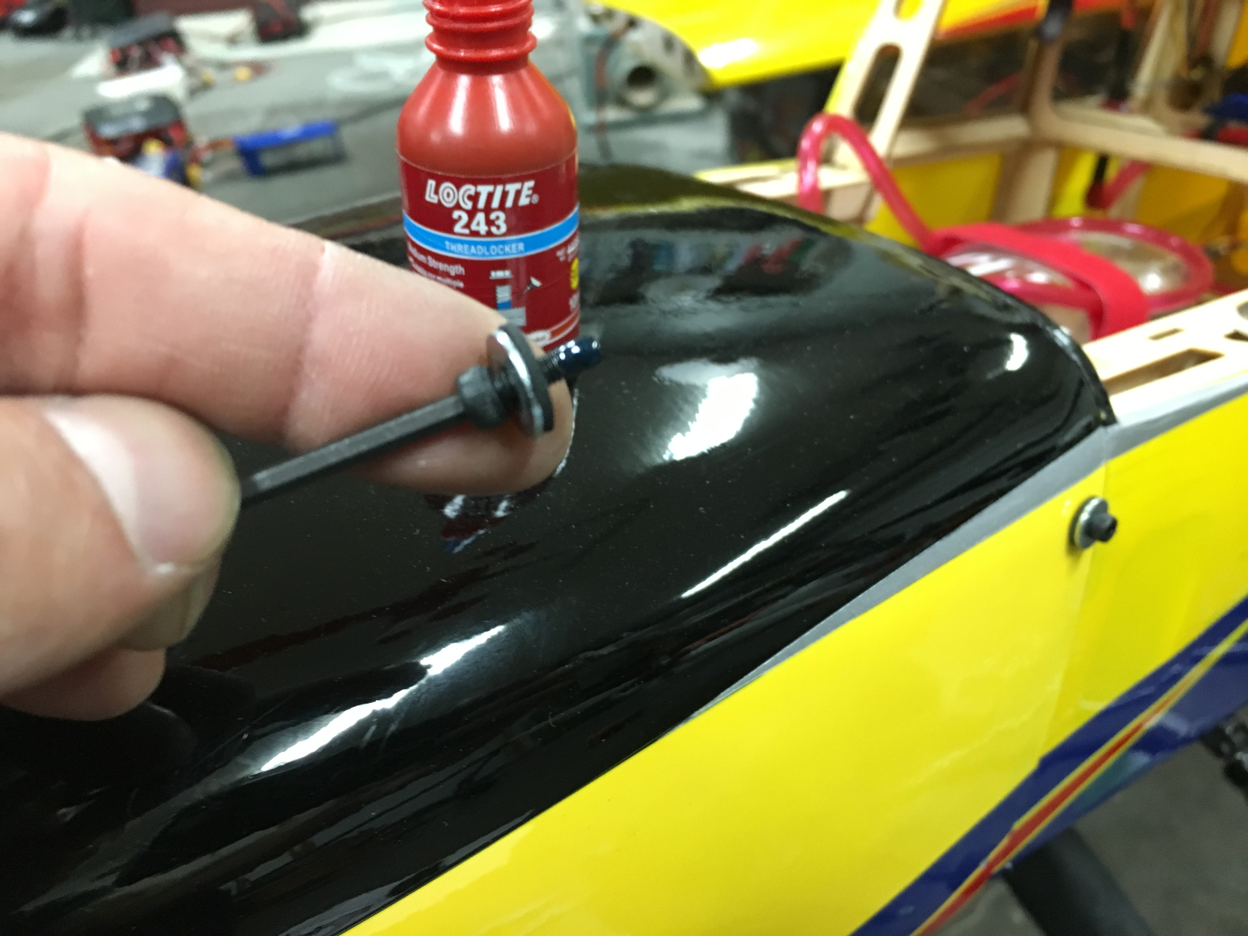

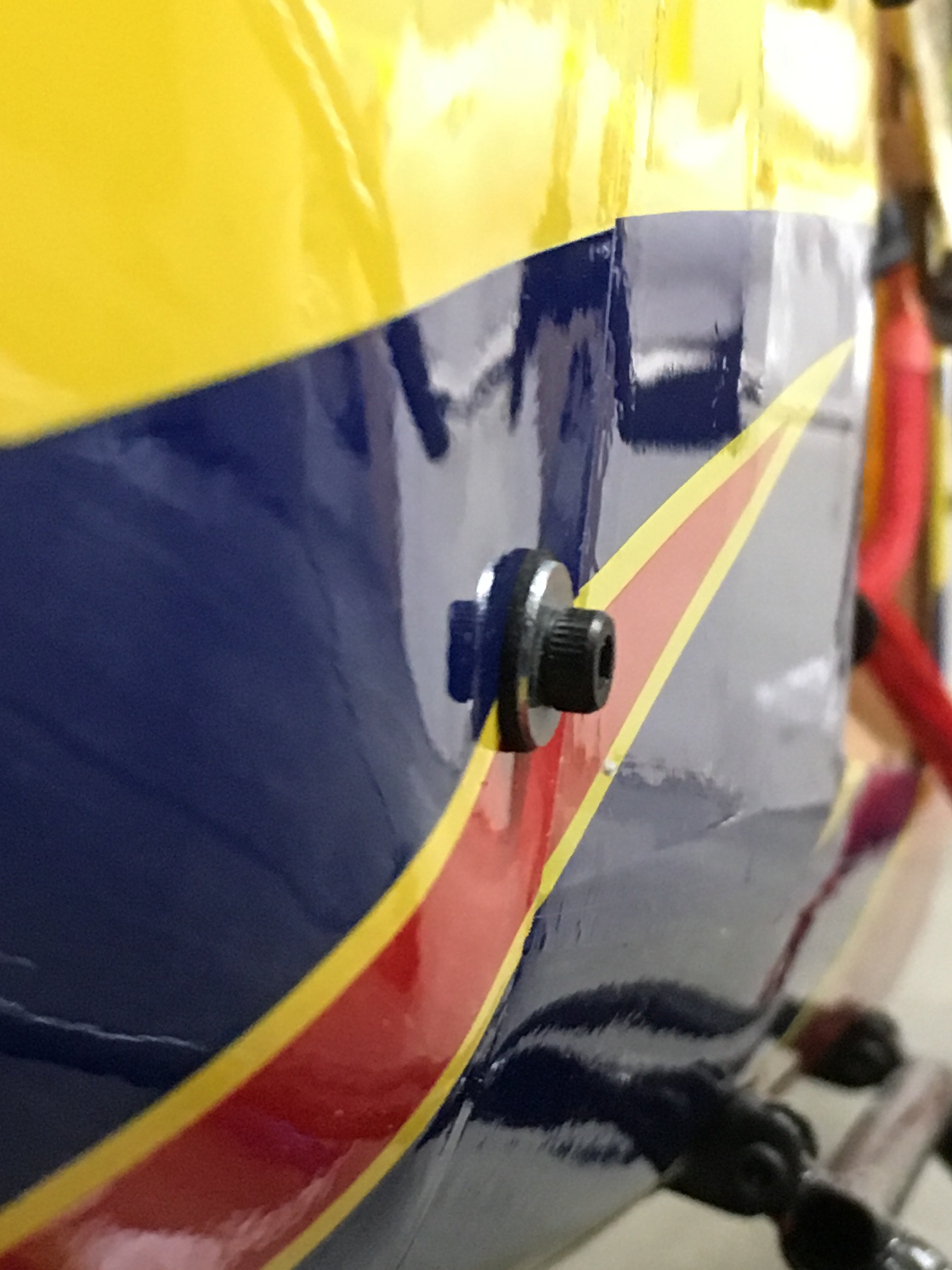

Here are some photos of the engine before I put the cowl on it. Note the Allen screws with the large metal and rubber washer included! Pretty nice. Little dab of blue locktite, and tightened them up. I did notice a bow in the cowl that was fairly significant, might end up shimming up the nutplate mounting surface.
