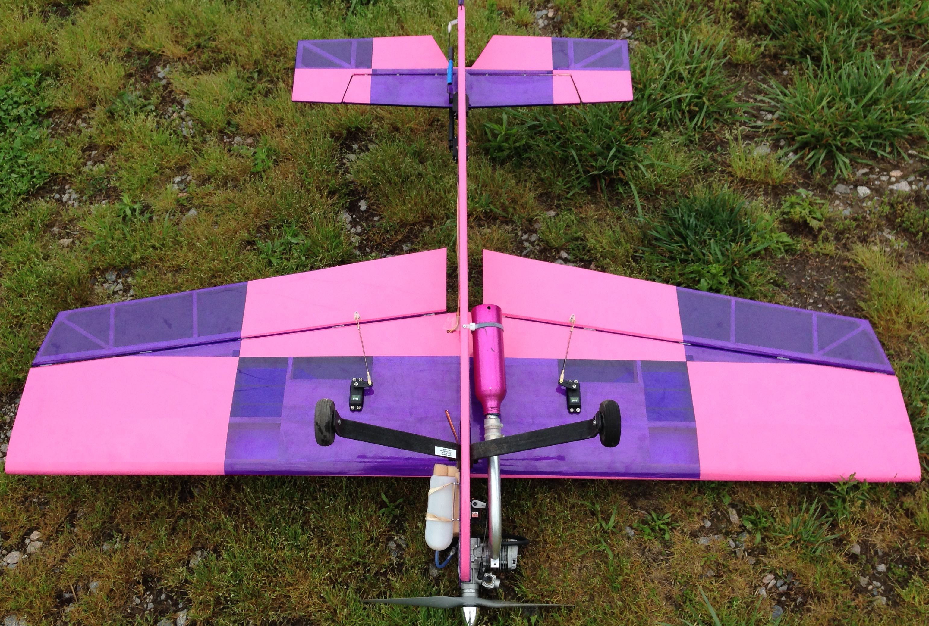

It's hard to see in this photo and I will see if I can find a better one but all I did on the 40 sized one when I built it was literally a small piece of double sided foam tape to stick it in place and then drilled a small hole through the fuse in front and behind the servo and wrapped a tie wrap through it. Was very secure and never had an issues with it.
Like the muffler looks like a beer can how well did it work.
Thinking of double sided tape but with a spring loaded carburetor and covering I am not confident that it would work for long. Plus there will be some fuel spilling out of the carb towards the rear in the location of the servo. It may still work giving it some serious thought.
