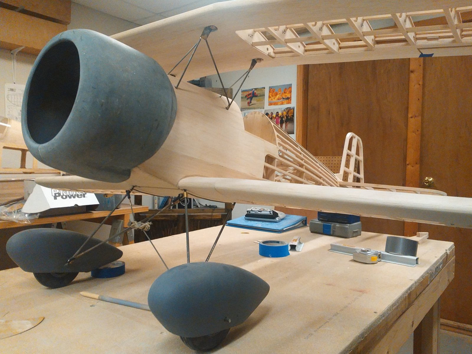

Just curious, why didn't you lay up the cowl as one piece with the mold halves clamped together. I understand doing fuse halves separately cause you cant get into them but this baby was wide open at the back and should have been EZPZ. It would have eliminated the step of joining the cowl halves.
Doc
Just being cautious. I had trouble getting the plug out with the front lip and the cowl flap holding things together. Also I was going to add a reinforcement strip of cloth there anyway.

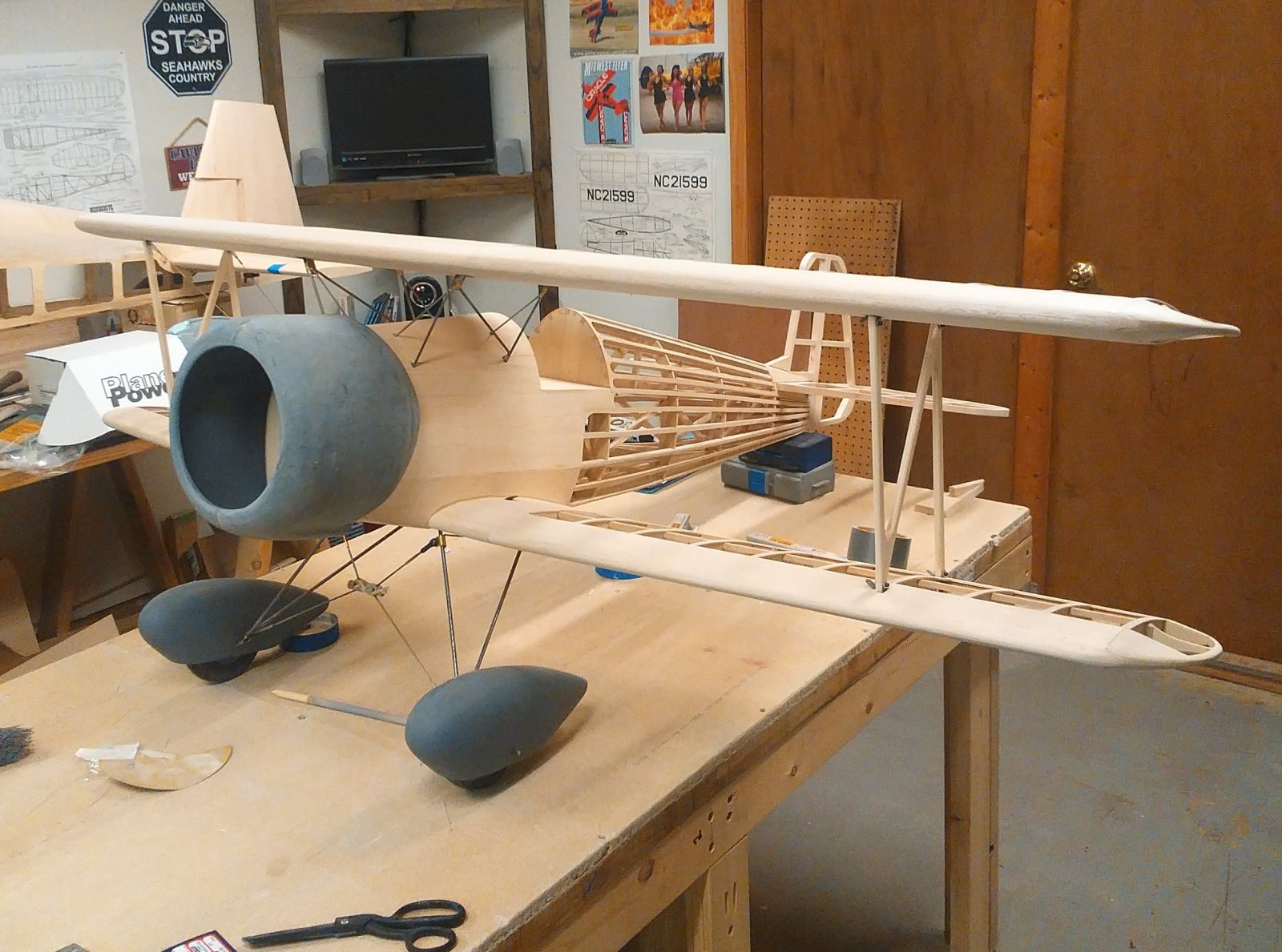

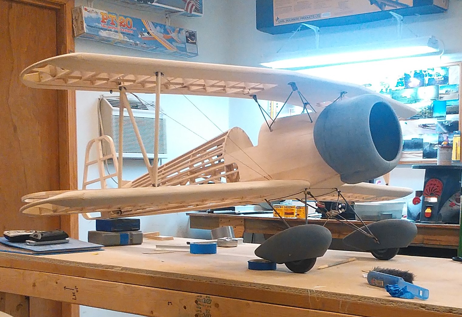

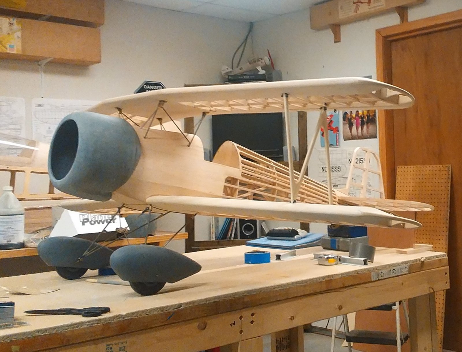

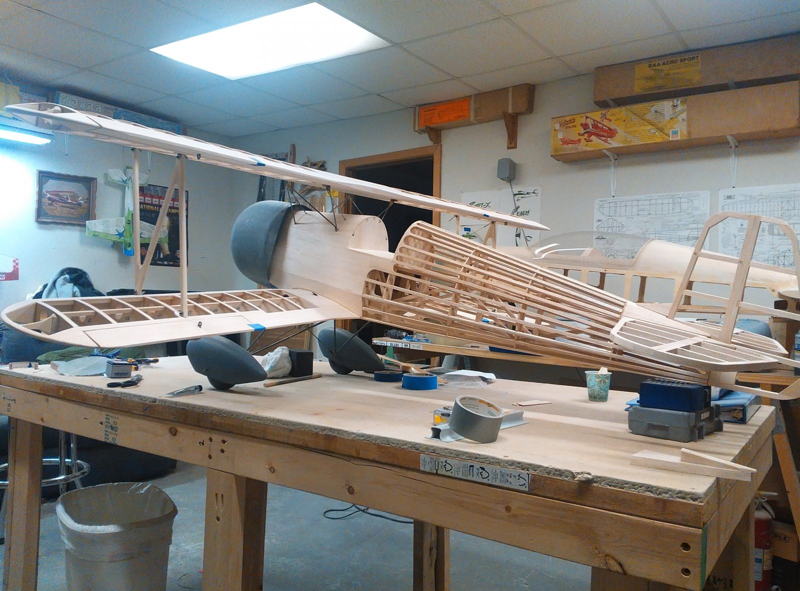

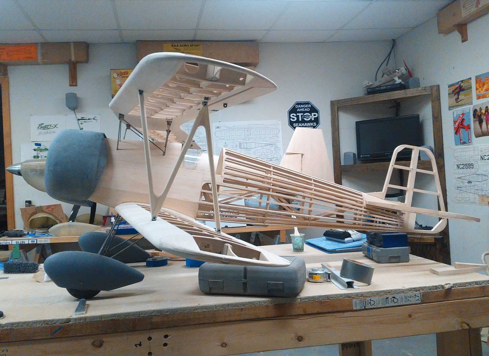

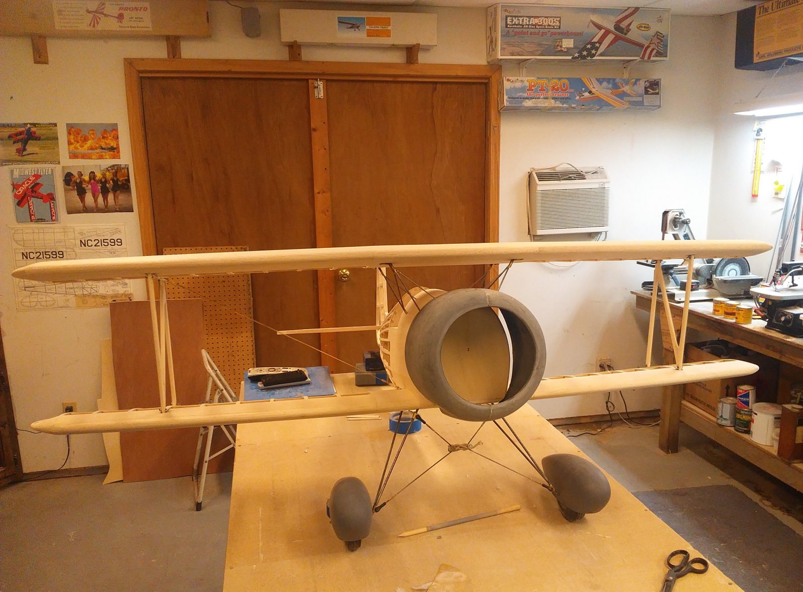

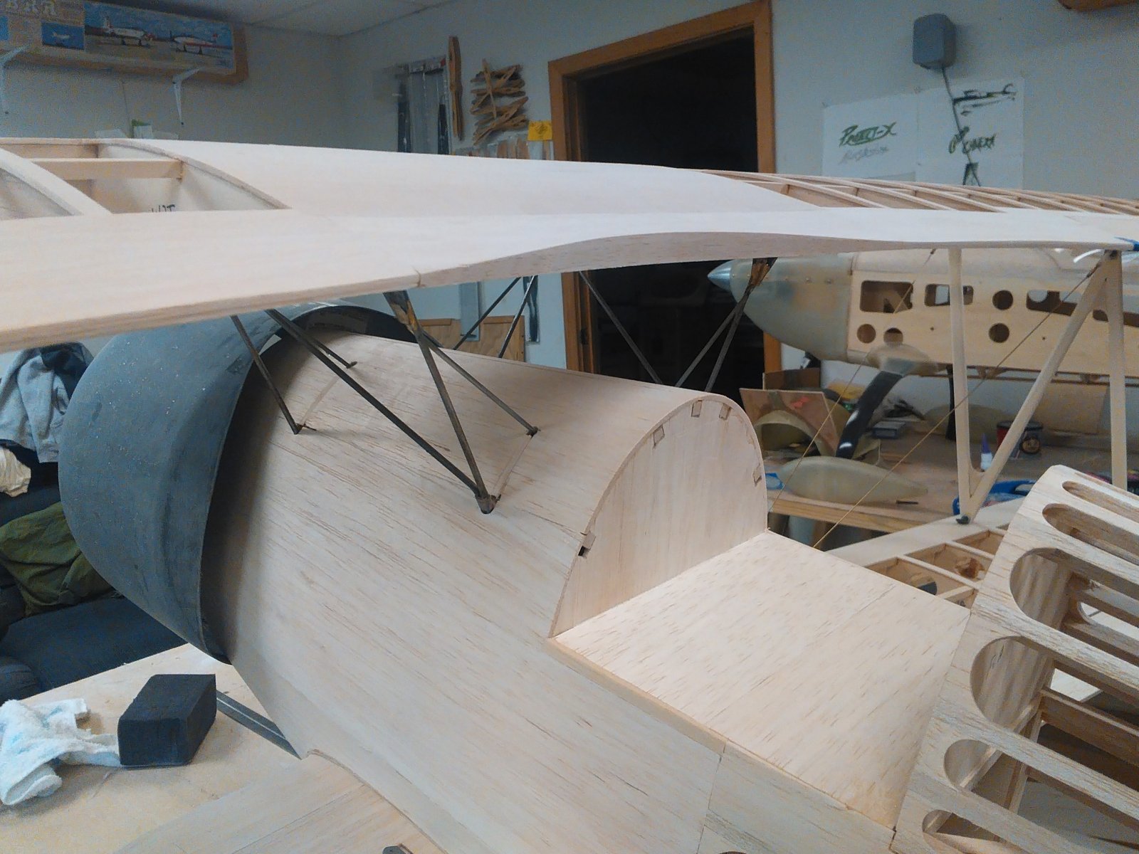

I had to take a few more pictures before I put it up for awhile, so thought I go ahead and post them just for the heck of it :)
Bipeguy03
Just beautiful work!!! :way_to_go:
Thank you!
Damn! That is unreal! Love watching this work of art come to fruition. Learning a ton also. Very much appreciate what you have been doing here!! Thanks!
Thank you for following, glad that your learning too so am I! :)
Glad you took a few more photos, that is one sexy biplane!
Can't believe you're setting it aside, but I'm sure the covering and painting will be just as awesome as the build has been so far.

At first I was going say that the wheel pants looked to big but then I went back to page one they look right. The original plane had a Q35 in it what engine are you planning for the plane. Still good looking plane and a long way to go.
Doc
Its going to have a Q35 just like the one Grand dad built.

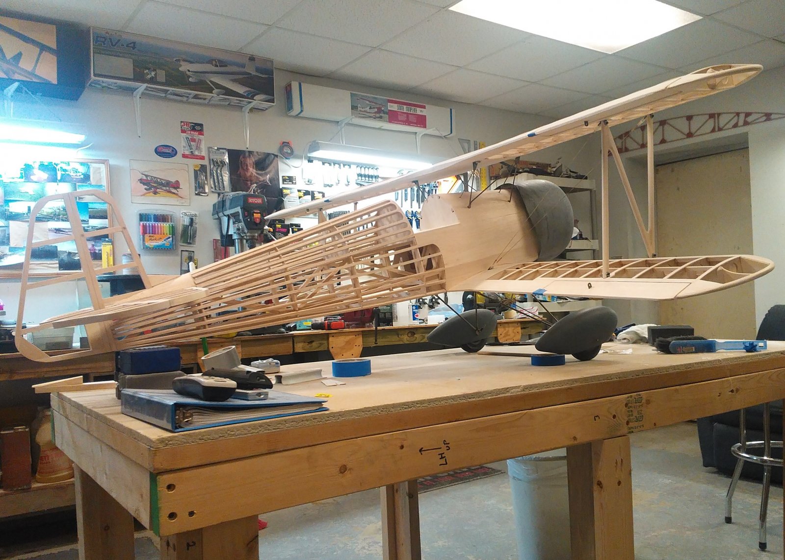

My original plan was to use a DLE or EME 35 but I got to worrying about it being tail heavyafter reading the logs Grampa kept. His Krier originally had a Tartan Glow engine on it (remember it was the early 80s lol) which is comparable in weight to a DLE or EME and he had to have 14oz of lead in the nose. With the Q35 he took it all out. This thing has a really short nose and a loooooong tail, which means it should track like an arrow, if it ain't tail heavy!
The other reason it's getting the Quadra is my dad found one NIB on Ebay for $90 so couldn't pass it up!
I think a G38 would be another good engine for it, or if someone wants to give building one a go when I'm finished, you could always stick a 50cc in it for ballistic power. It's does have a 71" wing after all;)
