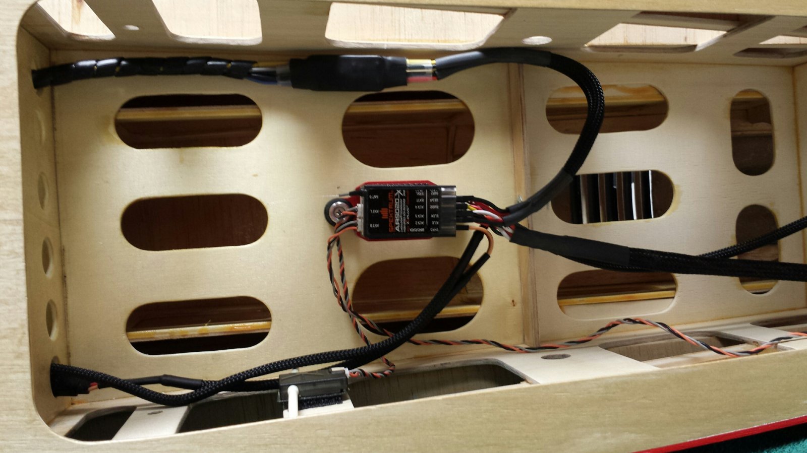

Like your overflow nice and clean install.
On the ends of you snake skin you just put heat shrink on to keep it tidy.
Like your canister tunnel looks nice and big you get something into that hole.

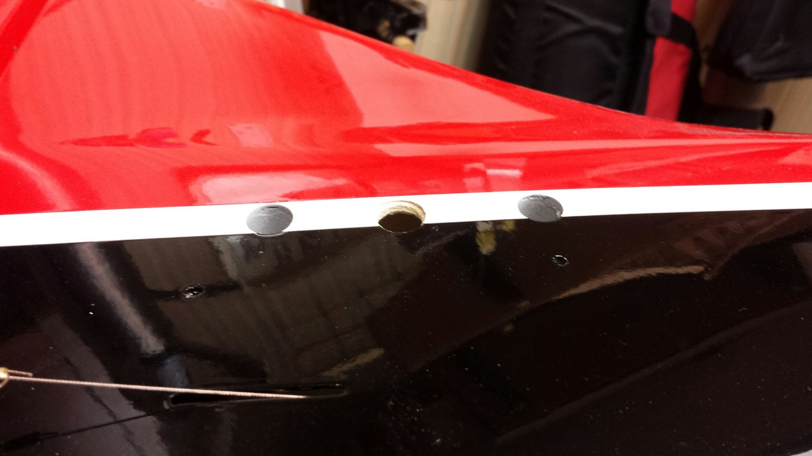

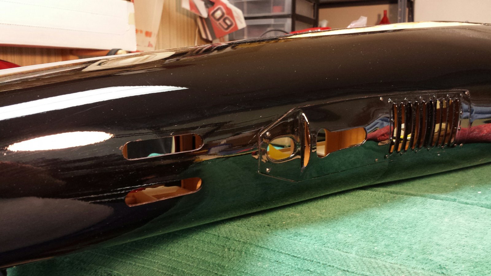

I decided to add some vents in the bottom rear of the fuselage behind the pipe cover. I also realized the other day that I had never cut any holes for the elevator extensions, so I took care of the too. I also added some tabs in the fuselage to route the elevator extensions through.

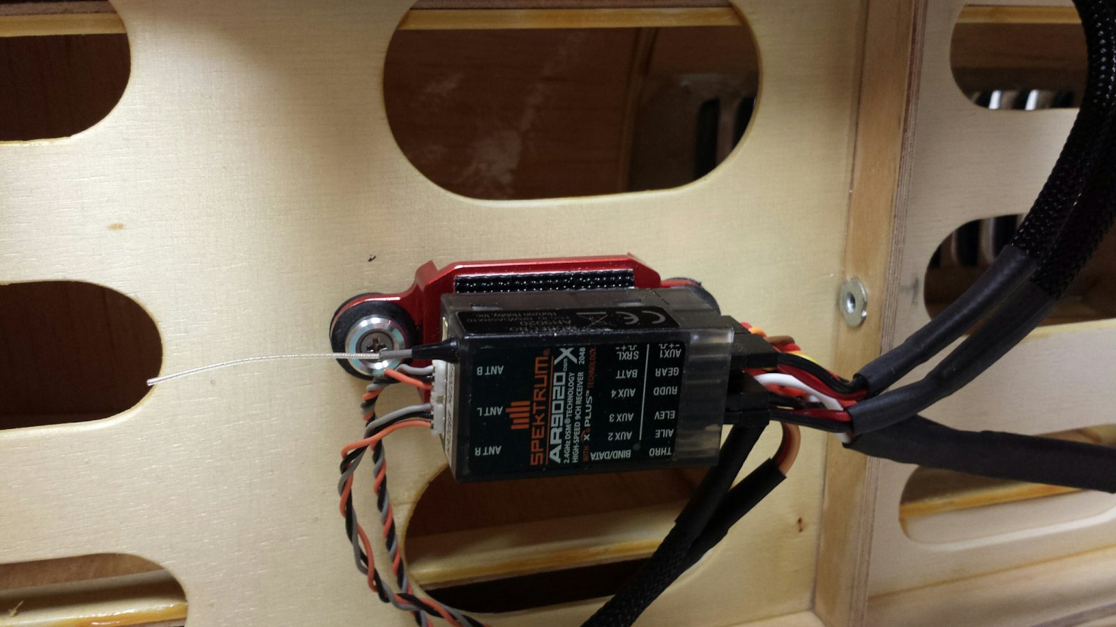

Hey Doug, what and where did you get the fancy receiver mount? Looks pretty cool.
It's a Secraft. I got it from Aztec Aeromodels. I've had one in my Edge for about 5 years. I had to spend a little time thinning down the rubber grommets because they were a bit thick, and I used 4-40's and blind nuts to hold it down instead of the wood screws it came with.
