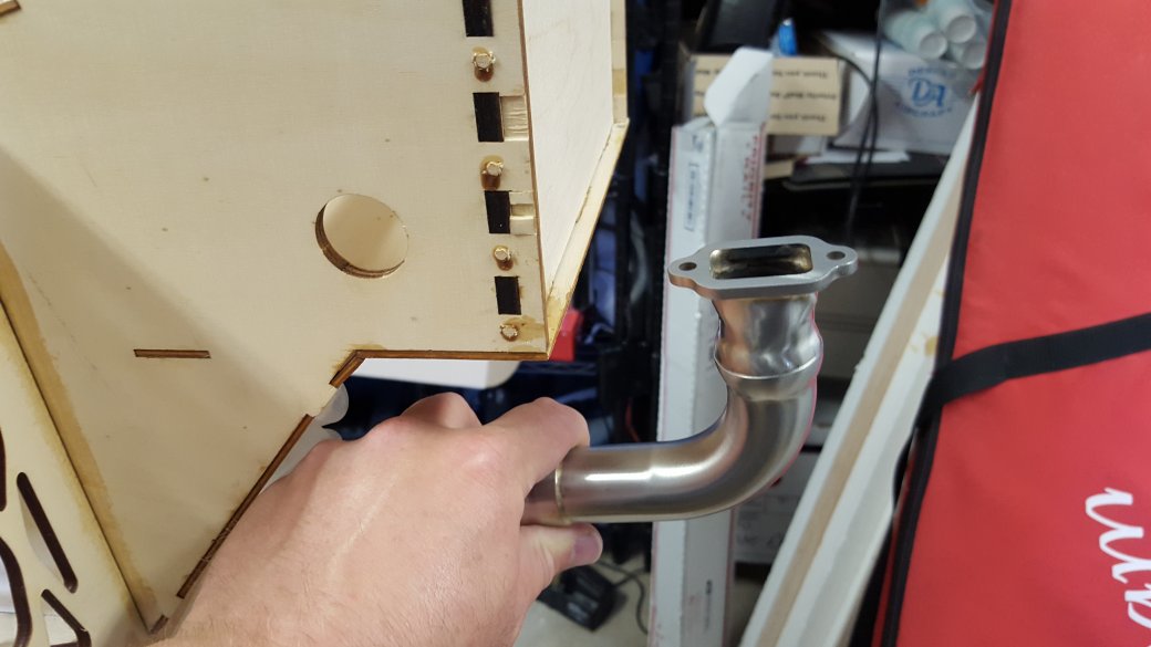

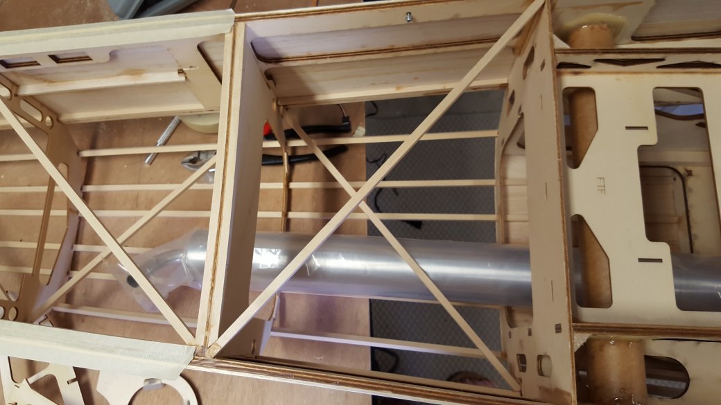

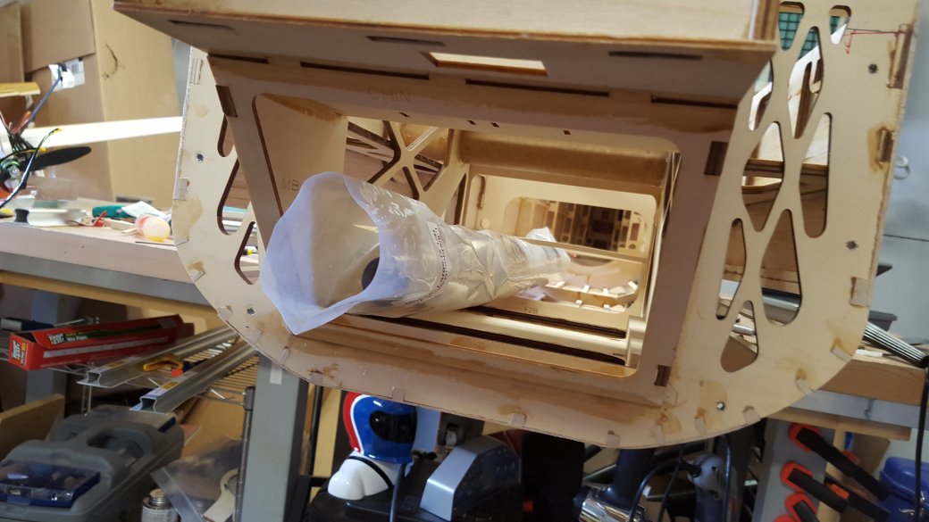

Finally got around to getting the pics from the weekend off of my phone. I had to do a lot of traveling the previous 2 days so I haven't had a chance to get out to the shop.
What I'm working on is getting the plane set up for the Smooth Pipes. I first estimated where my header would be with the pipe in the tunnel. I measured again and from the first fuse former to the front of the cowling is 13 5/8". This helped me figure out where I can attach the rear pipe mount to a former. It looks like I should be able to mount the front mount to a former as well but I need to figure out the best way to do that in case I need to adjust it's height. The rear is pretty much a perfect fit with very little room for adjustment so I will probably just leave it as is.
