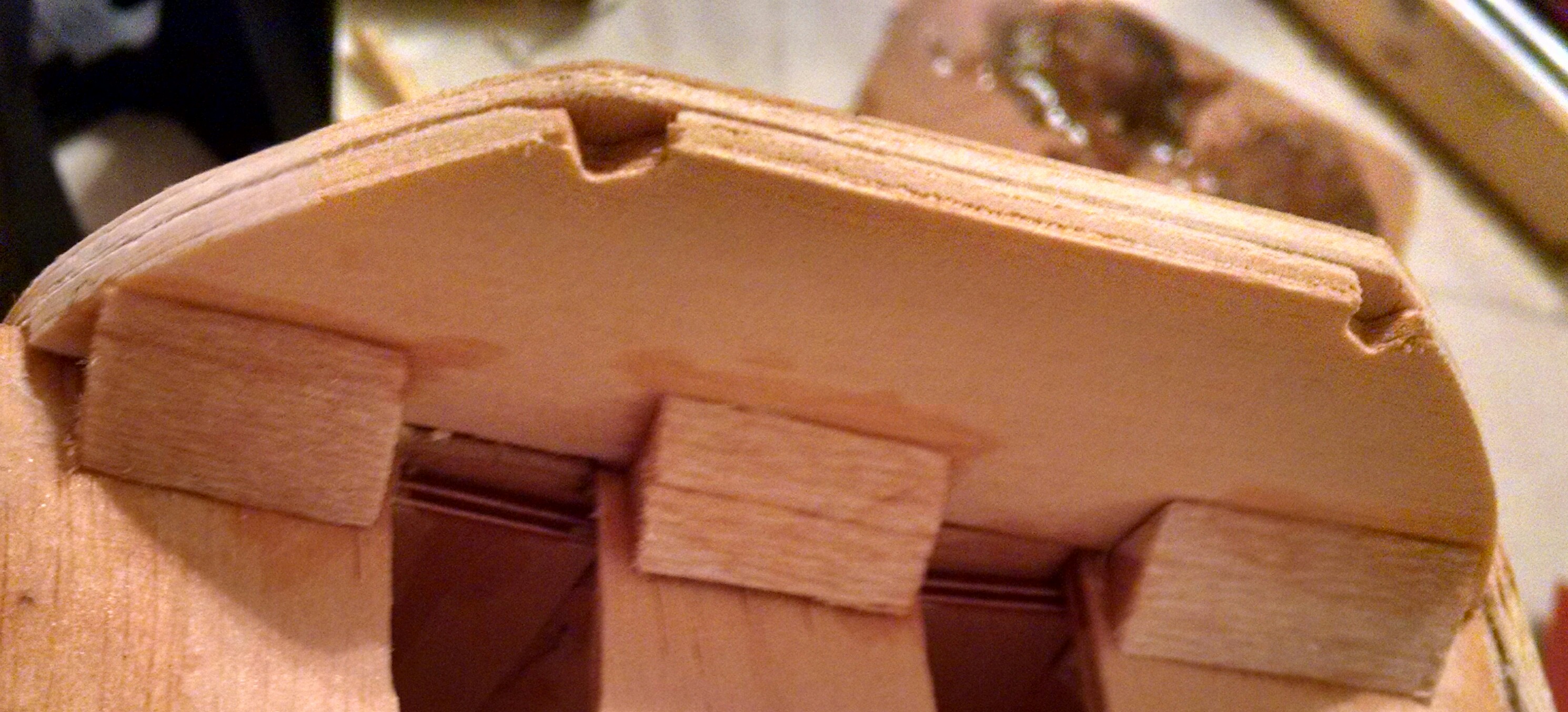

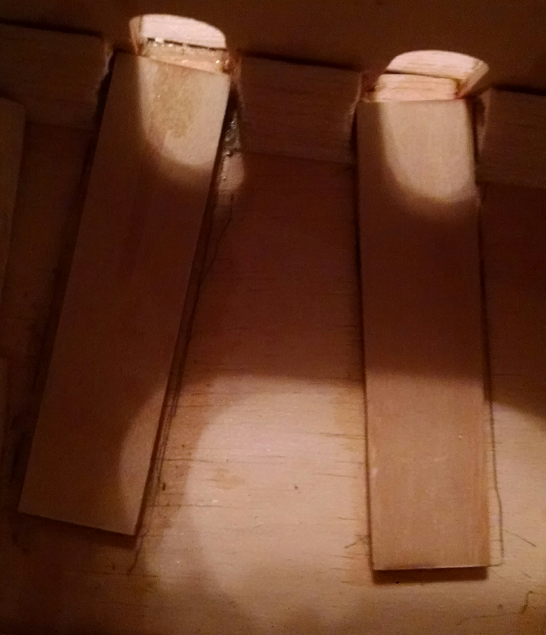

Got some decent build time today. I had to drill the pilot holes for the motor mount all the way through the firewall. The kit has two strips of 1/8" ply that glued to the back of the firewall. These are to add reinforcement for the blind nuts. I also had to cut off some of the extra tri stock reinforcement to make room for the strips. I'm using a larger motor mount than stock, hence the modifications needed. I also added additional tri stock reinforcement to the top back of the firewall. I'll post pics later.
Next is fuel proofing the nose section. I hope to get that done before vacation next week.
rcdude07
Here's the pics. The additional top tri stock is due to using a larger motor mount than the stock one and the screw holes being a tad higher.
