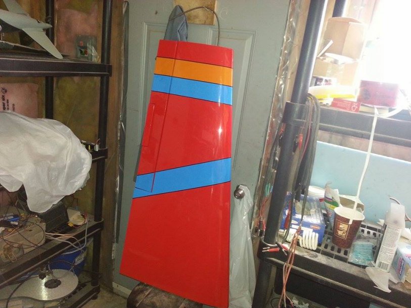

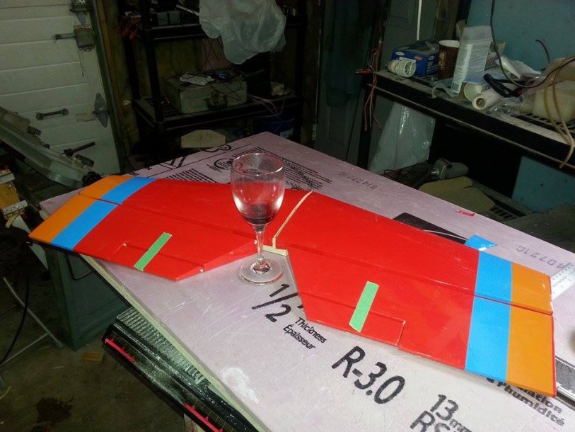

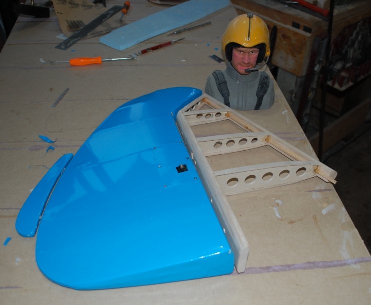

here is the left wing and stab/ele with trims

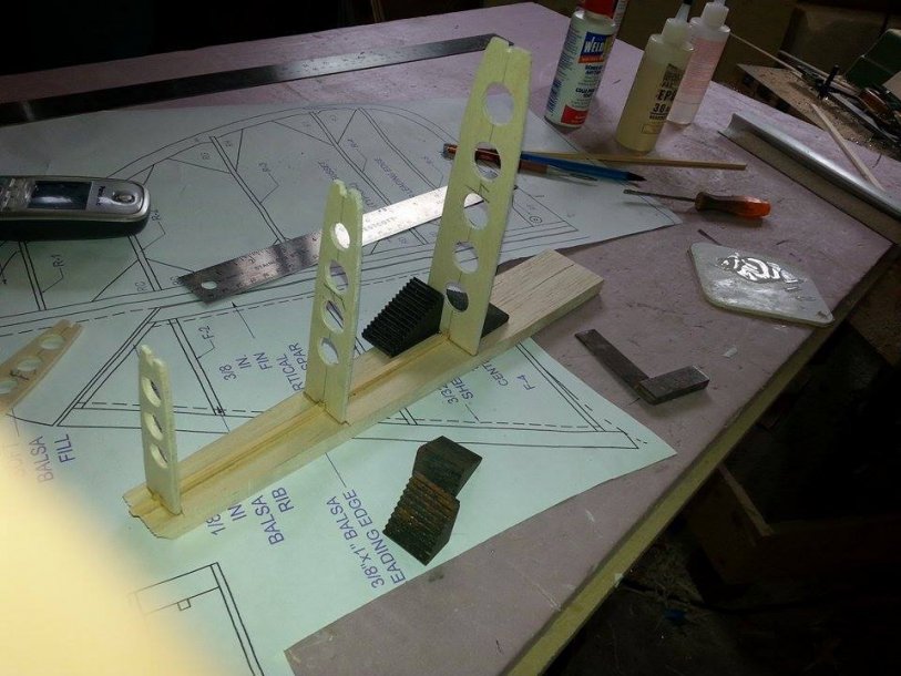

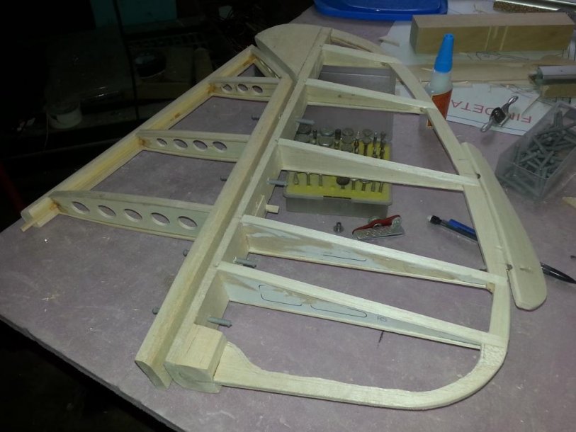

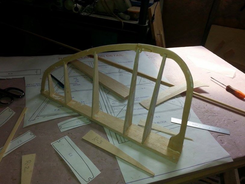

fin and rudder taking shape

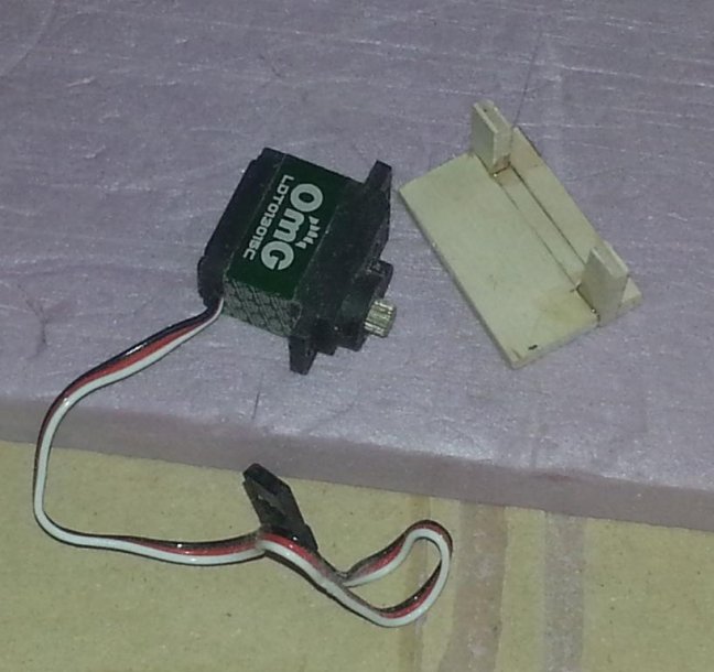

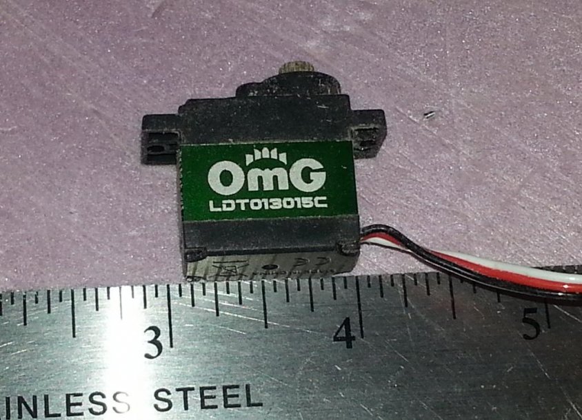

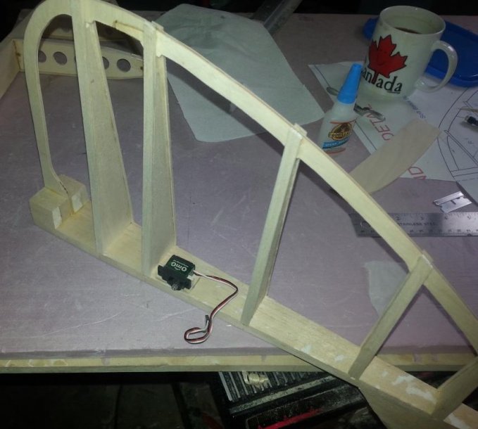

tiny servo for rudder

working on the canopy hinges and windshield and finished the rudder covering with the boost tab servo you can see the tiny black spot

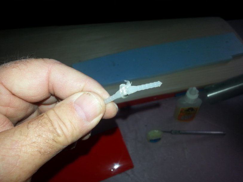

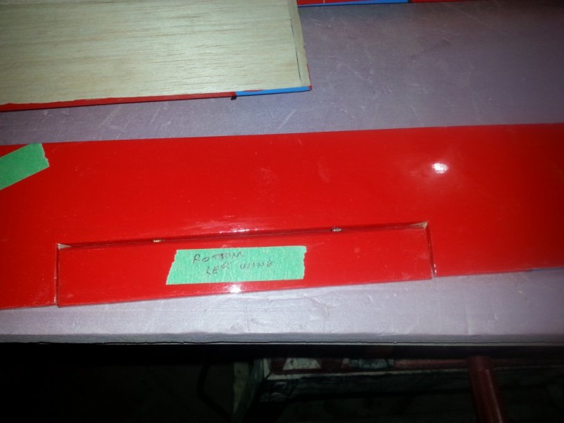

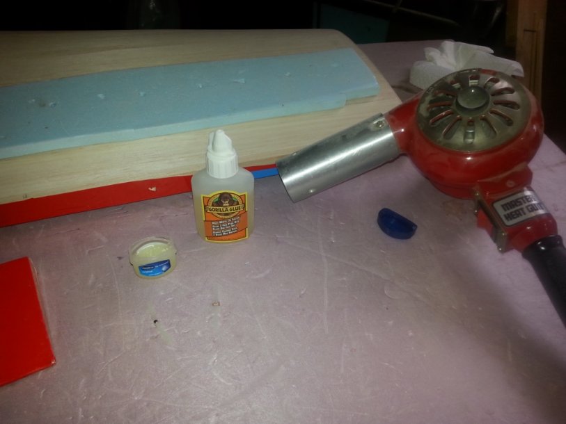

fitting pin hinges to boost and to aileron on finished wing, I use vasoline on the center of the hinge, then apply heat with the heat gun so it will liquify and go into the joint of the hinge which quickly jells back before I apply to the holes in the control surface , I use Polyurethane (Gorila) glue for this since it expends and grabs the hinge point very nicely.
