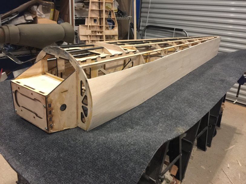

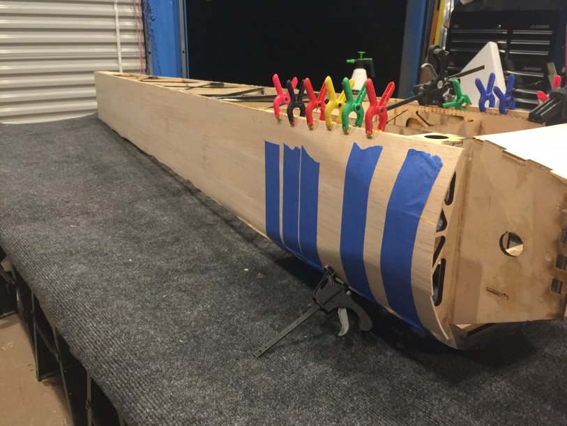

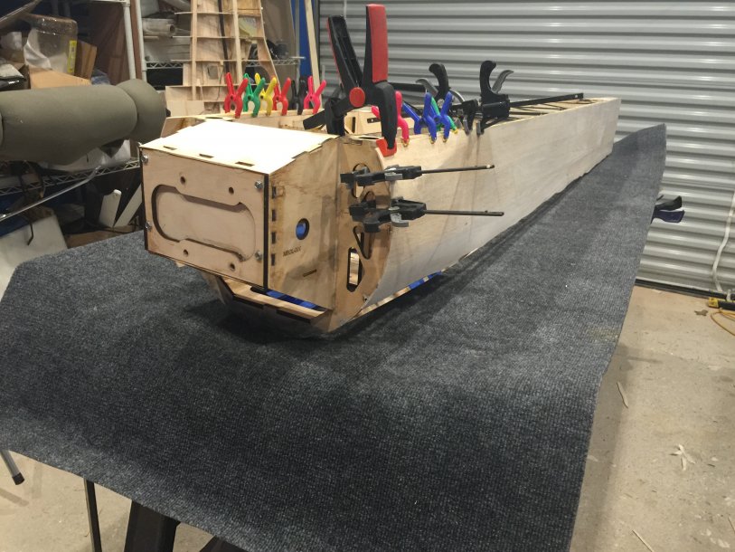

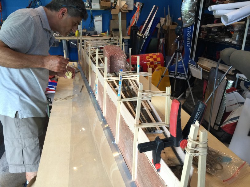

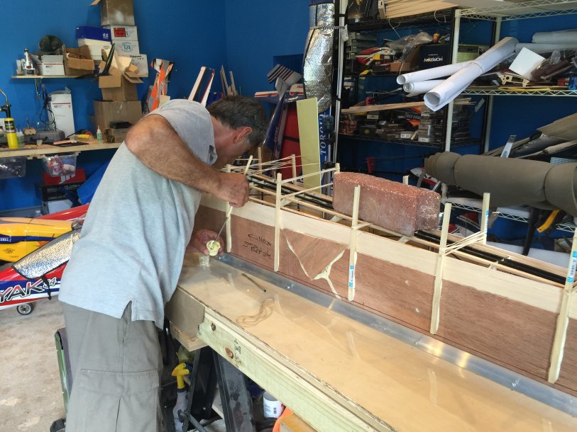

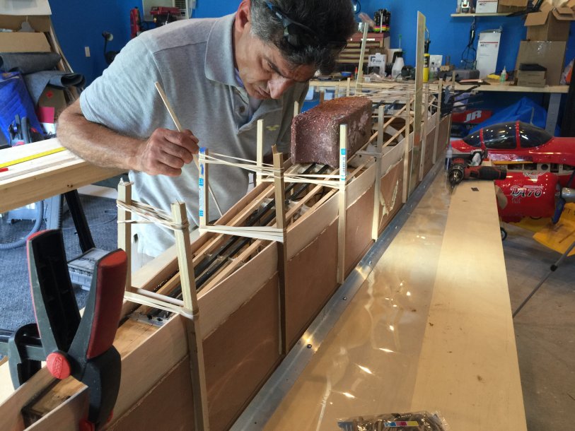

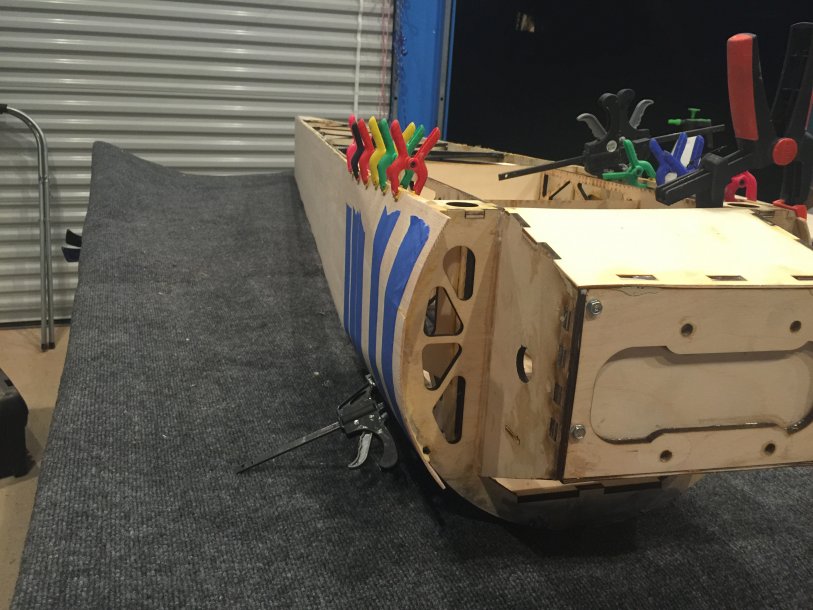

Fuselage sides are on now as well. Just waiting for these to cure.
Good heat outside, so it should cure quick.
It is 85 degrees F outside and in the shop.

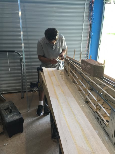

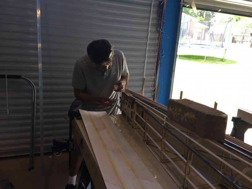

This is my father in law helping me!!

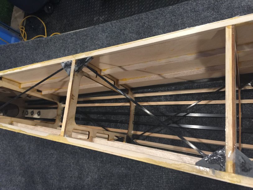

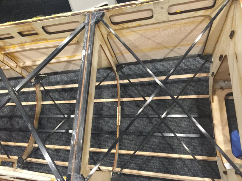

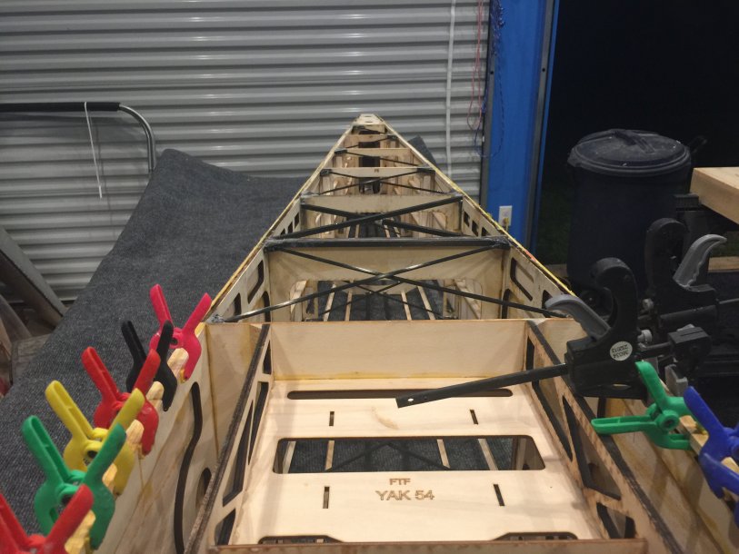

Cam, that is awesome stuff !! Looks great ! what did you use in the corners for the CF cross bracing ??
Some final remarks for the day. I have several...
1. when glueing the balsa sheets to make the sides, look carefully at the individual sheets, and make a plan on which ones to use, and in which orientation. Also, use a straight edge, to confirm that they are as straight as can be. If need be, then trim them so they are straight, but do not take too much off.
2. Splicing the two sheets to make them long enough... use a miter box, and cut at 45 degrees. When glueing the 3 strips together to make the height, then make sure that the splice points are not lined up when gluing the middle sheet to the top one or vice versa with the bottom sheet.
3. Once you make each fuselage side, trim it down some, but allow for overhang on the bottom of the stringers, which is what is sticking up when the airplane is flat, upside down on the work-bench.

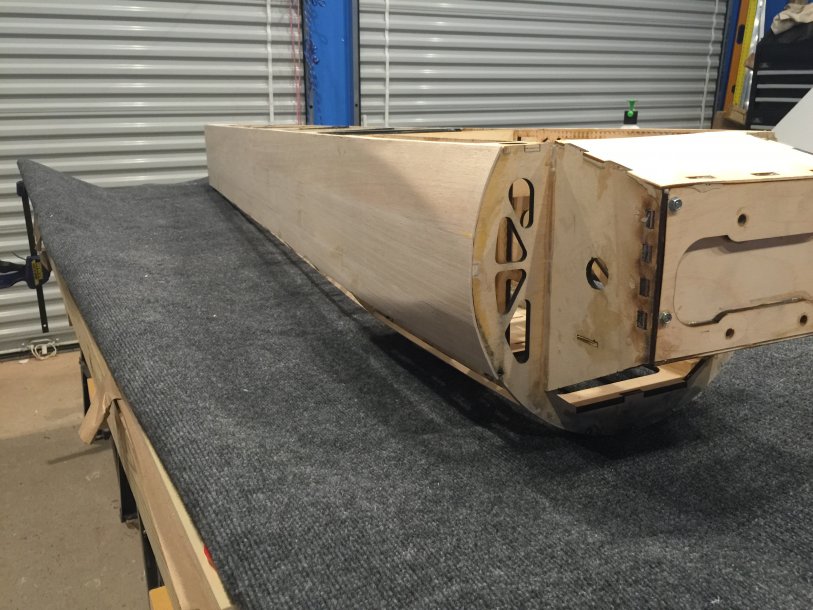

4. Once the fuselage sides are glued, now is the time to also sand them down and make them look pretty.

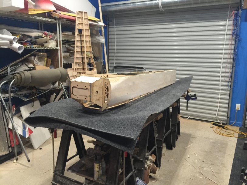

5. once the sides are glued on, from here on out, do not let the sides touch the workbench. any little thing can ding the balsa. I use a brand new rug from Lowes to protect the airframe.

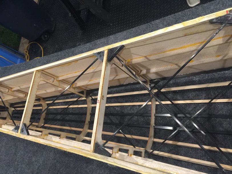

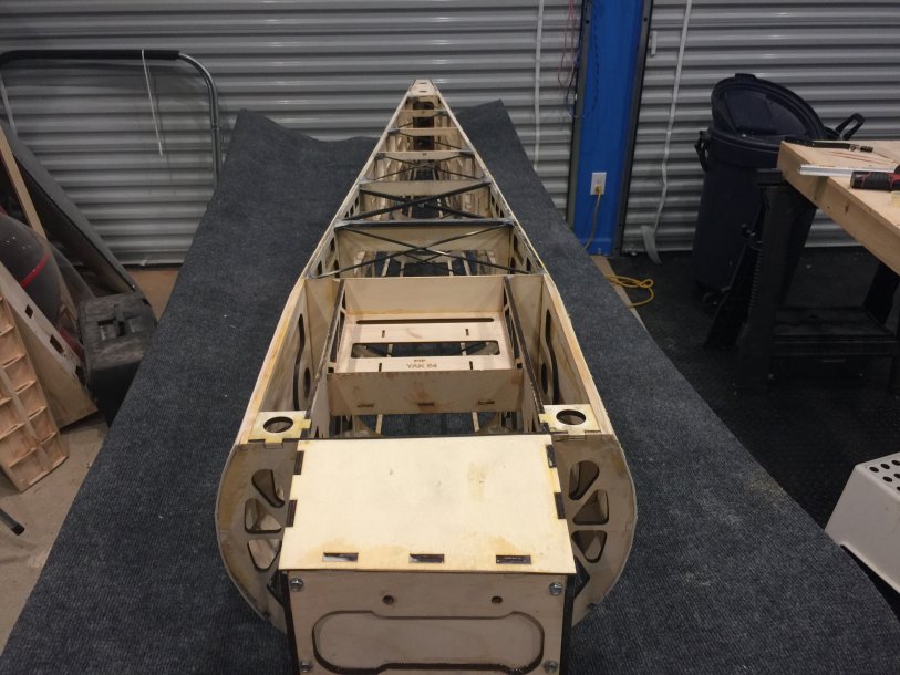

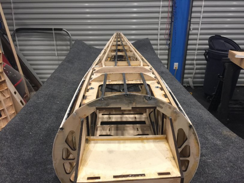

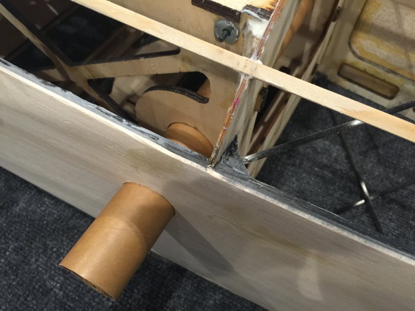

Here are some views of the finished fuselage sides. All the corners have excellent glue joints. I used Titebond II for any contact between balsa and spruce. Any contact between carbon fiber and balsa was glued with V-POXY. Thanks again to Hamid for helping me with this step!

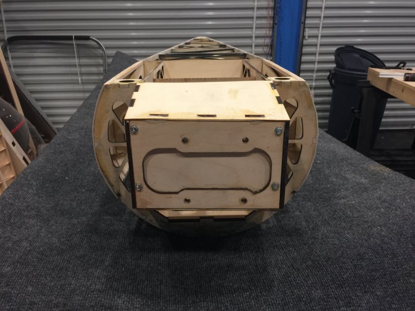

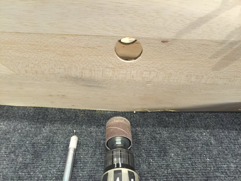

The hole for the wing tube phenolic is 1.5" in diameter.
I obtained this drum sander from Harbor freight == 1.5"
worked perfect!
