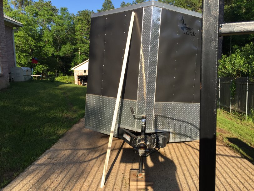

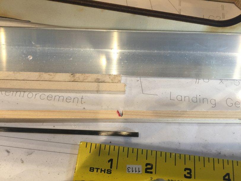

Spruce just made it here!! Looks good. Just a picture so you can see the length of each stringer. (8 feet each).

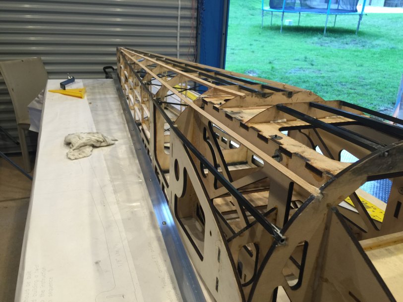

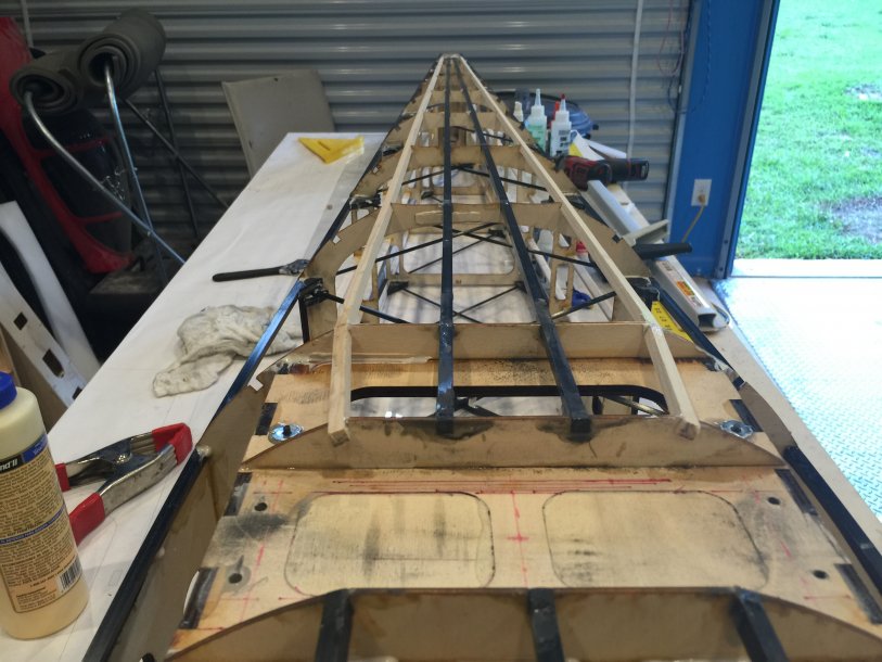

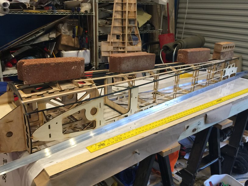

All the stringers are glued in (on the bottom of the fuselage). There is one more pair that needs to be glued on, which is in the front of the airframe and the top, to help make the front of it round. It is between F2 and F1.
I want to give a detailed idea about this build to others, and on this step, this will be discussed separately.
Now, after this cures, tomorrow, the next step will be to glue on that last stringer, then make the skins. Possibly on Wednesday, i will glue on the skins to the sides of the fuselage.

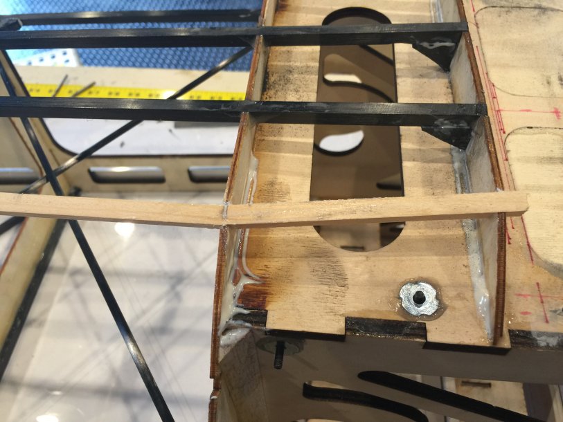

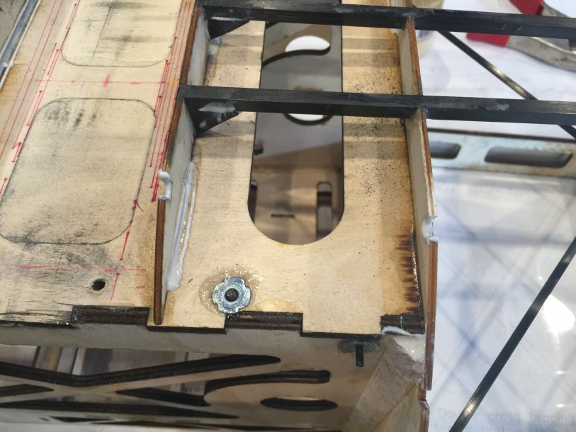

This is a minor point, but, if you look at LG2 and F2, where the stringers key in, is not in line.
In order to overcome this, I did not want to glue in two separate pieces. What I did, is something we do in orthopaedic surgery, in order to correct deformities of long bones, which is a closing wedge osteotomy or an opening wedge osteotomy.
In this case, i did a closing wedge. Meaning, i removed a small piece of wood, and bent the stringer, sort of like a greenstick, and then glued it in.
Capt.Roll
Cam, the opening/closing wedge cut is a cool tip and I can see where that can come in very handy at times.
LOL.........my thought process would have been........"wow, the stringer notches in F2 are not cut in the right place." Then I would have cut new notches that lined up to keep the stringers straight.
This area will be sheeted and that short segment is helping to shape the bottom. If it is moved in, it will create a different shape.
