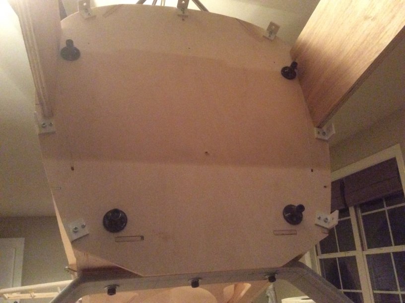

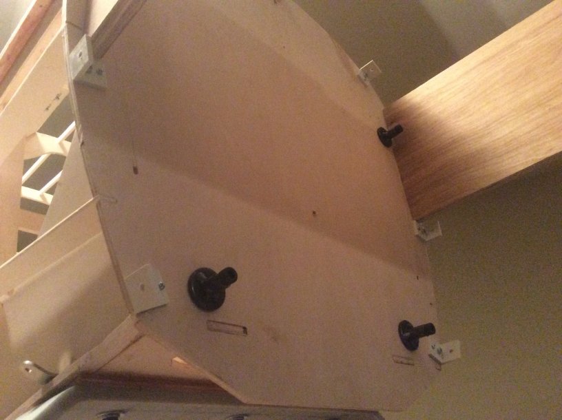

So this is fairly scale, and will be a complete module. Four bolts will pull the engine, exhaust, coke and throttle servos.

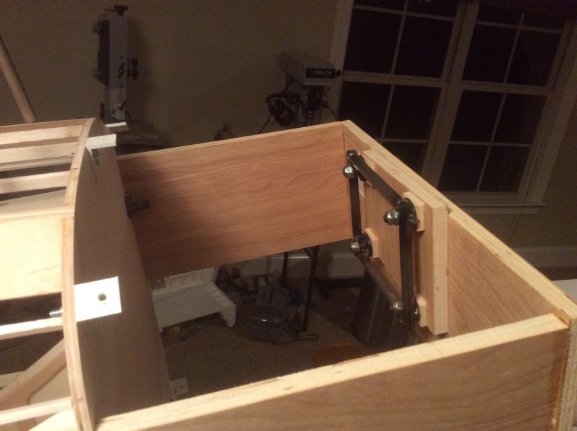

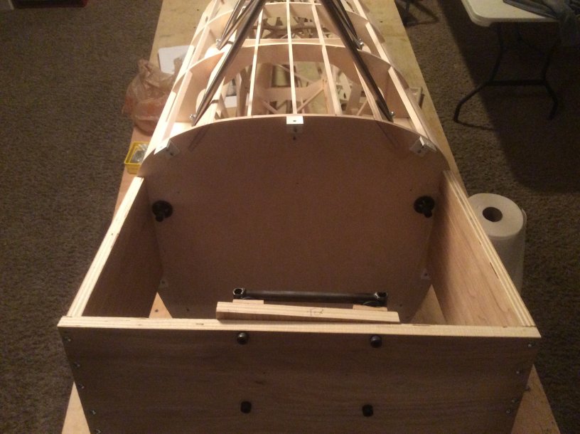

Very interesting mount! The ply boards had me confused but now I see they're just temporarily hiding the front tubes in place, correct?
MattyMatt
Exactly.
I used the original motorbox that came with the Kit to set the angles correctly. Then built the ply jig around it to set the angles for the tube steel motor mount. I pulled the motor box and now bolted the firewall mounts and the tube mount for the engine. Next, I'll cut and weld the tubes from the firewall mounts to the back of the motor mount.
