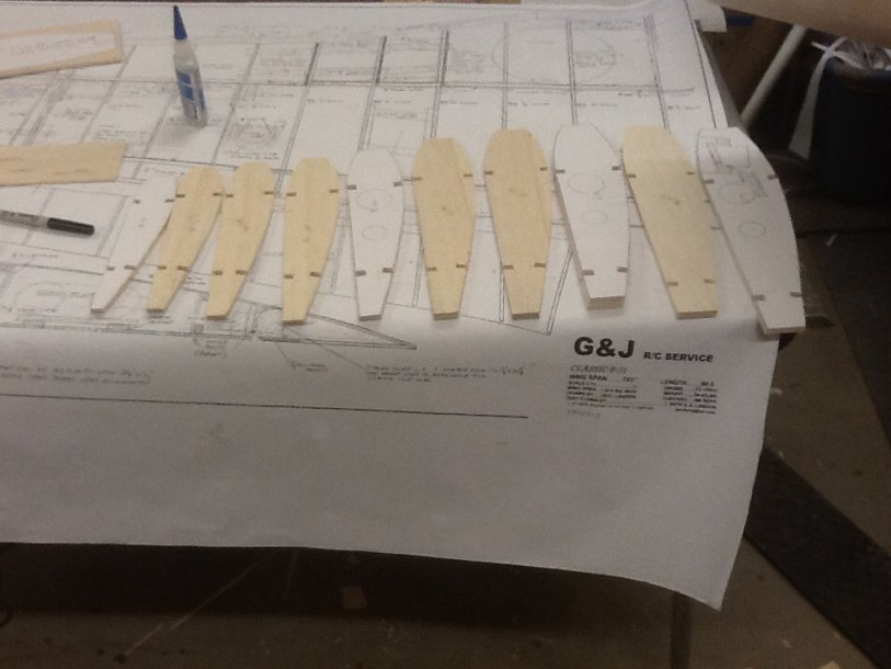

22 ribs cut! I'm tired! So much for being faster than cutting the paper templates. But, they have to be right and the left side has to match the right. So, you put 2 pieces of 1/8th sheet together and cut and sand them 2 at a time. image.jpg

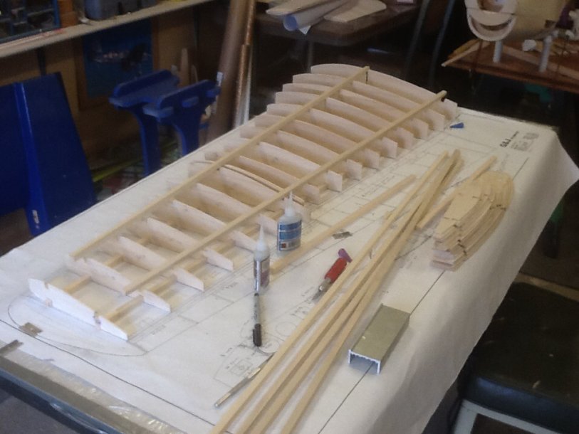

I recut all the notches for the spars so that I could use 1/2x3/8ths hardwood spars. I cut the spars from pieces
of 1/2 x 6 x 48 poplar using my table saw. That was the only size of 1/2" wood in the entire Home Depot. But, it turned out ok. I just laid the top spars down to get an idea of how much "tweaking" I'm going to have to do to make them fit. Looks like about an hour each should make everything line up just right. Before I can glue any of the ribs in place, W8 through W12 have to be drilled for the wing tube for the three piece wing.
