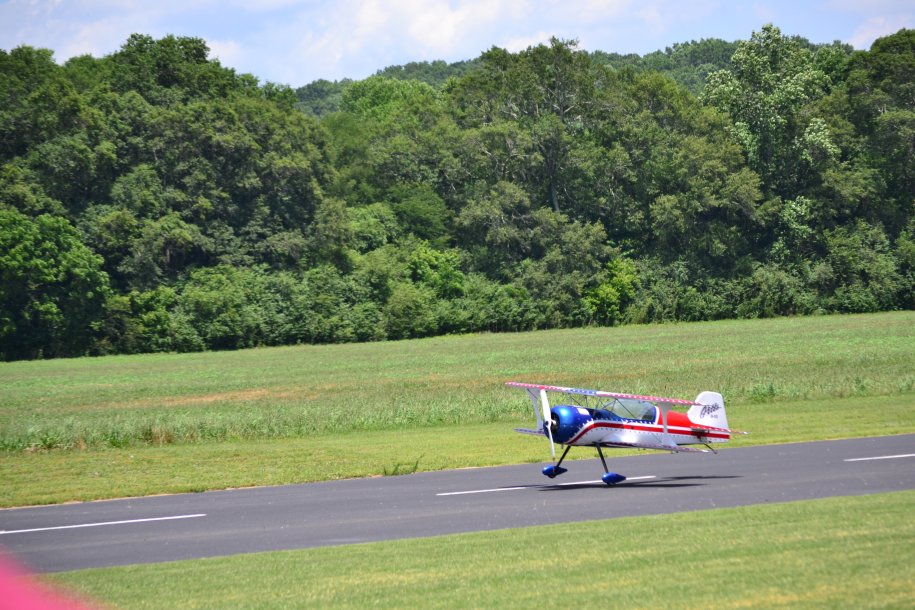

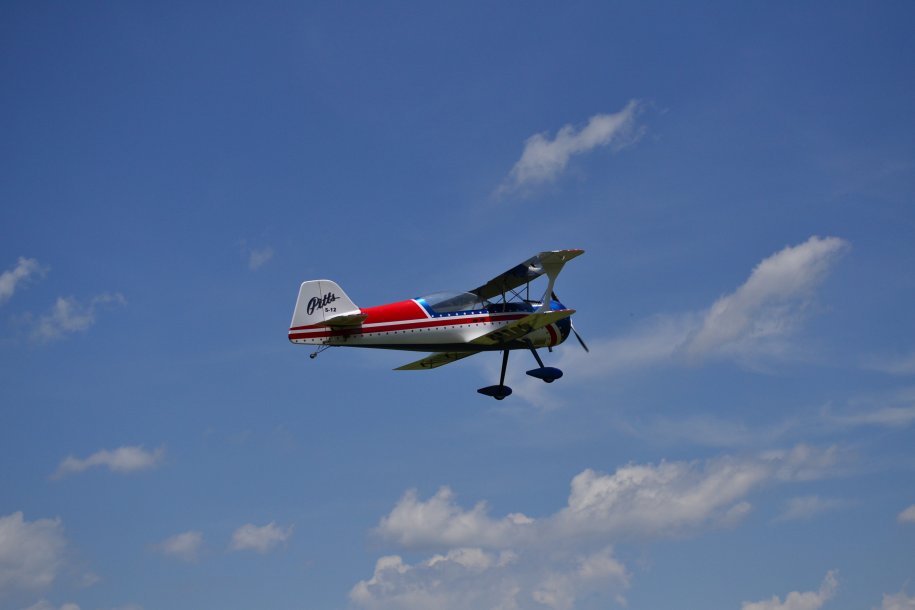

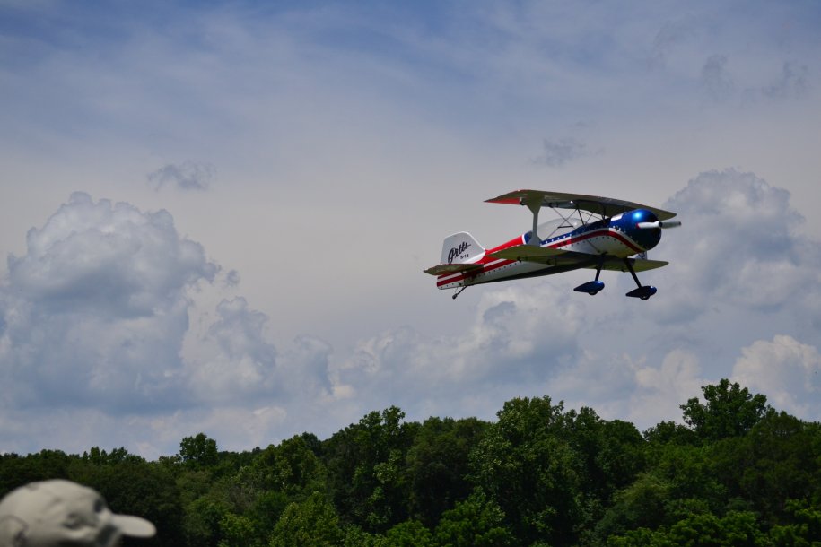

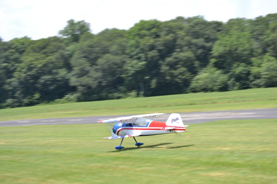

Here's a few of my other CARF... I think this was from when I maidened a few months ago... up and down in 1 piece!
