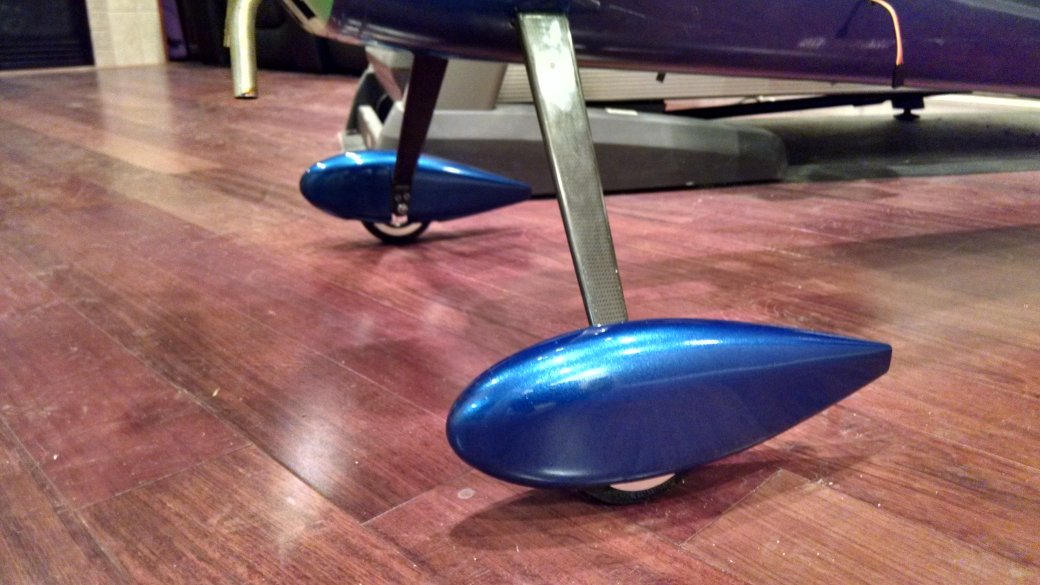

I had a landing on a windy day a few weeks ago that left a little to be desired.. and it also left one of my wheel pants shredded. I decided that I had nothing to lose, so I'd try to repair it. I didn't take any "before" shots, but you've seen them before... split down the middle on the seam, and up the inside side of the pant, right behind the landing gear. Basically, the left pant was in 3 pieces.
So... a little Hysol to hold things together, then some West Systems Epoxy and glass to give it some support, then a lot of sanding, priming, more sanding, paint, scuffing and then a few coats of clear.
When I was done, the repaired pant looked pretty good, but it was a few shades lighter than the other pant.. so I sanded and painted, then cleared the right hand side.
After a little cure time in the wife's oven, it was back to the basement for some buffing.
Here's a picture of the finished product. They are a lot closer to the color of the plane than they look under this light. I've thought about shooting clear on the plane also, but it would be a nightmare to buff out all the orange peel properly on the flexible fuse sides, and it's heavy. I may do it anyway, we'll see.

Nice Mike! :) Killer job, dude!
The inside of the pant was the most damaged, but it turned out pretty well too. I wish CARF would take the time to clear these planes before they ship them, it REALLY makes a difference in the finish. I did the wheel pant painting with an airbrush... not the best tool for the job, but I didn't want to clean out my spray gun so many times for such a small job. The paint goes on a lot drier with the airbrush, and especially with metallic finishes, you want it to flow a little wetter. On the positive side, it's almost impossible to get a run, even in the clear coat. Not so with the big gun, but it will lay down the clear very quickly.
There's no wax on these pants yet.. when I do that, they will really pop.
