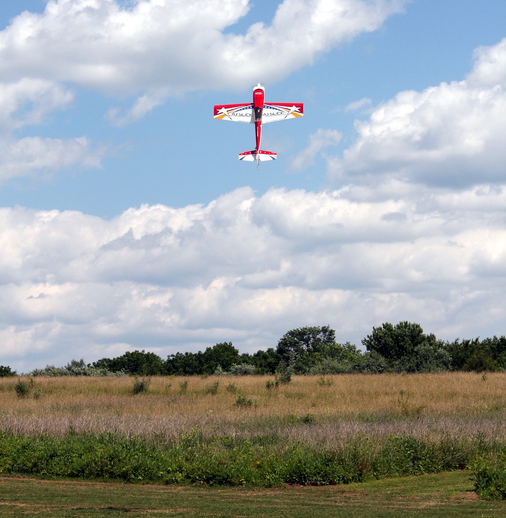

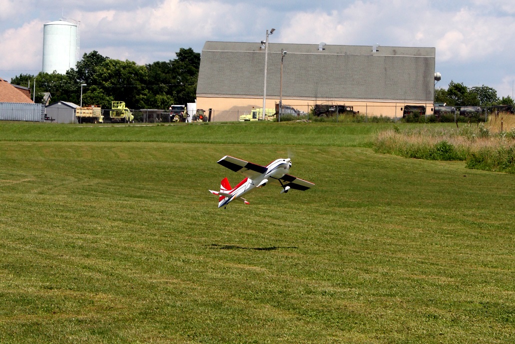

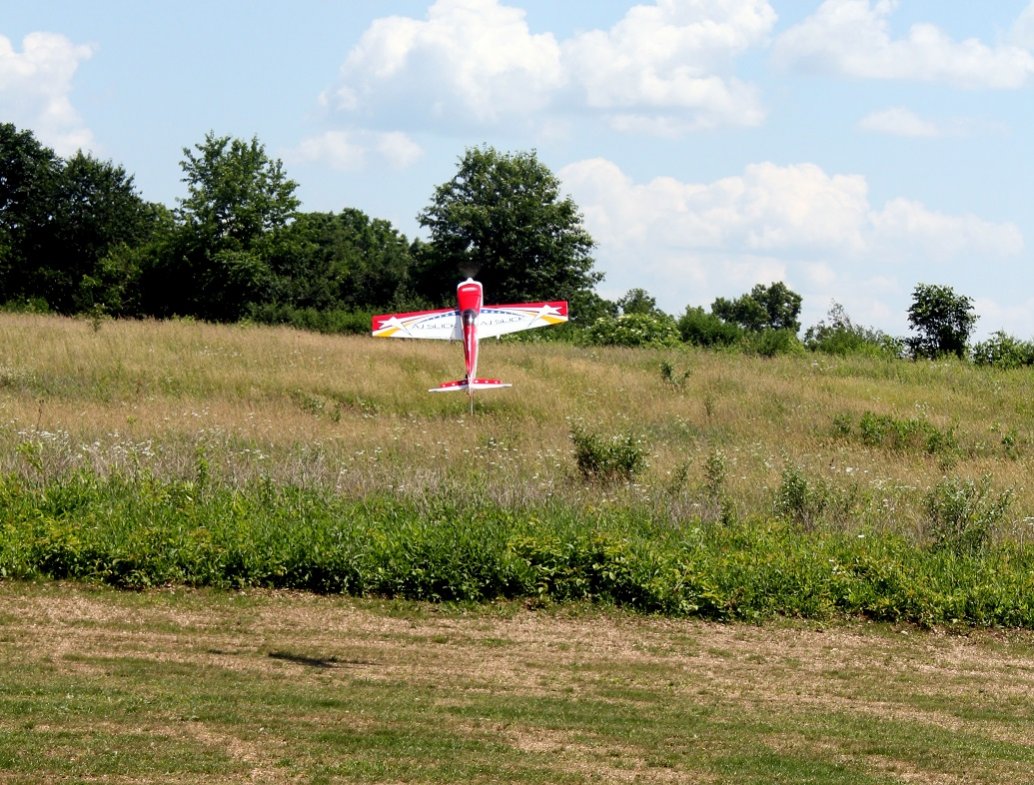

Back from the maiden. This is from my third flight (thanks for snapping the pics, Josh). What's my prognosis?
