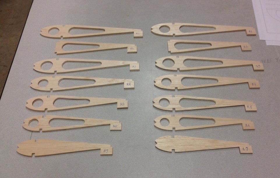

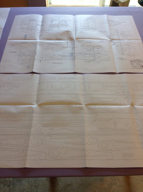

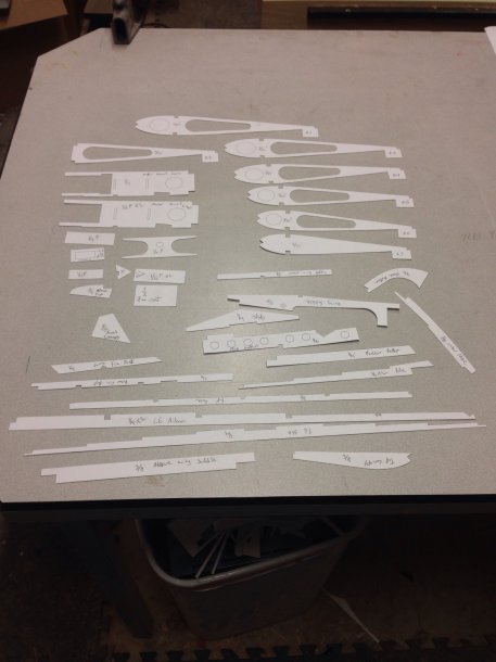

So the past few mornings when getting home from work I have started working on my next scratch build. Yes it's another profile and I will be building two. One for me and one for a buddy. To start with I use spray adhesive to stick all the cut part templates to a piece of poster board from the dollar tree and then cut out the templates. This makes it easy to cut parts again in the event of a crash or what have you and be in need of new parts. I always start with the wing ribs and here they are. Enough ribs cut to build two sets of wings.

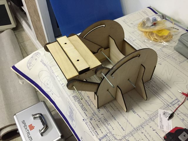

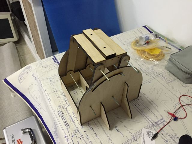

Just playing with an idea here... I want a stand in the trailer that will keep the wheels of my planes up off the trailer floor. Gets hot here in the summer and don't want the wheels loaded and bearing on the trailer floor for extended periods.... so, playing with a stand of sorts that will lift and support the plane an inch or so up.... again, very preliminary... but, 1st cut with the laser...
Down position
Up and locked position

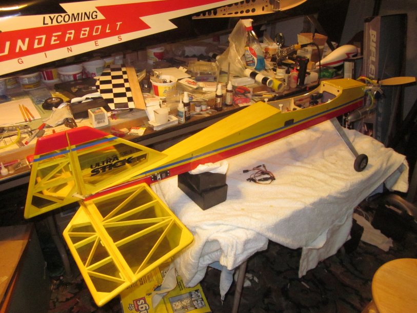

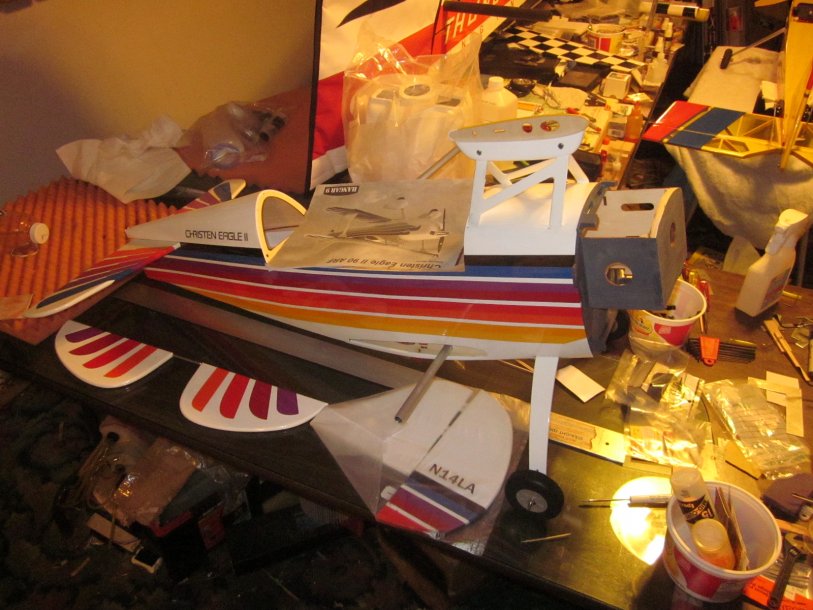

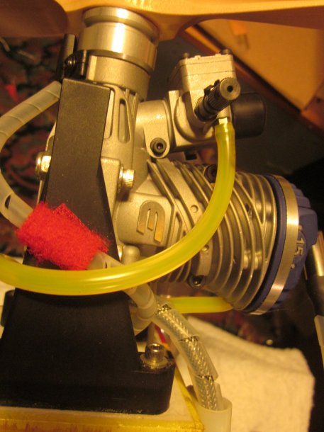

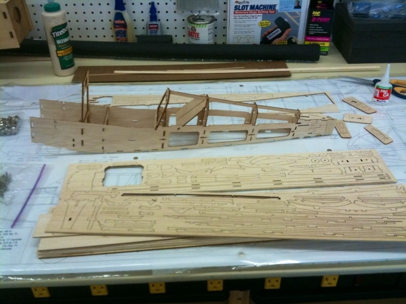

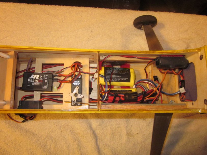

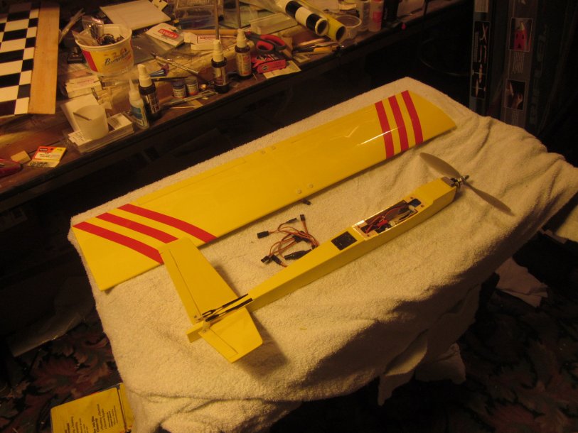

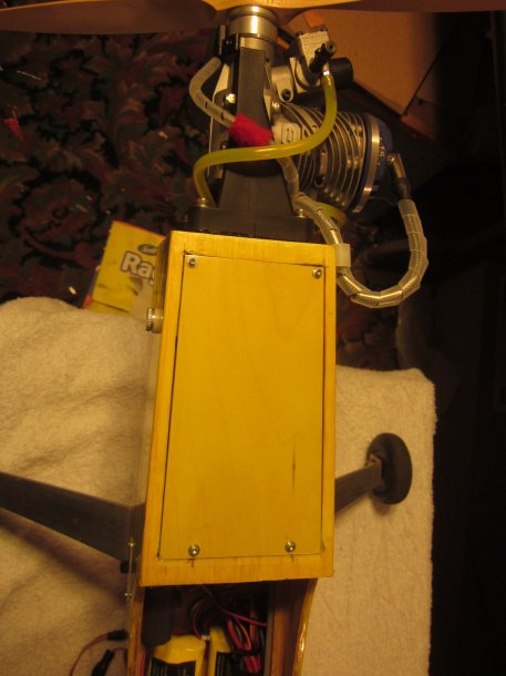

IMG_3818.JPG IMG_3820.JPG IMG_3821.JPG IMG_3824.JPG IMG_3825.JPG IMG_3826.JPG I have been busy. I converted an old Dominator 200 (Lanier) from glow, (Norvel .074) to Electric for a friend, and For another guy, I converted an Ugly stick from glow to gas. I removed the top front of the fuse and added a hatch for convenience, it is now Sporting an Evo 15 first edition. Now I am working on a Hangar 9 Christen Eagle II 90,which will be powered with a 20cc gas engine. In my spare time I work on my stuff

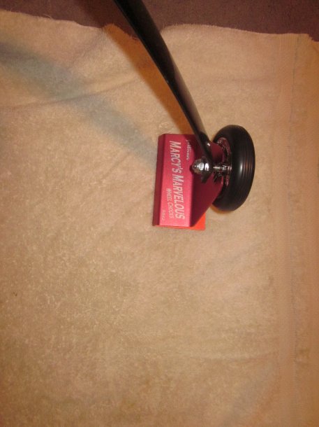

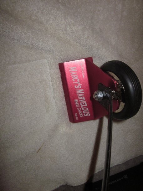

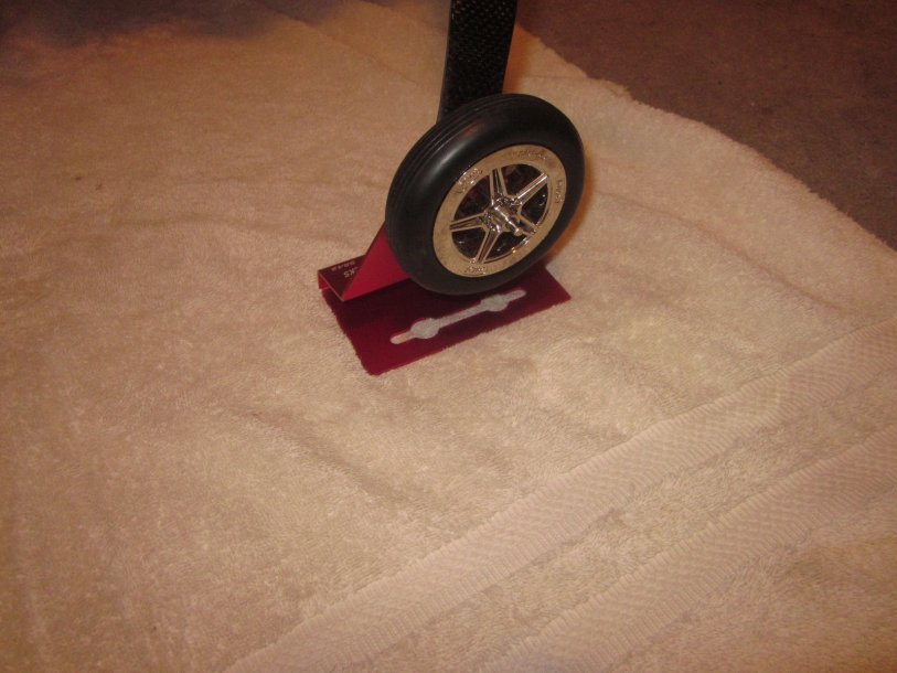

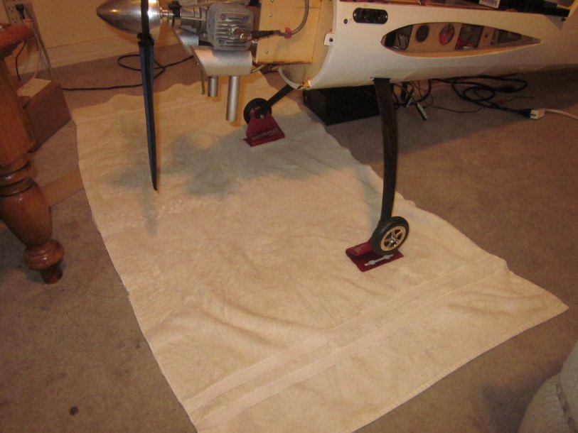

To keep the wheels off the floor in my trailer I just use a few sets of these Sulivan wheel chokes bolted in place where I need them. I also set a few planes on them in the house IMG_3827.JPG IMG_3828.JPG IMG_3829.JPG IMG_3830.JPG

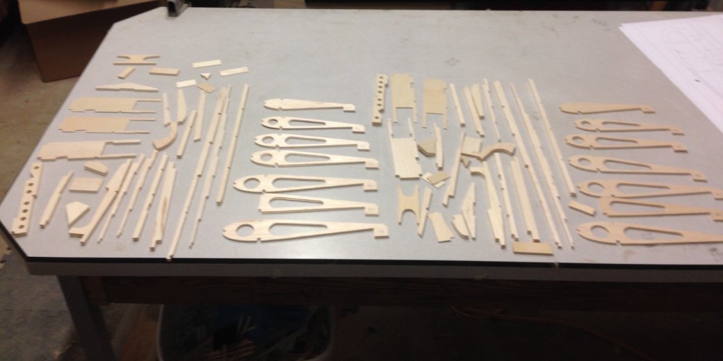

My scroll saw and I have been pretty intimate tonight. Two complete short kits for a pair of slabs I will be building. Glue starts flying tomorrow night.
