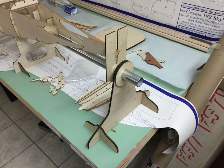

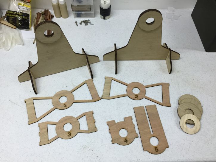

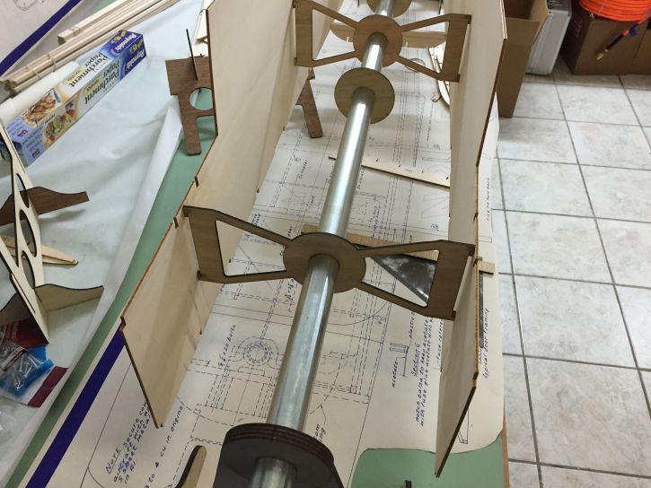

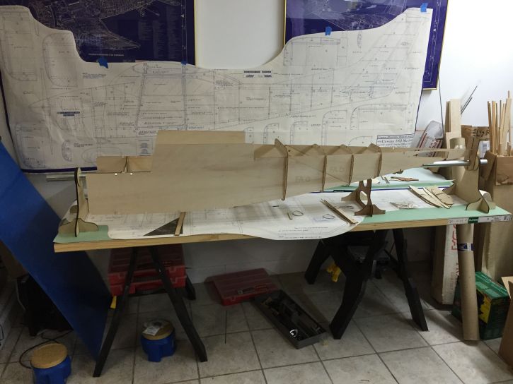

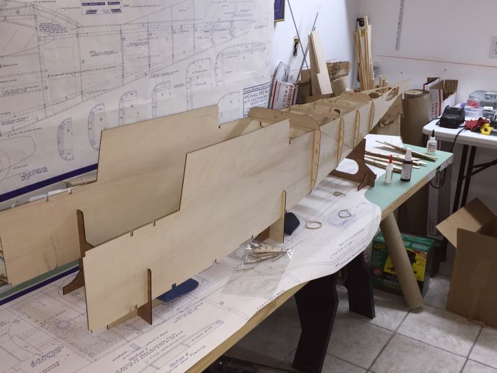

What if you square up and line up the formers on a sheet of plywood. Then glue them onto the plywood? That would hold the formers rock steady and fully aligned while building the fuse.Started work on the Hostetler Cessna 182.... The laser cut kit came with these plywood formers... they are nice for getting started, but I am finding them difficult to work with for maintaining alignment. Going to have to take a step back and figure out a way to keep this fuse straight.
View attachment 19012 View attachment 19013
