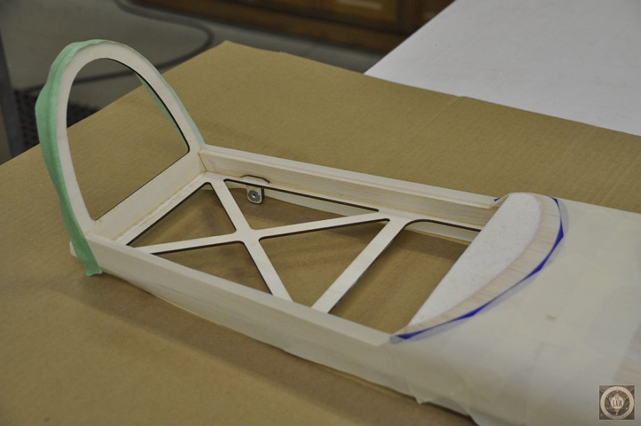

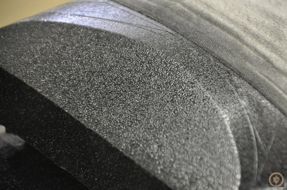

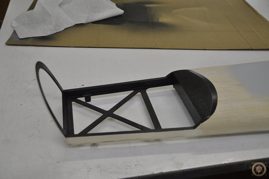

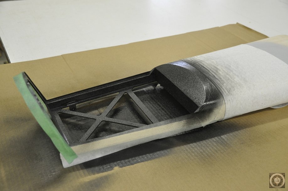

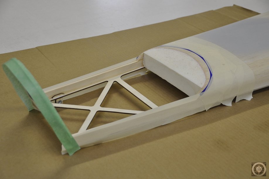

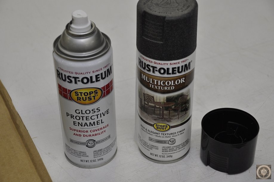

I took a few minutes this AM to finish the inside of the canopy. I tried a few different textured paints and like this one. It's two steps but you don't even need to let the first coat dry before applying the second. Also the amount of material applied does not even tip the scale on adding weight so it's perfect!!

tylerzx9r
Did you have any trouble with that soaking into the wood as it dried? When I did my PAU it seemed to soak into the wood, so I soaked it down a little with CA, it seemed to help. I thought I may try the hairspray trick next time.
