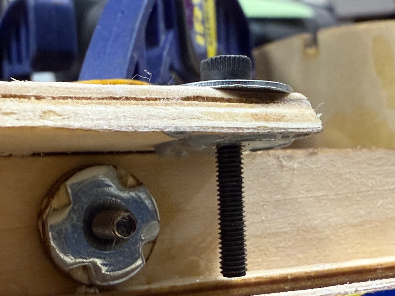

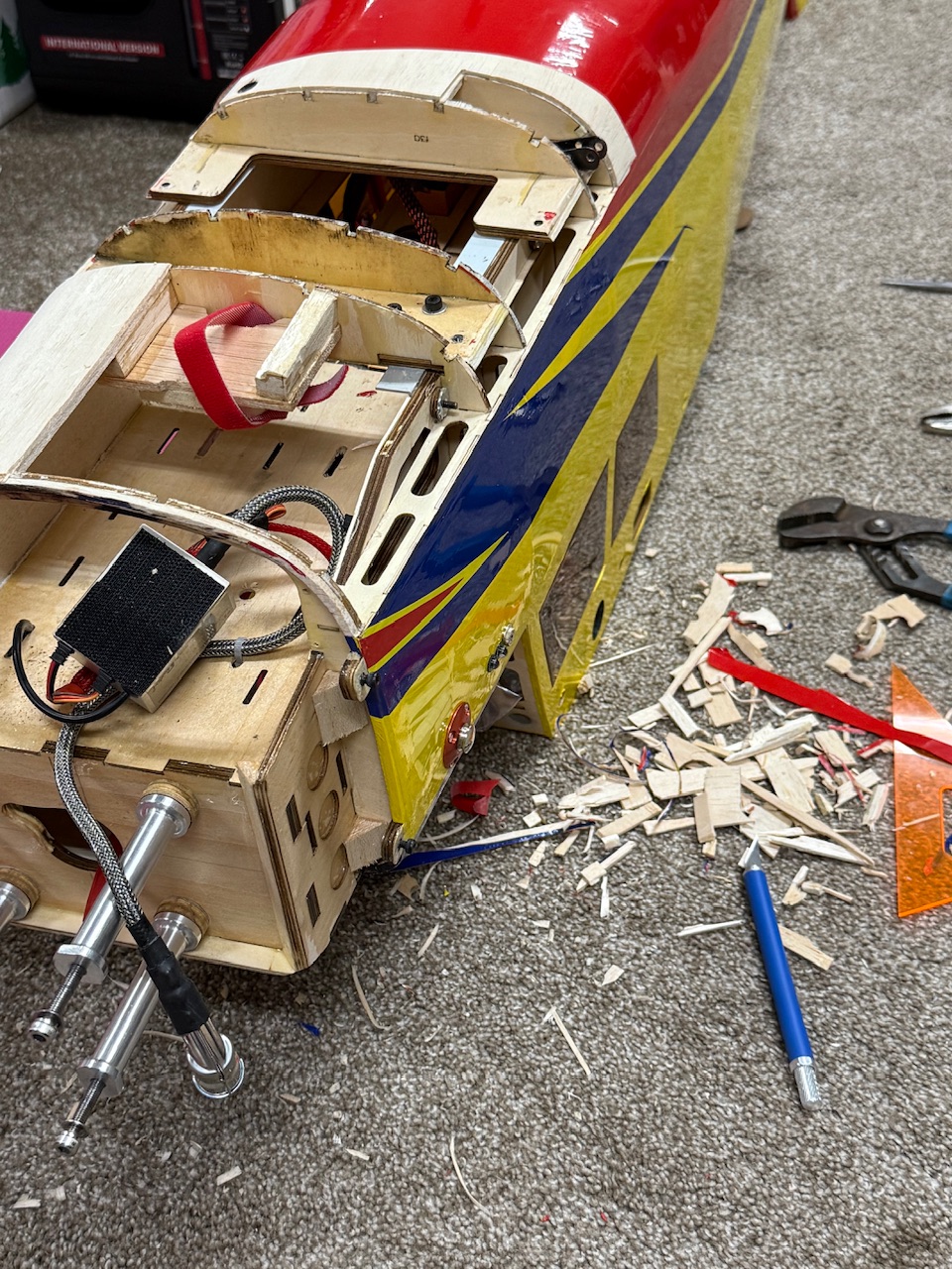

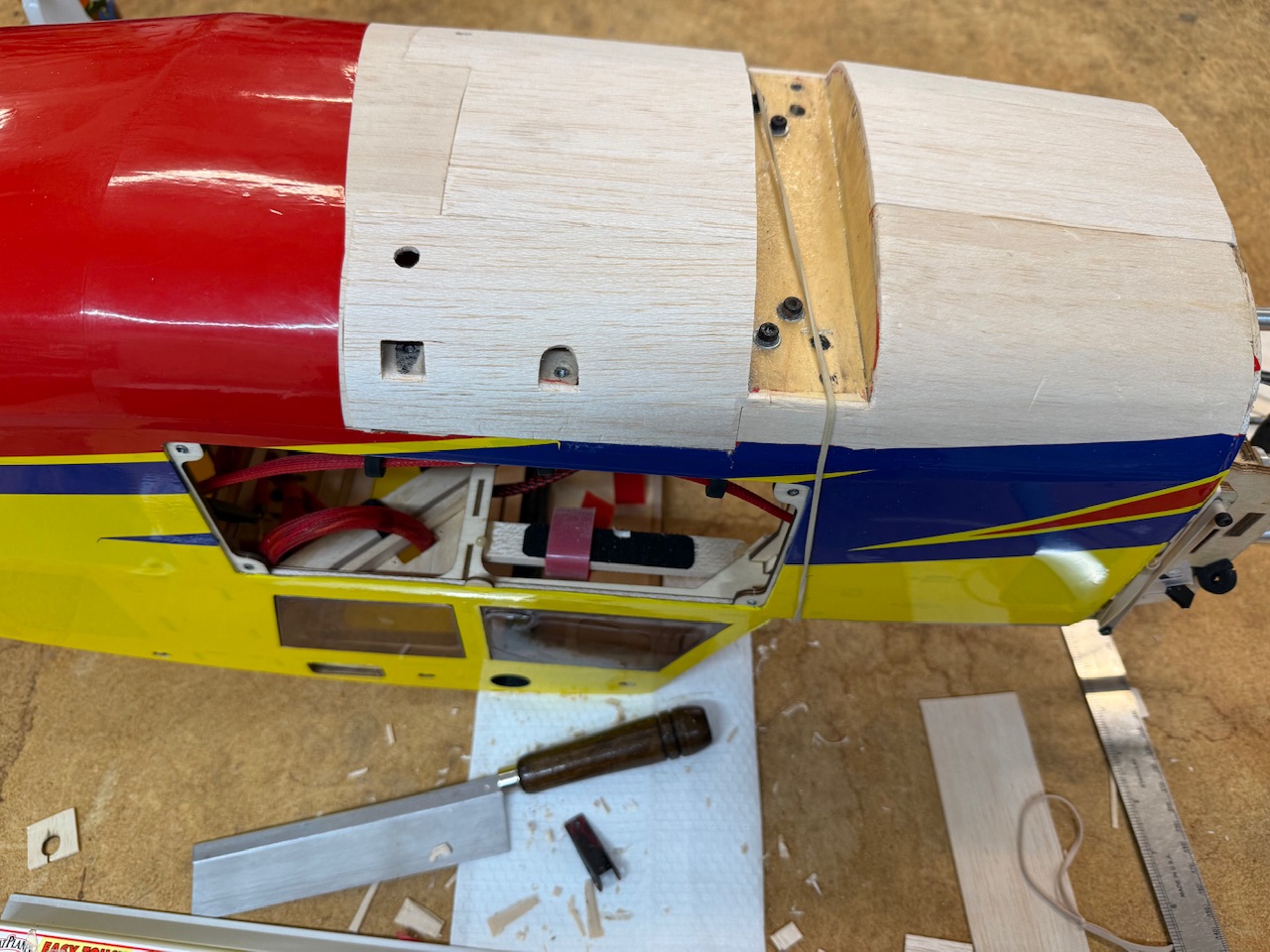

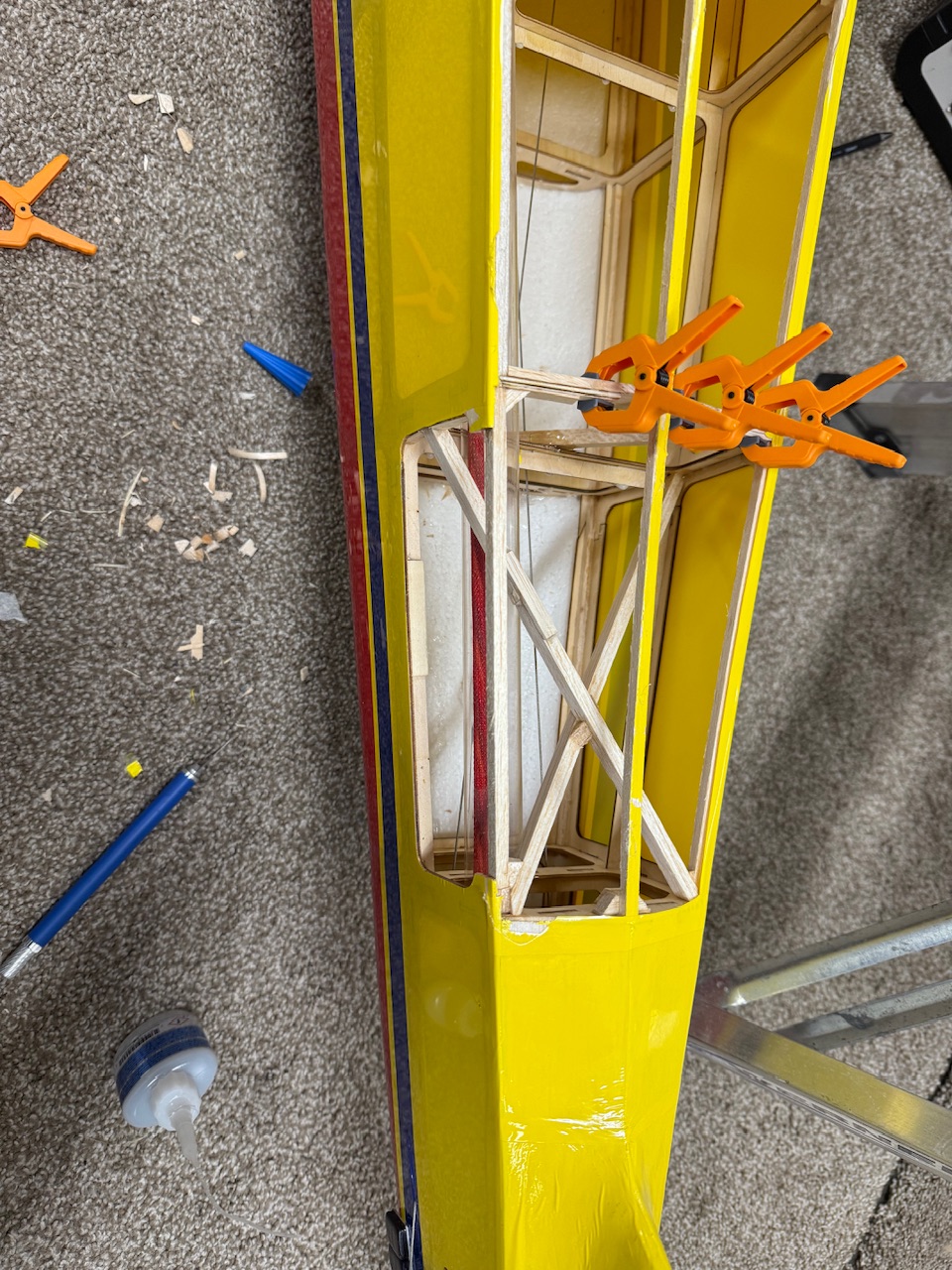

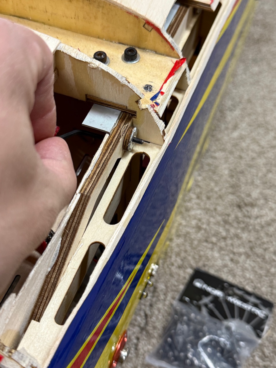

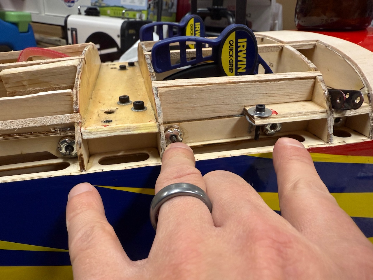

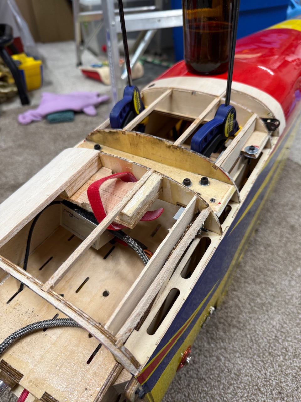

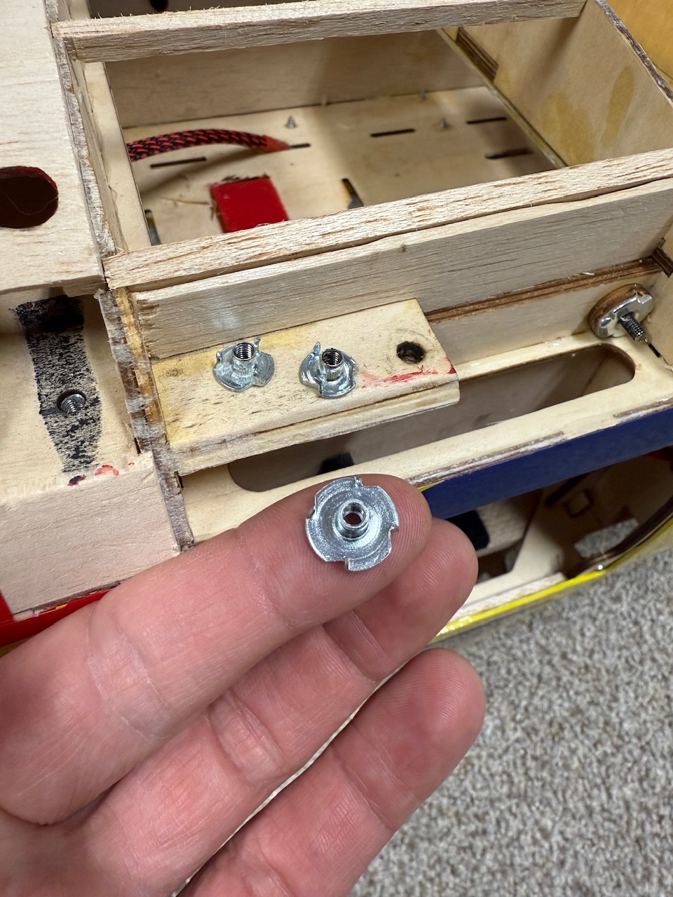

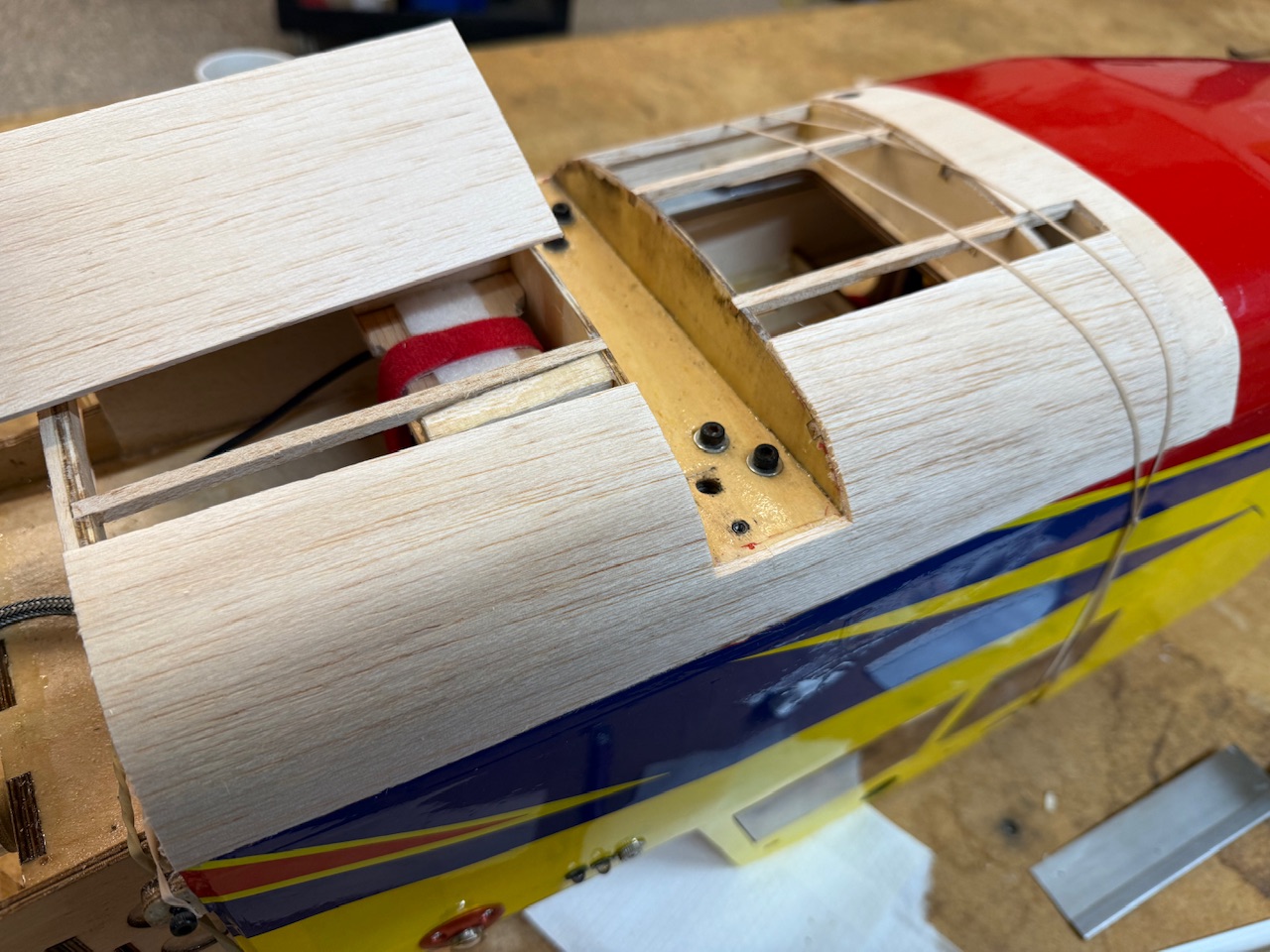

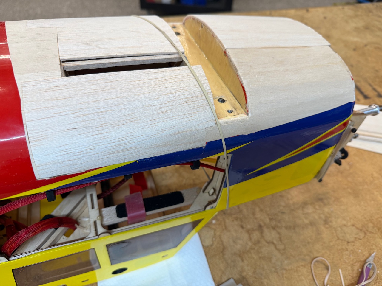

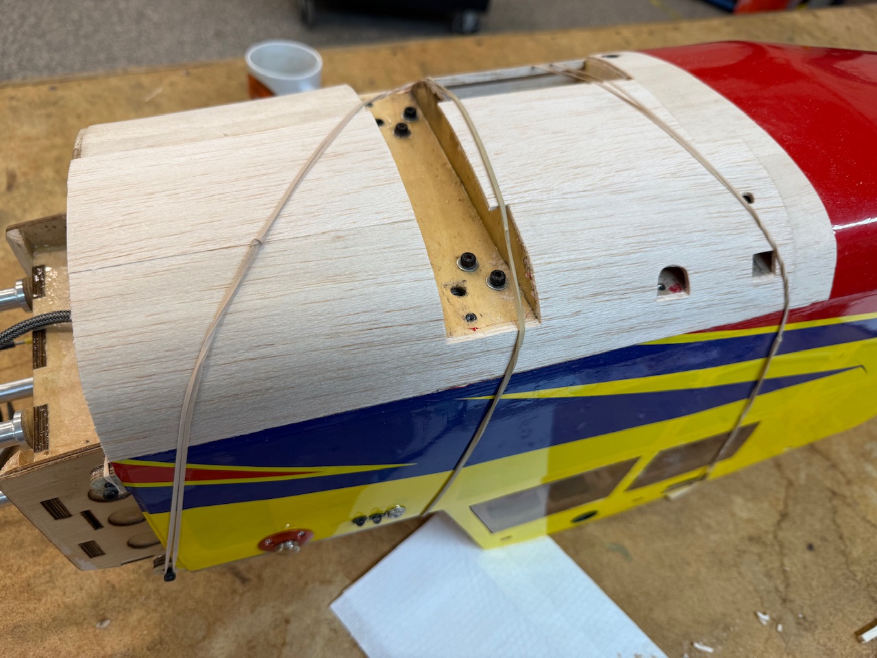

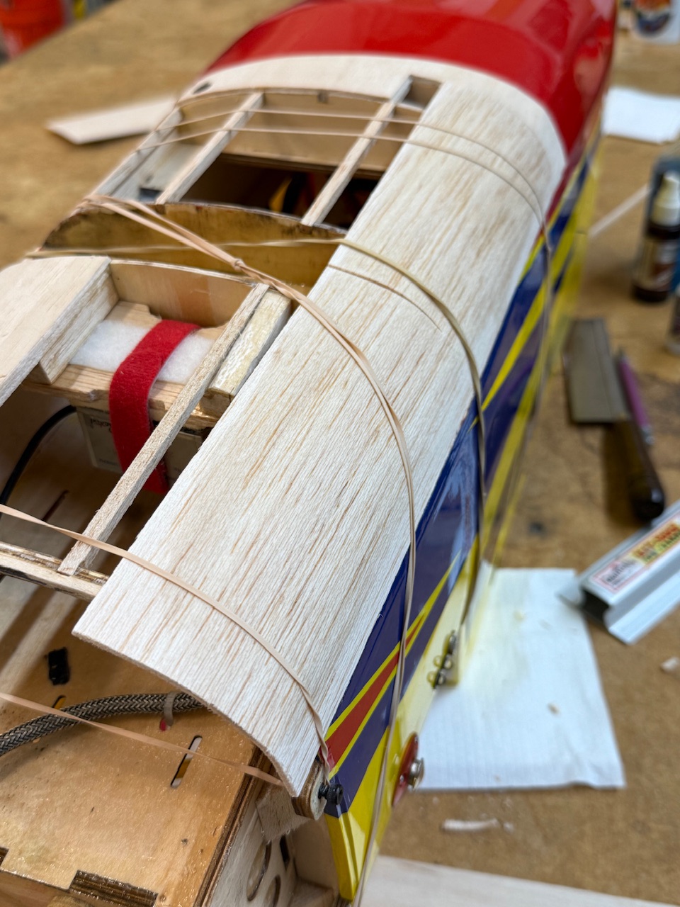

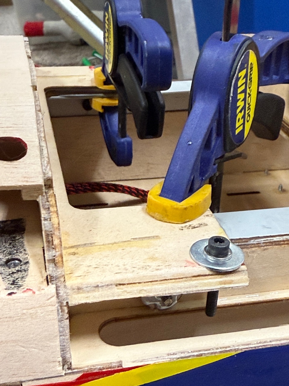

Been staring at my poor timber… decided to take it down and start poking away at it. Found out that I was missing over half the 3mm bolts holding my landing gear aluminum support block in! That’s nuts. I think because it was loose is why it got so damaged from my soft tree landing.
Overall it’s not that bad, just going to take some time.
