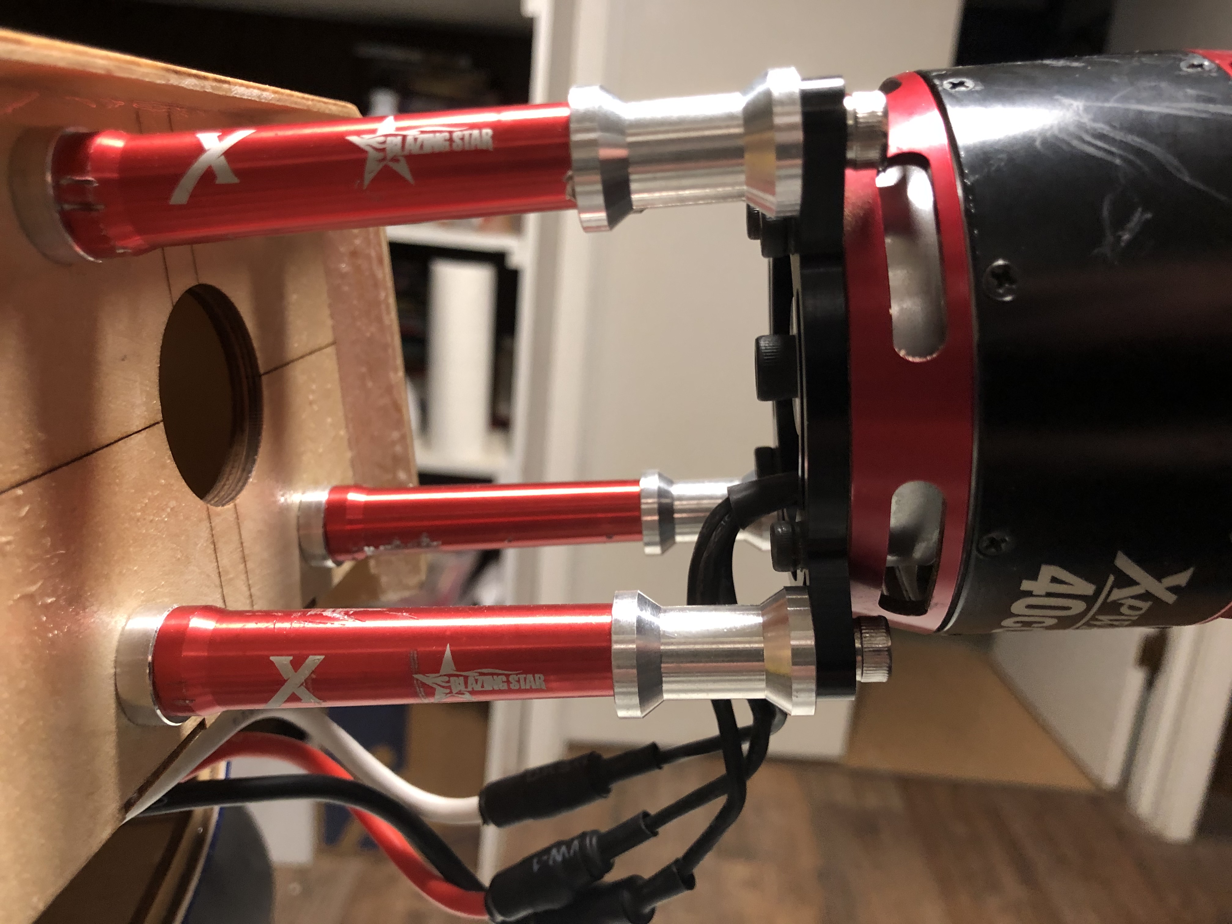

@Snoopy1 Hey man, with the Xpwr 40CC did you have to do major changes to the motor box/firewall to get that motor to fit? It's weird cause there are the bolts sticking out of the back of the motor that hold the mount on which won't allow it to sit right up against the motor box. Just wondering what you did with this thing...? Would you be willing to post some pics of your motor mounted and how it is attached? Thanks!
#185 look at that one it shows the motor box I built for the motor, throughout the motor box that came with the kit. Could not get it to fit the motor properly. If my memory serves me right from page 15 on I make some reference about the motor box. If you have any further questions please ask.
Thanks for the advice guys. A dude over on RCGroups posted about mounting his Xpwr 40CC motor using the Blazing Star stand-offs like the picture here. I am going to go that route as it seems the easiest and he says it fits perfectly. Thanks!
Please do not be offended, just my concerns. I am sure it is the easiest way of doing it but not as rigid as it should be. Four long posts like that can twist without cross bracing, and does not take much for it to twist. I could be wrong.
gotcha! no offense at all. I am trying to find out more info from the guy who did it and how it is working out for him. Here is the thread I have been on where he suggested doing it that way: https://www.rcgroups.com/forums/sho...ber-110-30-50cc-ARF-Review/page3#post44663239
