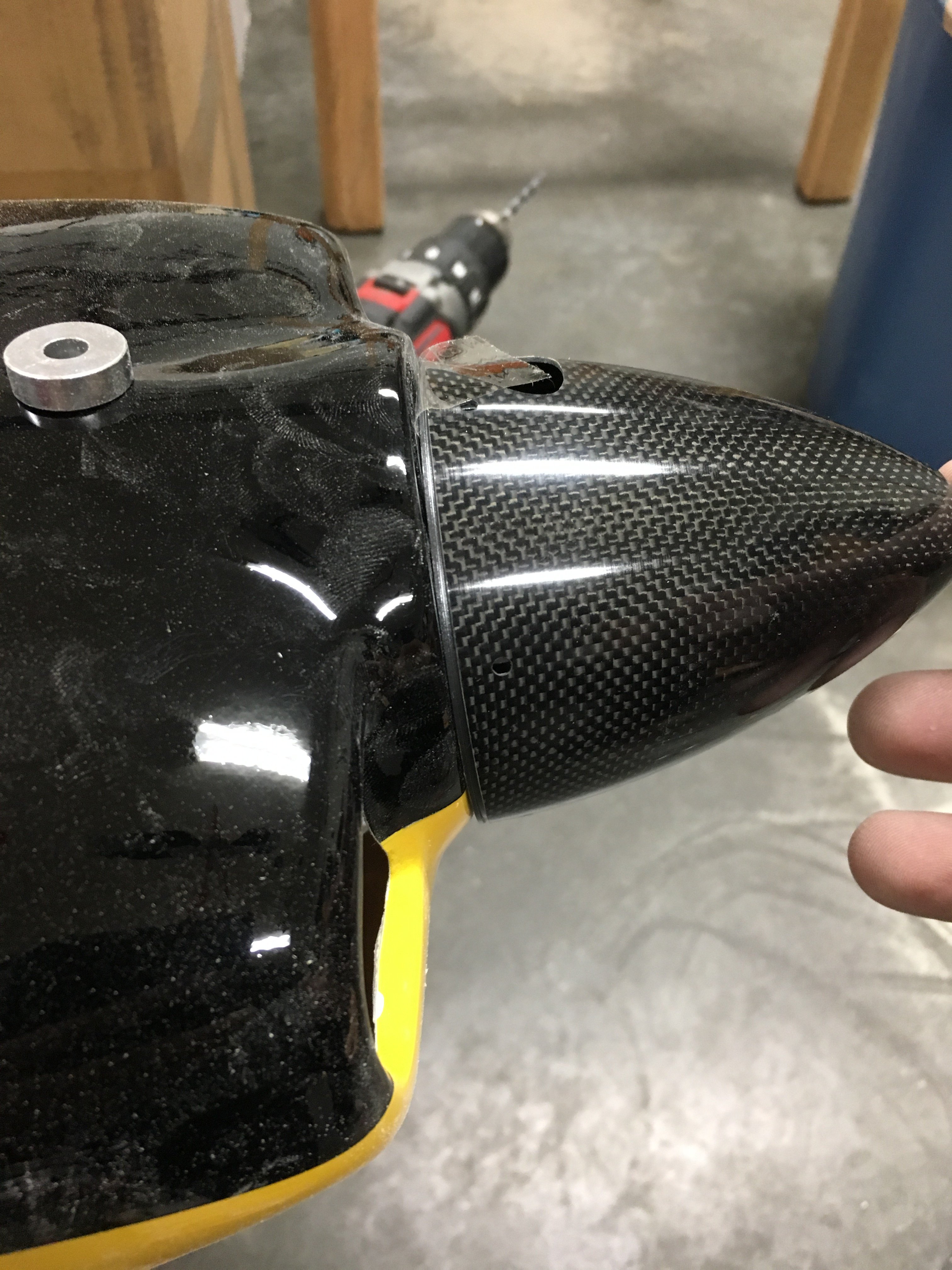

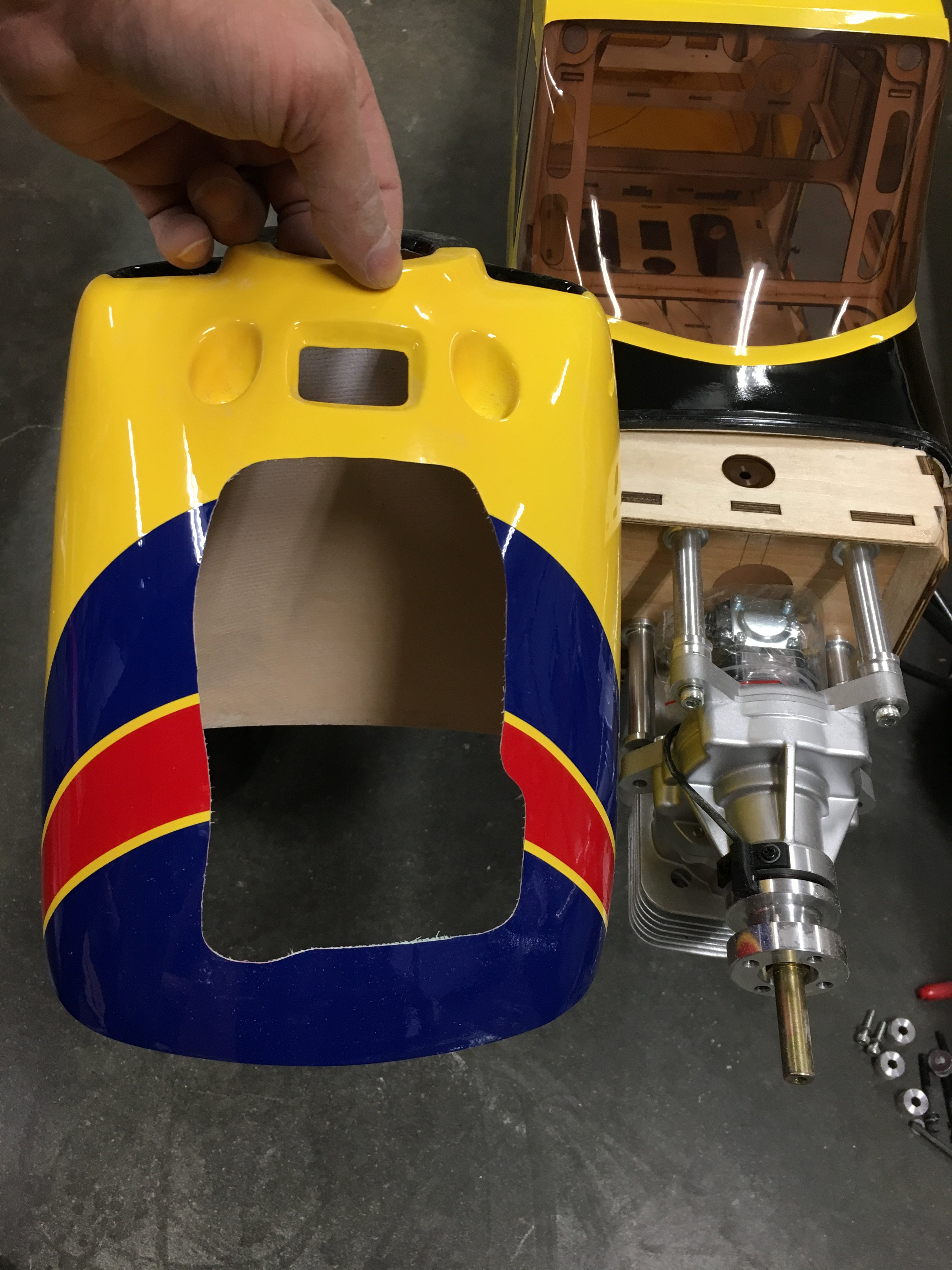

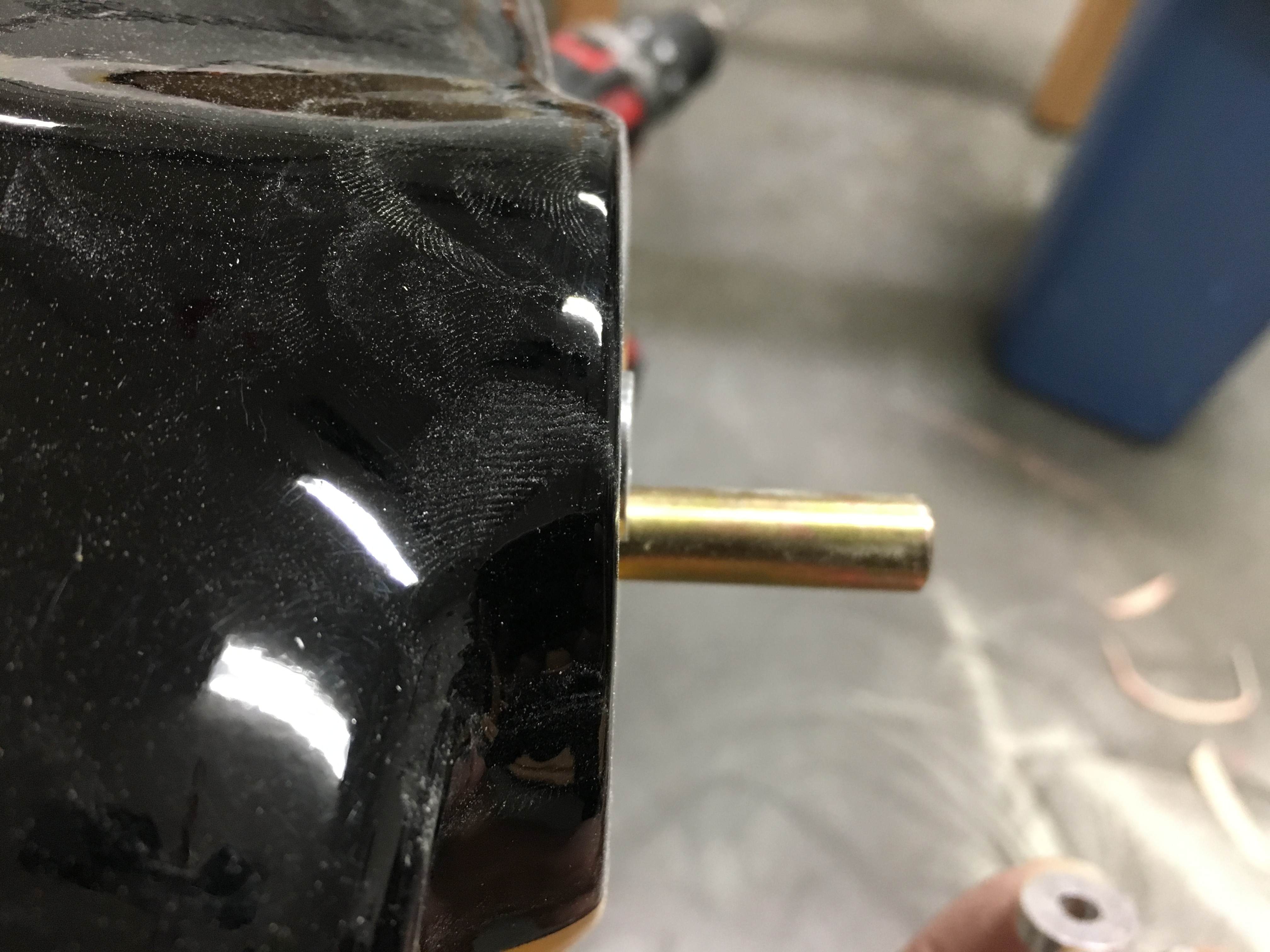

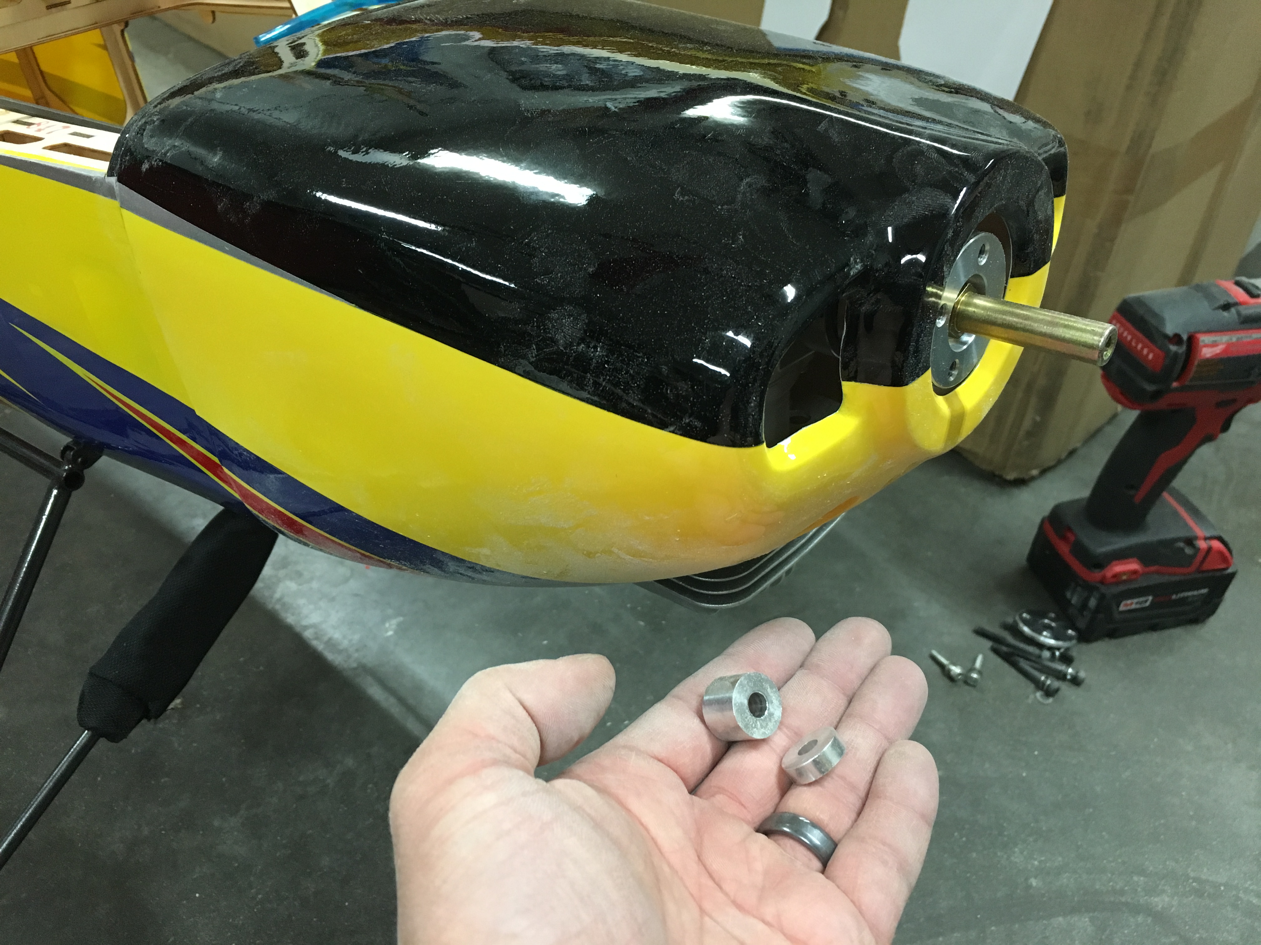

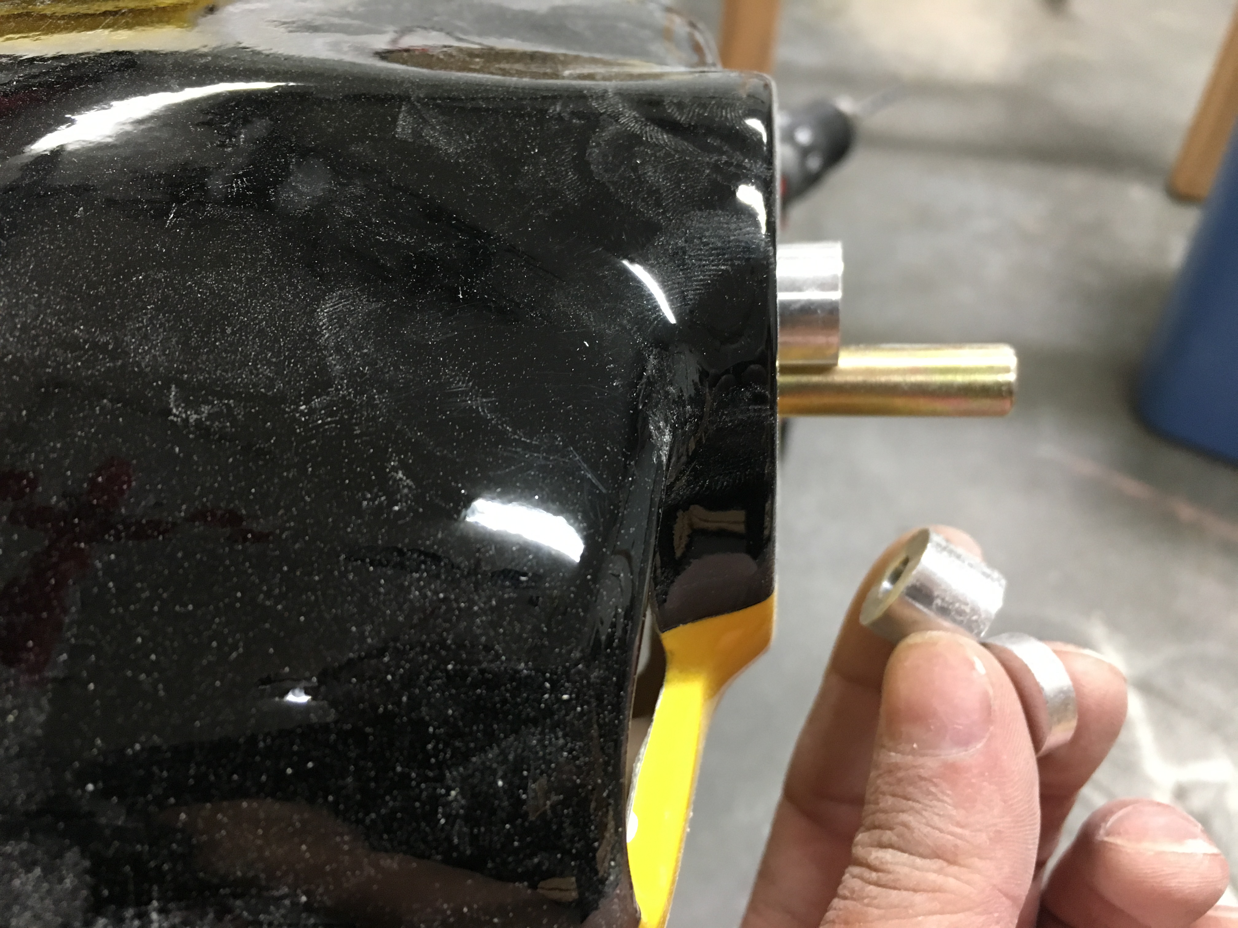

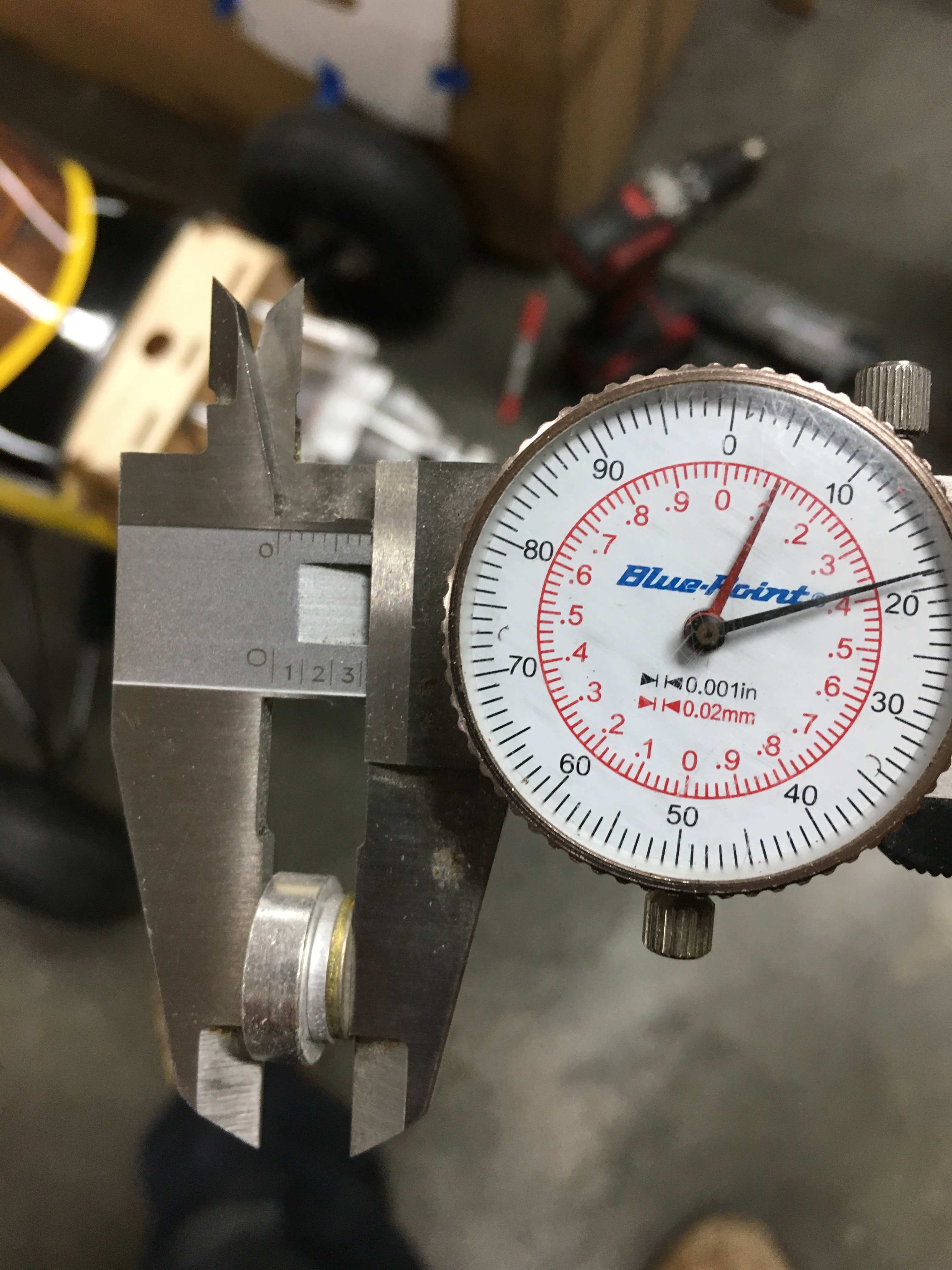

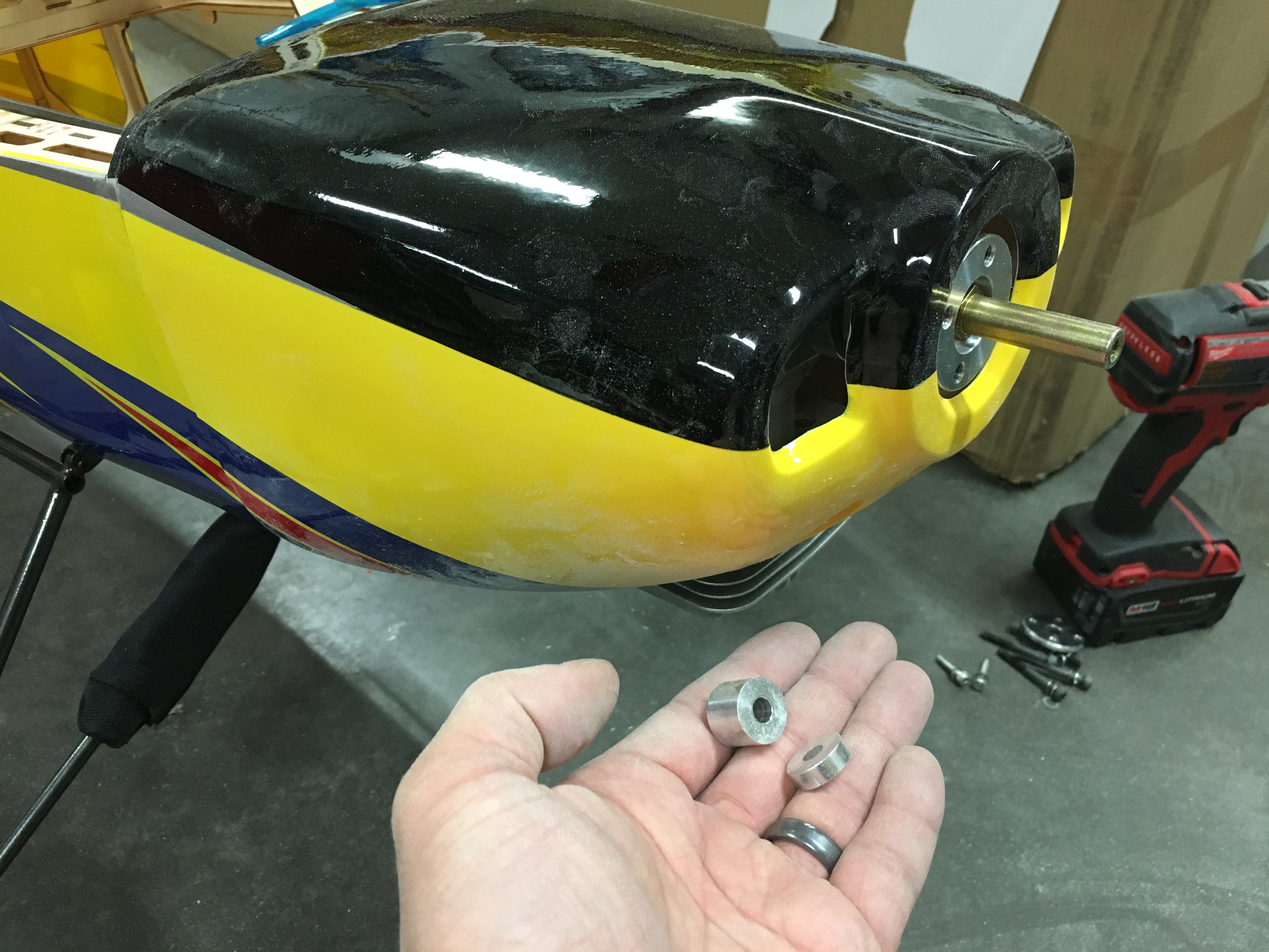

I needed to make some longer spacers for my DLE55. Will post pics later.
