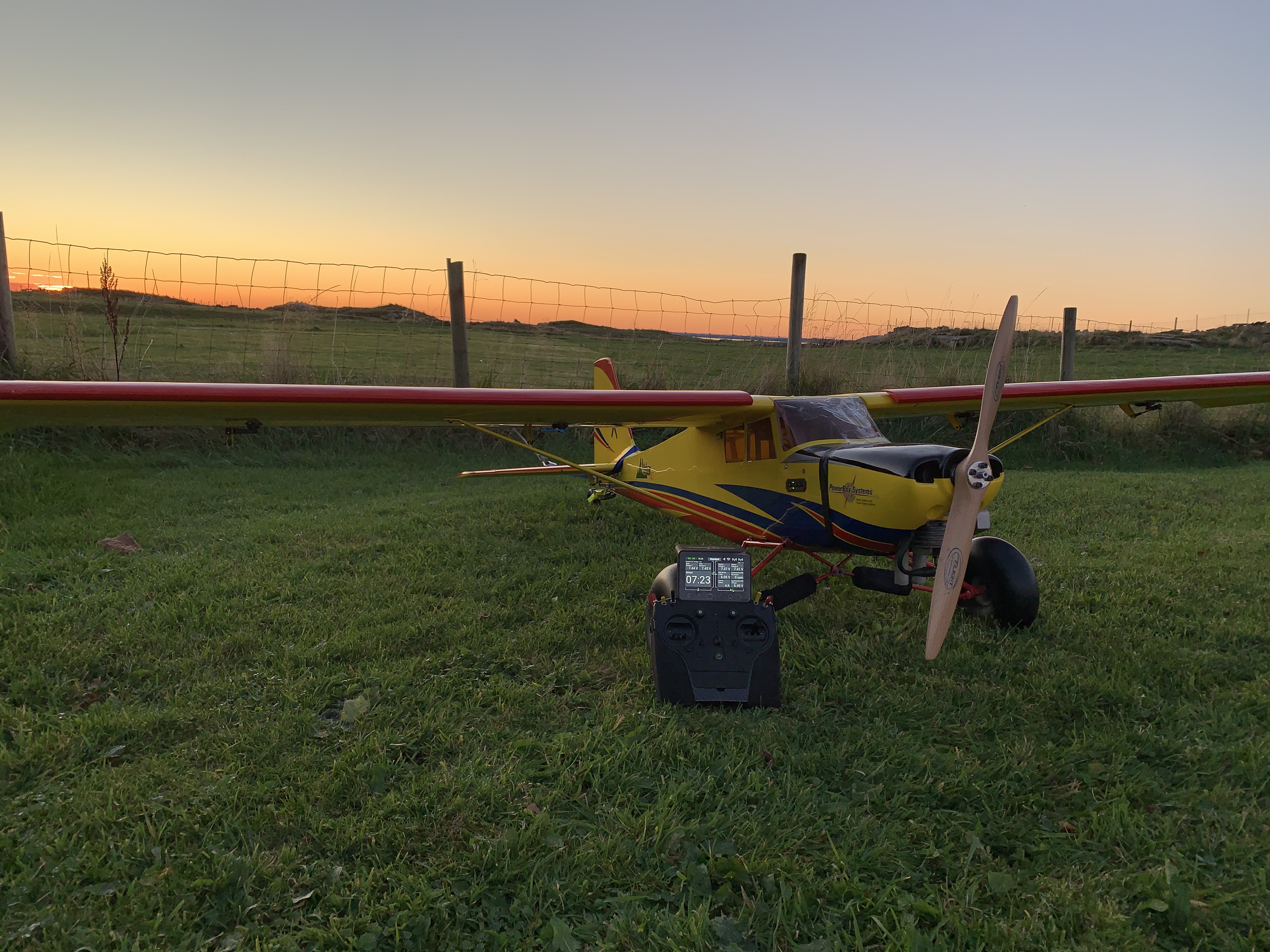

As to the DLE55.. I got a RCGF56cc in the T-110 and have not had any significant issues. Its nice to have the extra power when you load it up with the XCub main and the Airtops.. Just check the frame regularly for cracks.. It do get shaken about from the engine vibrations and H9 isn't always to generous about the glue... (I did add epoxy to the joints in the forward section of the frame though, that may have helped me from getting any issues....)
As to servos, I use the Hitec HS-5685MH they are on the budget side of the scale I'd say and works fine. Note that they are to wide to fit inside the stab. Cant recall what servo I used there....

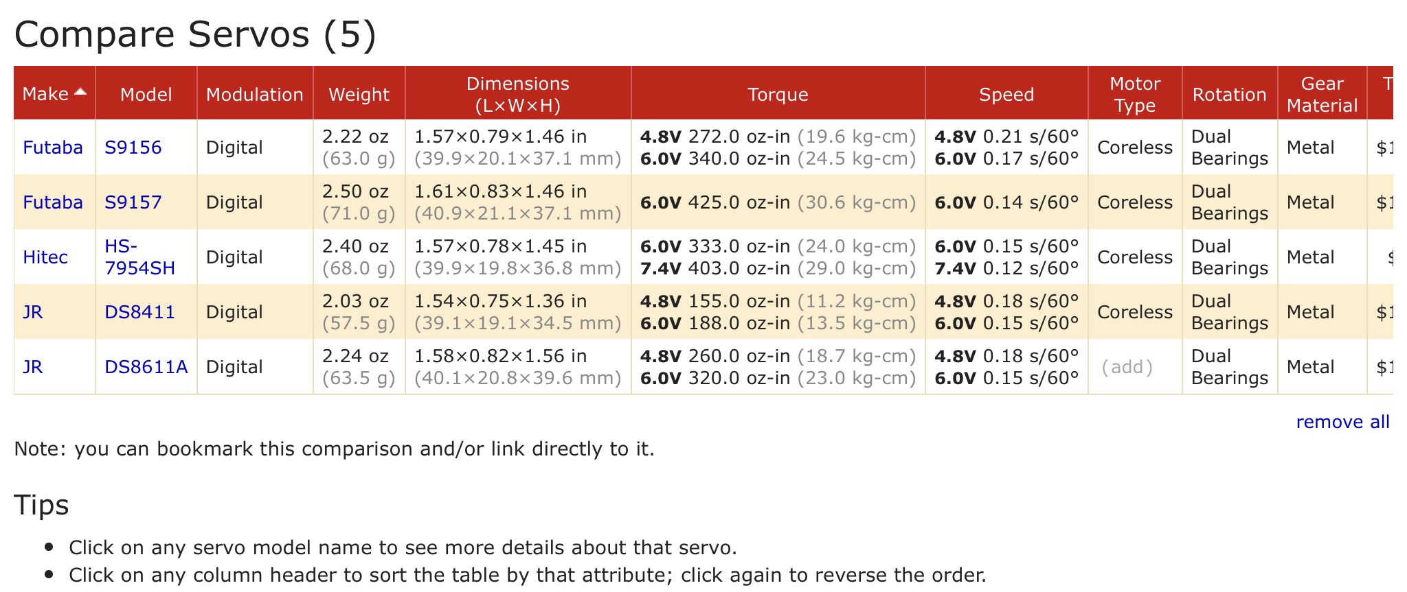

Thanks man I appreciate that! What is considered (High Torque)? I have a set of Spektrum A6380s "in the box" they spec at 160 oz/in of torque. These are the servos they call for in the book. They are "High volt (8.4) High Torque (160 oz/in @ 8.4) and metal gear". Do you think that would be enough torque?

AKNIck has a very good point vs the Hitec HS5 series, but as I said, they work fine with my type of flying (Lazy sunday flying and STOL - I dont do any major acro or 3D with it..) I do not know the Spectrum world, but from what I see on the spec if you push 8,4V you get about the same performance as I have with my HS-5685MH so I would say that if you should be fine if you go easy.
Try this link. Several tools are available for browsing, by brand or comparisons.
https://servodatabase.com/
Below is a screenshot of the servos installed in my Python because I was curious the other day.

I think you’ll have just as much fun as I do with those servos lol! But really, they’ll work just fine. Run then at HV to get the best performance out of them and you’ll be one happy flier. Most people won’t notice over torque. Where the 250 Oz/in+ shines is the full span ailerons and rudder. As at full deflection at speed the ailerons will be hungry. And the rudder needs some extra torque if your relying on it for steering on rough terrain. I prefer faster servos (0.11) when switching directions quickly. BUT this is just a hyper bush plane. Don’t over think it! Go with what ya got!
